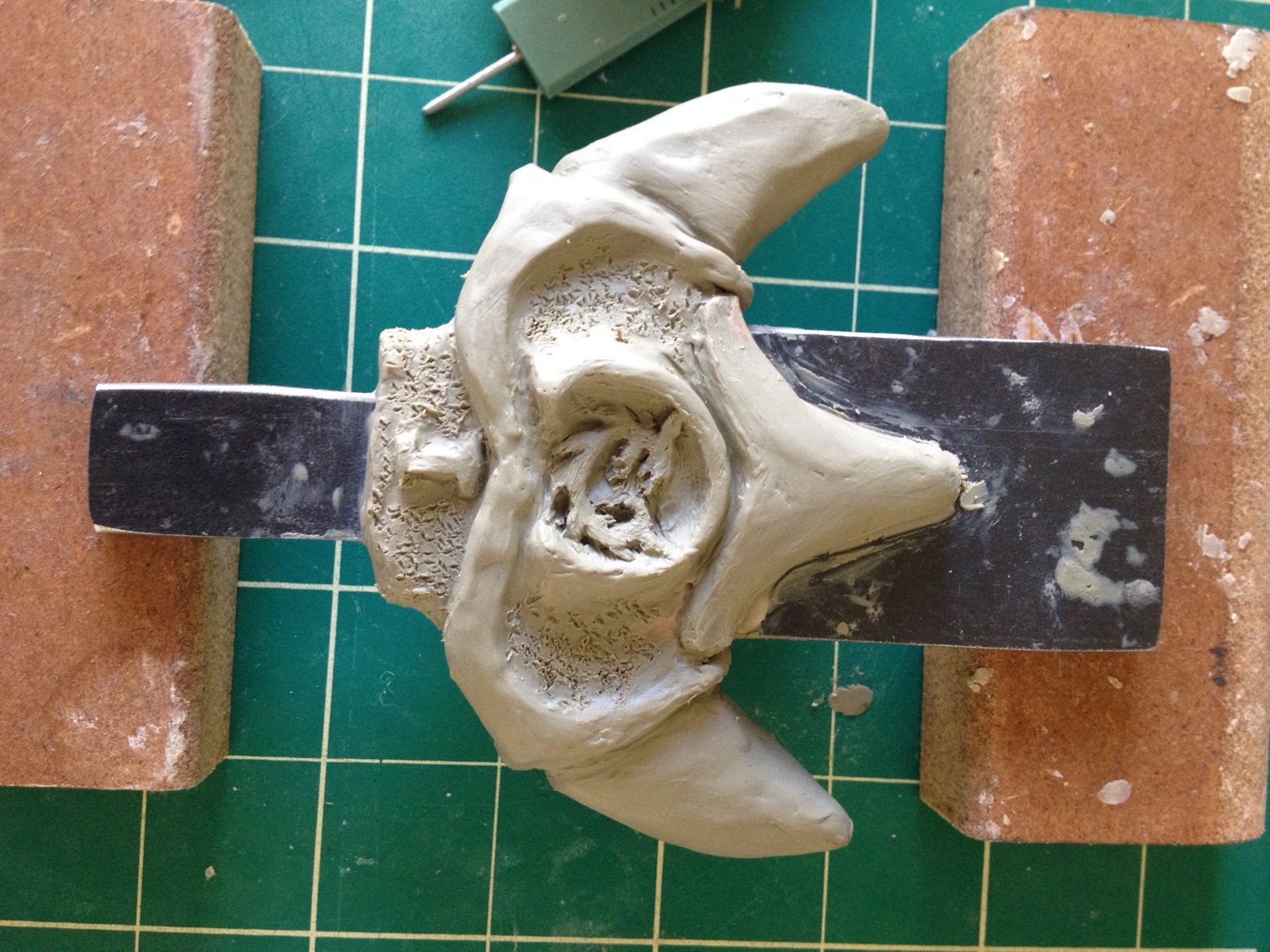

Finally got some more updates! I added a 'short sword + 1' to the mix...mainly because my daughters were feeling left out and wanted something neat that Dad was working on. So the short sword +1 made it to the top of the list! I'm making the first 3 out of aluminum and casting the guard and pommel in resin with a powder color in it to look golden/bronze (cold cast). Here's a quick progress pic:
Here's some more progress. The sculpture is made of Plasticene clay over an armature. I plan on making a 2 piece mold from it and I'm a bit scared that I might damage the original a little... I usually sculpt in Super Sculpey and bake it. I plan on spraying it with shellac before the mold making process...it should be good.
