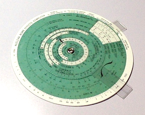

This isn't a prop from the survival kit per se, but it's displayed alongside it in the exhibition so I thought I might as well ask here:
I bought the Nuclear Bomb Effects Computer on eBay and when it arrived I found that it looks a lot more green than the more blue looking ones in the exhibition.
It's definitely an original from 1962, just like the screen-used prop. I thought that maybe it looks greener because it may have yellowed from sunlight over time or something, but the white parts of it aren't yellowed very much at all.
When I did a google image search for these, the majority of the results look like the blue ones but a few are green too. Does anyone know if a greener one was just also sold alongside the blue one, or if there's some other reason for this?
You have a good one! The colour Green fades to Blue over time when exposed to light.
