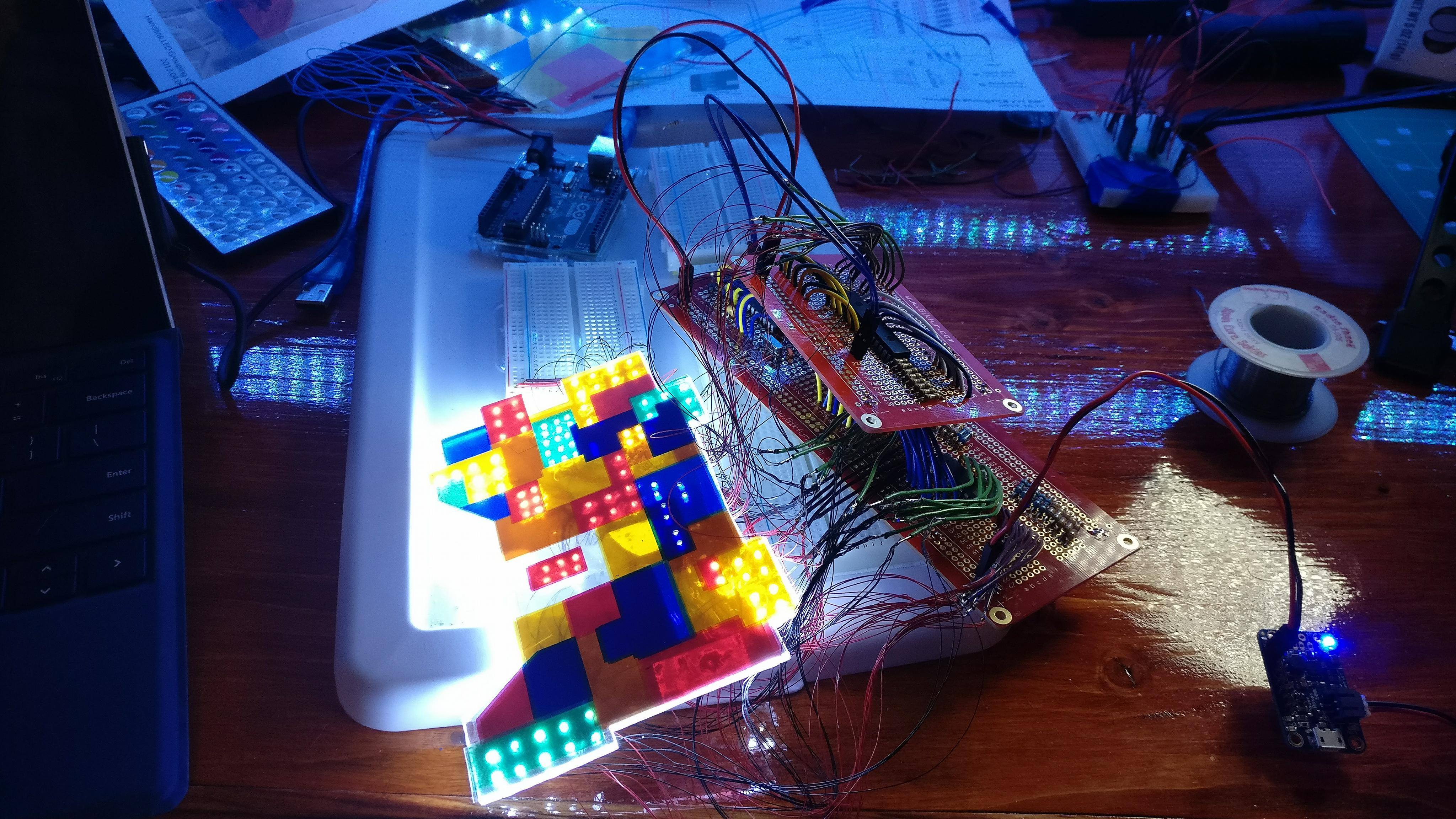

Almost done. There was a major change to the electronics that pushed it back, but I think we got that whipped. The last iteration involved using a raspberry pi as the brains, but that proved to be a problem with battery power, and more importantly, boot up time.
So Morgan took a sledge hammer to that idea, and basically started with old school MCU programming. I've got the circuit board awaiting a parts breakdown from him and then that can go to pcb fabrication in China.
As you can see, in prototype its pretty messy, but once one the PCB it will be nice and clean.
