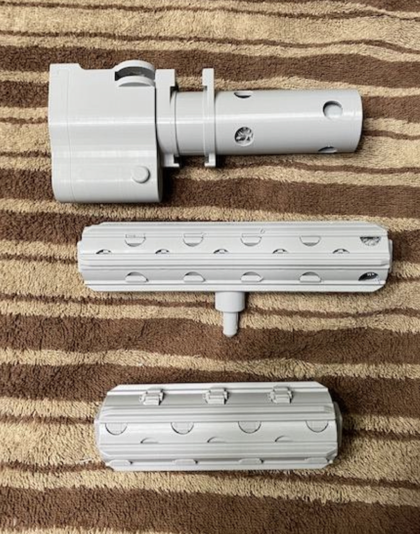

Purchased a DLT-19 kit off Etsy, later found out it is produced by a member of the 501st (as he included his trading card with the shipment). First 2 Photos are from his sales post.
Amazing details!
Just a bit of cleanup to get it ready for paint and assembly - clearing our all the holes on the barrel and removing the support material from printing...that was a solid day that my hands will never forgive me for!
Here’s a closeup pic once the holes were cleared:
Some sanding to do (could have done more...but as it was my first go on a 3D I’m happy!) and then it was ready for priming (it’s cold in Canada...so sprayed in the garage and hung in the basement to dry)

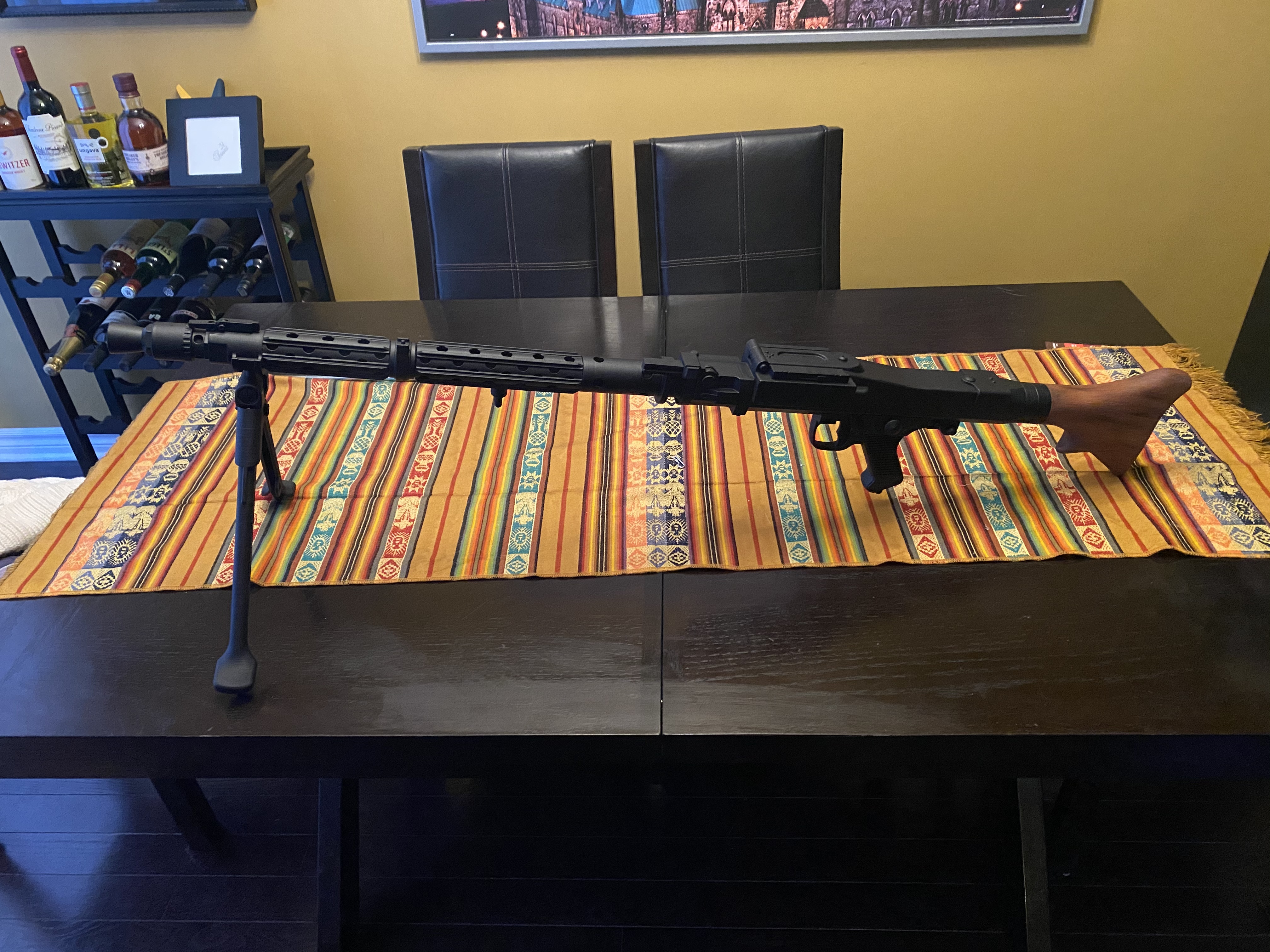

Then final assembly of the details bits and attaching the stock... and now it sits waiting to see if I’m going to weather it:
You may have noticed that there’s what looks like a bipod under the barrel...of course it’s workable!
Great print, easy assembly, would have been easier clean up if I wasn’t so new at it I’m sure....absolutely love it and had to share!
