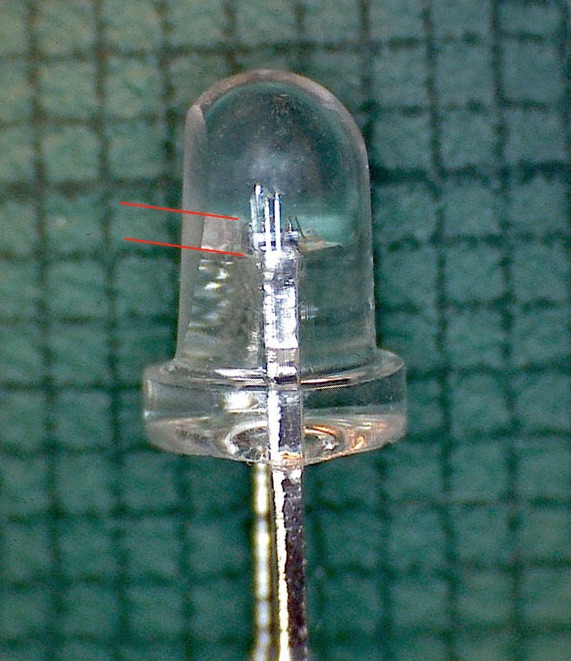

So I got to thinking, what if you got rid of the green diode altogether? After all, tricolour LEDs contain three separate diodes housed inside a single transparent case. The tiny silicon die making up the diode is wired using an unbelievably thin wire.
And that was the answer! I examined the lit LED carefully, figured out which side the green diode was on, and roughly filed that side of the LED flat. Then I used a 0.3mm drill and slowly drilled a tiny hole into the LED, testing as I went, until I severed the wire that powered the green diode.
Done! I now have a 3mm LED that runs off 3 volts, and which slowly fades continuously between red and blue. The one drawback is that there's a short period where no light is emitted at all, as that's the point in the sequence when the green diode would have been lit alone. But since R2's light occasionally looks like it's off, I figure that's good enough.
