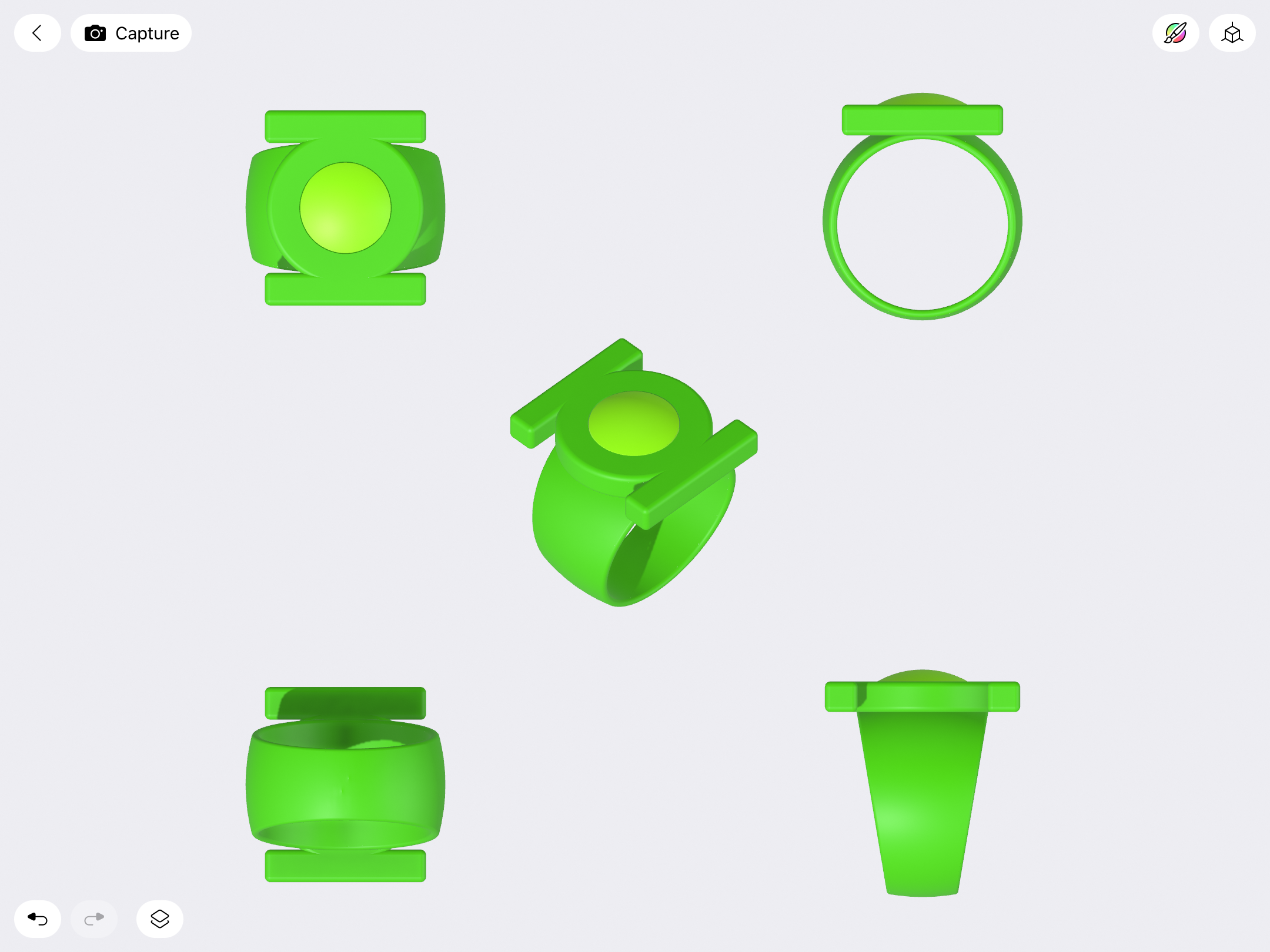

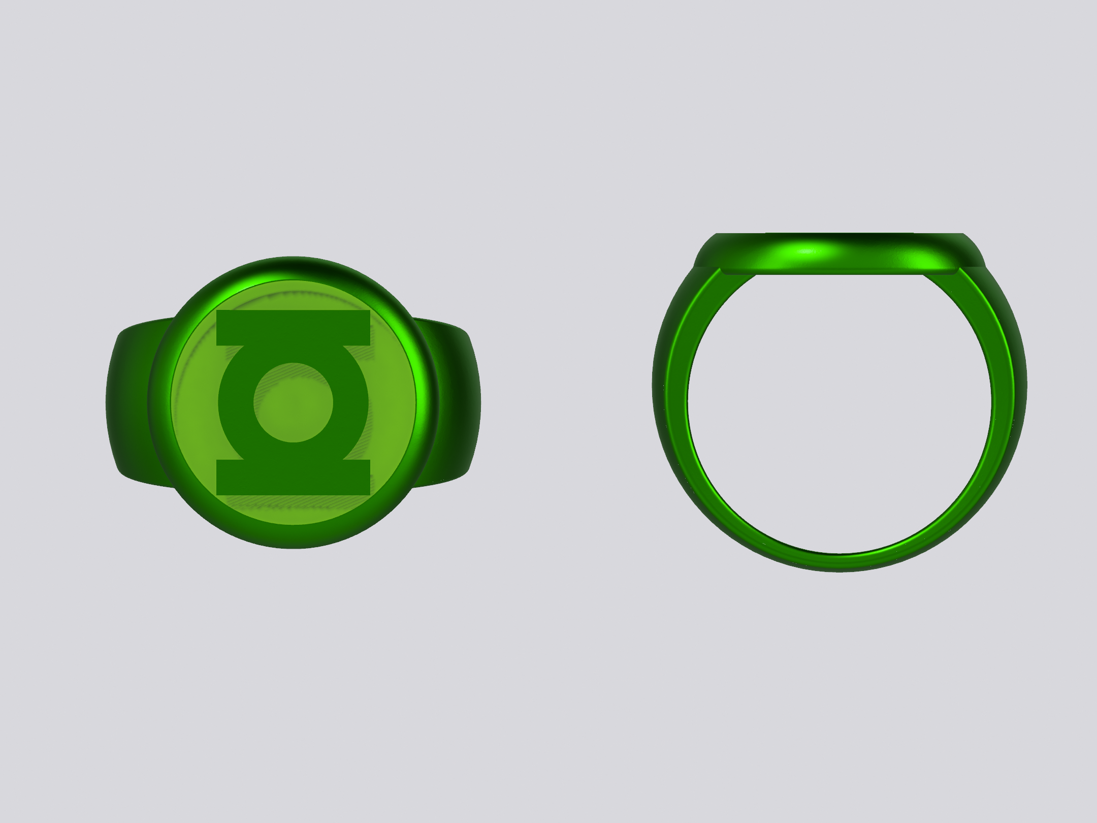

Playing around with the V2. Made the symbol-piece exactly 1” (25.4mm) long, and slightly adjusted the width of the band.
…and, since I reworked the V2, I decided to go back to the V3. Having now had more modeling experience, and since Shapr3D has added some new tools, I’ve now worked out how to subtly adjust the proportions of the model without putting in tons of work.

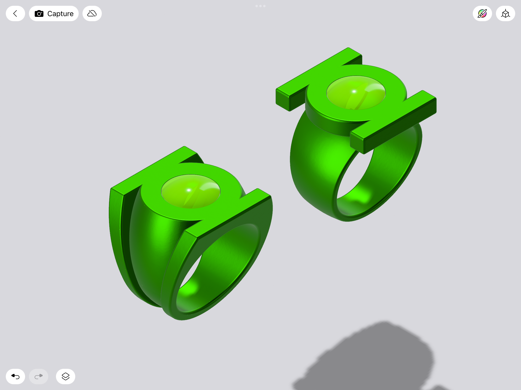

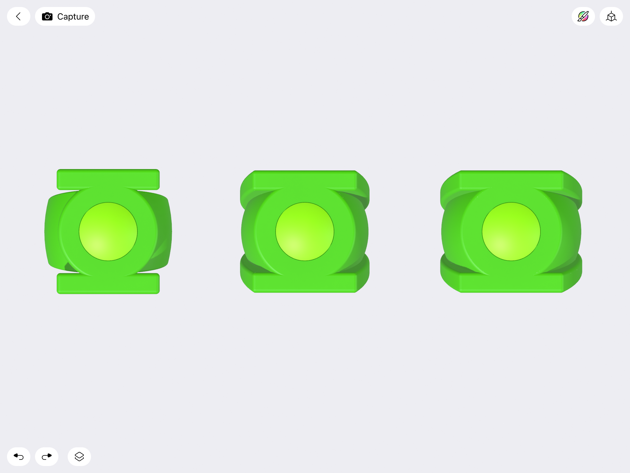

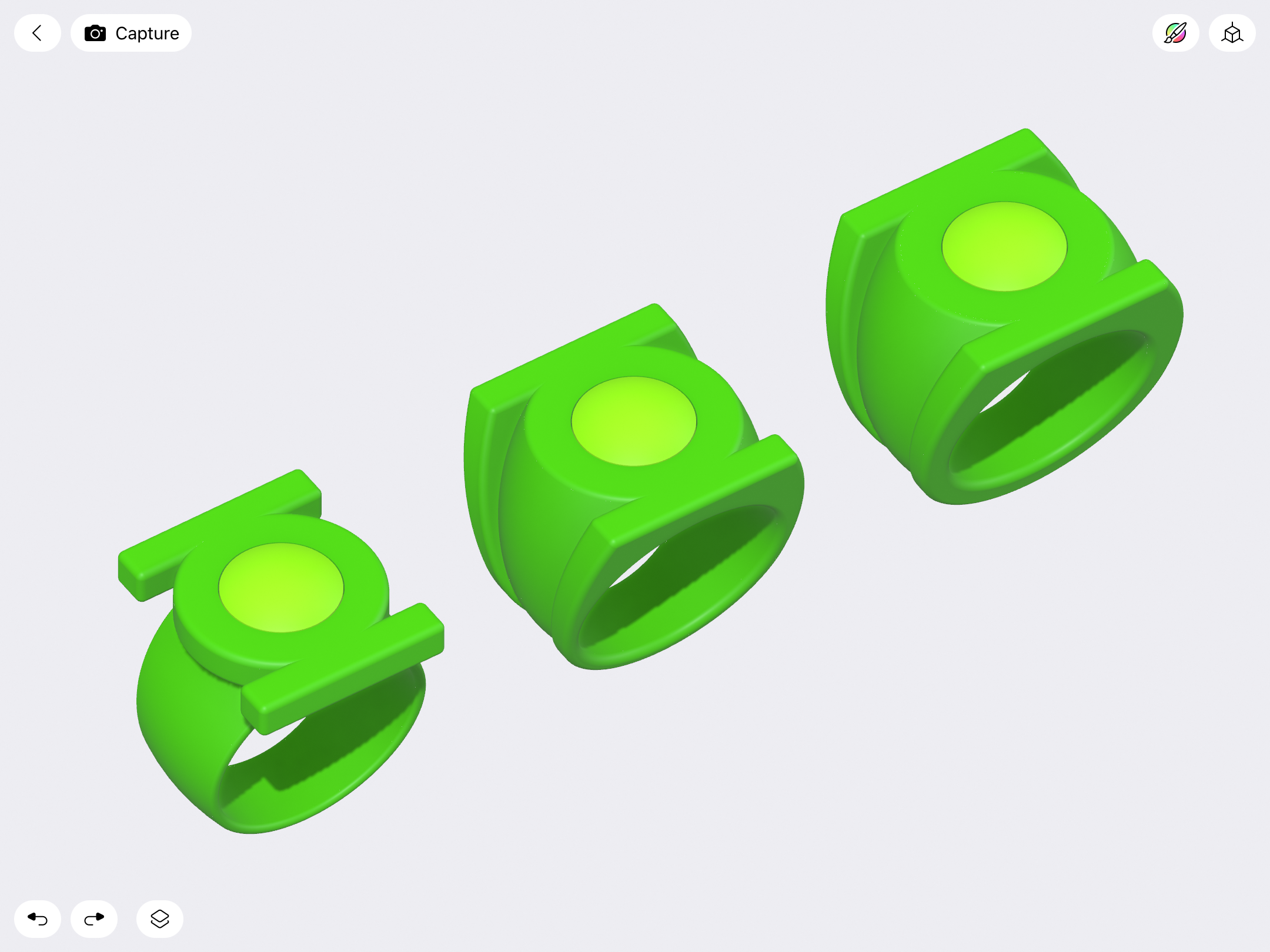

Here we have the new V2 (left), and two variants of the V3. The size of the symbols and gems on both the V2 and V3s are identical. The height of the faces of both V3s (from finger-hole to symbol/face) is 4mm. The left V3 has a thinner band, akin to some of the Mike Grell art. The right V3 is obviously thicker—probably too thick to be comfortable. It’s a tricky balance in terms of the height of the face and the thickness of the band. Tweaks to either result in either a squat or a tall and skinny appearance. The comic art reference can go either way. As noted in the past, the 2011 movie ring has a VERY tall face, which I’m not so fond of. I’m trying to find that sweet spot—not too thin, not too thick.

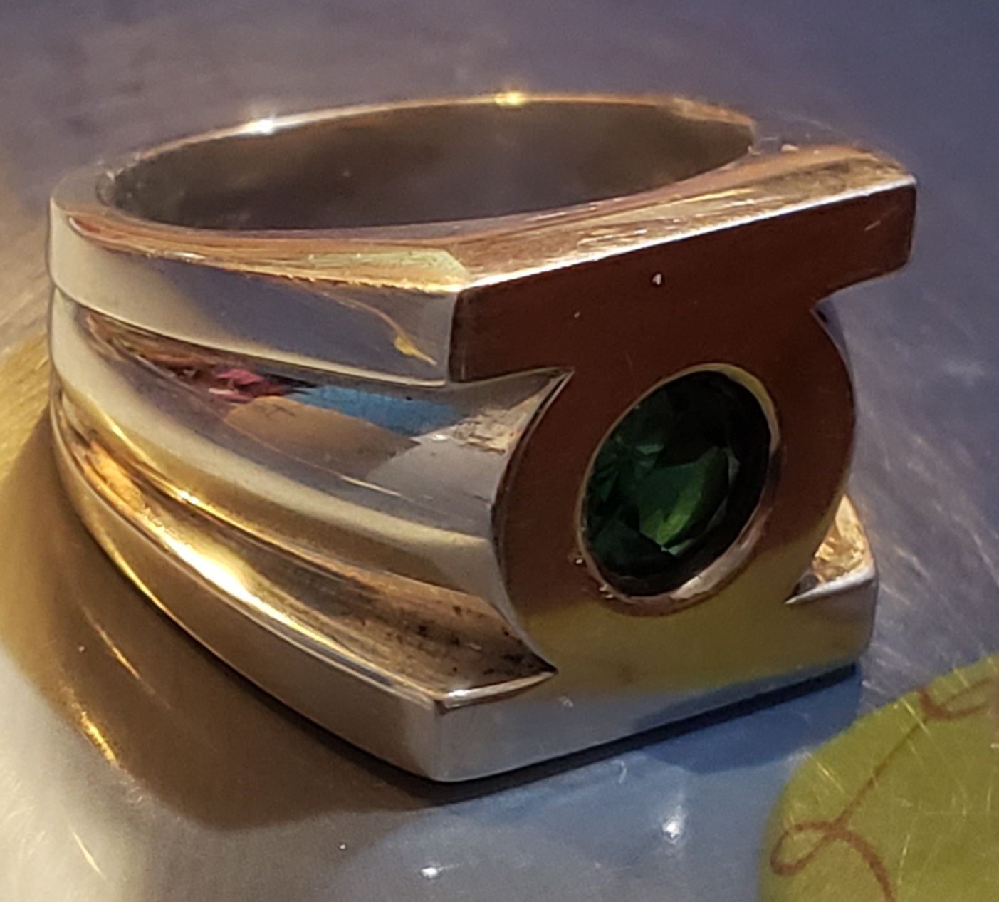

So, this is a ring I had made by Geek dot Jewelry.
Yeah, I am sorta showing off, but this ring is my fave style Green Lantern ring. And it is silver, if you drop it, it might break your toe.

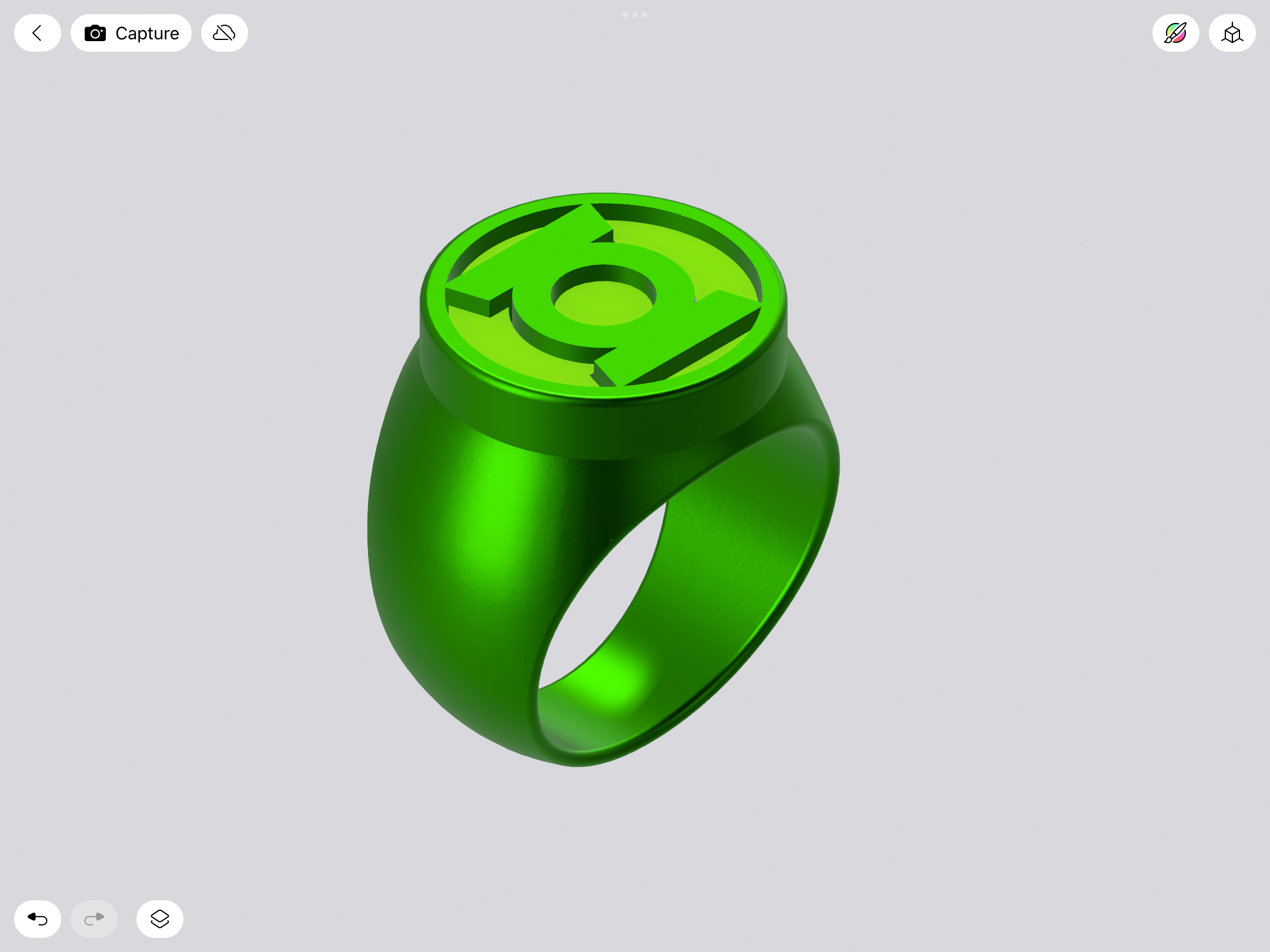

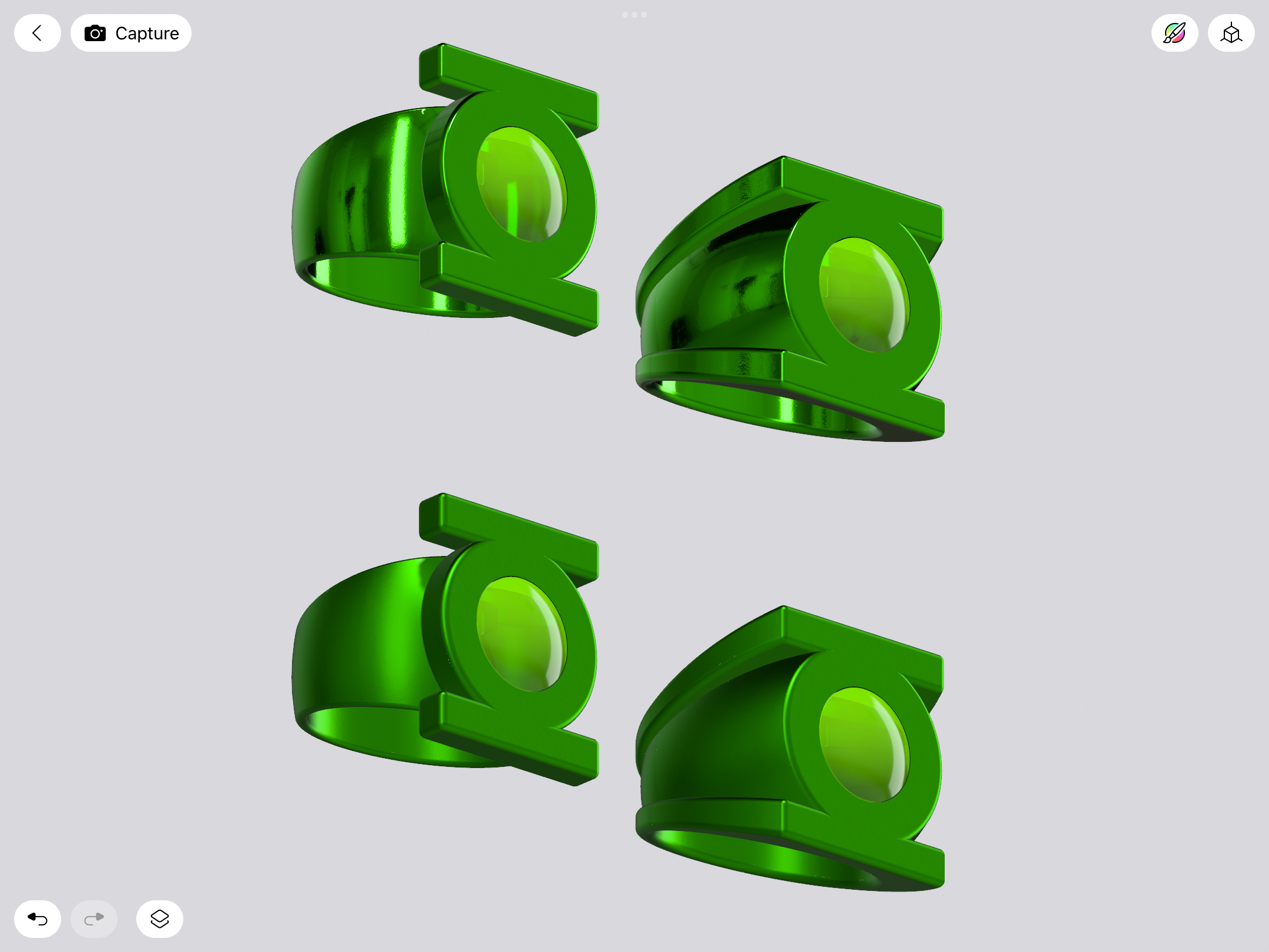

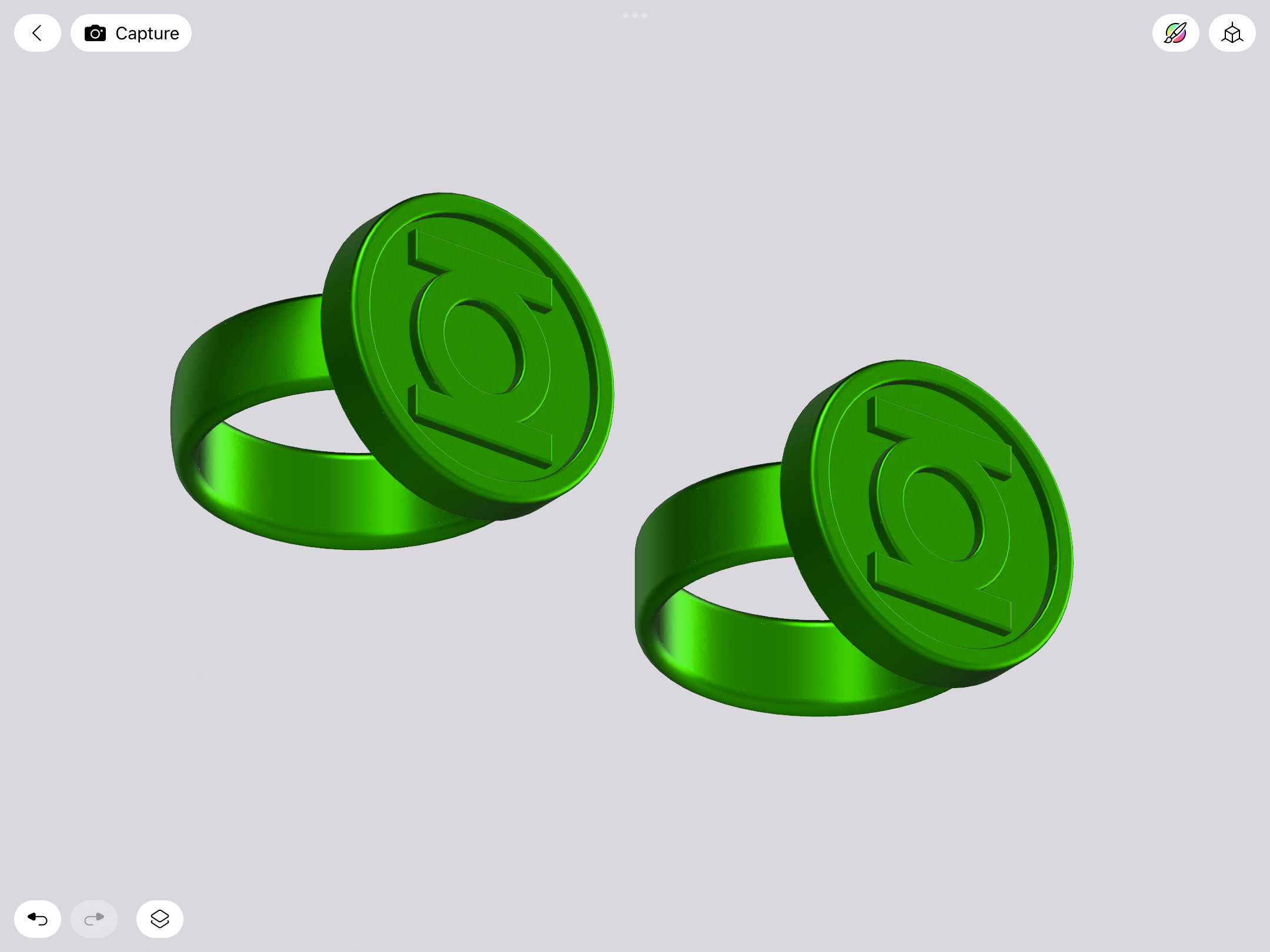

After the latest round of tinkering with the V2 and V3, I’ve finally gotten around to playing with Shapr3D’s “Visualize” tool, which simulates different materials and finishes. I think this will help with getting the overall look right.
Here are Anodized Metal in glossy (top) and matte (bottom). The gems are Translucent Glass (thick).

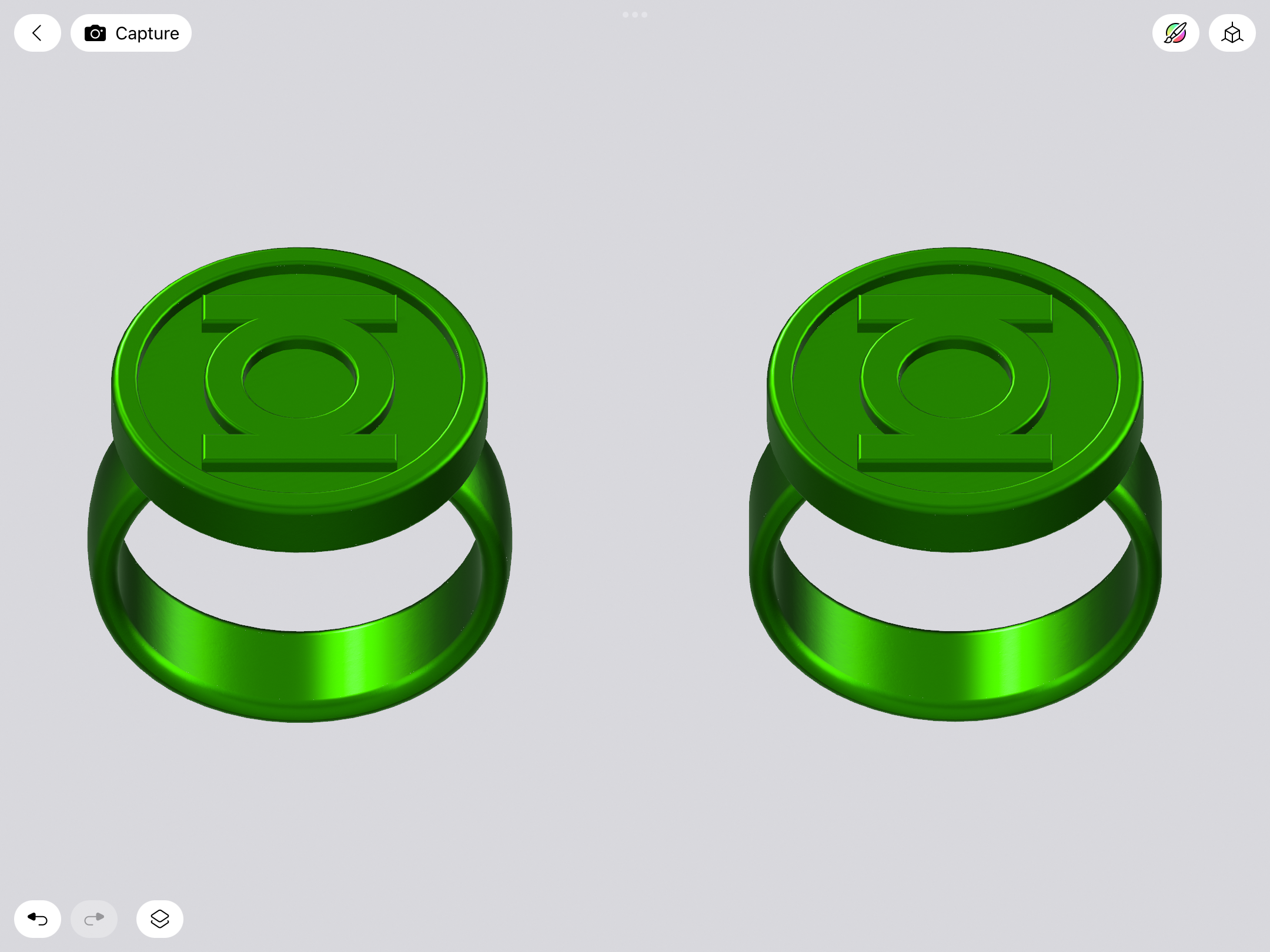

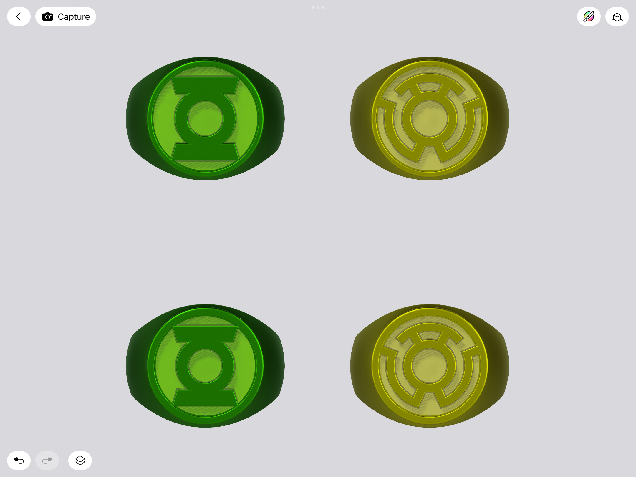

Tweaking the outer ring/flange surrounding the symbol on the REBIRTH design. The official version of that symbol has a very thin outer ring/circle, which would be far too thin to translate into a real ring, so I’d previously thickened it up a bit. That version (top) still seemed a little thin, so I decided that the magic formula would be 2/3 the thickness of the inner ring of the GL symbol itself that is sandwiched between the sidebars. The result (bottom) looks pretty close to the BLACKEST NIGHT promo rings.
I kinda like the thinner ring, but the thicker version looks good, too. Decisions, decisions.

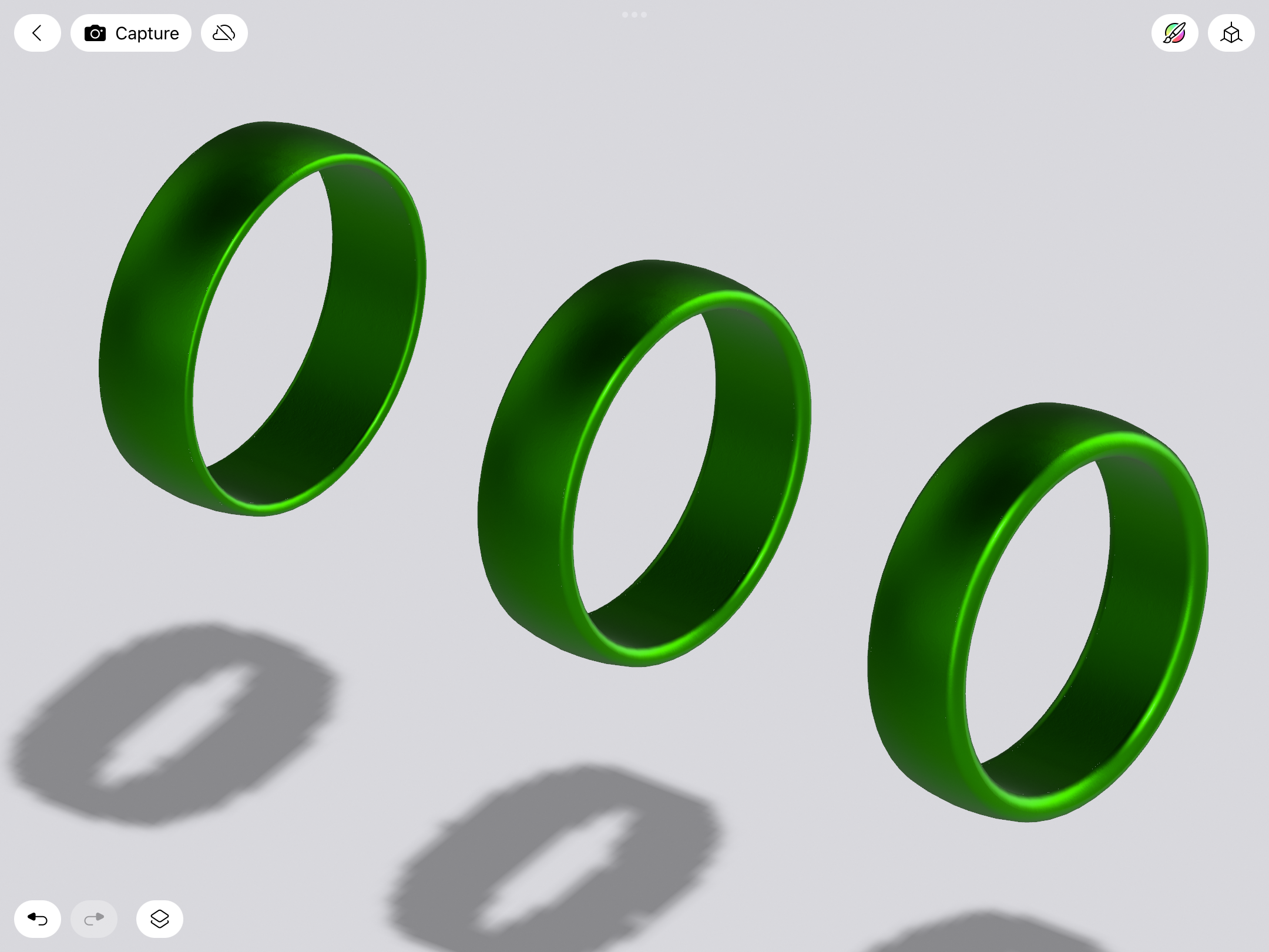

Working on the V1 band. Tweaked the doming of the round-sided variant. I’ve also been doing more research on real ring bands, and made variants (from left to right) in light (1.3mm thick), medium (1.7) and heavy (2.1), which are standard ring thicknesses.
I’m just wondering now about the degree of filleting for the edges, and whether to have a flat edge with a fillet on either side, or go full-round and organic.
Using the above-mentioned basic bands’ philosophy as a template, I’ve been reworking the V2, V3, and REBIRTH to reflect it, with a consistent 0.50mm filleting on all the edges, and various band weights corresponding to the 1.3/1.7/2.1 model. Easing back on the filleting from 0.75 to 0.50 also gives a crisper look (without creating edges that are too sharp, hopefully).

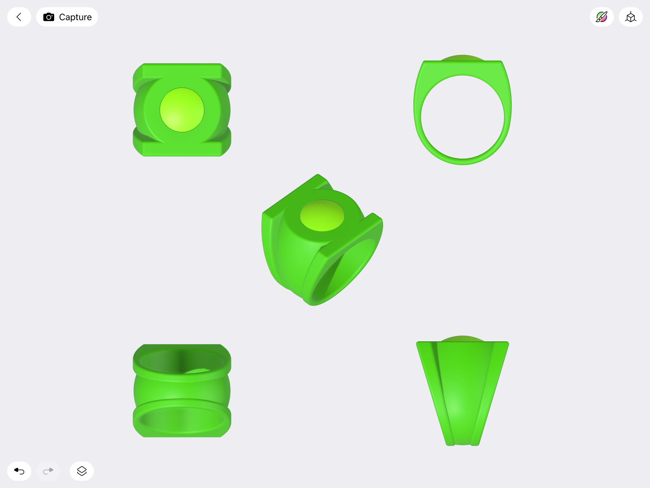

I actually ended up rebuilding the V3 almost from scratch, and gave the ribs (formed by the sidebars of the symbol wrapping around the bottom of the band) a little more thickness and definition, as well as raising the face of the ring by 1mm to give it a bit more height.
Still going back and forth on whether to even bother filleting the edges on the REBIRTH ring’s symbol, since I presume polishing would knock them back sufficiently. The tweaking has also made it look even closer in overall shape and proportions to the BLACKEST NIGHT promo rings, which measure out at right around 2.1mm thick at the base of the shank. While I’m not trying to duplicate the promo rings exactly, they do serve as a good ballpark guide for that design.

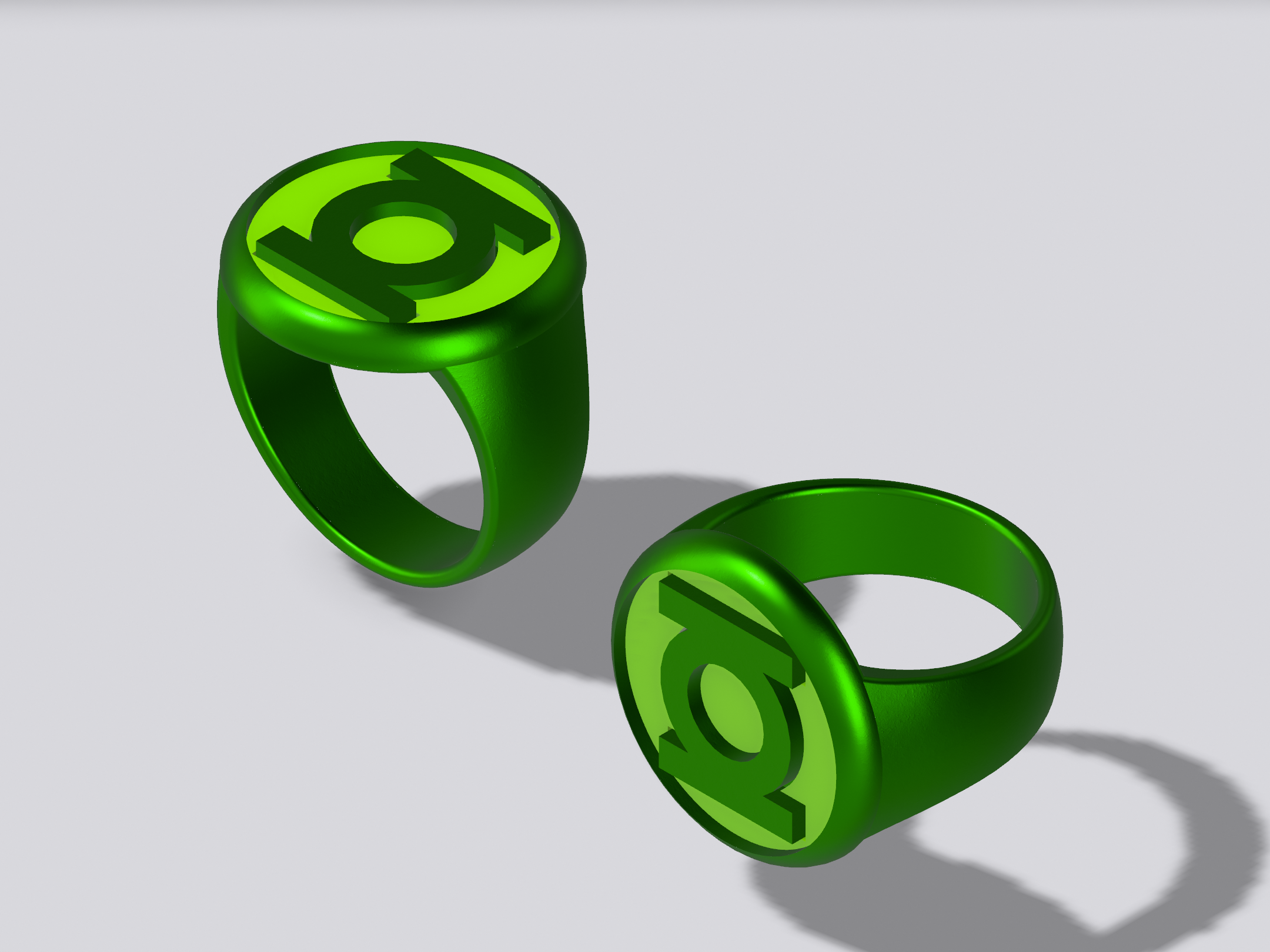

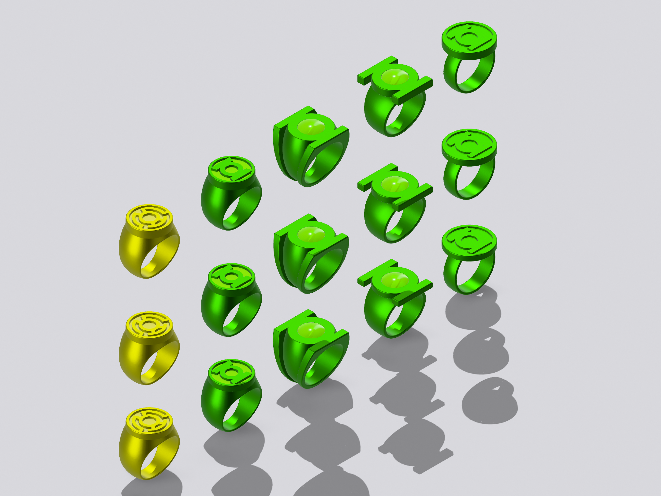

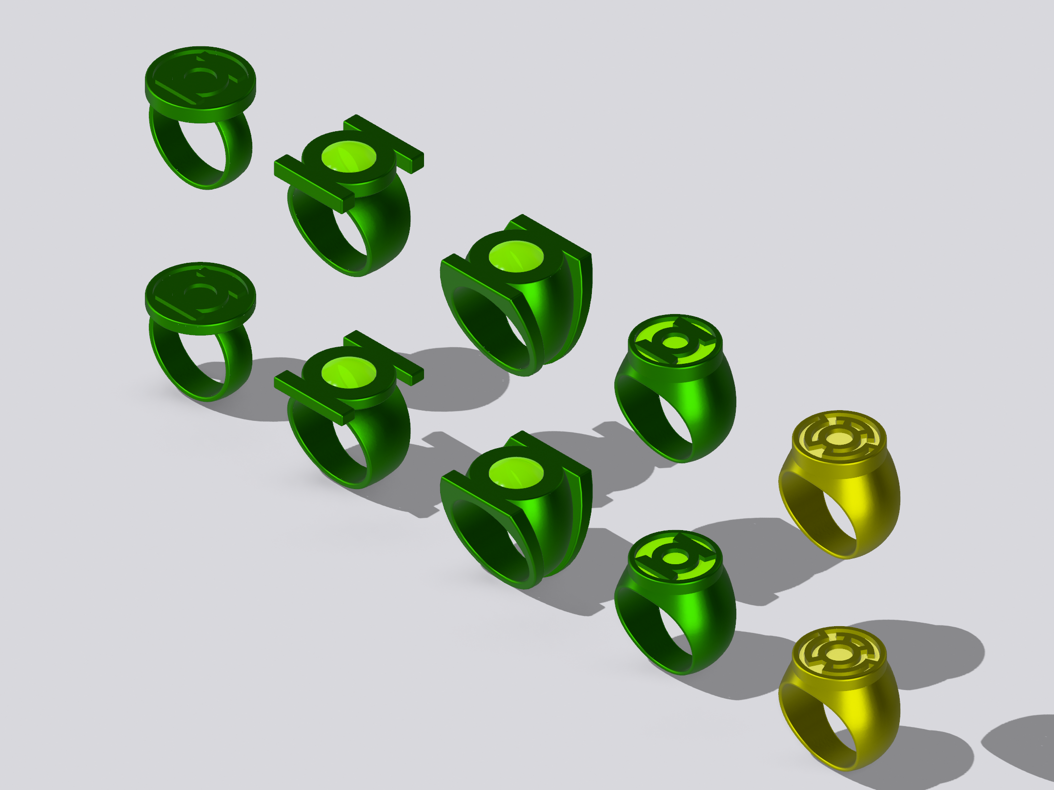

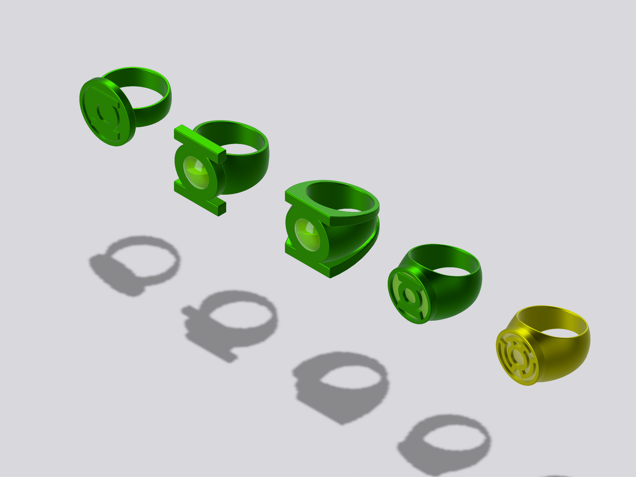

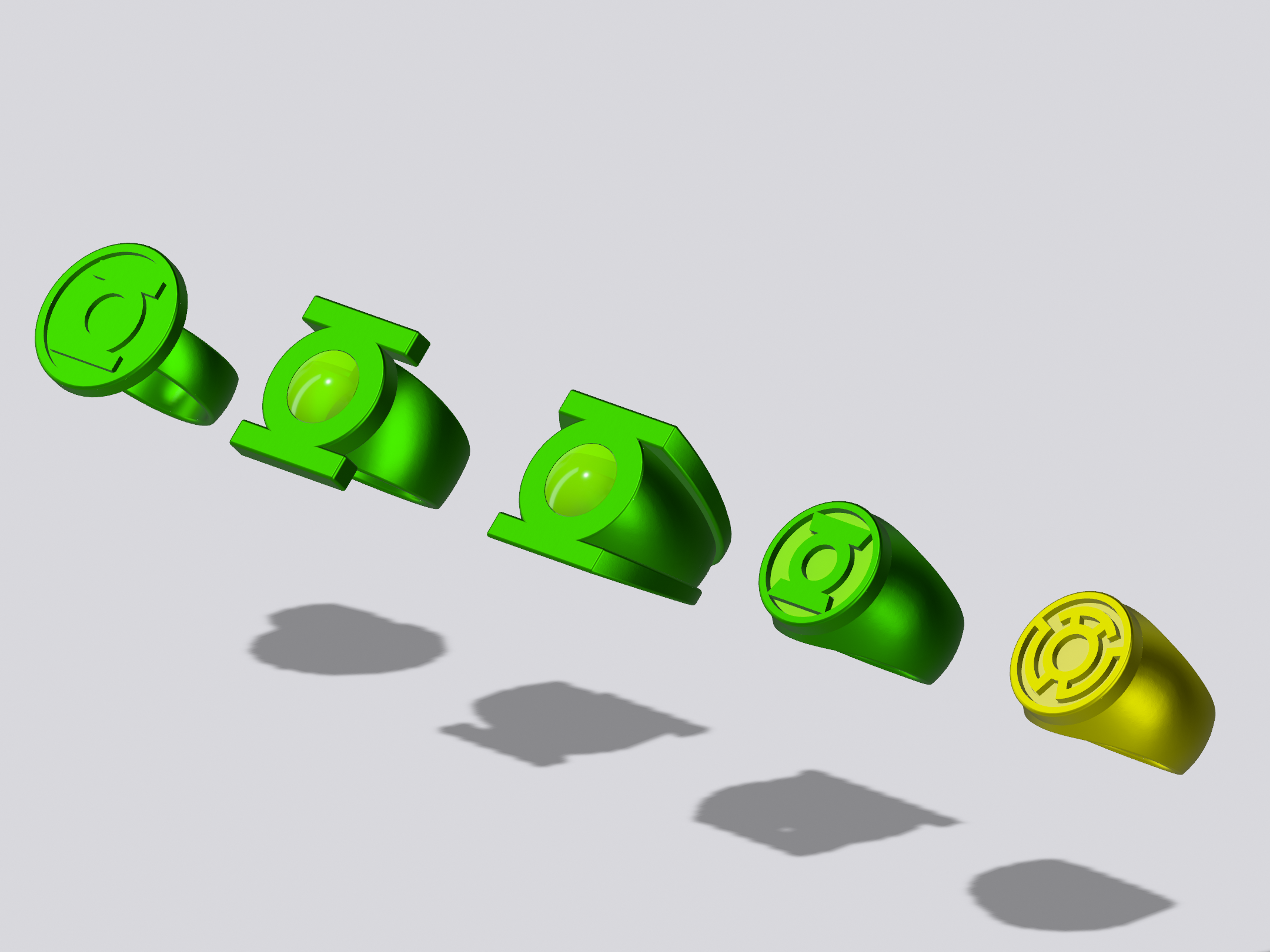

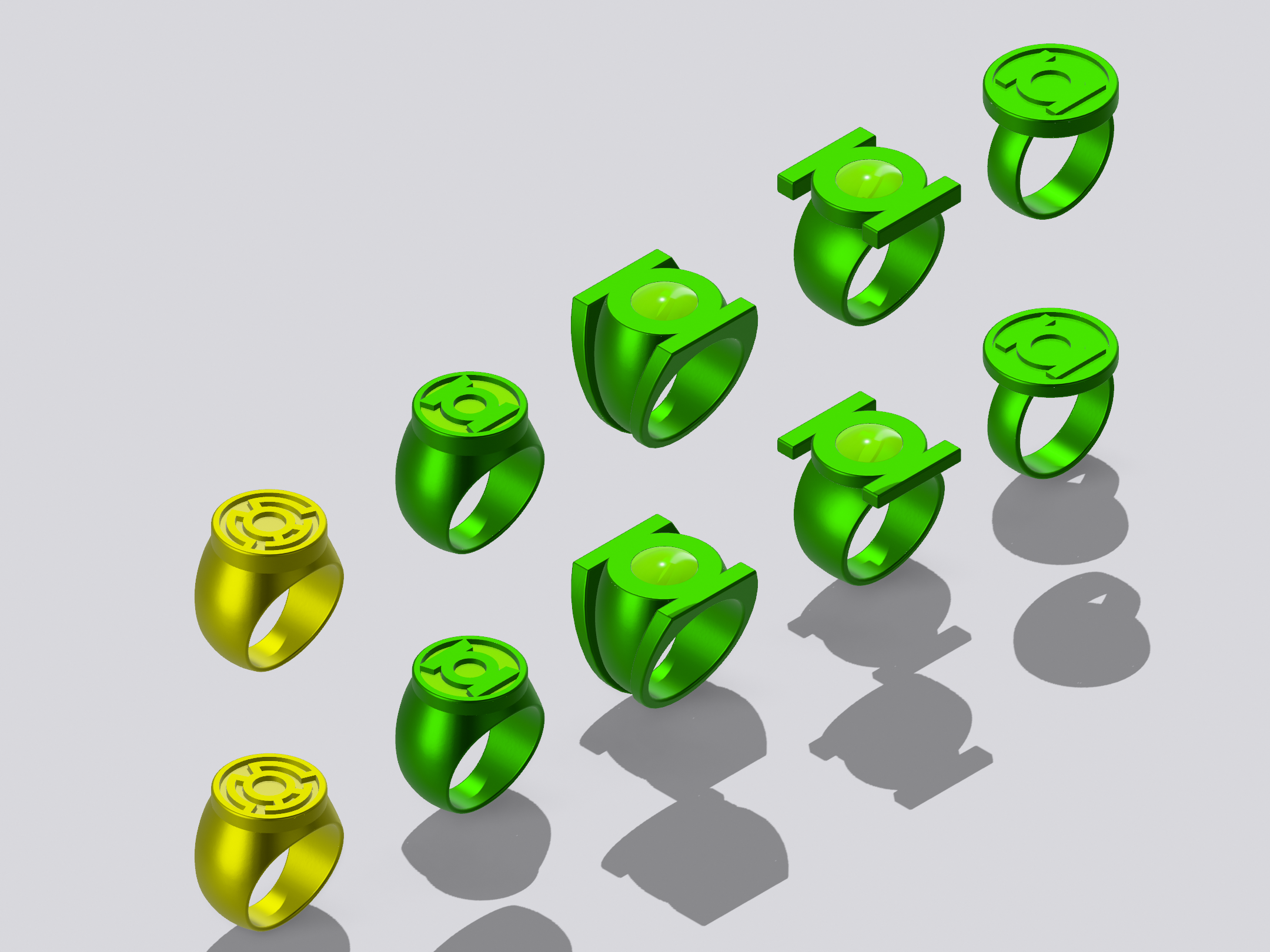

Put together some group shots just to get a feel for how they mesh together. Looking a lot more unified, now. All fillets are 0.50mm. The bases of all ring shanks are 7.5mm wide. All signet-type rings have a disc that’s 3mm thick/tall. The symbols/faces/gems on the V2 and V3 are exactly the same size, with the band styling (symbol atop tapered band on the V2 versus the Grell-style, integrated tri-band on the V3) being the only difference between the designs.
It’s a small thing, but this uniformity of detailing gives a sense that these rings all came from the same source, and all employ the same Oan technology. Well, except for that Sinestro Corps knockoff, of course…

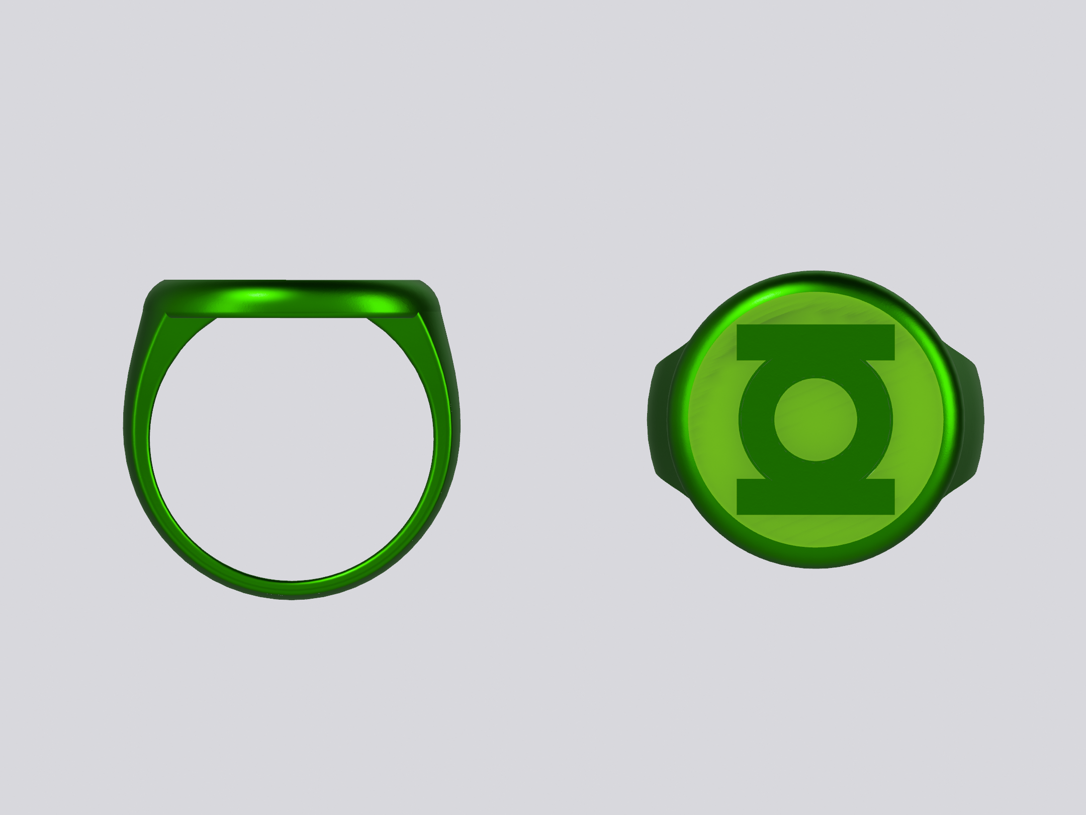

Anyway, I’m getting close to the next round of test prints. Just need to give the EMERALD DAWN and the signet ring version of the V1 a fresh look. I also find myself wondering if this new version of the V3 might not be too chunky, and if it should be smaller. We’ll see. Also, as I’ve noted in the past, there are hints in the Broome/Kane comics run that the V1 should have the lime-green crystal negative-space surrounding the symbol, rather than being monotone green metal. Of course, the comics were rarely colored so as to depict a two-tone ring, and then really only after Kane had started drawing the curved-band V1. Whereas the version in the images below specifically represents the early look of the ring from the first few years of the series—a disc stuck on top of a simple band.
I’m also still not entirely sold on the thickness of the signet discs or the height of the V3. Somewhere between 3-4mm seems to be the sweet spot, but certain heights can look off when compared to other details on a particular design. It’s a matter of getting the proportions and overall look right.

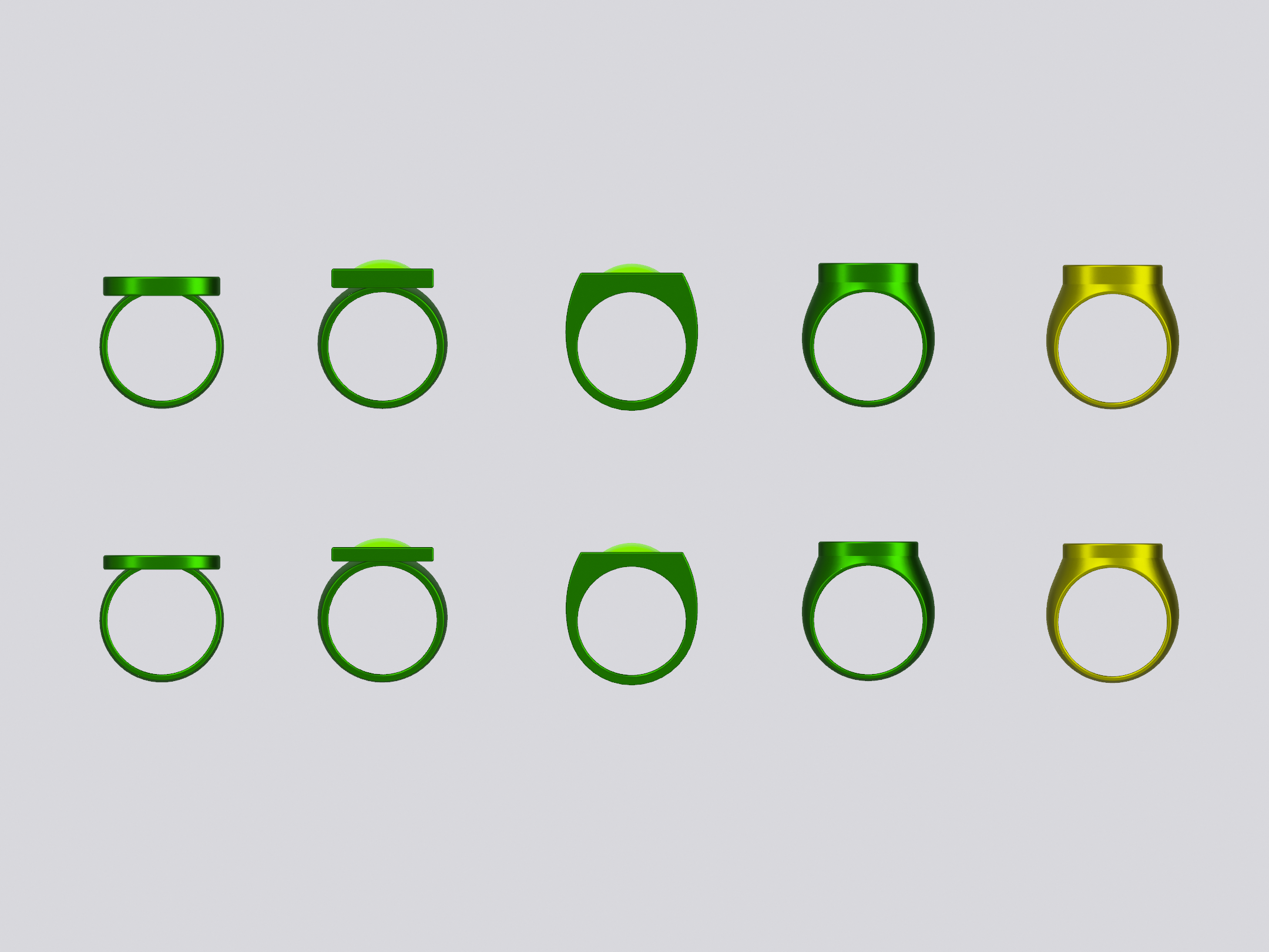

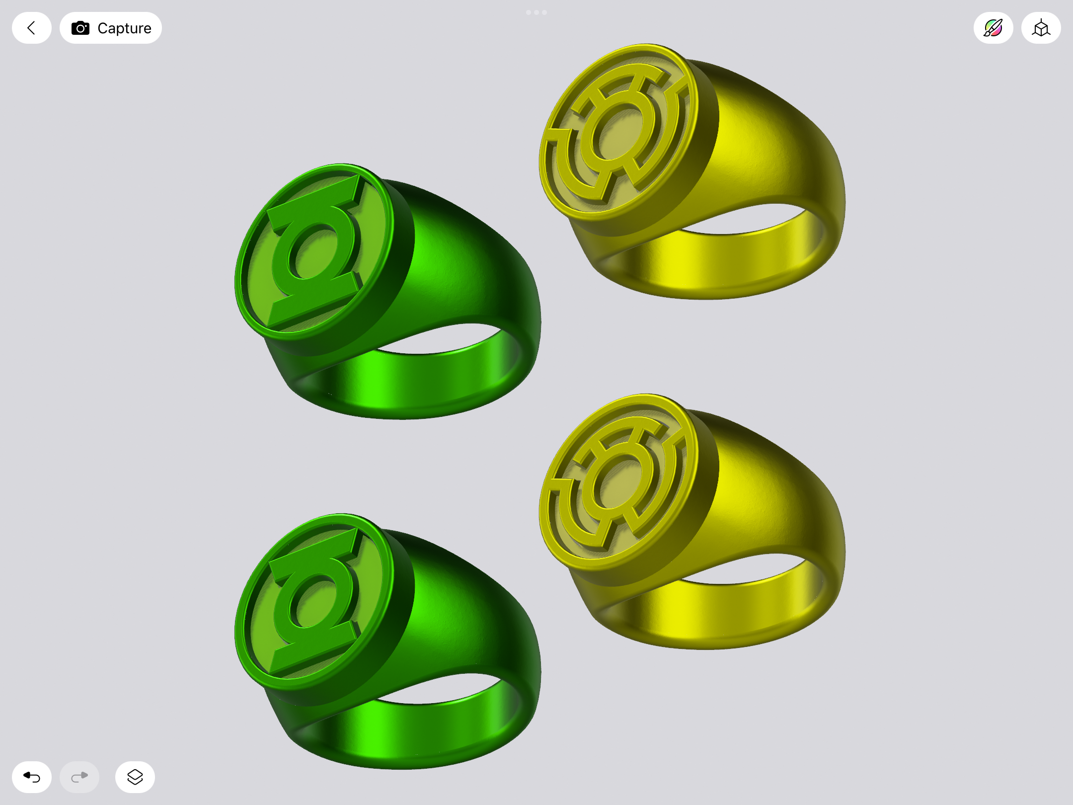

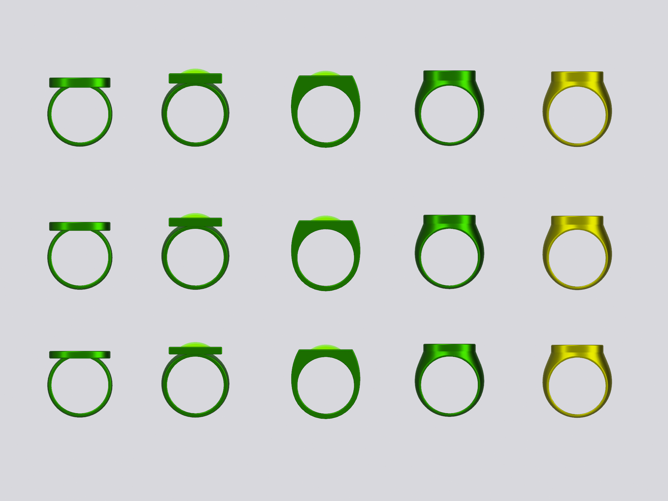

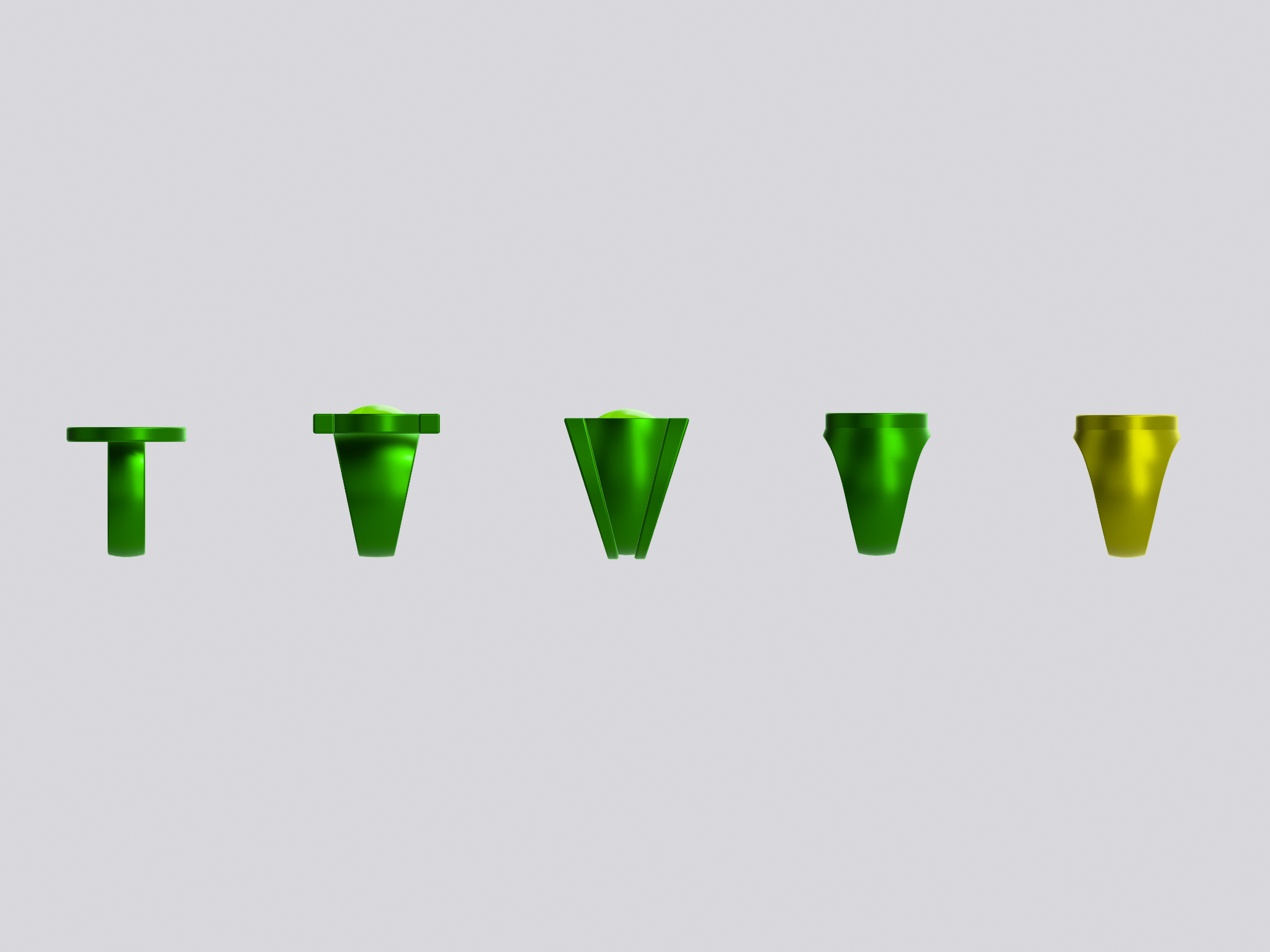

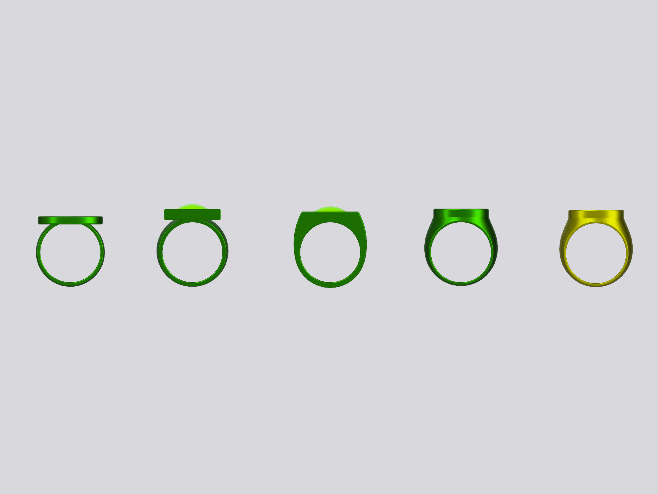

So, I’ve tweaked the models to reflect both 4mm (top) and 3mm (bottom) heights for the symbols and signet discs. The previous images posted upthread were a mix (3mm for the signet rings, 4mm for the V2/V3). It’s a subtle thing, but kind of important to the overall look and proportions. As I’ve noted in the past, the super-high-profile looks of the BLACKEST NIGHT promo rings and the 2011 movie rings is not what I’m aiming for.
I’m open to a mix of heights between the designs, but I’d kinda like to aim for consistency.
