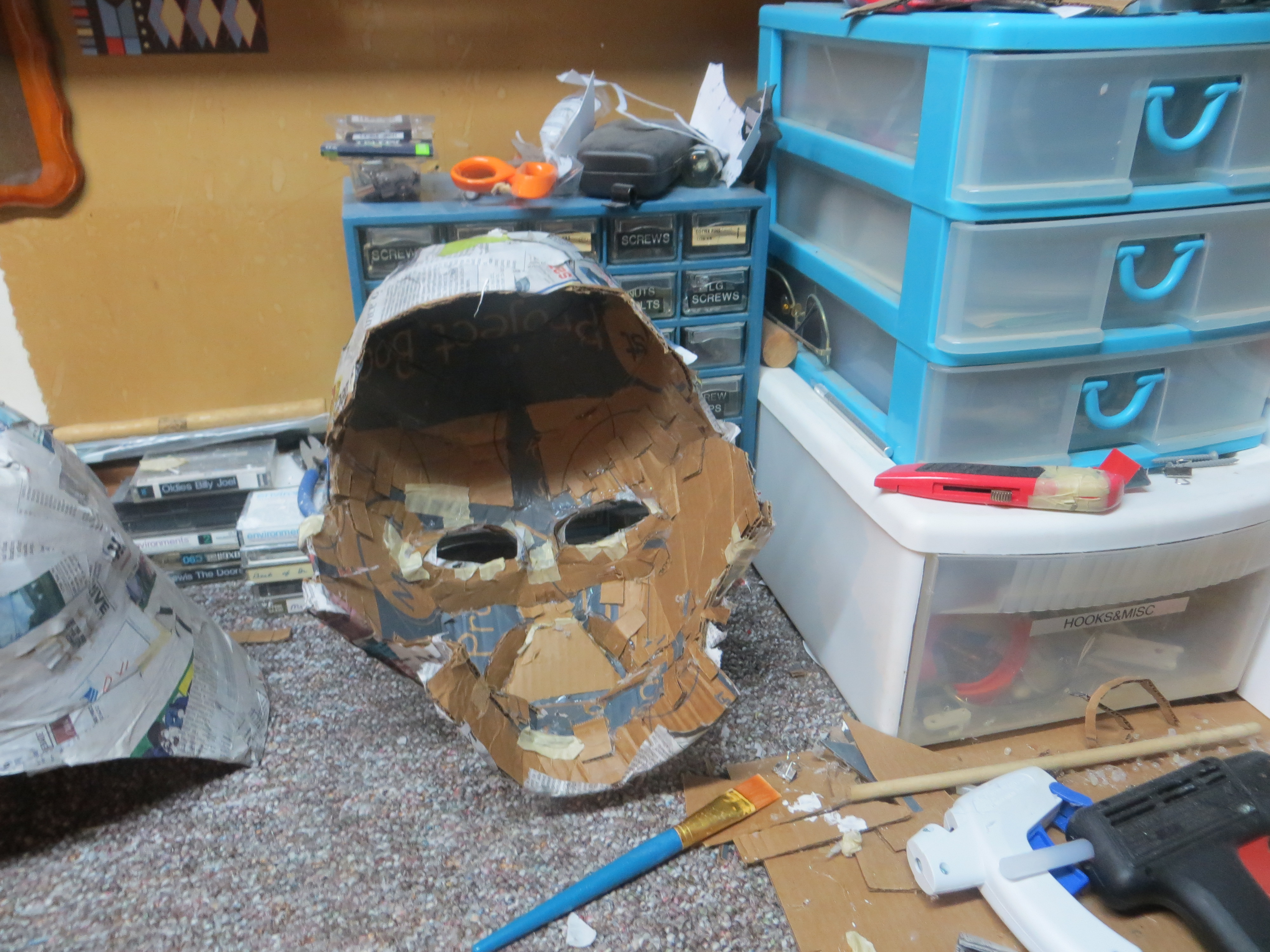

I don't have pictures of the early process, but I do have what I have so far: The Helmet with all the pieces attached. Finally found a pretty close size, and not attaching the back parts of the mask part so it's mork mask like helped a bit.
Only slight problem is...
...I haven't "attached" the pieces yet. I am reasonably sure that if I clue the big cap to the mask part, then it would be really hard to actually put on the whole thing, so, with much hesitation, the plan is to use Velcro for ease of wearing, and to stop the big cap from wiggling.
Here are some pics of me messing about, to give a general idea.

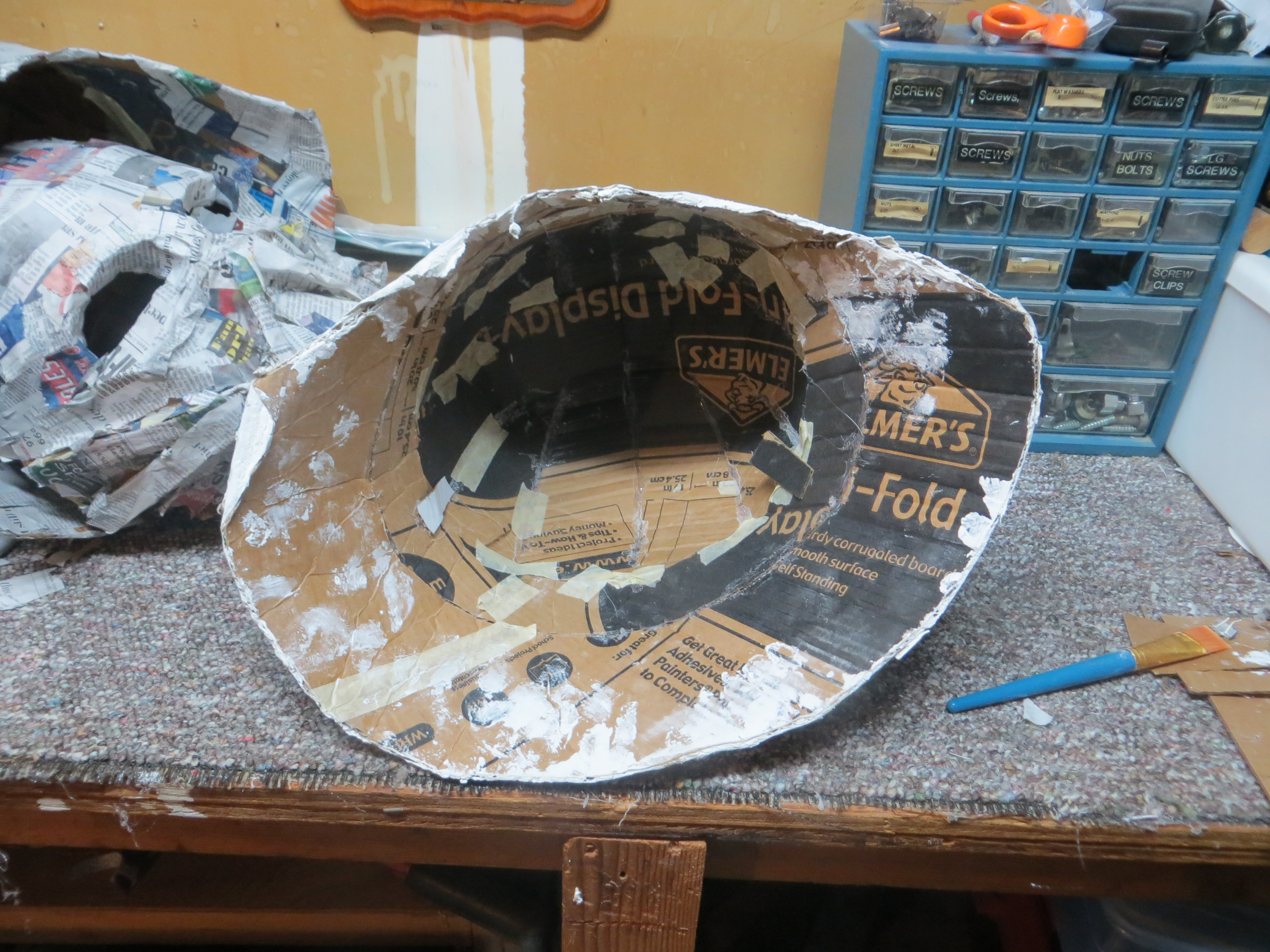

So, yesterday I paper mached the helmet, and here is how it turned out:
In my personal opinion I think it came out well.

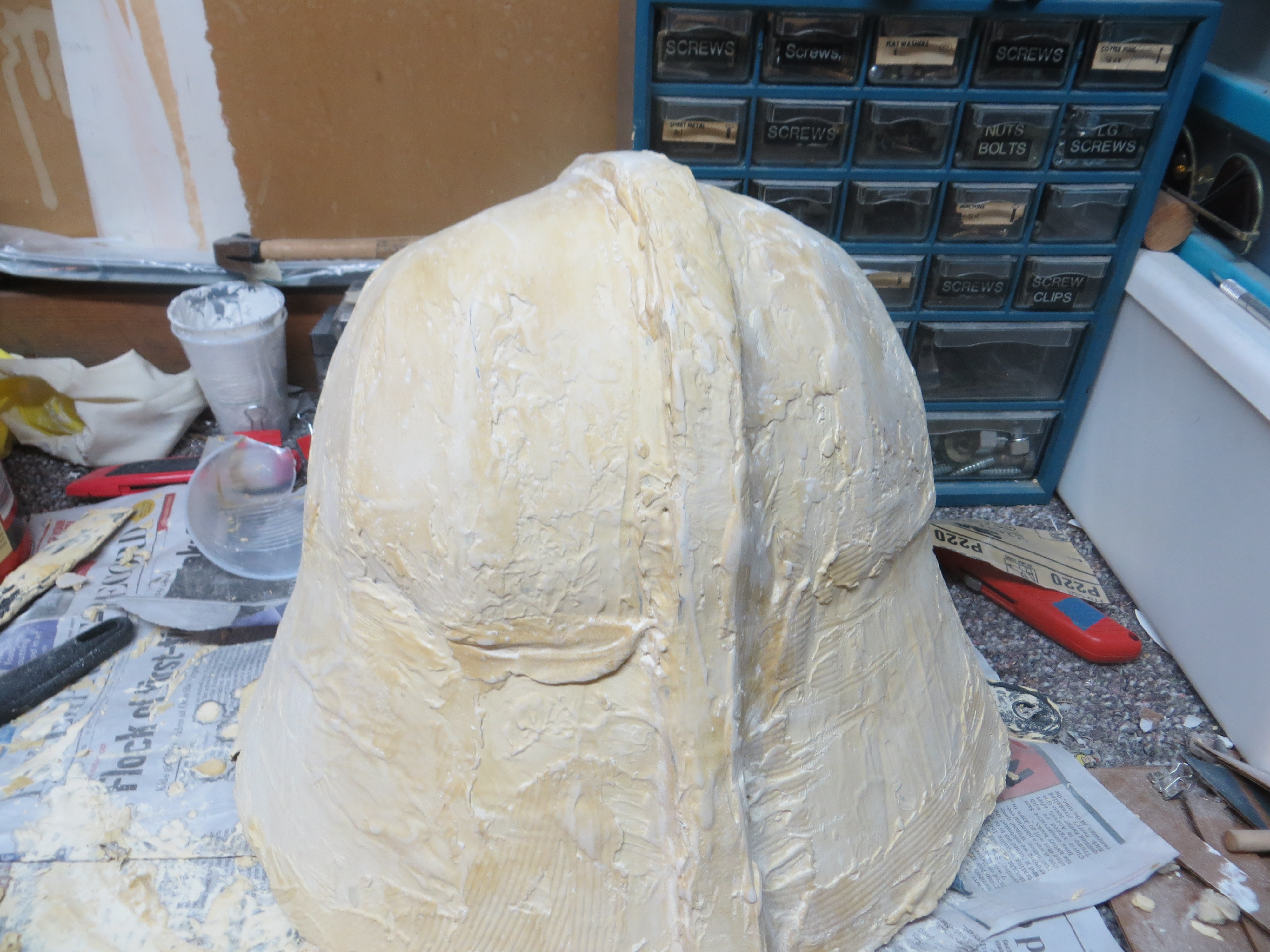

Using the Durham's Rock Hard Water Putty, I get to work, and now I show the fruits of my labors!
As you can see...lessons were learned the hard way.
After drying it's a little rough, and sanding it with sandpaper doesn't really get rid of the bumps and large splotches of putty. I am seriously tempted to get a motorized sanding tool, put it on low, and sand it that way, but fear the results.

Not a fan of bondo ( hated the sanding, then sanding then more sanding part hahaha) , but eventually it will be smooth enough , just had to be patient till i got the bumps sanded down. started with rougher grit moving slooooowly to finer grit sandpaper. a motorized rotary tool would help a lot ..;)
You've definitely run into the no-fun part of ANY prop build, which is the sanding. The only thing I can say is go with a coarse grit, like 80, and steel yourself for the process. I usually make my own sanding blocks out of EVA foam (same thing some people make costumes out of), which is easy to cut to any size or shape. Then I attach the sandpaper with rubber cement.
If you are really having a hard time sanding it then you'll want to back off on the glue the next time you mix up your filler.
-Rog
The glue makes it less brittle but also harder, so just use less glue if you can't sand it easily..
-Rog
