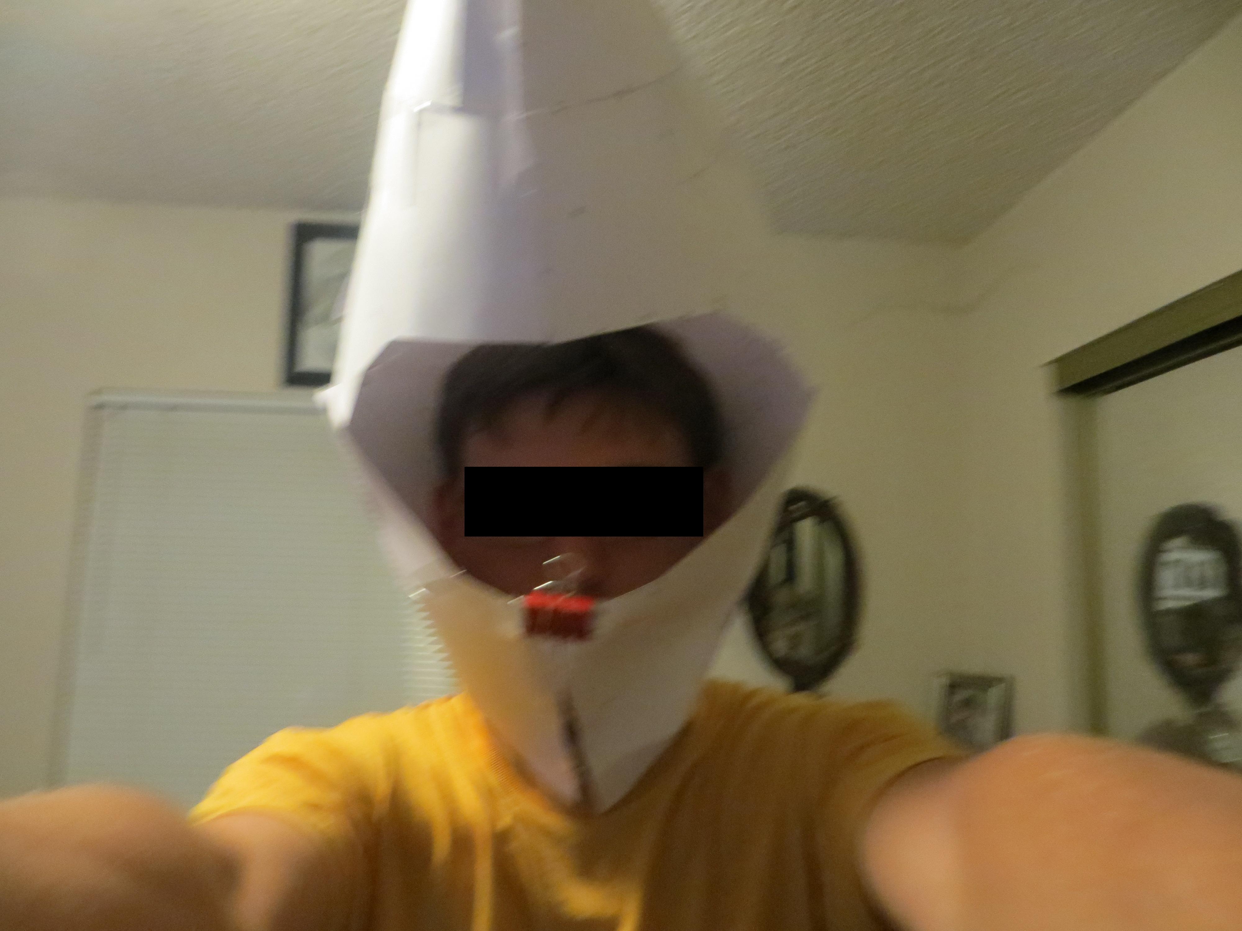

So I started making a paper prototype. Unscaled, the helmet is way to small, so I tried to measure my head and use some math to see if I could get my head into the hole.
It mostly worked. It is made of paper so...well...
in any case, the costume is going to be made of foam, first time btw, and I have a little bit of a concern in using a clasp or other locking mechanism will make the seam look visible if I do in the front. Reason why I would do that is so I can put it on my self with no problem

What is the thickness of the foam you are using?
You want to measure the outside horizontal edge of the pep 3d model, then add on the thickness of your foam to both sides (if 6mm foam, add 12 mm to model) This will give you the clearance for the thickness of the foam.
Unfortunately, when working with foam for the first time, mistakes can be made, so cut out your templates, put them to the side for now, and practice on the off cuts for making angled cuts and practice gluing edges together.

As for fitting your head in the hole, You can cut a slit up the back of the helmet, using magnets, velcro strips, or the like to keep it closed. since the pauldron section includes a cover for the back of the helmet, you can hide any seam.
