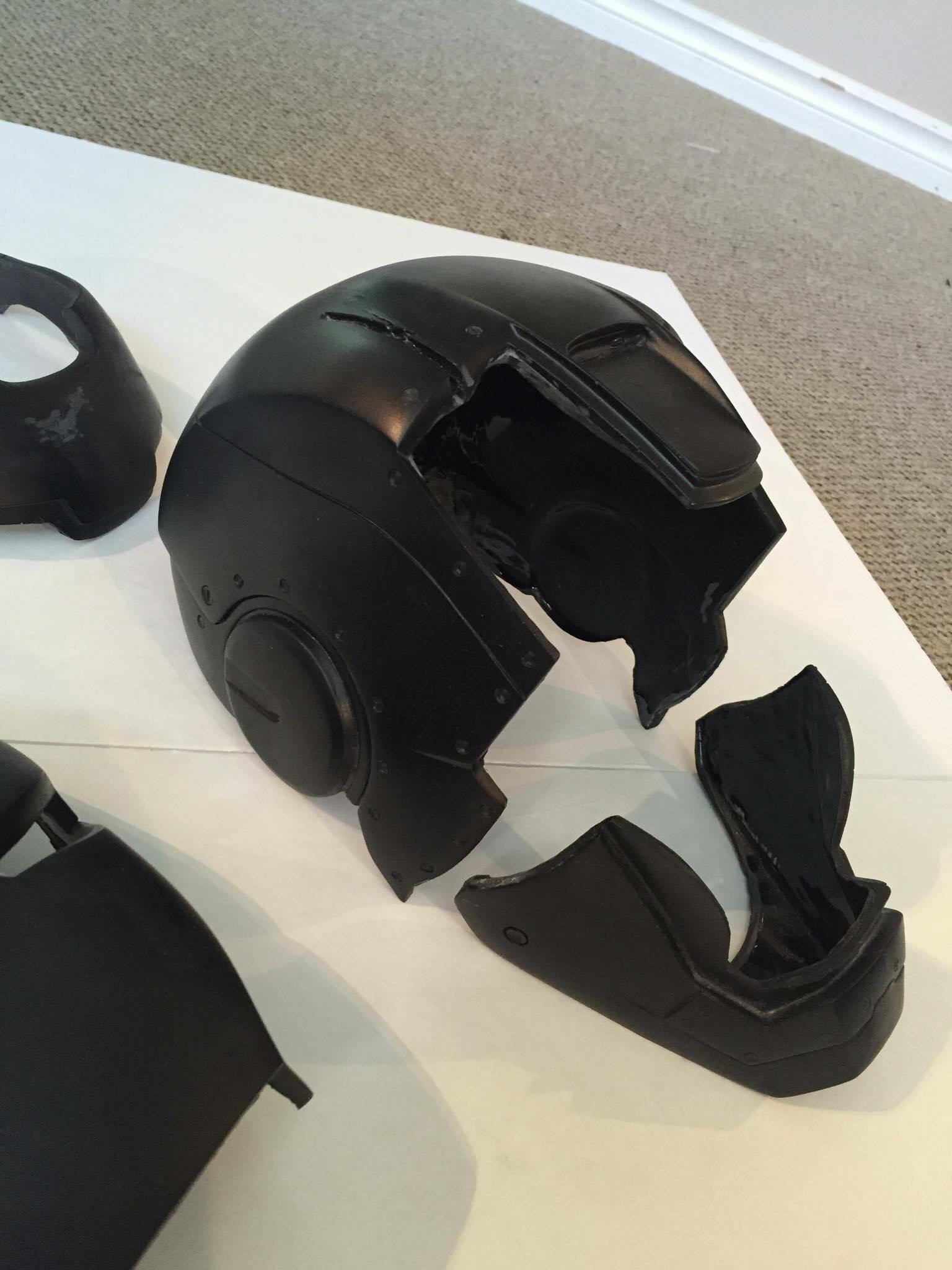

Hey guys.. I recently picked up a heavily flawed "C-Grade" casting of a MK. III Iron Man helmet, and figured I'd use it for a super heavily battle damaged look. This was just a "for fun" project and man.. It was fun!

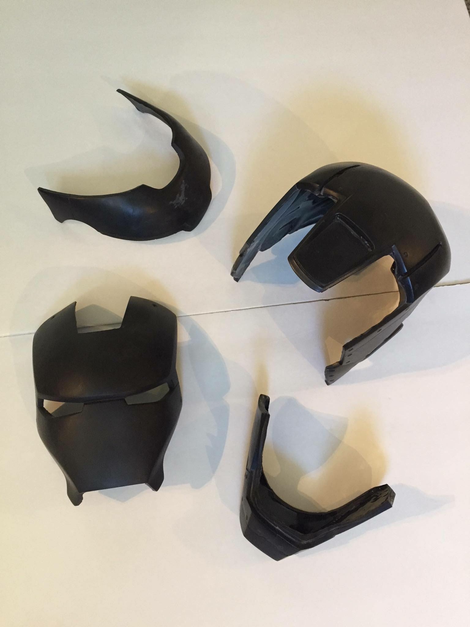

None of the pieces fit together correctly, and the thickness of the Onyx varied from a 1/16th of an inch to about 1/2 thick in places. It took a lot of work to even get it all together.. Once it was close enough, I glued it together and did a quick and dirty fiberglass job.

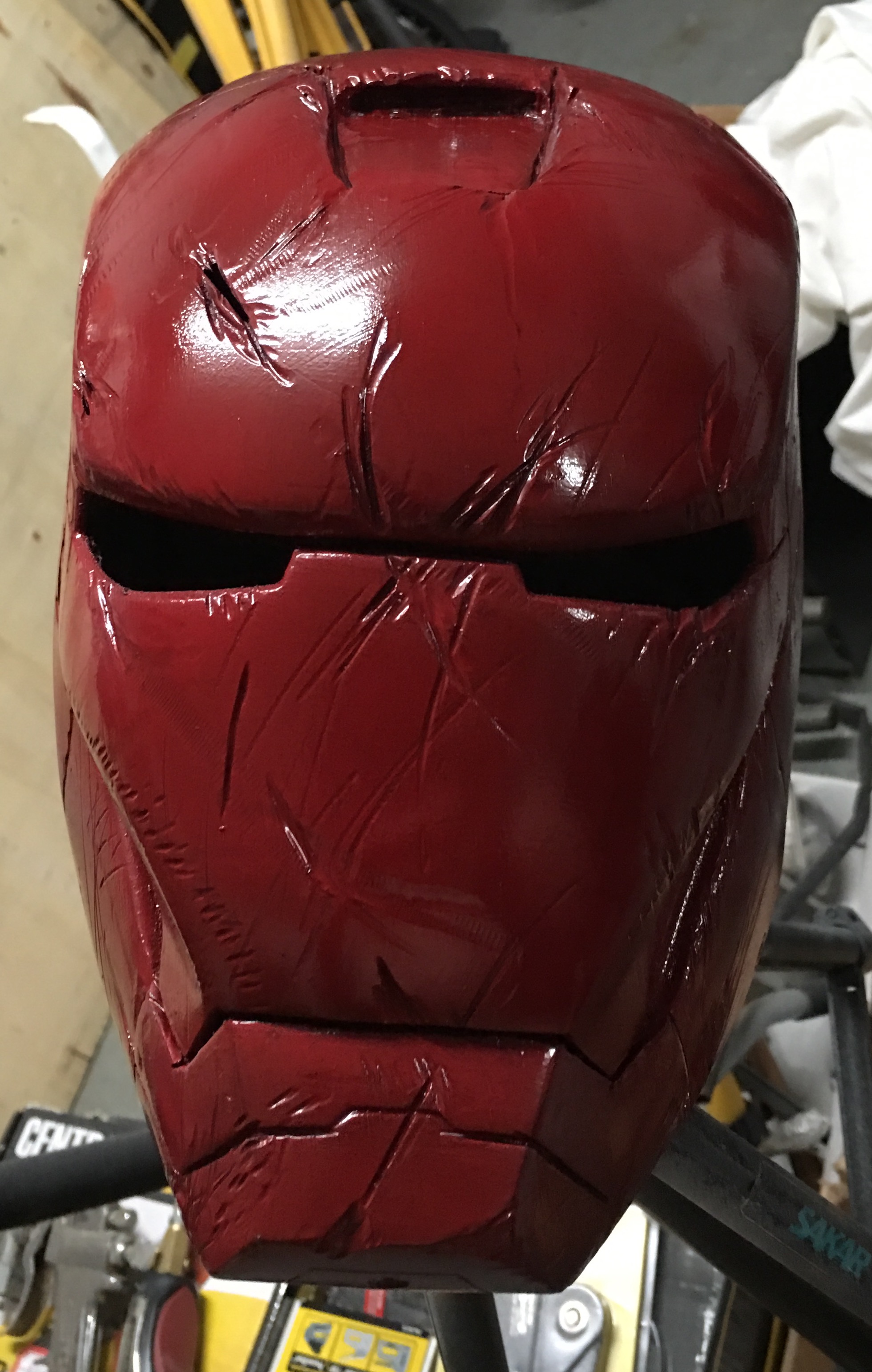

Step one was to sand the helmet. I started at about 100 grit to even out the surface.. I then moved onto 220, then 340.. I think. Somewhere around there. I added the battle damage before painting, but if I were to do this again, I'd probably finish the helmet first and then battle damage it.
I then used Bulldog Adhesion promoter to base out the helmet and then I used a filler primer. Once primed I wet sanded with a bit of 400 grit sand paper and I then laid down the base coat.
The red used was Nissan Merlot Pearl, with a little bit of candy red sprayed on top for variation. I then used a high gloss automotive clear coat over the whole helmet.

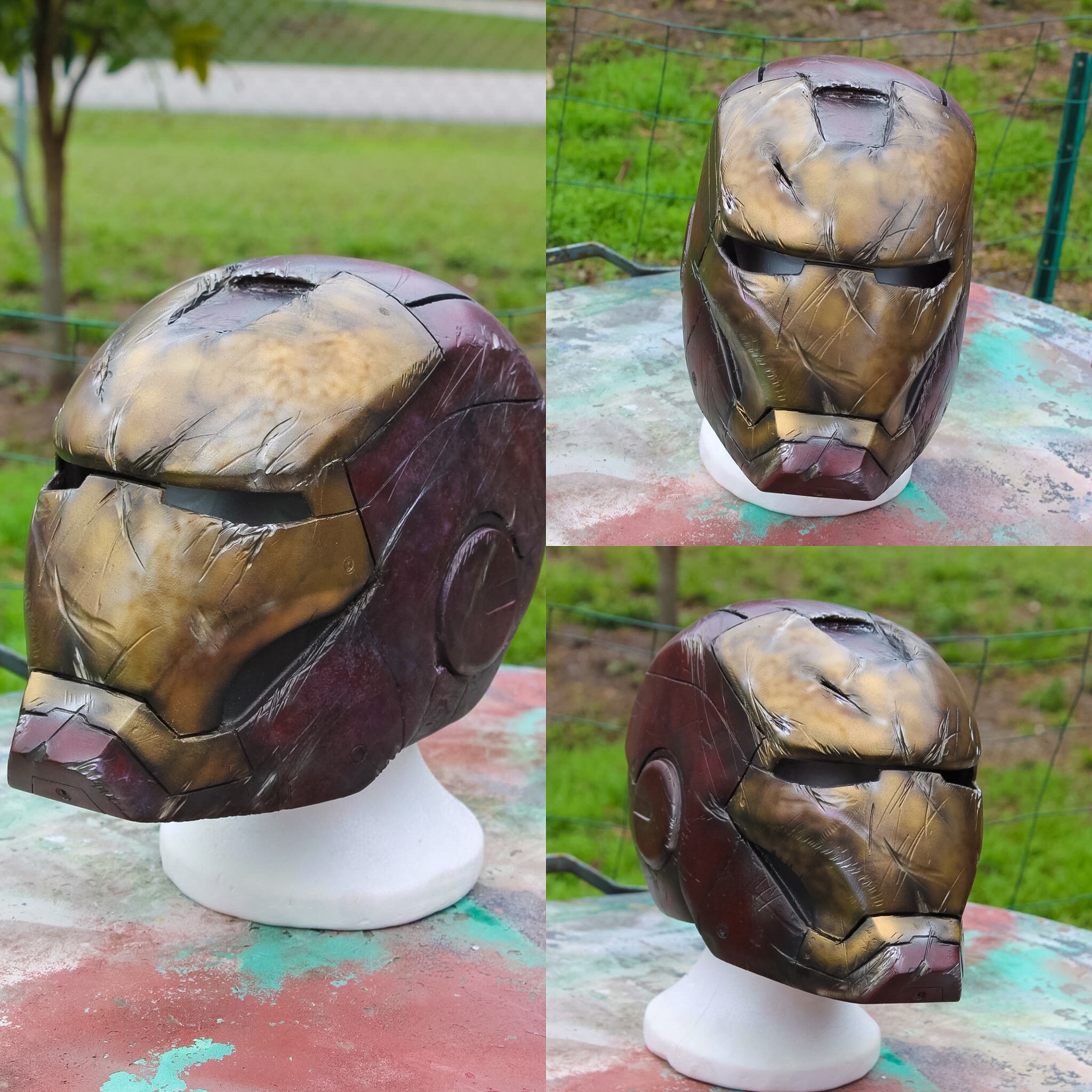

I let the helmet dry over night, and then moved onto the gold. I used Alclad IIs Polished Brass. If you haven't tried it, gloss red makes a fantastic undercoat for gold. It gives it a beautiful shine and depth.
I then used a variety of tones and paints to "battle damage" the helmet. Shrapnel for the silver tones, Tim Gore's Bloodline for the rest.
