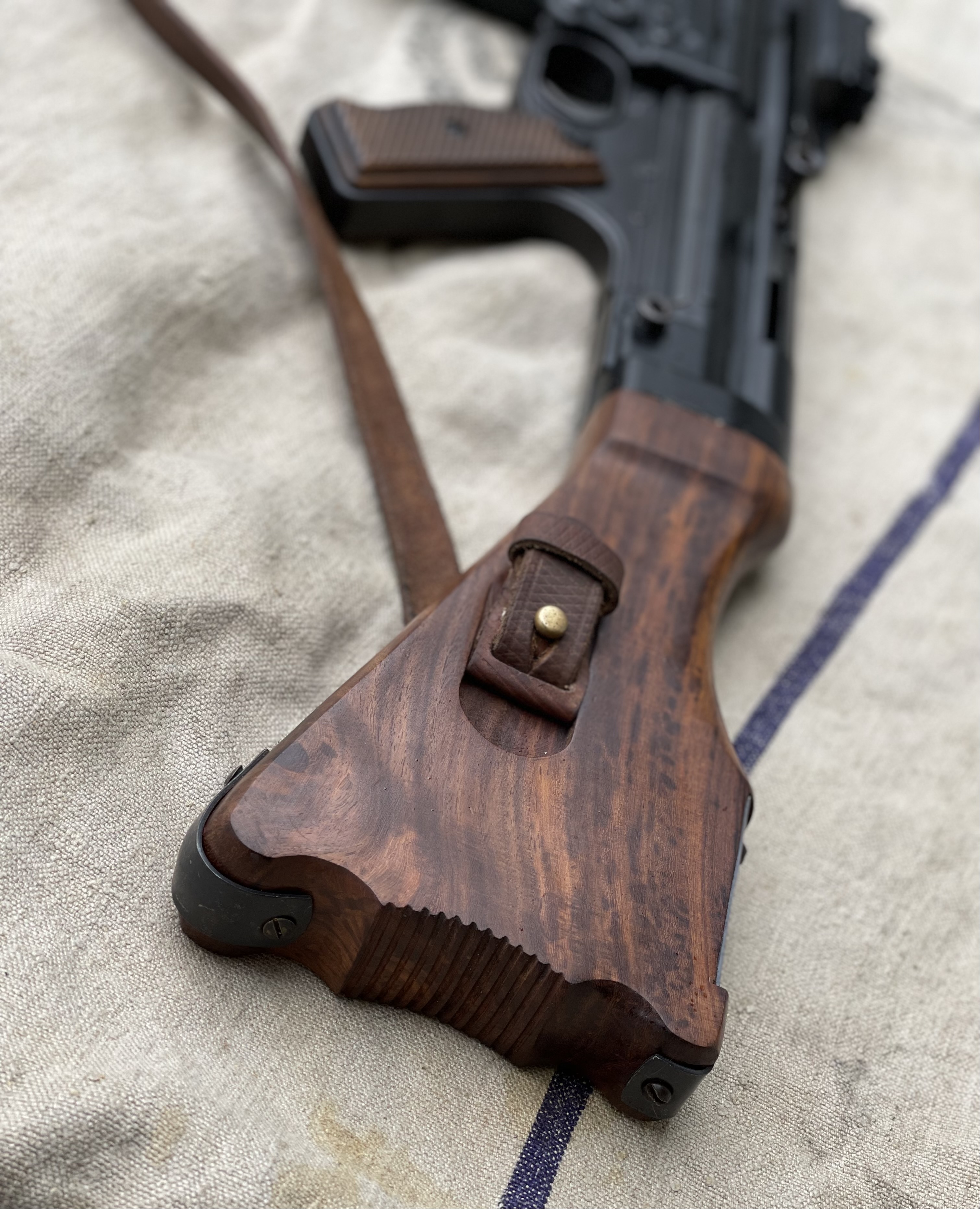

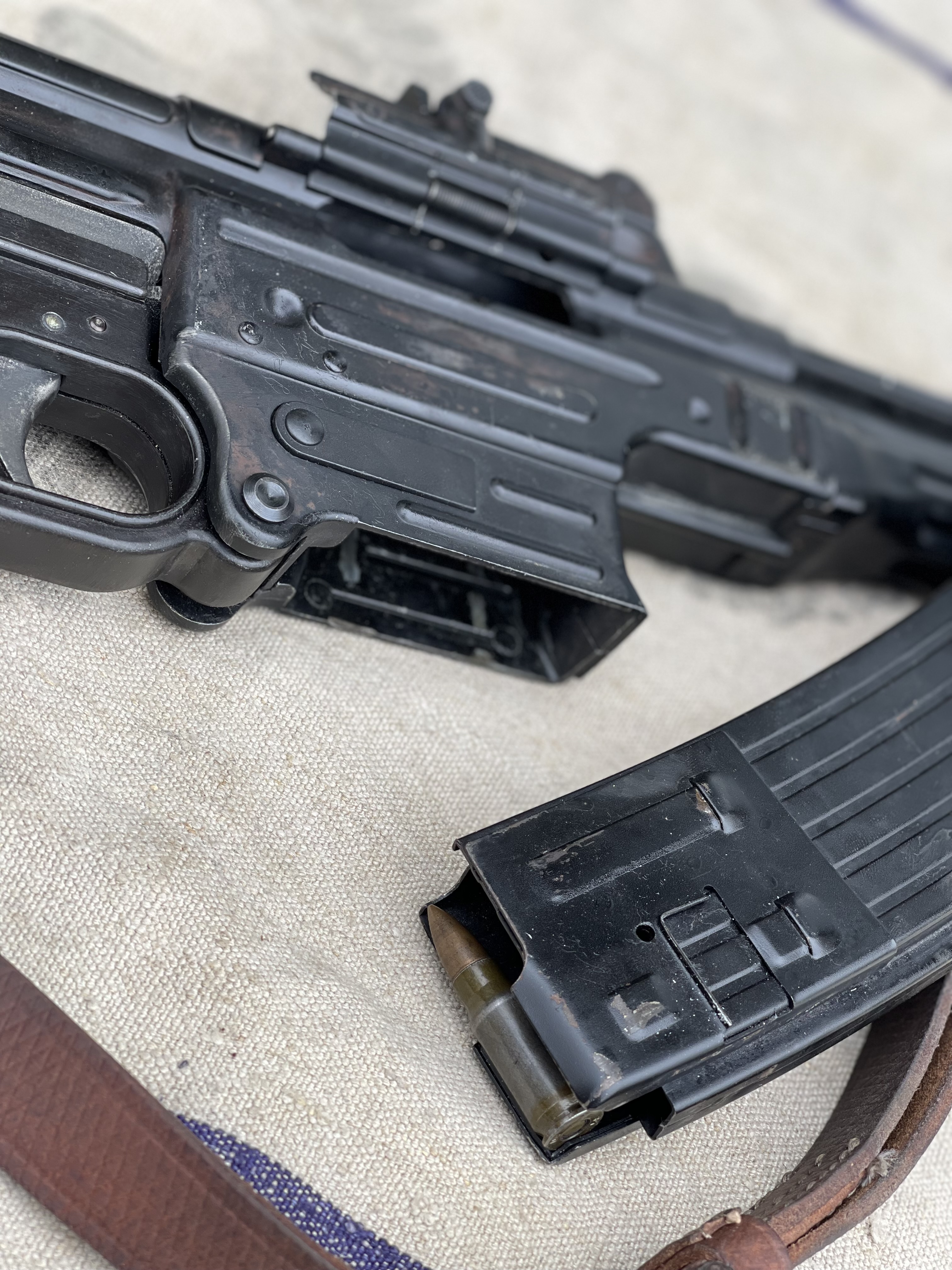

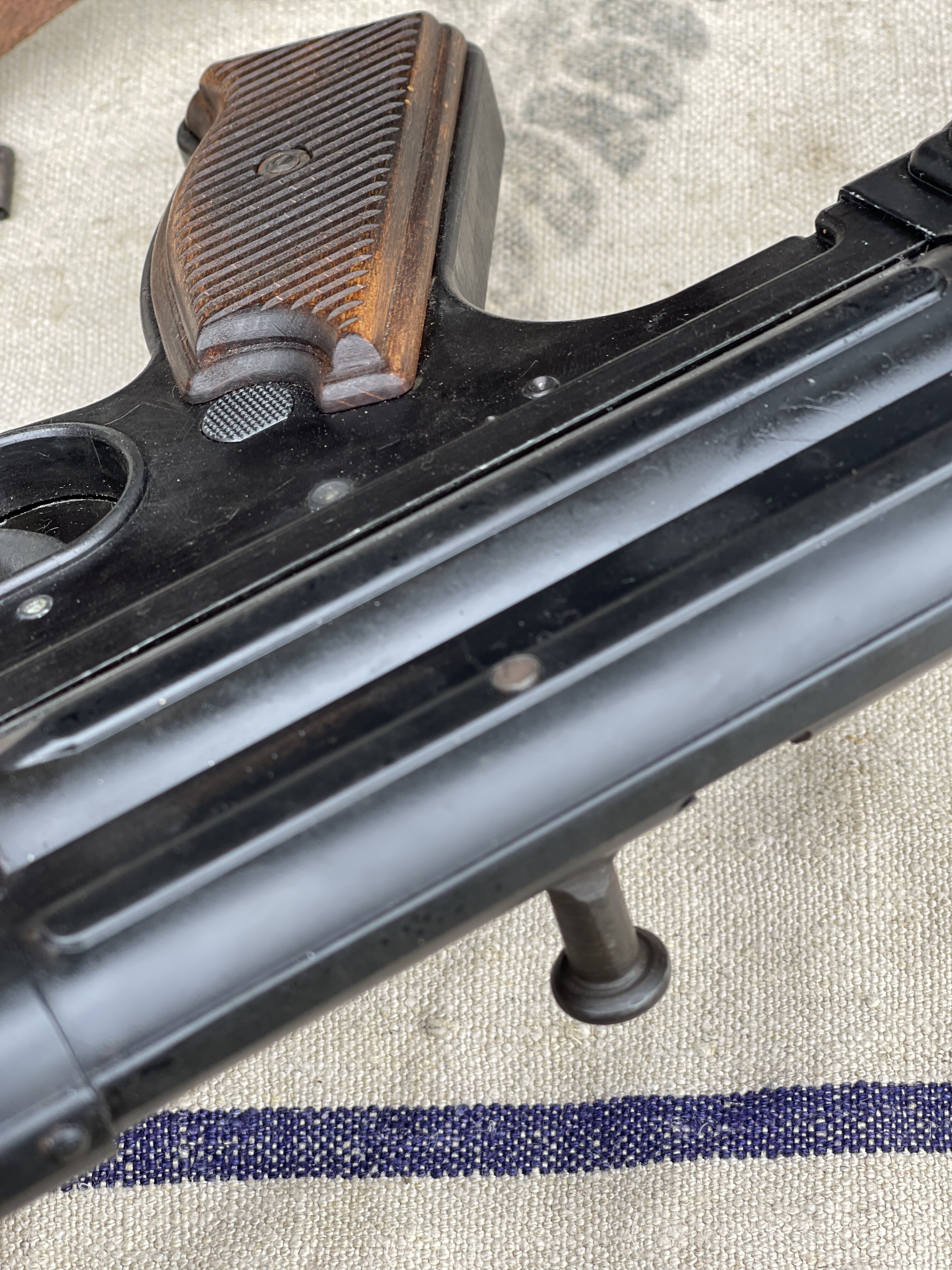

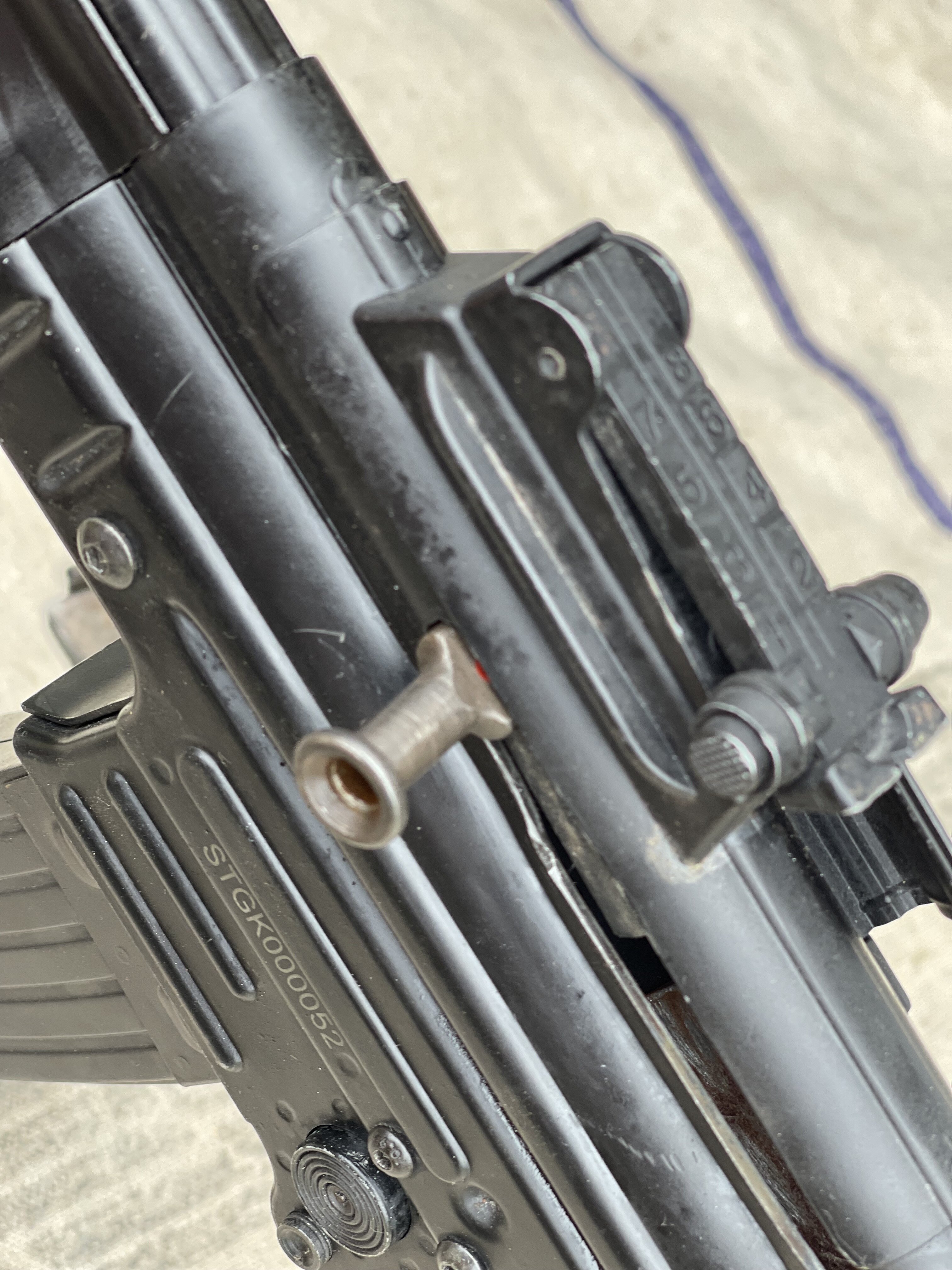

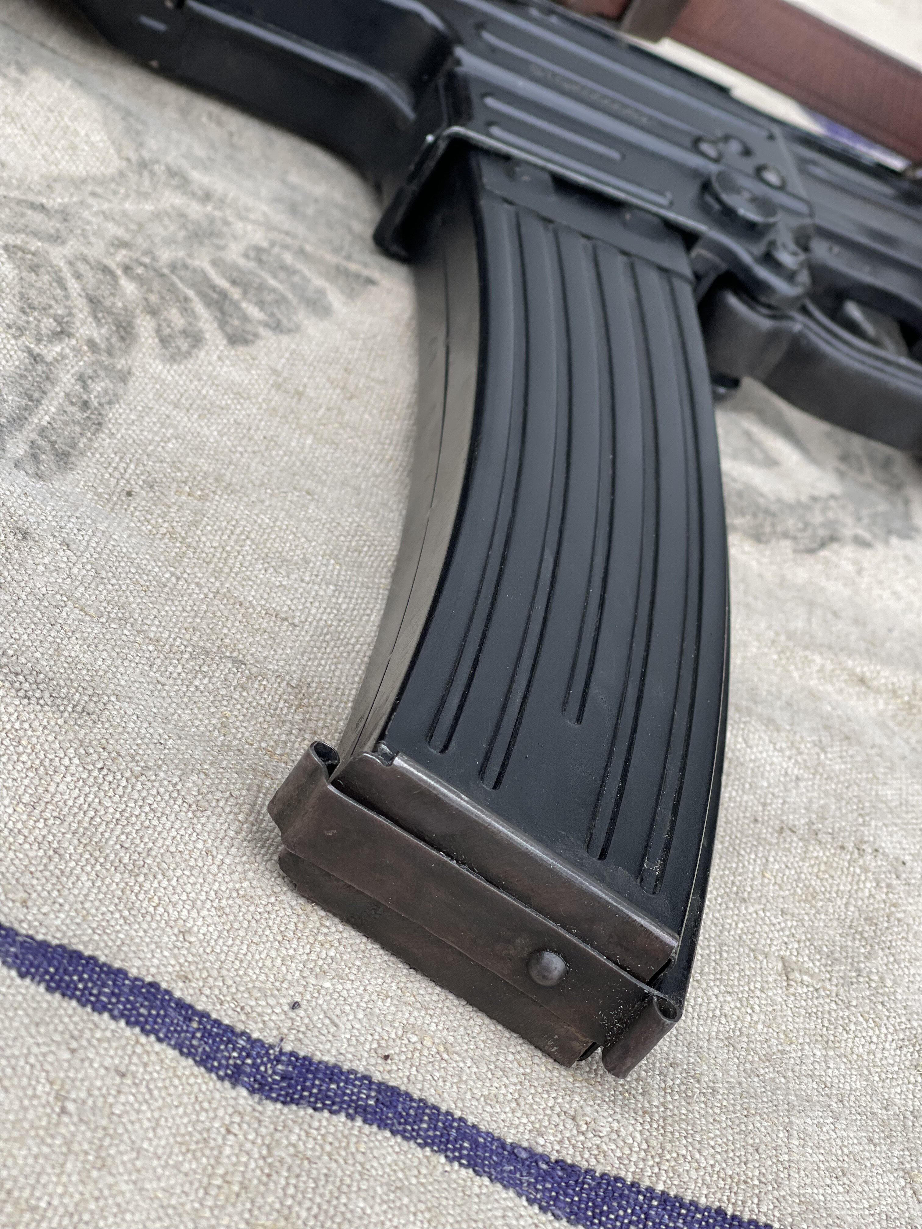

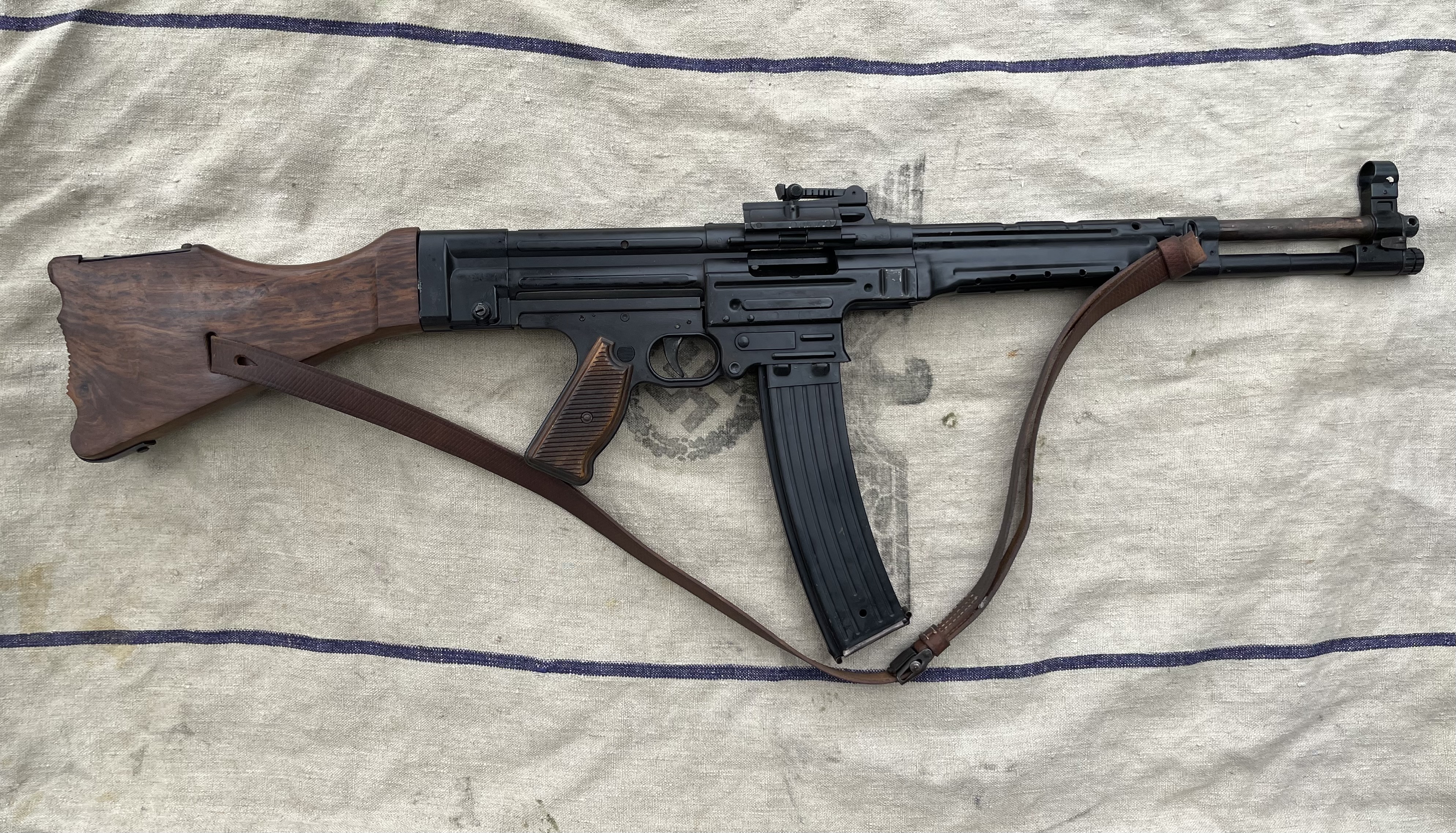

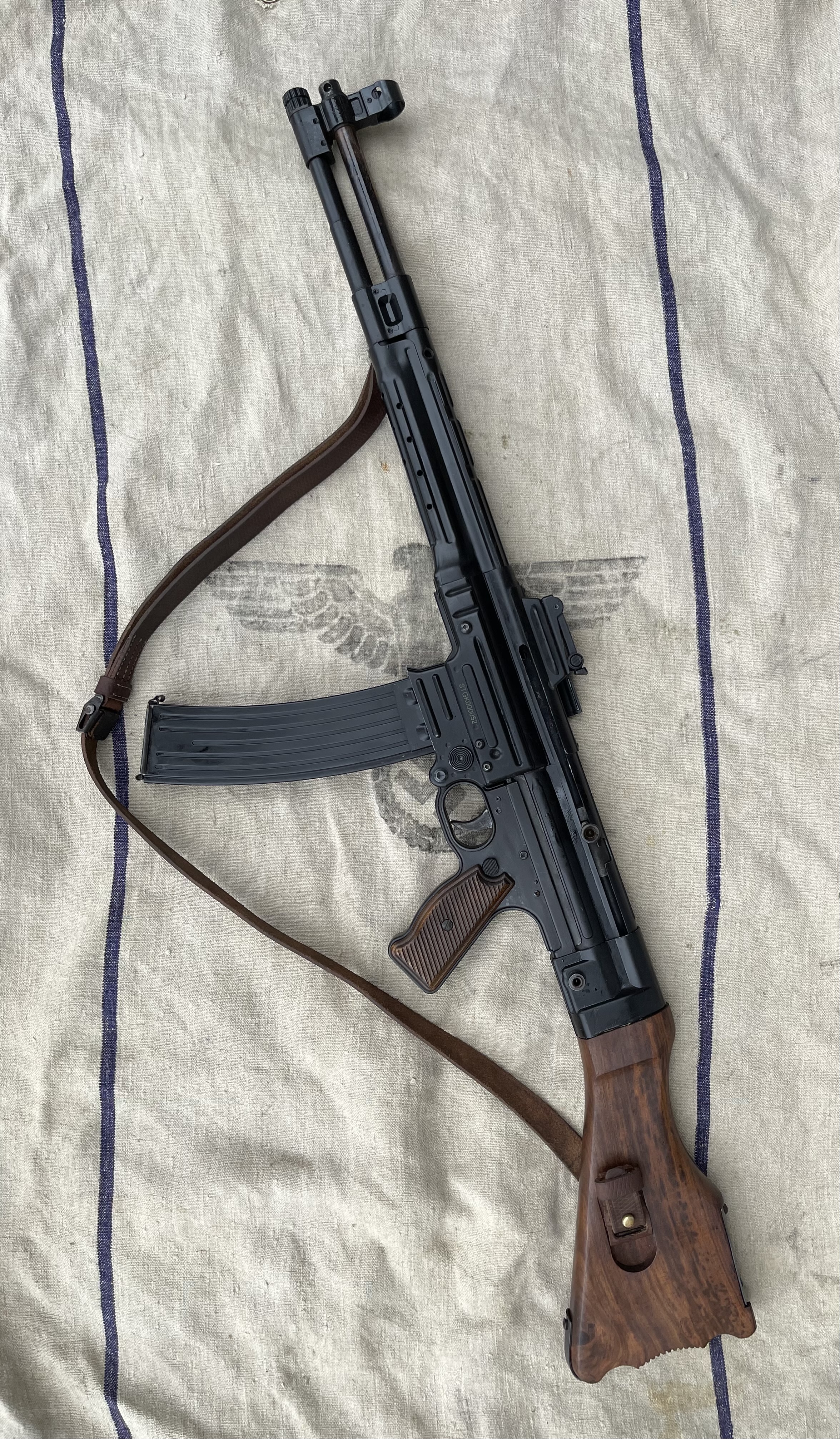

I just finished my custom MKB42(H) made from a AMG MP44, I got the front sight assemly, fire selector, lower receiver with wood panels from Shoei

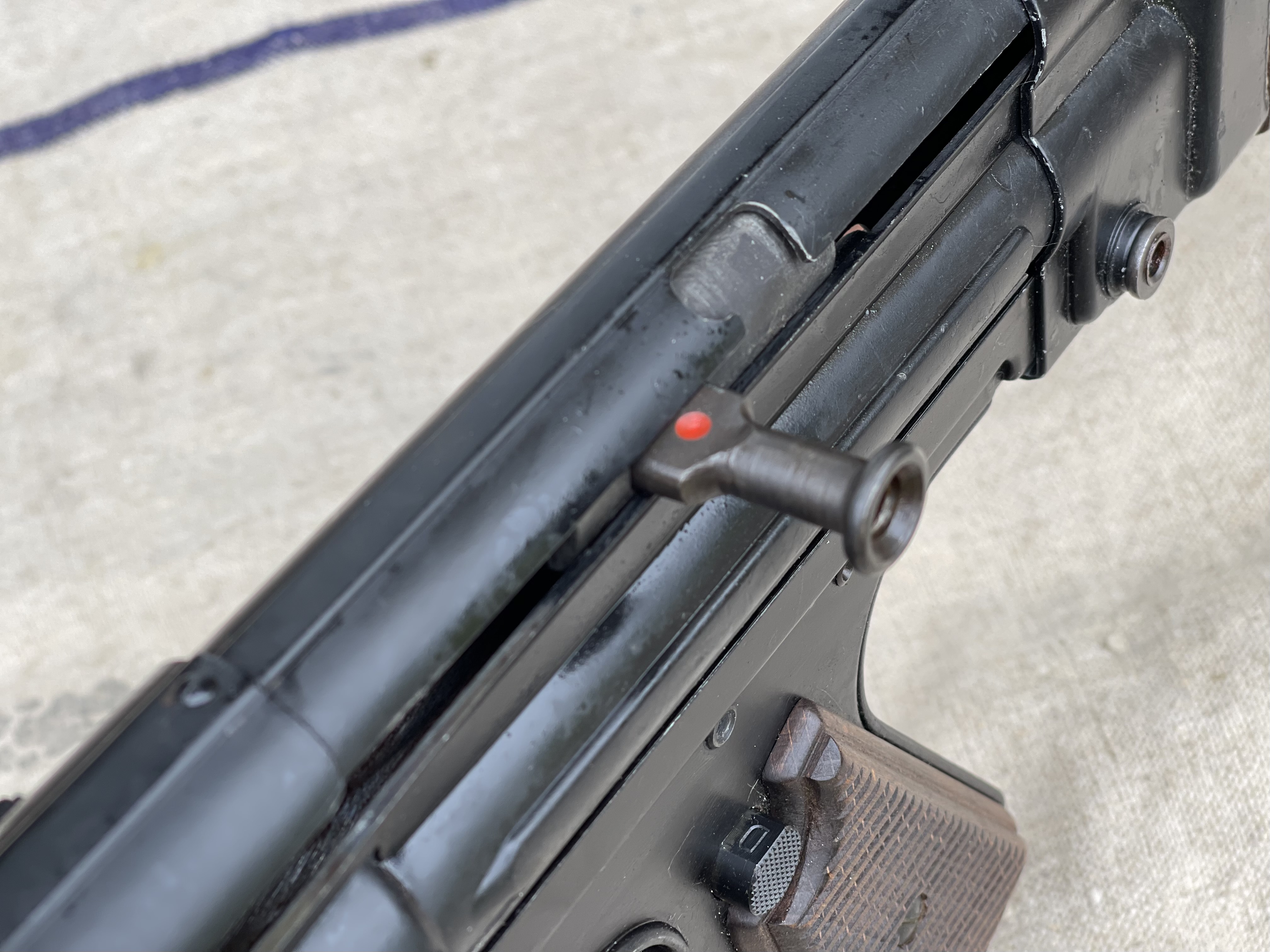

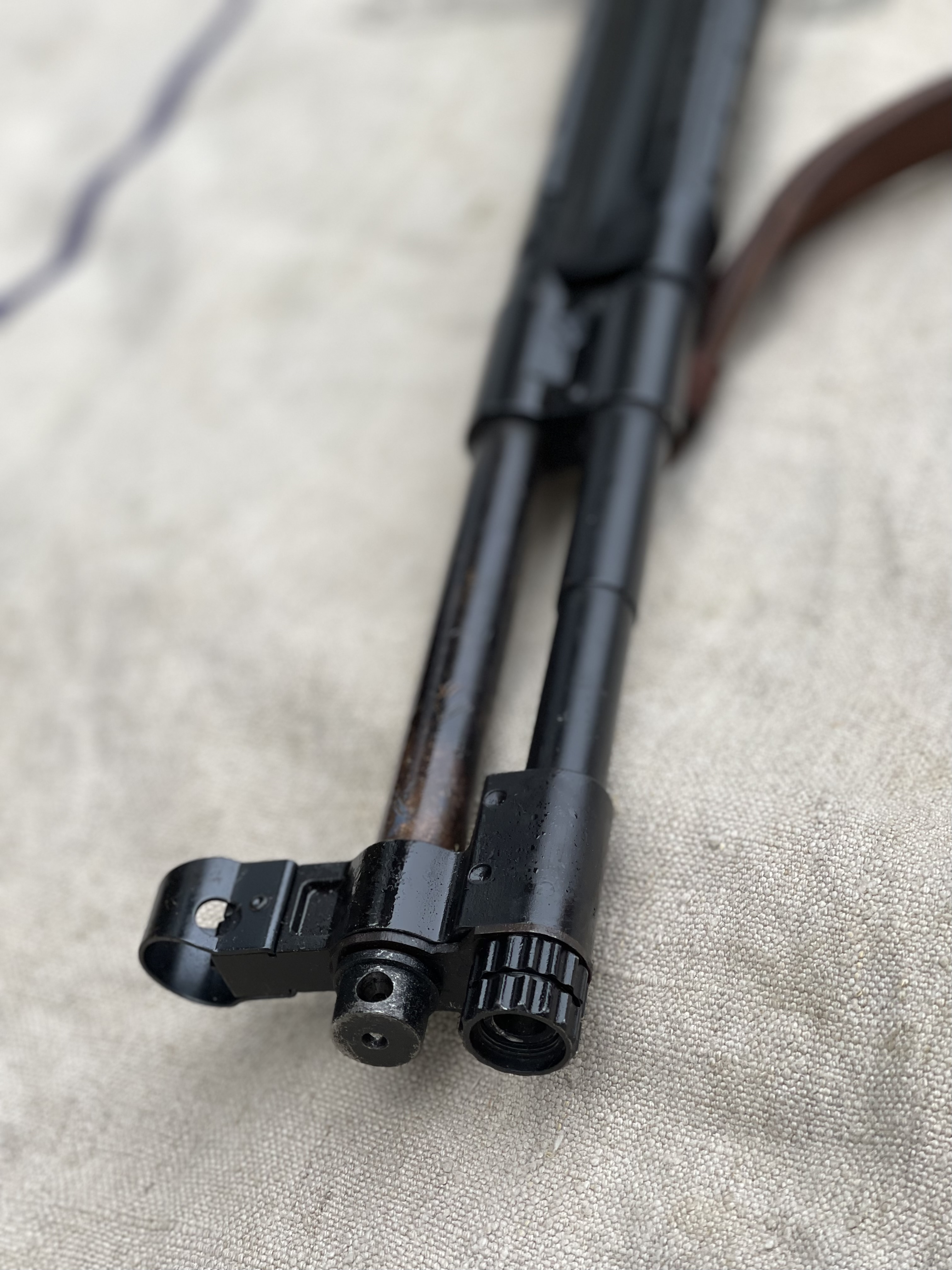

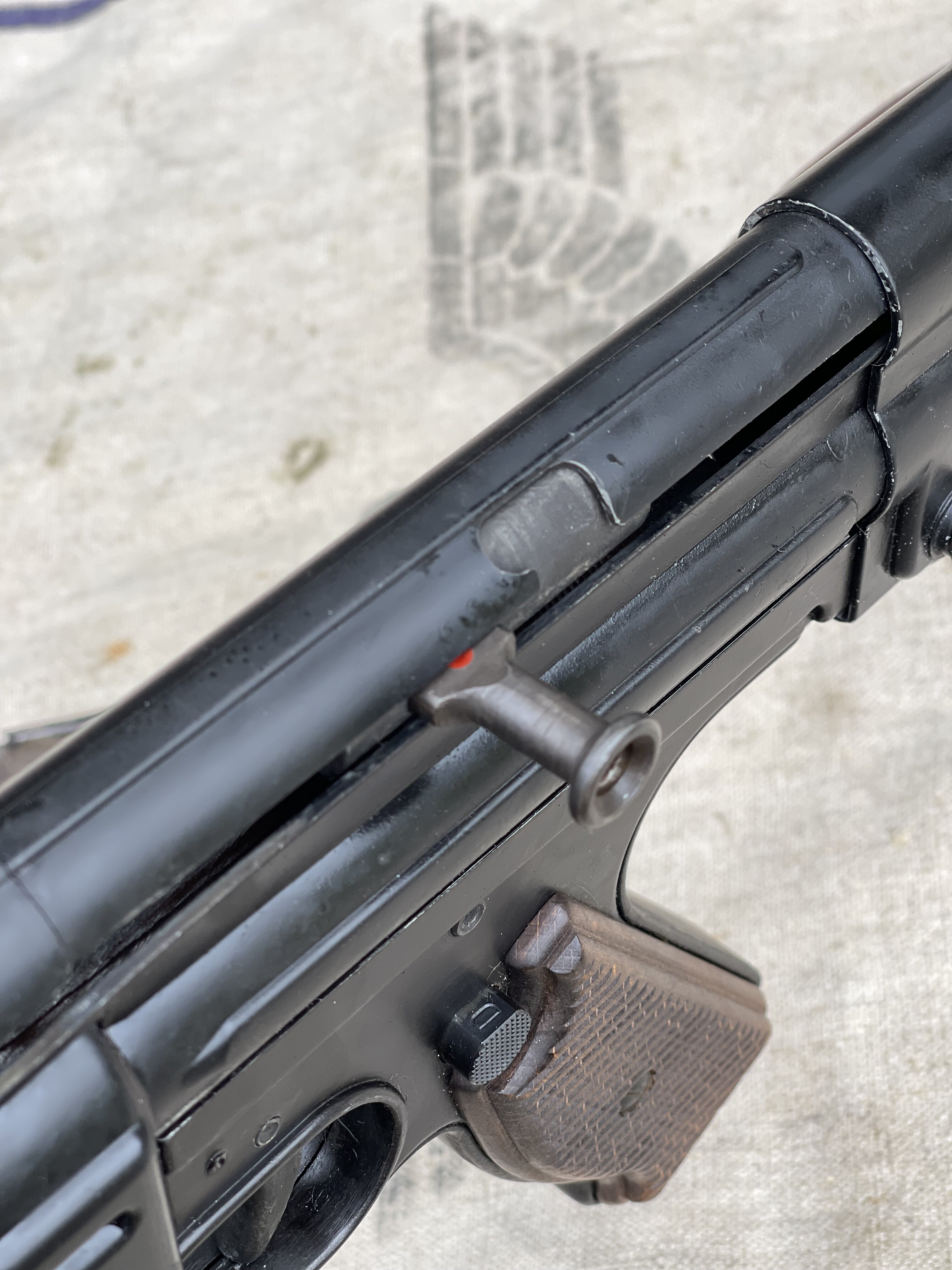

I made the front gas plug, grenade launcher tab, the tube over the barrel, modified the AMG magazine floor plate, trigger, chocking handle and modified the upper receiver so that the cocking handle would go further forward and drilled a hole for the chocking handle to push into, also made a hole further back to be able to push it in there to
Also I hade to make the «J» shaped slot for the cocking handle to lock back in the safe position
The upper receiver had a big gap between the lower reciever so I had to make a tube that fit to fill in the gap
The stock I bought from Epic militaria and replaced the philips head screws for the correct domed slotted screws
I did not bother making the one piece front sling attachment but maybe in the future, I have also been thinking about making a fake bolt and gas piston to make it heavier and look more realistic
Hope you guys like it!
