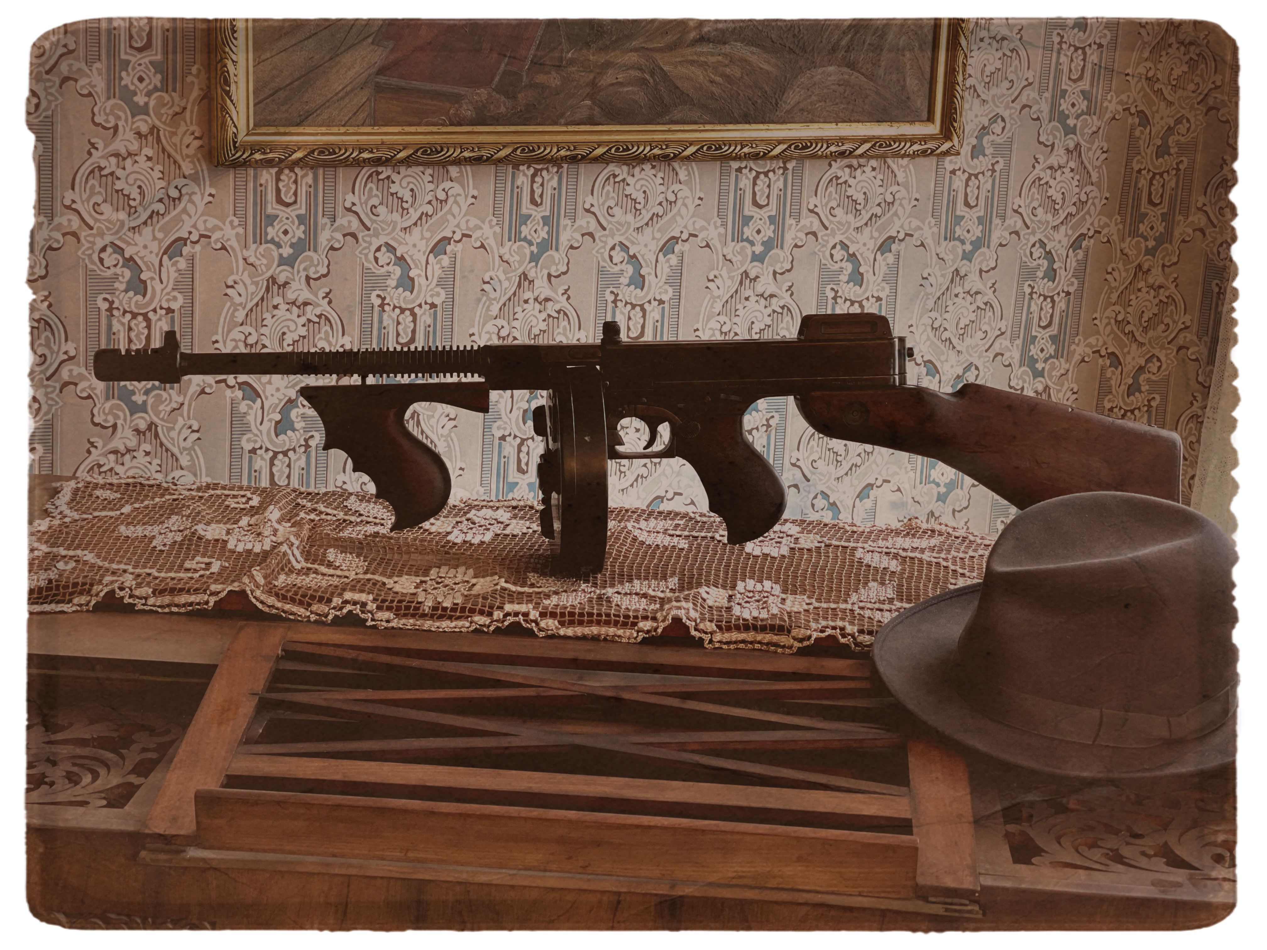

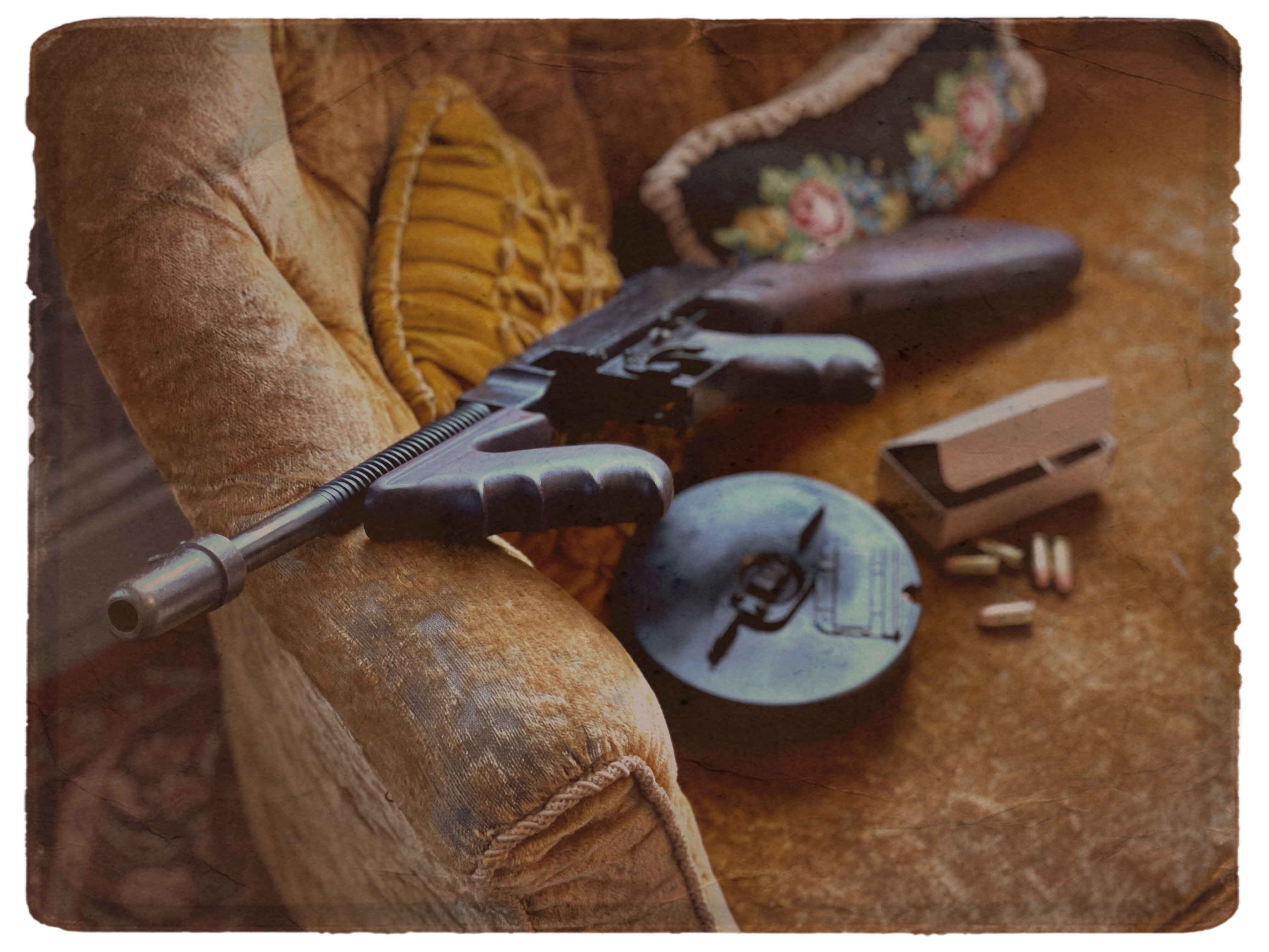

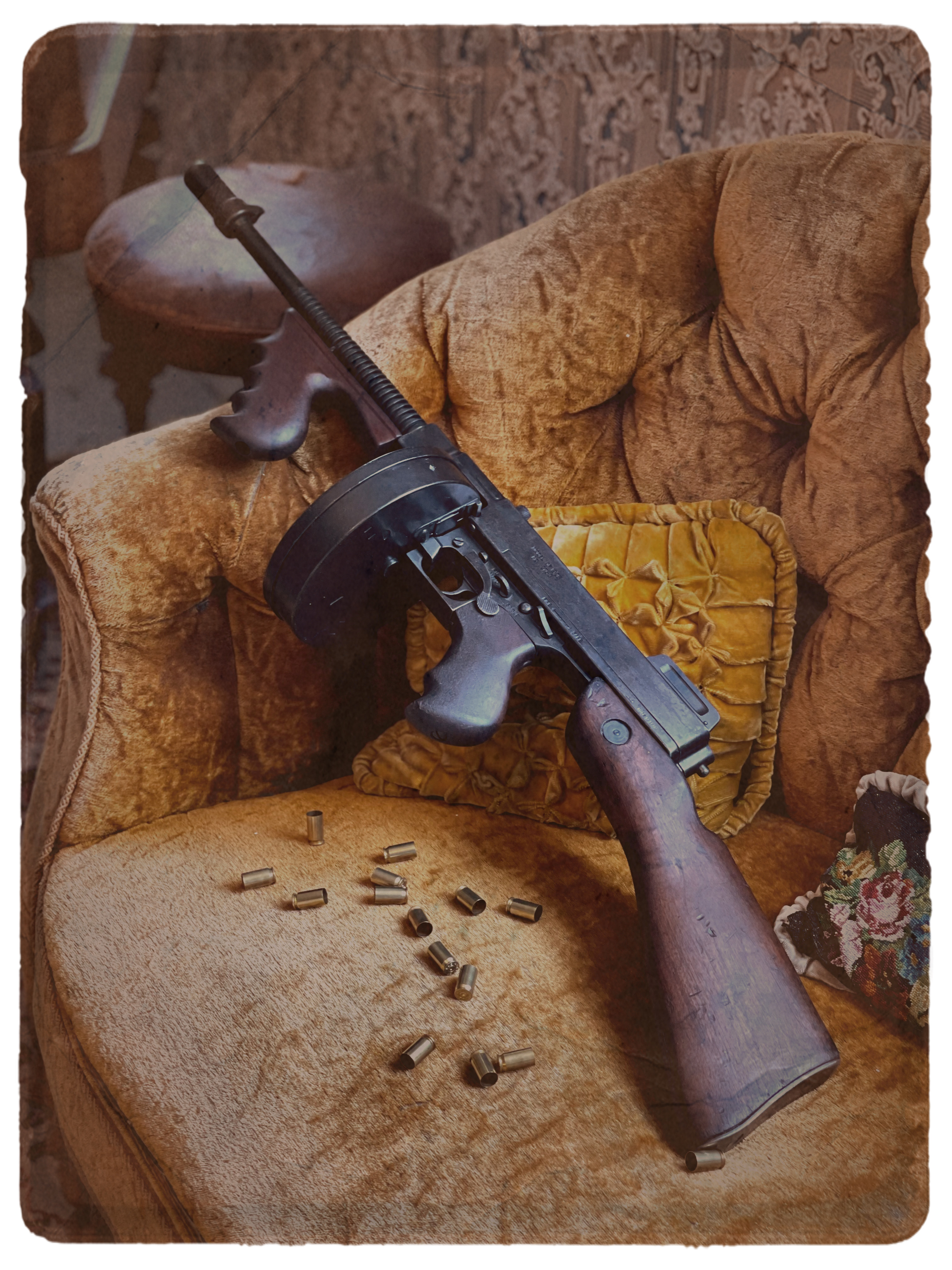

Just finished my Thompson M1921/1928 sub machine gun, based on a Denix copy with original walnut wood stock and pistolgrips, Cutts compensator, Lyman rear sight, fire control switch, safety switch and pivot spring

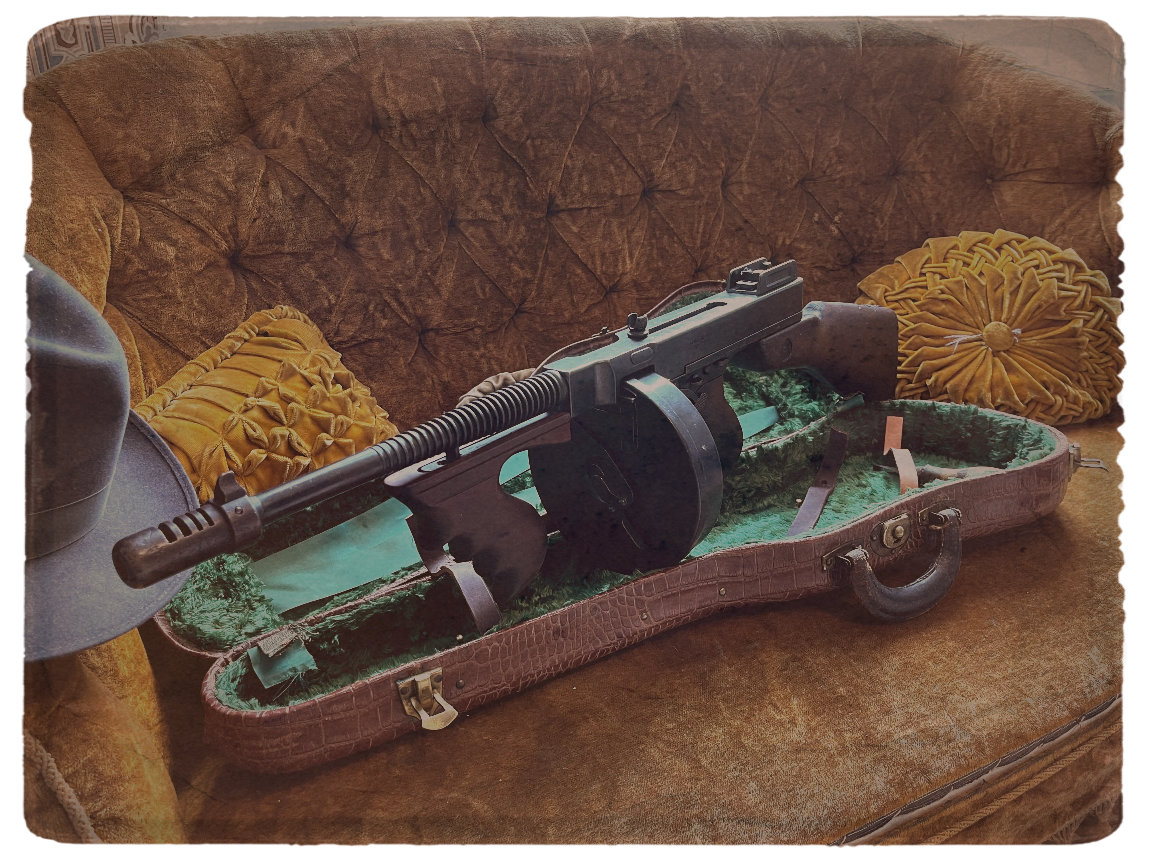

Chicago made vintage leather covered violin case modified for the Thompson with green velvet interior, dummy .45 ACP rounds and reproduction cartridge boxes
Featured in countless movies and tv shows including Public Enemies, The untouchables, Dick Tracy, Boardwalk Empire, The Godfather and the list goes on
Hope you guys like it!
Outstanding! Great display and thanks for sharing it. What technique did you use to weather the metal?

Can you post any dimensions your Tommy gun and violin case? I have a real (modern Auto Ordinance) Thompson and have been playing with the idea of modifying a violin/viola case to carry it, but the dimensions don't seen to add up (ie, the Thompson seems like it would be too big...particularly too long...to fit in the case, even partially disassembled). I'd love to even know if this is a viable project of if I should just drop the ideal all together.

Sure, the length is about 80cm and width is about 20cm

It’s really not difficult at all but measuring is important and I have been thinking about getting som buckles to strap the parts instead of just brass studs for a more secure mounting

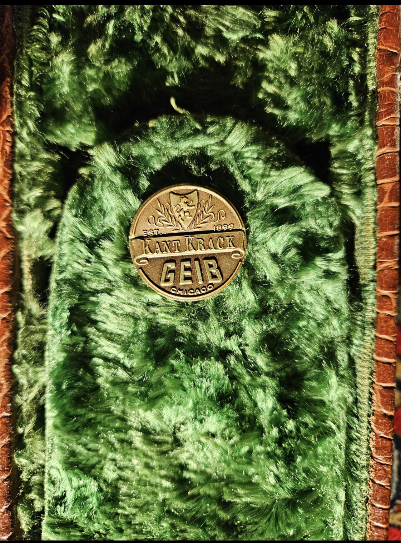

Oooh...that's right at the dimensions for mine (80cm/31.5in length, 19cm/7.5in height at the rear grip, 15.25cm/6in at the front grip). Are those exterior or interior measurements? That would be TIGHT so I'm curious on how much play there would be. I'm also curious on any manufacturer marks on the case so I could try to match it up and find something similar...absolutely love the old look of yours and how it fits the use.

I see so pretty close yours too then, yes those are the exterior measurements
My replica is pretty much spot on the original Thompson and if fits very well I must say

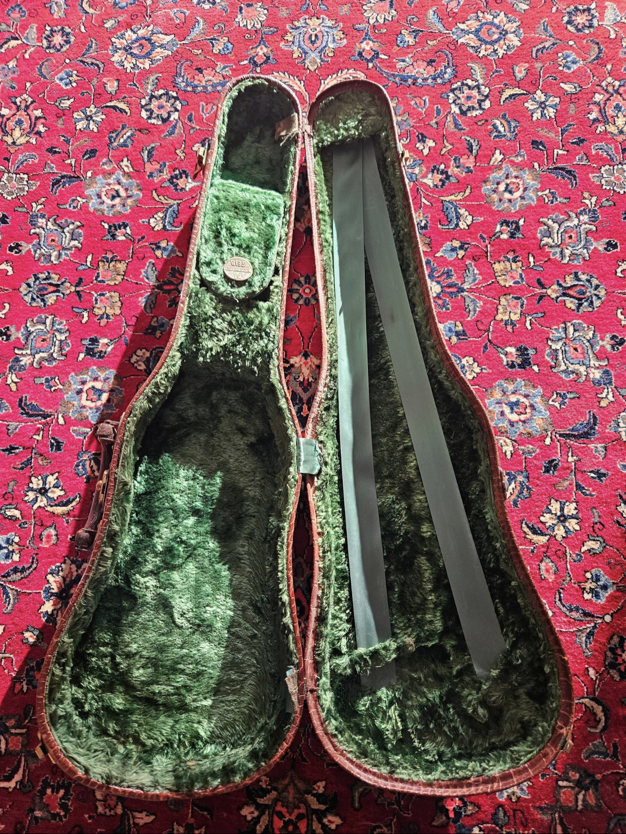

Here is a manufacture label and the case before converting it
