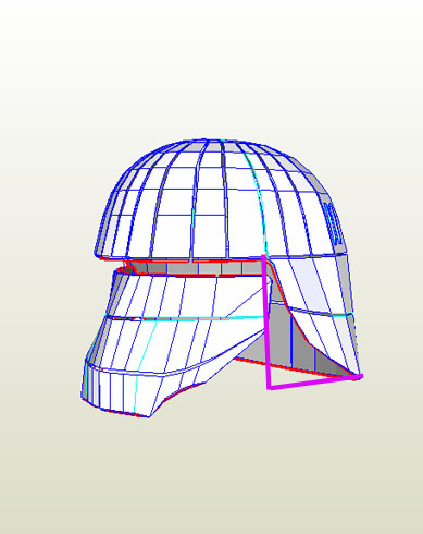

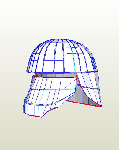

The inspiration started with finding this silver faceless mask (http://www.partycity.com/product/adult+no+face+chrome+mask.do?sortby=ourPicks&page=7&navSet=350293) at Party City, which I figured this would be a perfect base. I needed a helmet to pair with it, so I went looking for a pep file or something to start me off. I ended up finding a First Order Snowtrooper helmet file that was close to what I wanted.
I did a few quick paper builds to nail down the size I wanted, and then made a few manual adjustments.
I added a little extra on the sides to wrap around my face more and conceal the sides of the face mask,

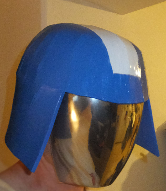

I built the helmet out of 5mm craft foam. I don't love all the visible edges and in a normal build I would have redone this, but since I'm under a time crunch it'll have to do.
I smoothed over the cracks with Dap Kwik Seal which helped a little and gave it a glossy paint job.
Not my best work as I would have preferred it be a bit more sleek and the edges less visible, but it works well with the face mask and I think it *looks* like Cobra Commander.

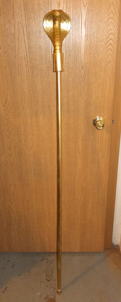

The Staff
I decided I wanted a cool prop, and I know in many of the incarnations of the Commander, he has a staff with a cobra head on top. I thought this was a cool item so I set out to make one of my own. First, I had to decide how I wanted it to look. Since there is no true 'canon' version of this, I took elements from several I liked and came up with my own design. This one (http://loserville.us/~chad_ghost/ccjvc.jpg) and this Sideshow scepter (http://4.bp.blogspot.com/-A9wJlwkYa.../s1600/Sideshow_Diorama_CobraCommander_11.jpg)

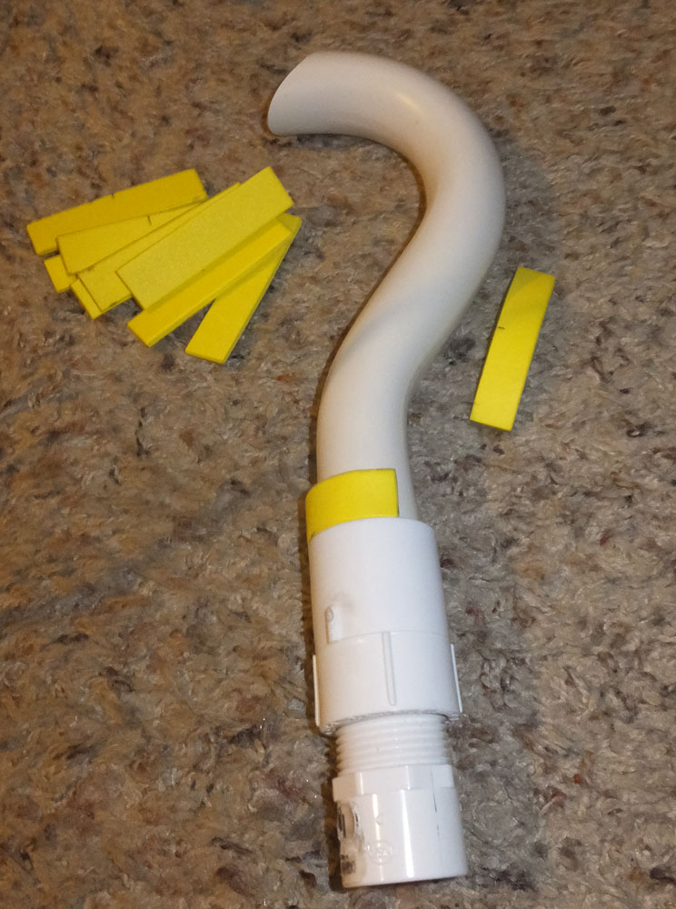

I decided I would make this out of PVC pipe and foam, as they are lightweight and easy to work with. I started with a Schedule 40 Pressure PVC 3/4" Condensate P-Trap, which was under $3 and had the exact shape I wanted for my cobra head.
I also picked a 1/2" PVC pipe as the staff (as the 3/4" pipe was a bit bulkier than I wanted) and bought all the connectors I needed to make the two fit together.

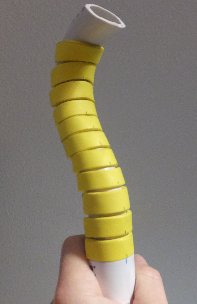

I began by cutting down the top piece a bit and cutting out foam layers from 2mm craft foam.
These would be glued down to form the 'belly' of the cobra.
After a few attempts with paper and scrap foam pieces, I settled on a shape for the cobra's back piece. I used 5mm craft foam. I also cut out a head shape as well, out of kid's floor mat foam.
I glued these pieces along the 'spine' of the P-Trap piece.

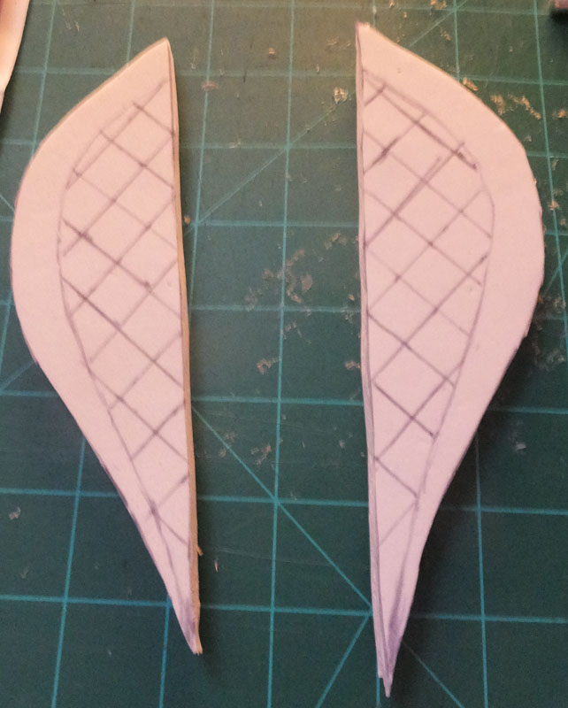

To bulk up the head, add more detail, and help hide the pipe element, I created side wing pieces for the front out of the kid's floor mat foam. I enhanced the details on the front and glued them in place.
After debating on whether I wanted a closed or open mouth, I ended up just going with the closed version as I couldn't quite get the open mouth to look how I wanted. After a few tries, I got the shape I wanted out of 3mm foam. I also added a decorative piece below the cobra head to hide the PVC joints. I made a wrap of 5mm foam, cut in lines and blasted it with heat gun to define them.
Once it was all put together, I covered it with gold spray paint and added red rhinestones to the eyes.
I'm very happy with how the staff turned out, especially since I was completely winging it!
