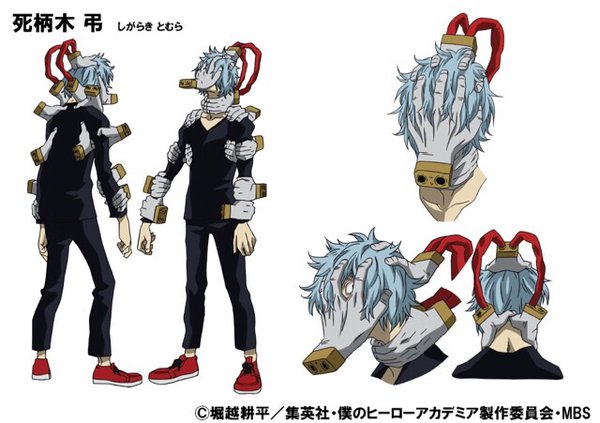

Hello all, figured this might be the best place to ask for advice in what material and process would be ideal for casting the hands for a character from this anime( Tomura Shigaraki from My Hero Academia) I intend to cosplay. The most unique and striking feature of the costume is of course the hands that cover his form, I'd like them to both be detailed but lightweight enough that the ones attached to my face and neck would not give me neck strain. I am curious what advice you all might have for tackling this part of the cosplay as I'm not quite sure where to start. I have some experience in casting plaster from a clay model, but beyond that non with resins or other materials. Ideally I'd like to use my own hands for the base instead of having to sculpt them entirely, as I think I can be fairly expressive with them and am fairly long fingered.
