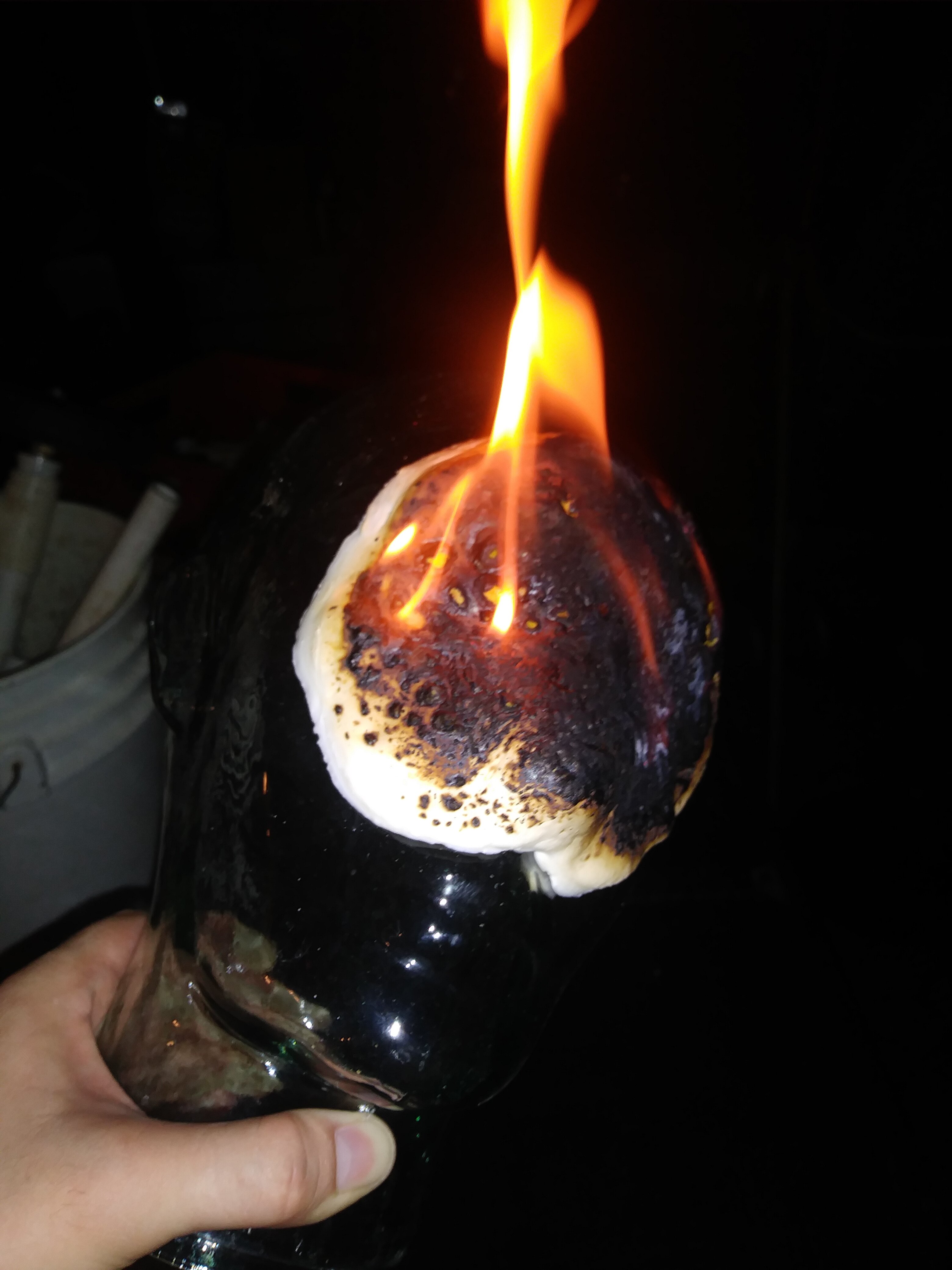

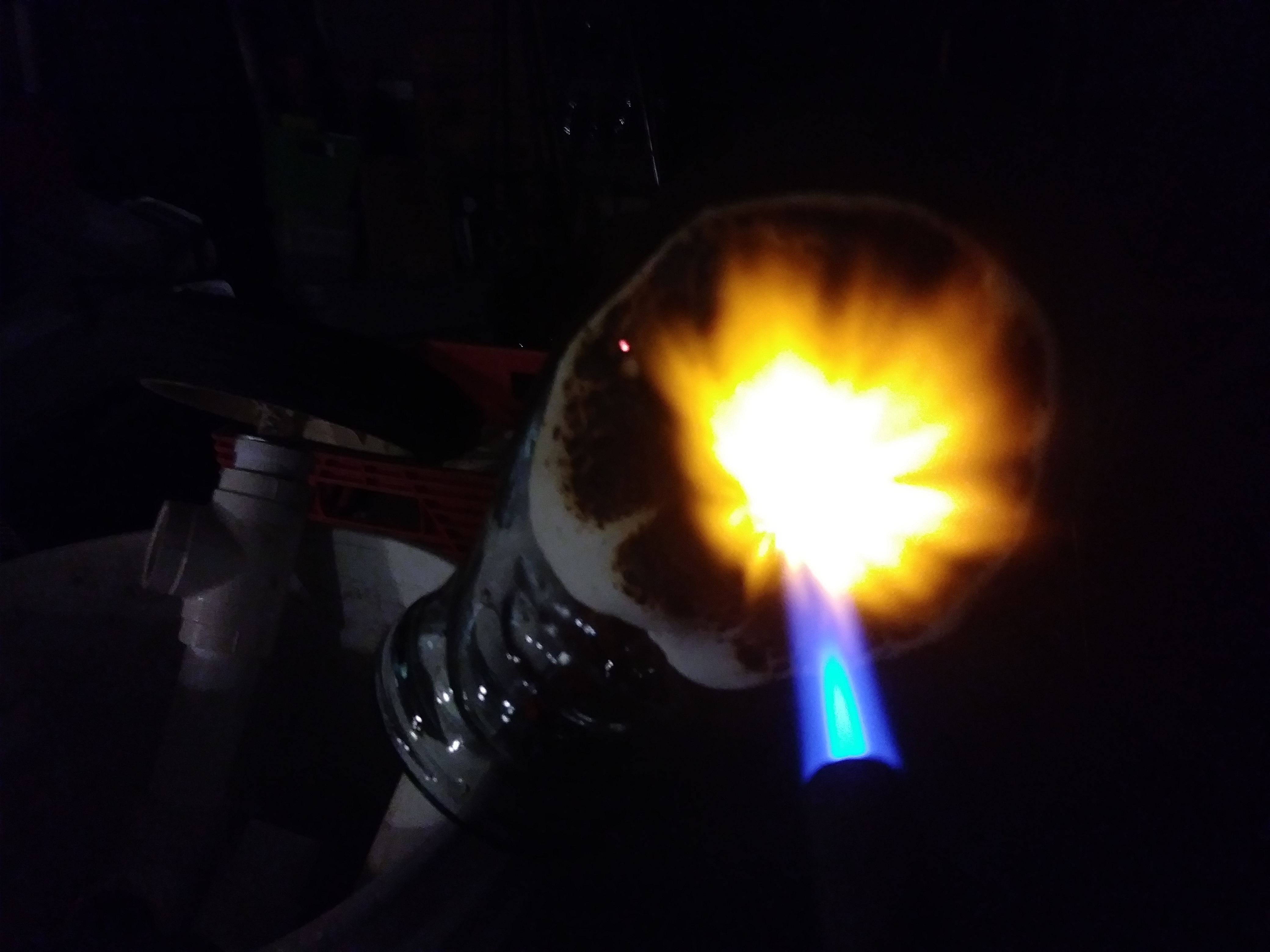

I used a material called Starlite; corn starch, baking soda and PVA Glue (Elmer's). It was developed as a flame retardant material. The mixed end product resembles clay/putty. The beauty of this material, besides you can somewhat sculpt with it, is upon applying flame (torch) to it, the immediate surface charrs up. The surface char becomes a barrier, preventing flame from burning more material below surface char. You can hold it in your hand and apply the torch you won't feel a thing. The charred Starlite resembles charred flesh too!

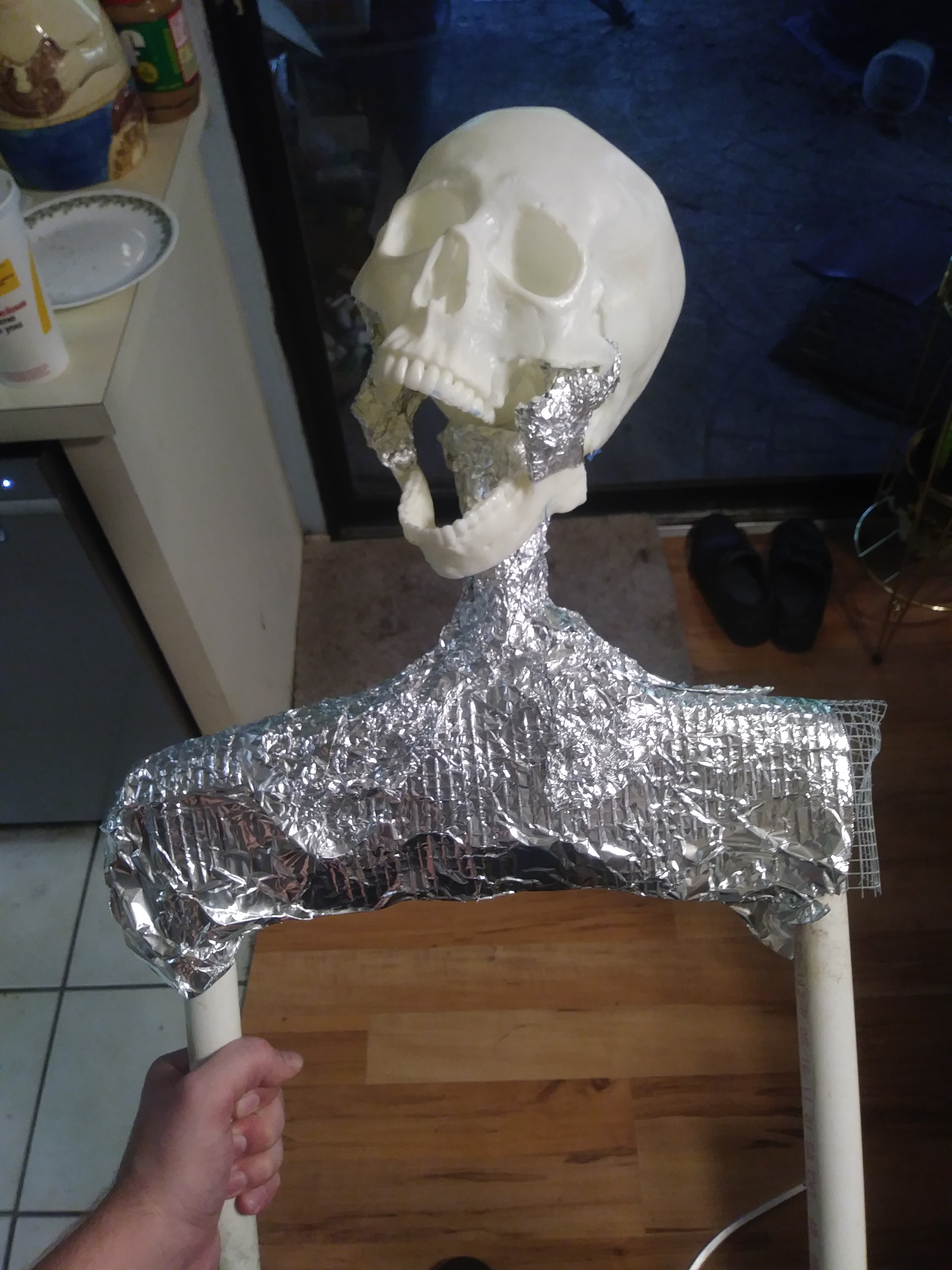

The shoulder/neck skeleton fabricated out of pvc, wood, wire mesh-essentially out of any found objects. Bulked out with aluminum foil and or wire mesh with the last layer being wardrobe.

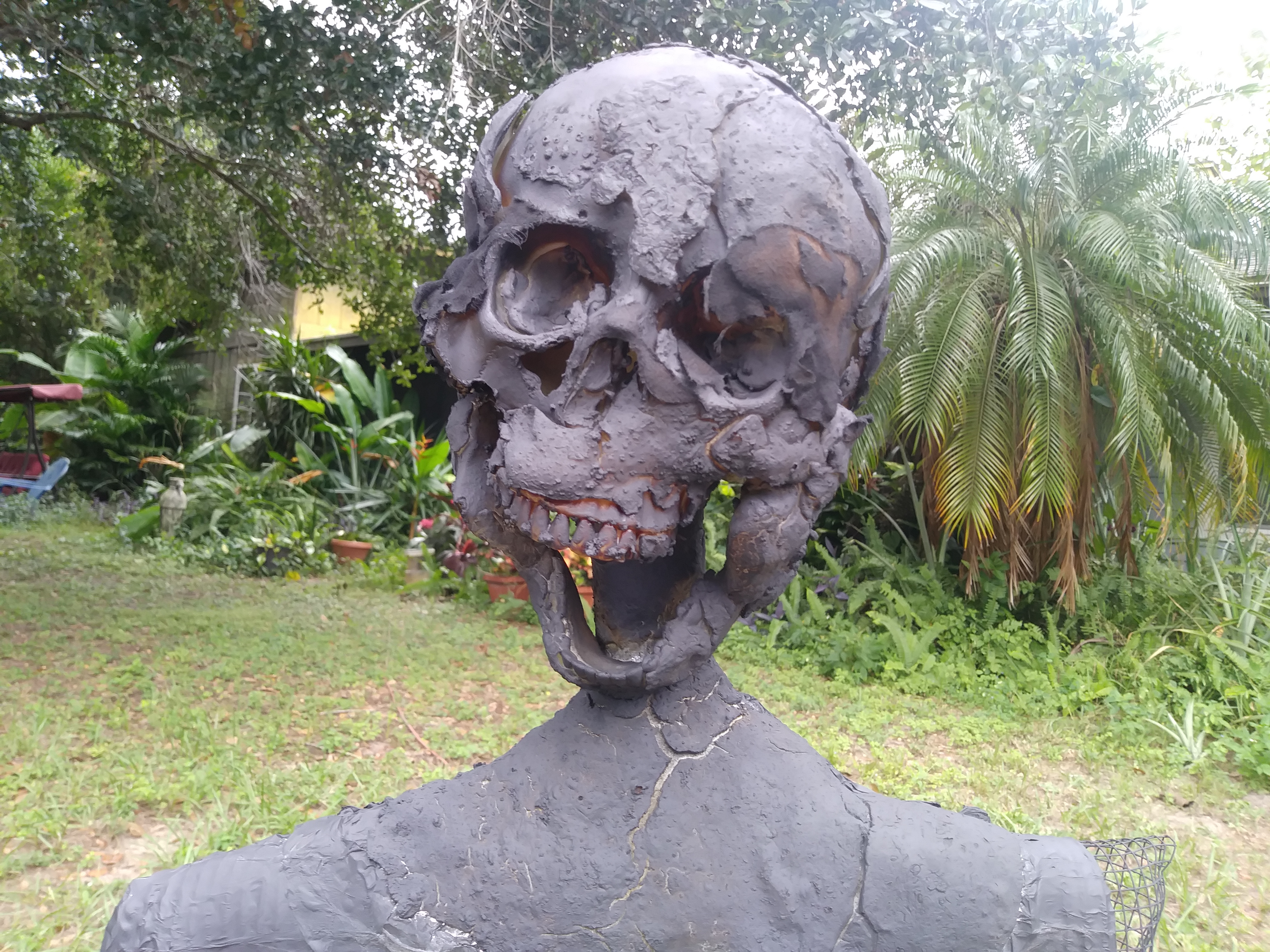

Starlite then charred with torch. Then props painted completely with a flat black grill rattle can paint. The paint adds to the char look.
Setting up for the shoot we sprinkled crushed grill charcoal throughout and applied lamp oil, grill lighter fluid to burn on the surface of props...in theory anyways. They burned to ash but we got the shot anyways.

Starlite test.
Charring Starlite surface.
Charring Starlite.

Added lamp oil or lighter fluid to charred surface. The idea was to have applied fuel burn off the surface of props but the props remain flame proof-in theory anyways.
Under structure. PVC, aluminum foil, wire mesh. Task 7 Flame Out urethane skull.
Applying Starlite to understructure.
Lightly charred Starlite.
Painted will flat black grill paint.
