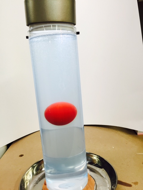

Update, So I'm almost done with this build. Here's some details.
Tube: I used a 3" extruded acrylic clear tube.

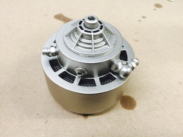

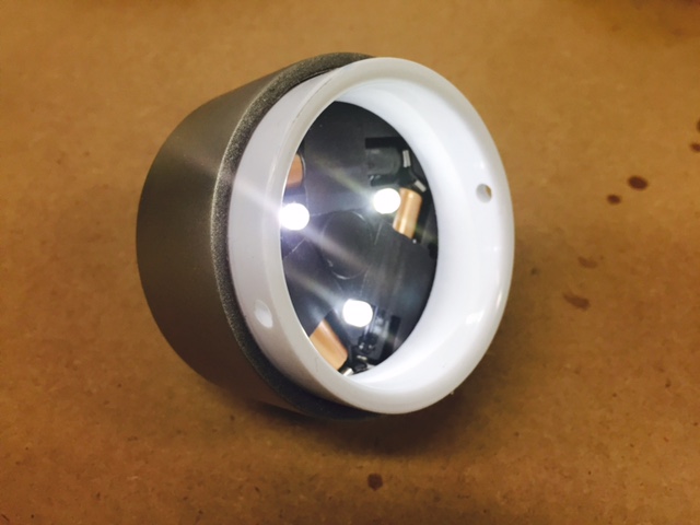

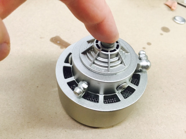

Endcaps: These were build from various PVC plumbing pieces and a couple bits from my shop. For the lighting I stripped out the insides of two LED tap lights. I had to unsolder the LEDs and add longer ones. I also created a pushbutton for the switch on the inside. From the outside it looks like a hex bolt. These slip-fit to the end of the tube and secure with a tiny hex screw.
The ball: I ended up using a pingpong ball. Painted it red.

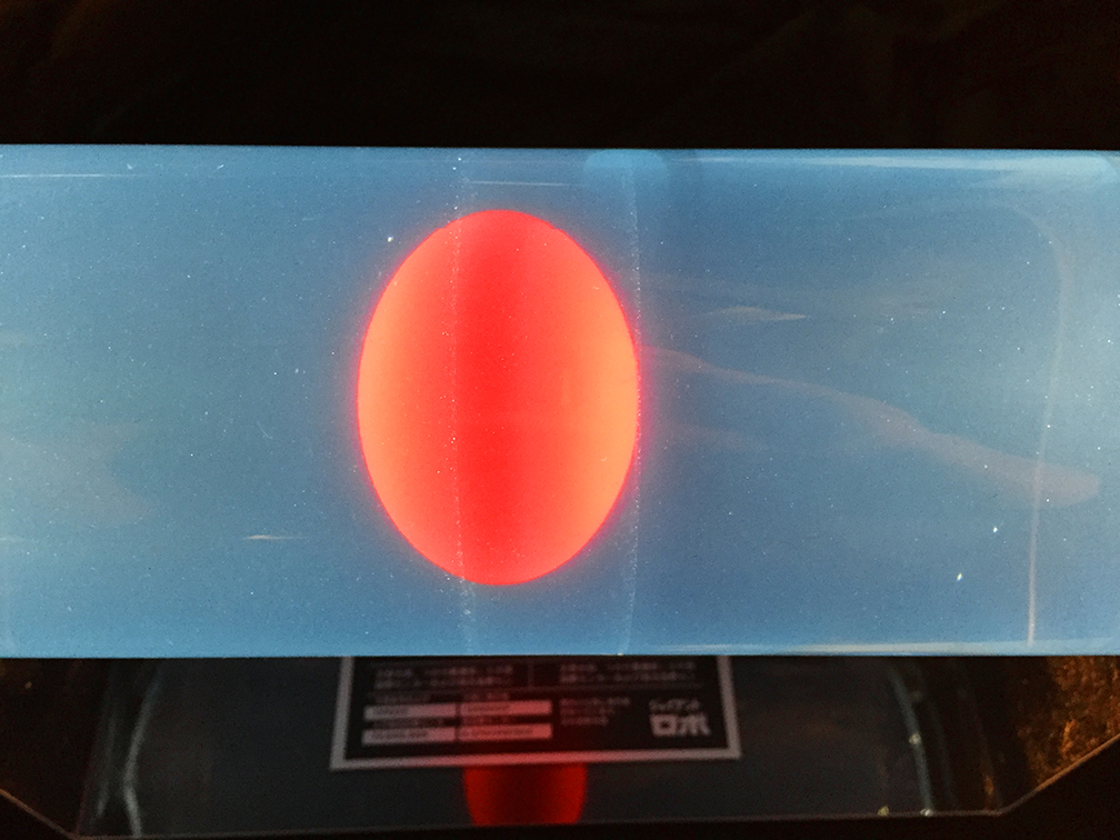

The liquid: After researching several clear resin, I stumbled upon a product from Smooth-on called Encapso K. It is a water-clear liquid that hardens into a rubber. It is usually used to create fake water in vases with fake flowers. It is perfect for my Shizuma drive because as is hardens there's no heat to expand or crack the tube. Smooth-on also sells tints for this material so I added a tiny bit of blue.

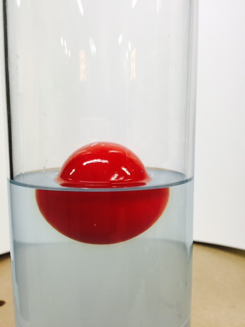

As suggested by a member here, I did the liquid in three different pours to capture the red ball. One almost halfway up the tube. Placed the ball and poured a tiny bit more to lock it in place. Then one more pour to fill the tube. A funny thing I hadn't anticipated was how much the gell would magnify the ball on the inside. It looks ready to burst!

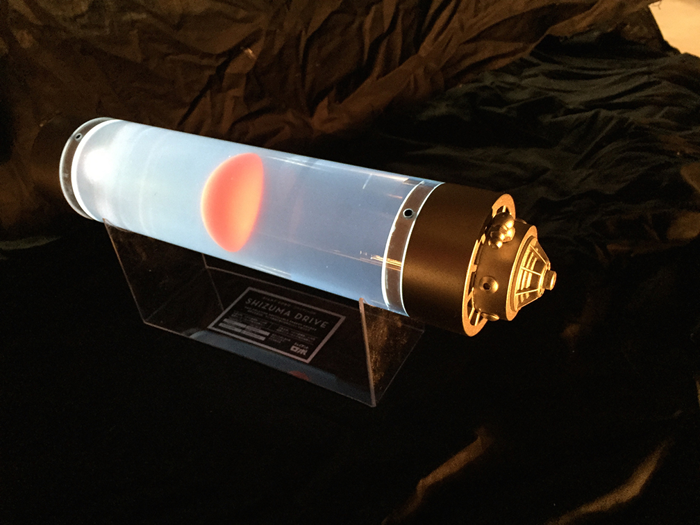

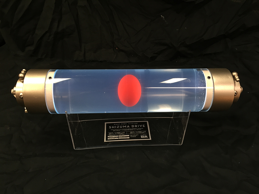

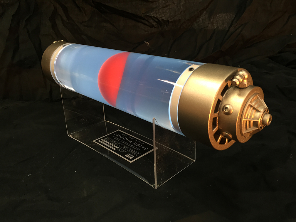

The Encapso K has set enough for me to do final assemble and a quick photo shoot. Man, this thing is cool when it's lit. The way the clear gel distorts the orb is a total happy surprise. I was worried the lighting in the ends would not evenly light the length of the tube. But the final effect is really even and beautiful! It's kind of creepy looking :) She's heavy (and round), so I build a simple stand (with collector plate).
