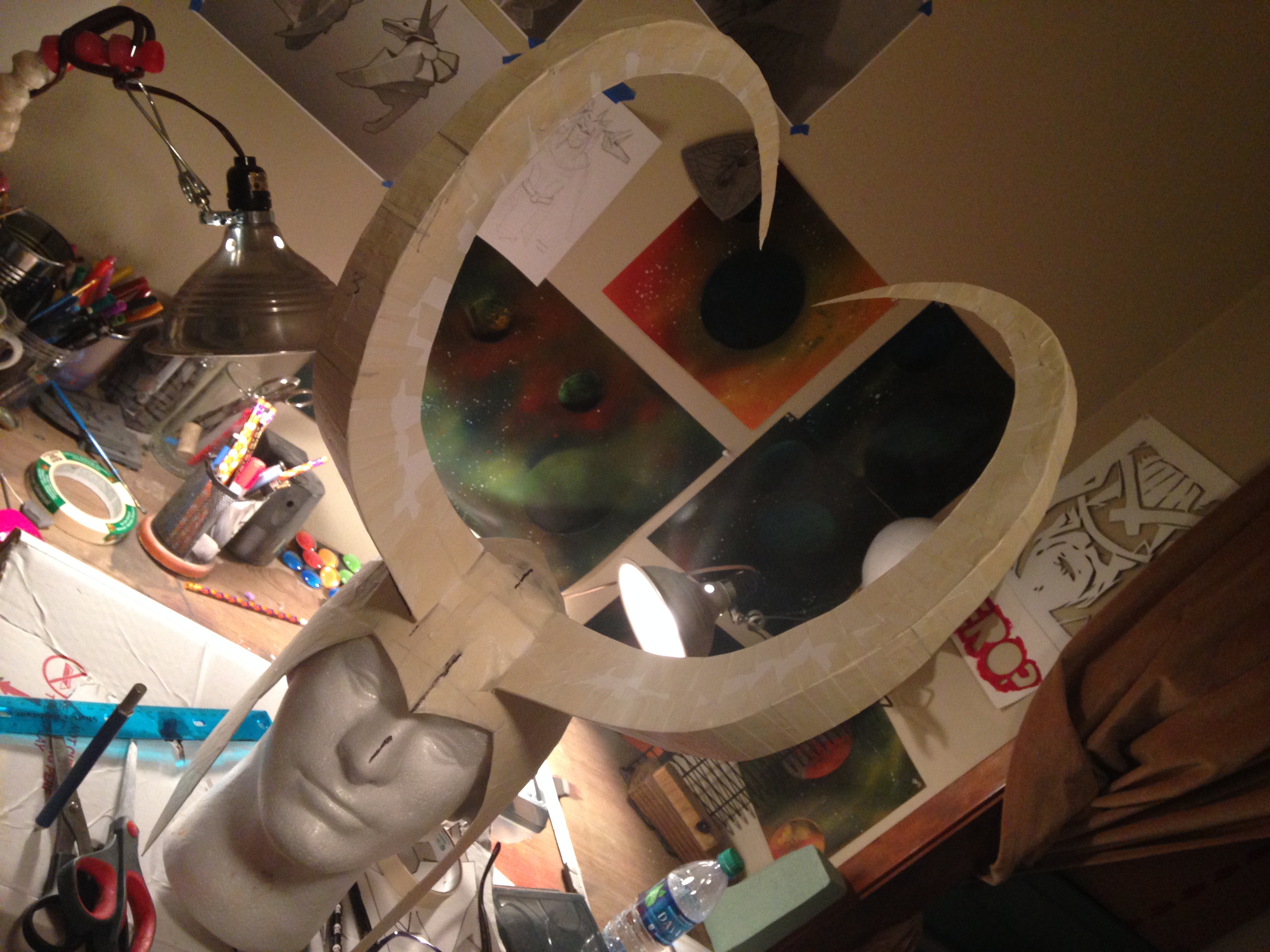

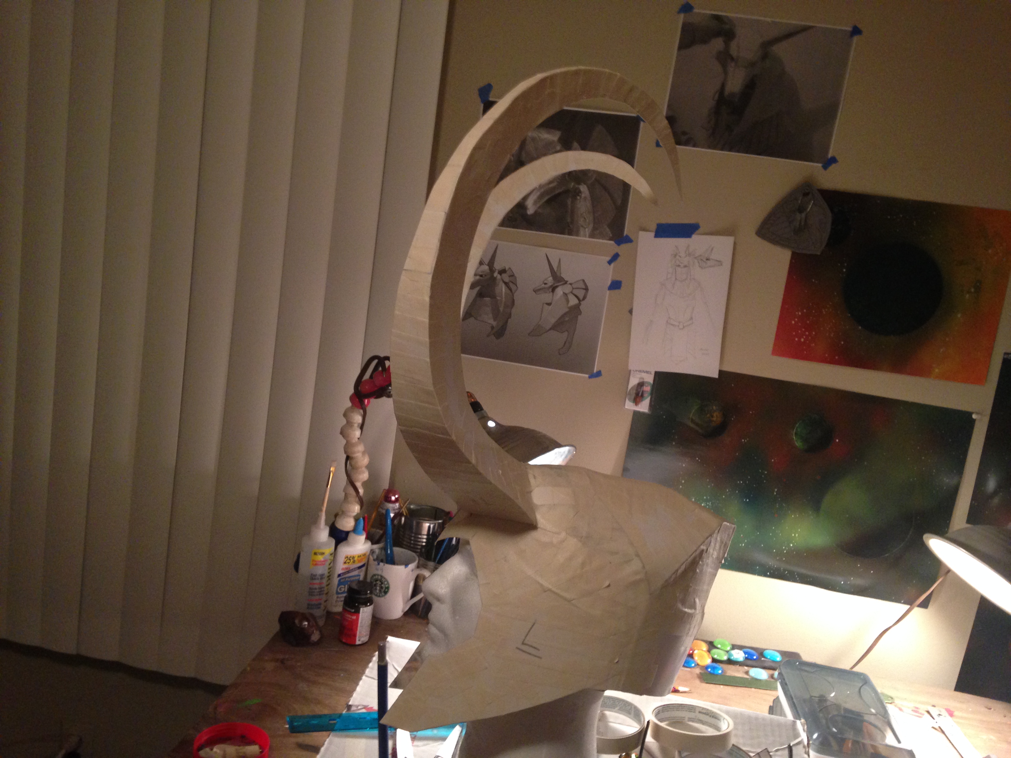

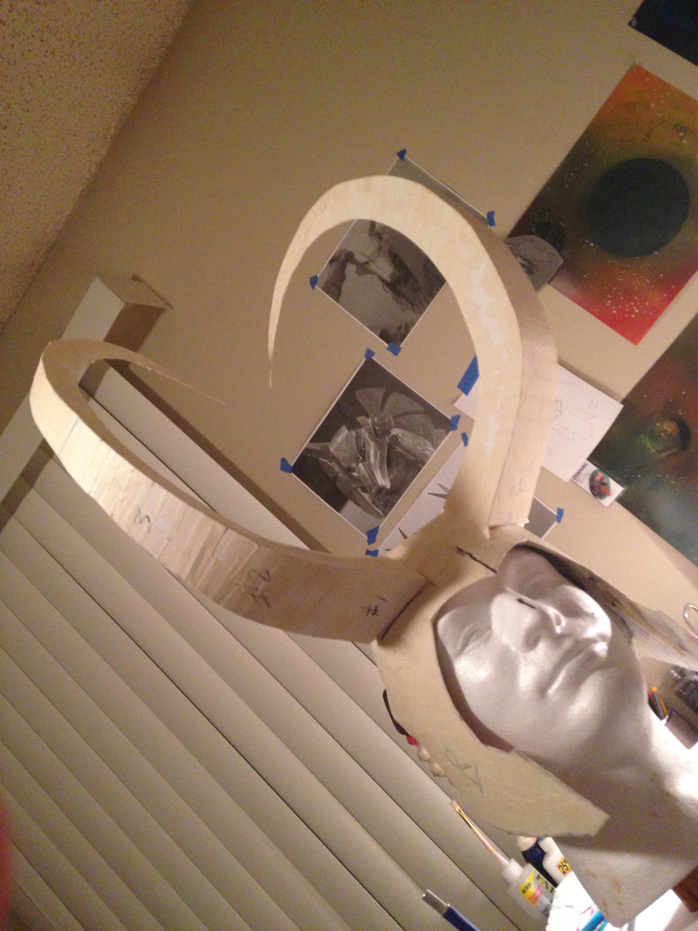

Hello everyone, I'll cut to the chase. basically I started a build of a Loki helmet and it's pretty much poster board, cardboard and masking tape! I wish to go to the next step! But I don't know what that step should be. I purchased some Bondo brand fiberglass resin and some Bondo brand body filler. Pics attached are where I'm at / what I'm working with now. Any suggestions or input would be greatly appreciated :) Thank you for your time in reading this! IMG_1779.JPGIMG_1780.JPGIMG_1781.JPG
