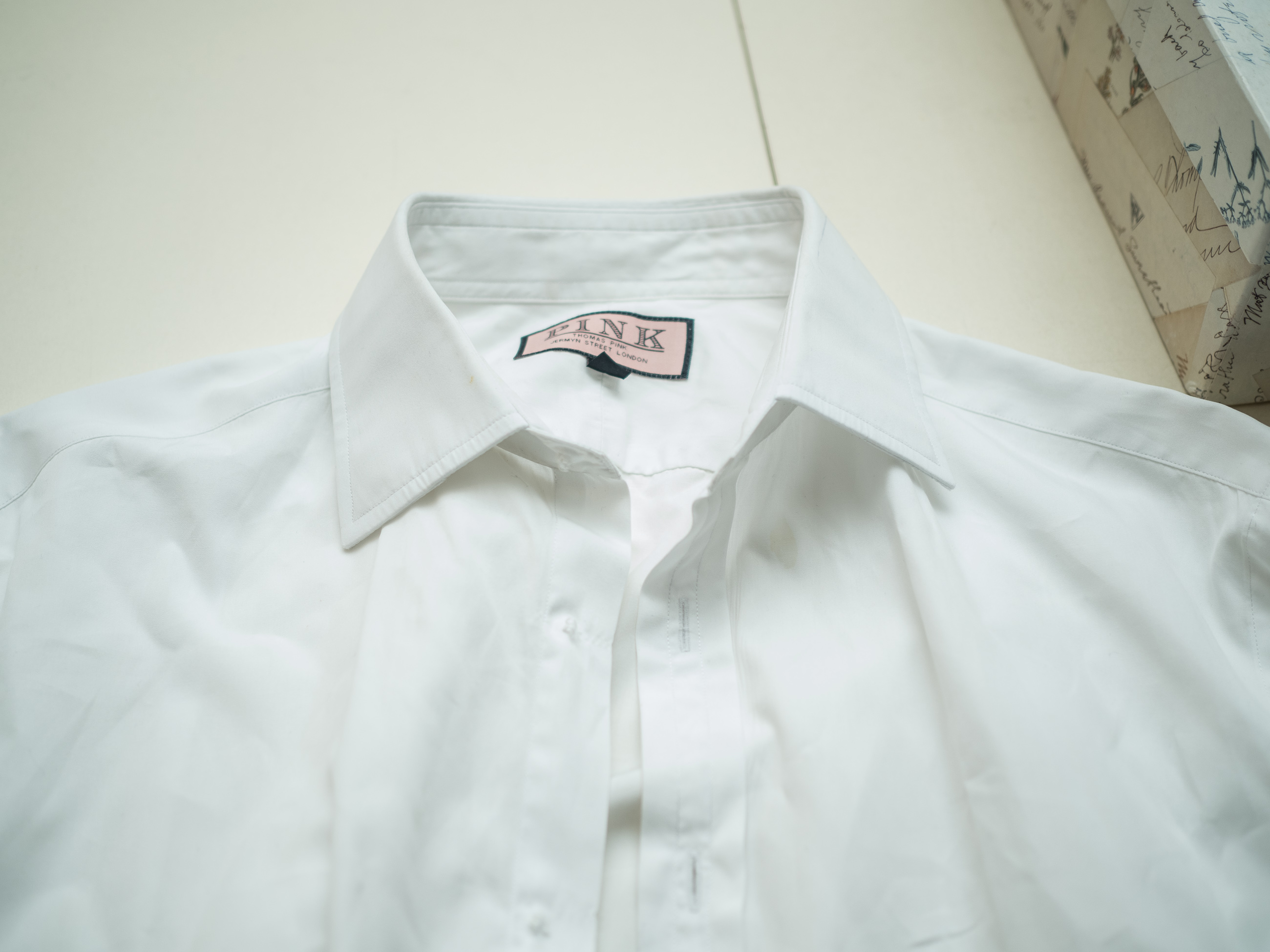

Got started on the cheap-o shirt conversion last night, following RowBoatCop's pillow-case method (although I'll be sewing mine). Start with one thrift store white dress shirt, and a pair of white pillowcases from Target. Total cost - $19. First step - bye bye buttons.

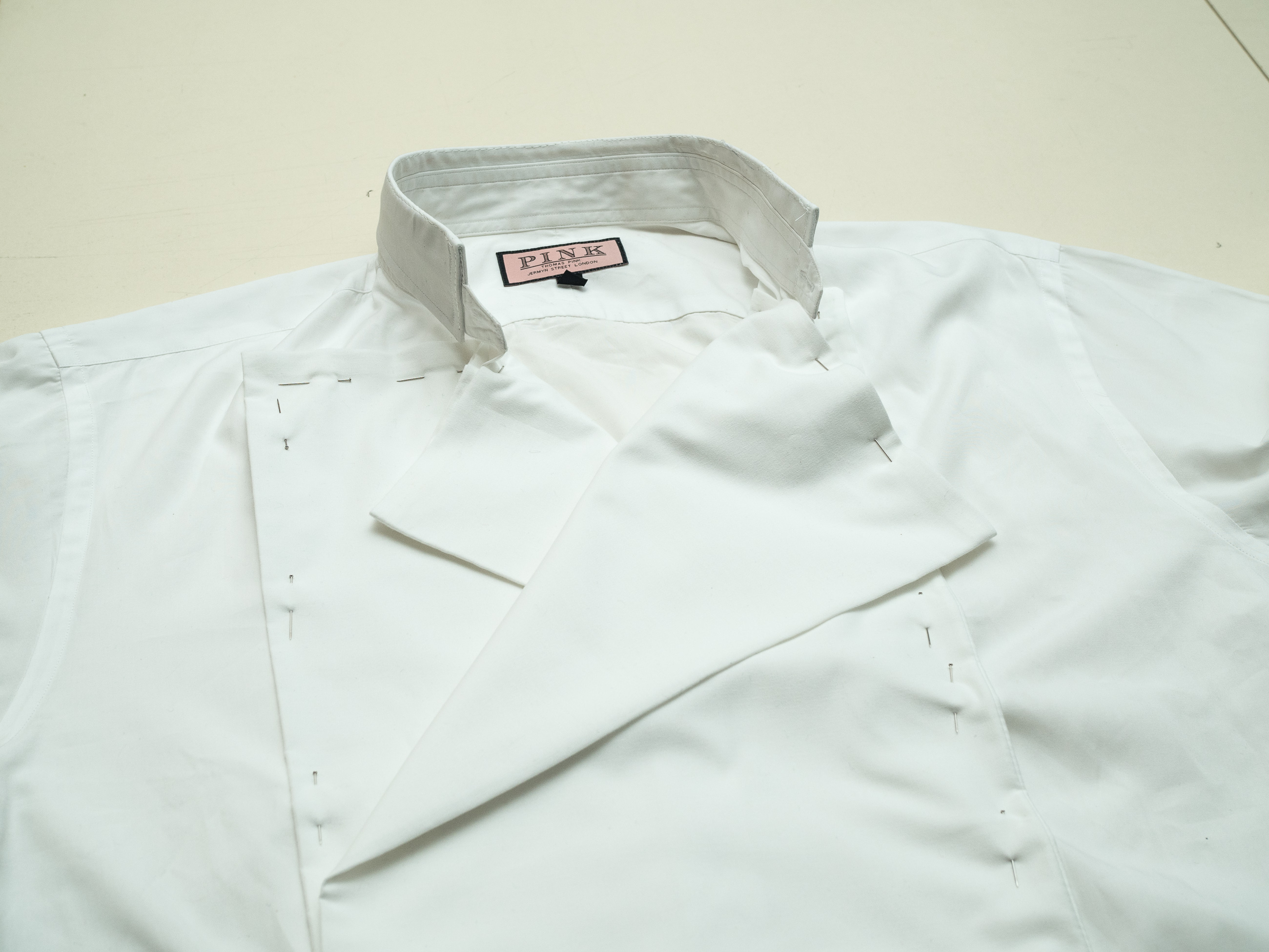

next up, folding over the collar and sewing it in place to form the pseudo-nehru collar. A formal dress shirt like this one is actually not ideal for this part, as the collar is already heavily interfaced, and has a lot of detail stitching. So, the resulting standup collar is quite stiff. The extra stitching isn't very visible under the jacket collar, however.
Then I laid down the layers - each pillowcase folded in half and ironed, sandwiching the shirt itself. Pinned both of them to test it out. I eyeballed the alignment for this step, and got it slightly off - doesn't really matter, as it's just a mockup test at this point - it'll be unpinned and done for real this week.
And a look under the jacket.
My main observation about this technique as-is is that the front of the shirt will end up relatively thick and heavy (although beautifully opaque). Each side of the double-breasted front is 4 layers of pillowcase fabric + the shirt itself, for ten layers of fabric on your front. What I'm going to do is trim away a layer of the pillowcases (leaving the folded-over tops for a clean edge), and trim back the underlying shirt as well, so it will only be four layers of fabric for the overlap.

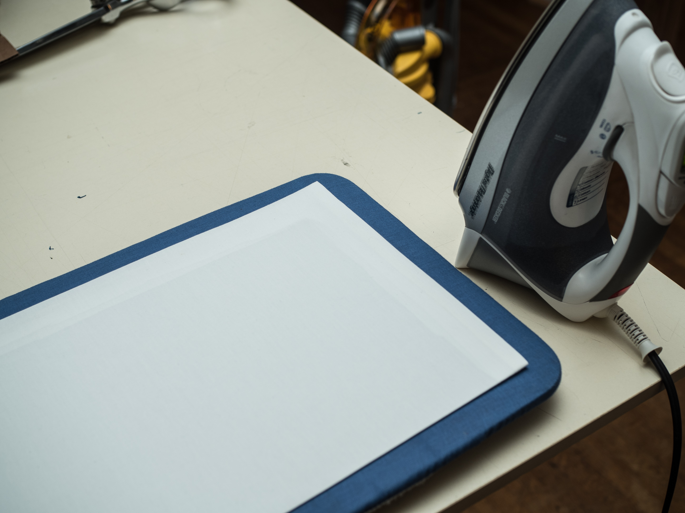

Prelude - preparing the double sided front. I trimmed away one layer of each pillow, cutting an inset in one side so that I wouldn't need to re-form the edges. Then align, press, and measure the width so I can align it correctly on the shirt front.
Each 1/2 pillowcase width is 10", so I want to align it with 5" to either side of the center of the button placket (not the edge - the center of the placket is the center of the shirt, since the placket on each side overlaps each other).
I didn't really take any photos of the rest of attaching the front pieces - it's pretty self-explanatory, and the photos were just a jumble of white fabric that you can't tell heads or tail from. Align, pin, sew.

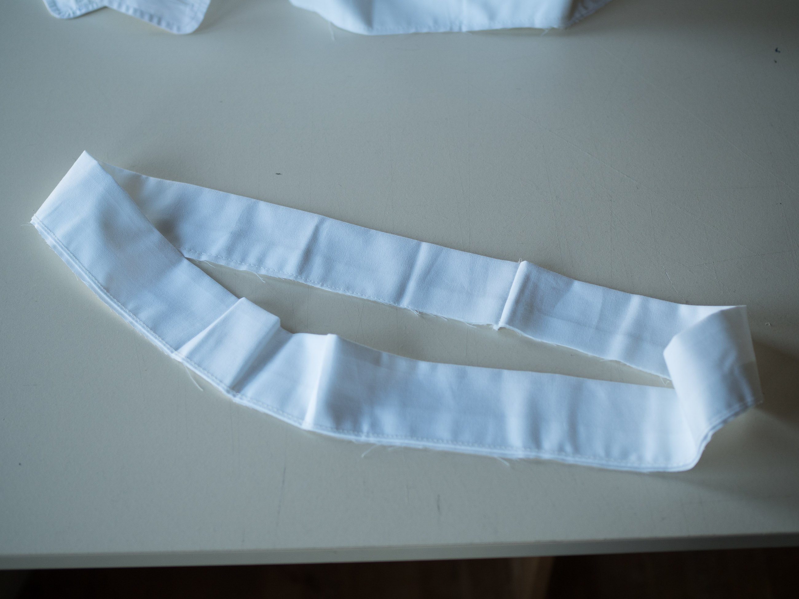

As luck would have it, the trimmed-off opening of one pillowcase works almost perfectly as a soft, casual collar for this shirt. I just had to shorten it by about 2" and it was exactly the right length. Flip inside out, sew along the top edge, then flip right-side out again and press.
Then it was quite simple to pin it back to the neck of the shirt and sew in place. Here it is pinned and ready to be sewn.
And the end result. This collar is much more satisfactory (and a lot more comfortable!). Now the shirt is really done, aside from shortening the body a bit so it doesn't bunch up in my trousers.

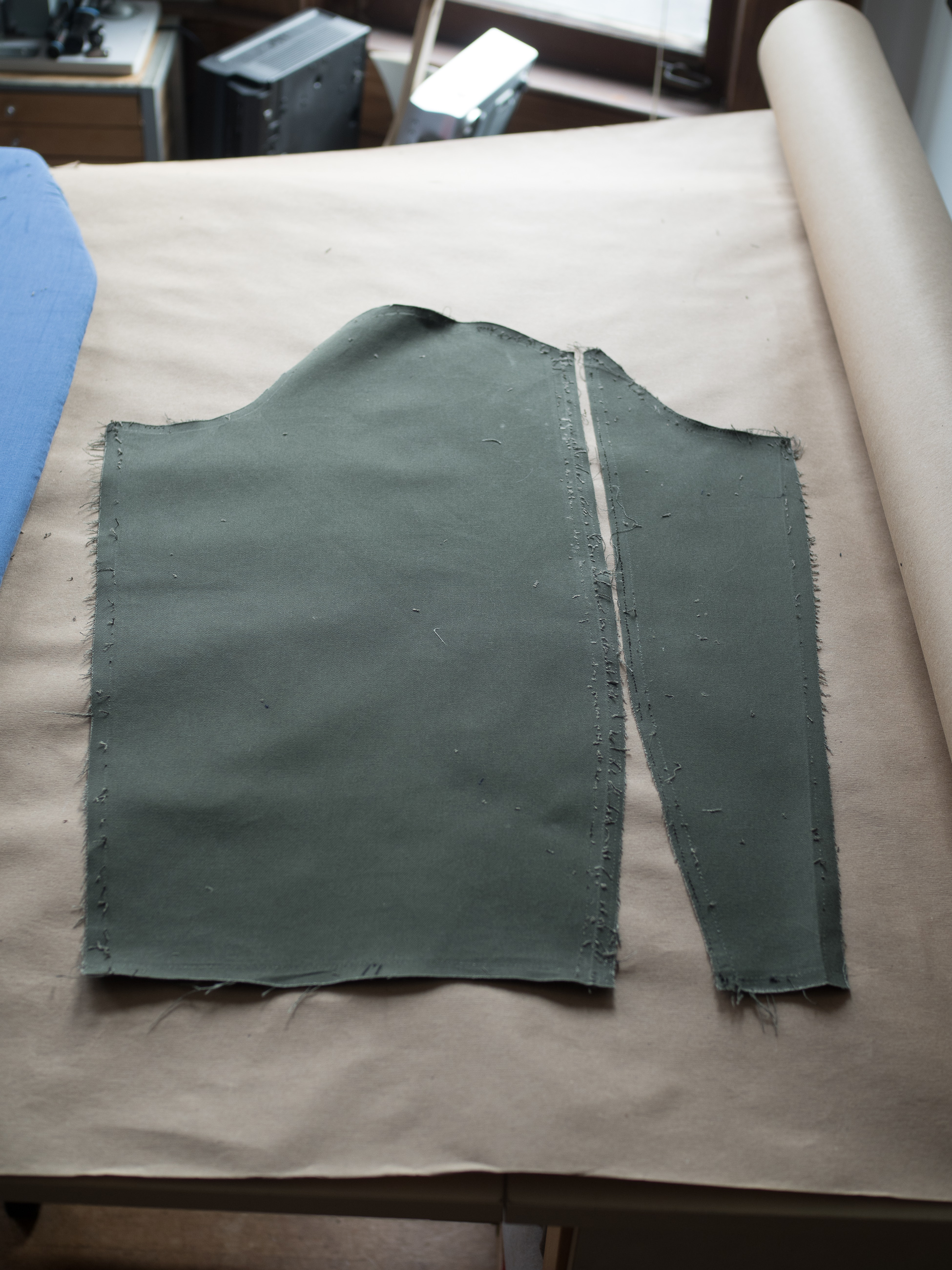

The sleeve isn't a set-in sleeve (where the sleeve is constructed, and then sewn in as a tube into the completed shoulder opening) - instead, the sleeve is attached to the shoulder with the side seams open, and then the side seam and sleeve under seam are sewn in one pass. This is a time-saving move often used on less expensive shirts (i.e. most factory made shirts) and jackets.
Pressing the seam allowances flat, so I can trace it out.
Here's the two pieces of the sleeve, pressed and laid out on a roll of butcher paper. A sleeve curve is handy - the forearm part has a slight curving taper to it. The rest can be traced with a straightedge, except of course for the sleeve cap, which is done freehand - very slowly.

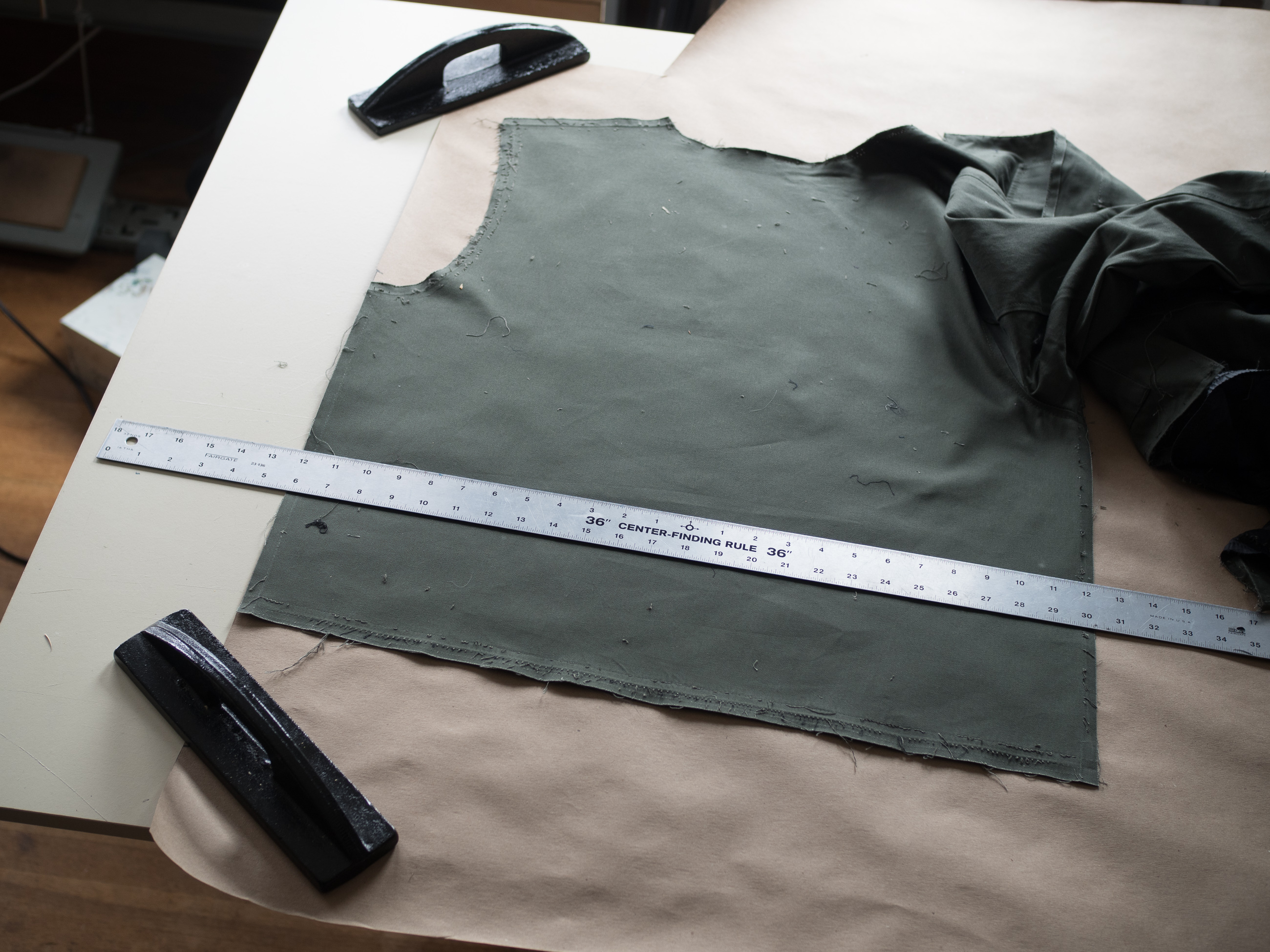

Then I had to open up the other side seam to lay the back piece flat. I didn't remove the second sleeve entirely - just traced half of the back, then folded it over to make a complete piece.

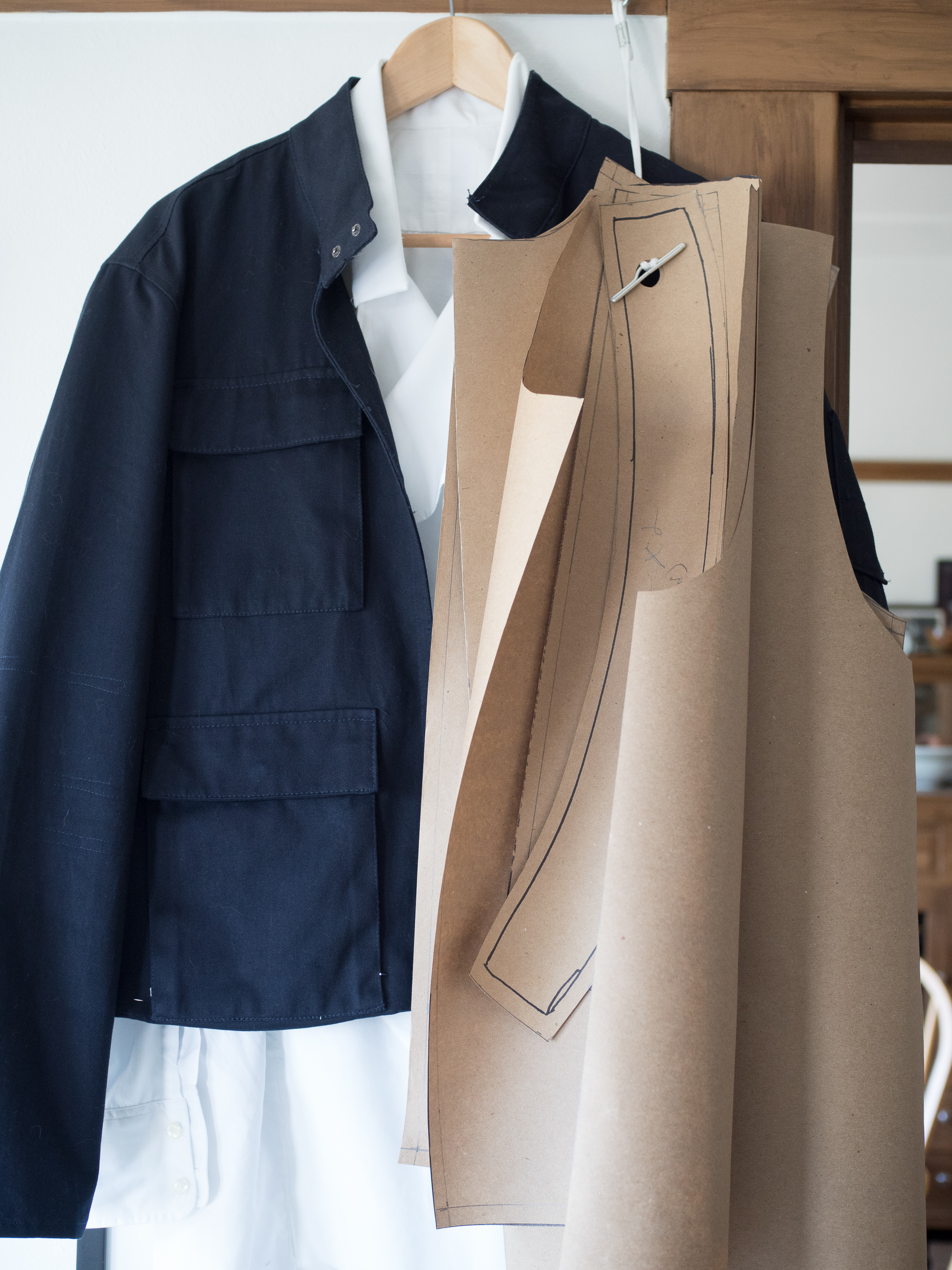

And here's the completed pattern, hanging on a pattern hook next to the almost-completed blue jacket. I didn't bother tracing a pattern for the pockets, since those are just rectangles that I can reconstruct from measurements. It'll undoubtedly be some time in November before I can sew up a muslin test, but I'm looking forward to it. And then making one in leather :)
