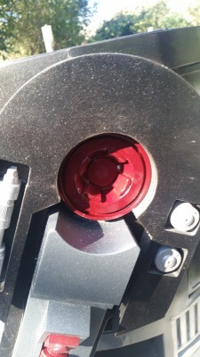

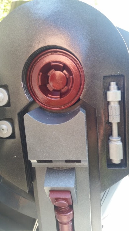

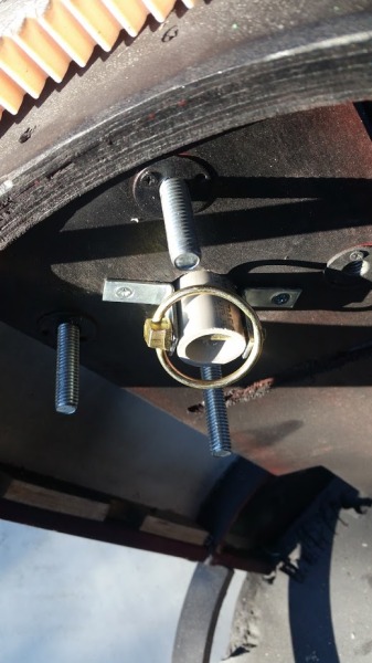

I finally designed and printed what I needed to do the shoulder hub/weapon quick change system.
The hubs do stick out further than they should. That has to do with my failing when the legs were CNC cut. The circuit was slightly off center which won't let the hubs recess fully. I also altered the hub to be shallower than stock. Eagle eye builders will notice. The general public probably isn't. If they do...well...BeeTee has ways of dealing with that.

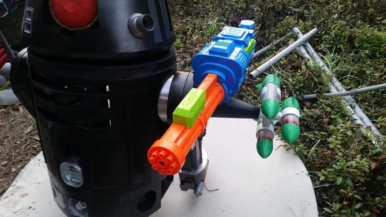

Here's a shot of how the quick change system works. I am not convinced the brackets are up to the job but we'll see. I can always make them out of some angled steel down the road.
I also finished the mounting clamps for the left missile salvo.
Here's a video of how the quick change works. It's so easy I can swap out weapons with one hand. It is possible to do through the door as well but for video purposes I left his dome off.

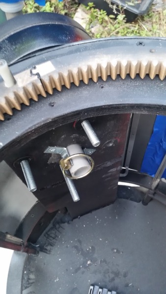

Before the cold snap I managed to get the utility arms mounted.
I cut down and modified the Halloween decoration for his eye. Yes...that is a coffee can lid bolted to the toilet flange. Don't worry, the flange is unused. It was in my junk bin from when I used it for a Mr Fusion support on my DeLorean for a Christmas parade a few years back.

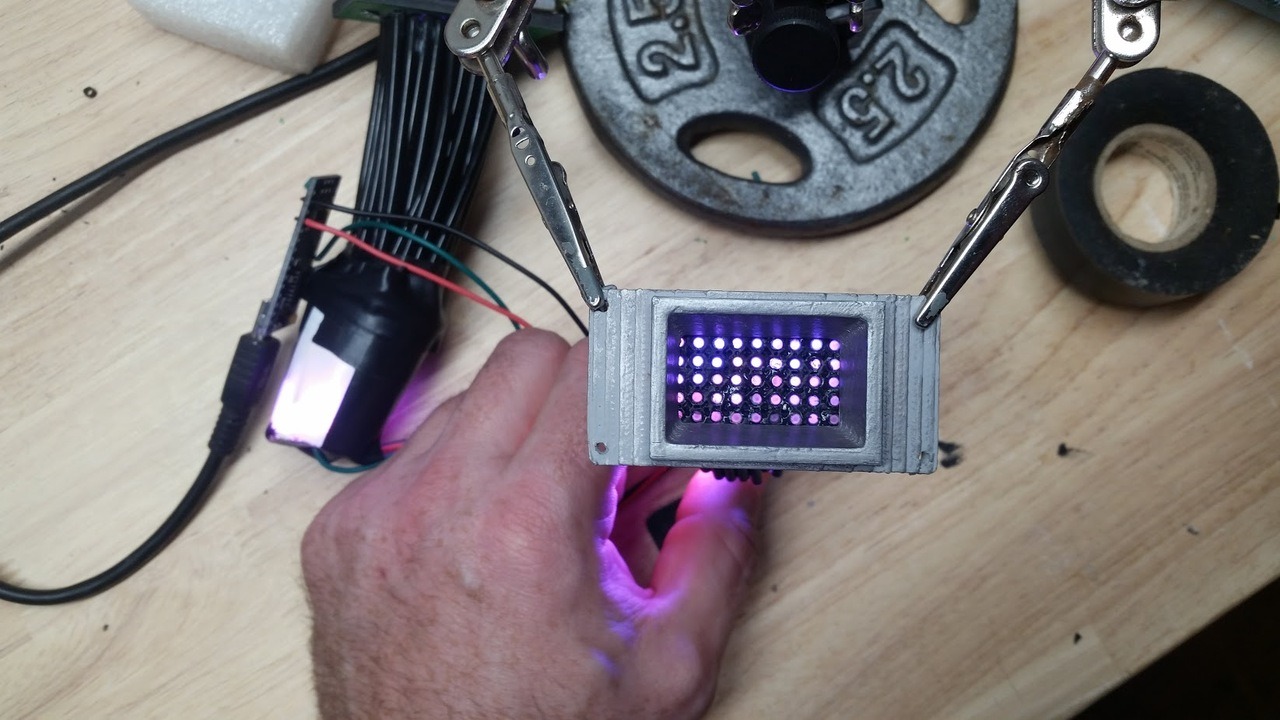

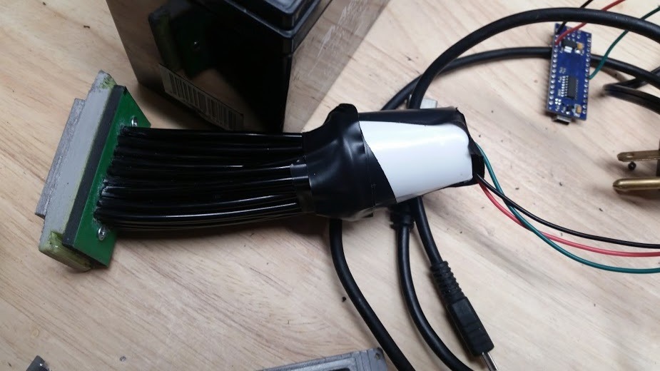

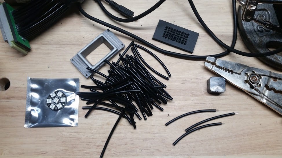

The eye is still probably my favorite part. Today I tackled the front logic displays since I got my parts in to tinker. It works better than I expected.
The prototype light capture cone is a KCup from a Keurig and some electrical tape. I'm going to print a proper one now that I know this works.
Halloween, Halley for short, was trying to help but kept getting distracted by the lights on BB-8's dome.
Here's a video of it in action. I changed the files a bit after this so the orange and purple are changing faster. The orange is a lot more orange so it has better contrast. I think it's the color set I am going to go with for the front logics.

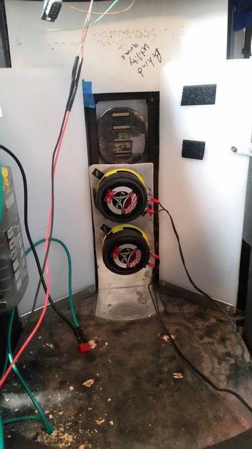

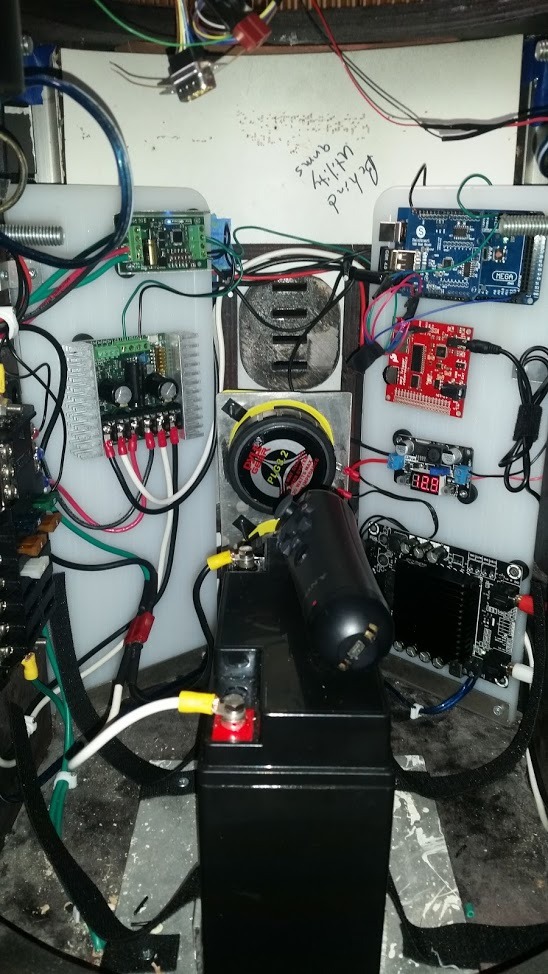

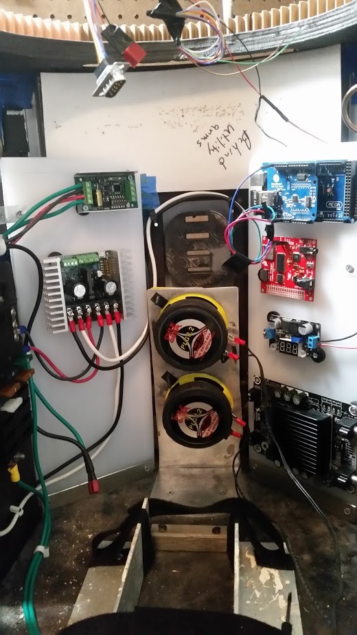

Today was wiring day with BeeTee. First I cut a large cutting board in half and cut a section of aluminum channel from a shower stall that I was given into lengths the same width as the board. I bolted those down and then screwed the cutting board in after pushing it into the channel.
With a good base to work from I started mounting my boards and wiring them up. The speakers are Chopper's old ones. I'll probably dig through my box of discarded speakers later to get a couple of nicer ones but for now this will work.
I also built a mount for the battery with velcro and angle aluminum. It's only 12v but it is the largest battery I've ever put in a droid.
After all that work I tested each and every bit before this...
I have a one-up on a Tarkin Initiative technician. I activated BT-1 and lived!

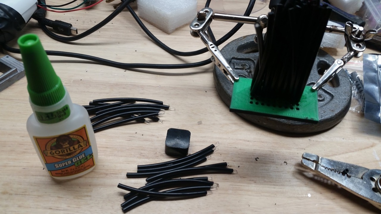

This is why I like ABS and a slurry on a glass bed. The reflection of the glue bottle in the print means all I really need to do is some fine sanding and fix a few pinholes that will pop up on the largest visible sides. The aluminum strips are going to cover the seams.
Is that the glue you used to glue all these 3d printed parts together?
Some of them like the footshells where I am backing the seams with fiberglass. Usually I weld the ABS using acetone. The superglue gel holds very well and fills seams. I just prefer to acetone weld whenever I have a large surface area of ABS.

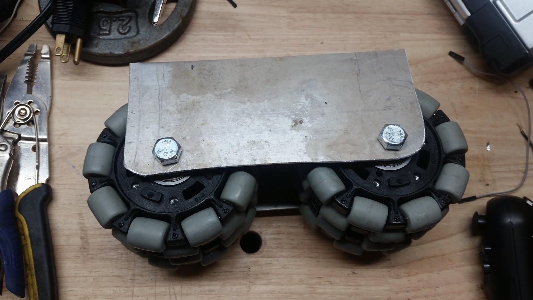

I finally cut the metal for my center foot. I did a lousy job at it but it's cut and it works. I need to learn to do electronics during the night and cut the metal during the day so I can see what I am doing.
