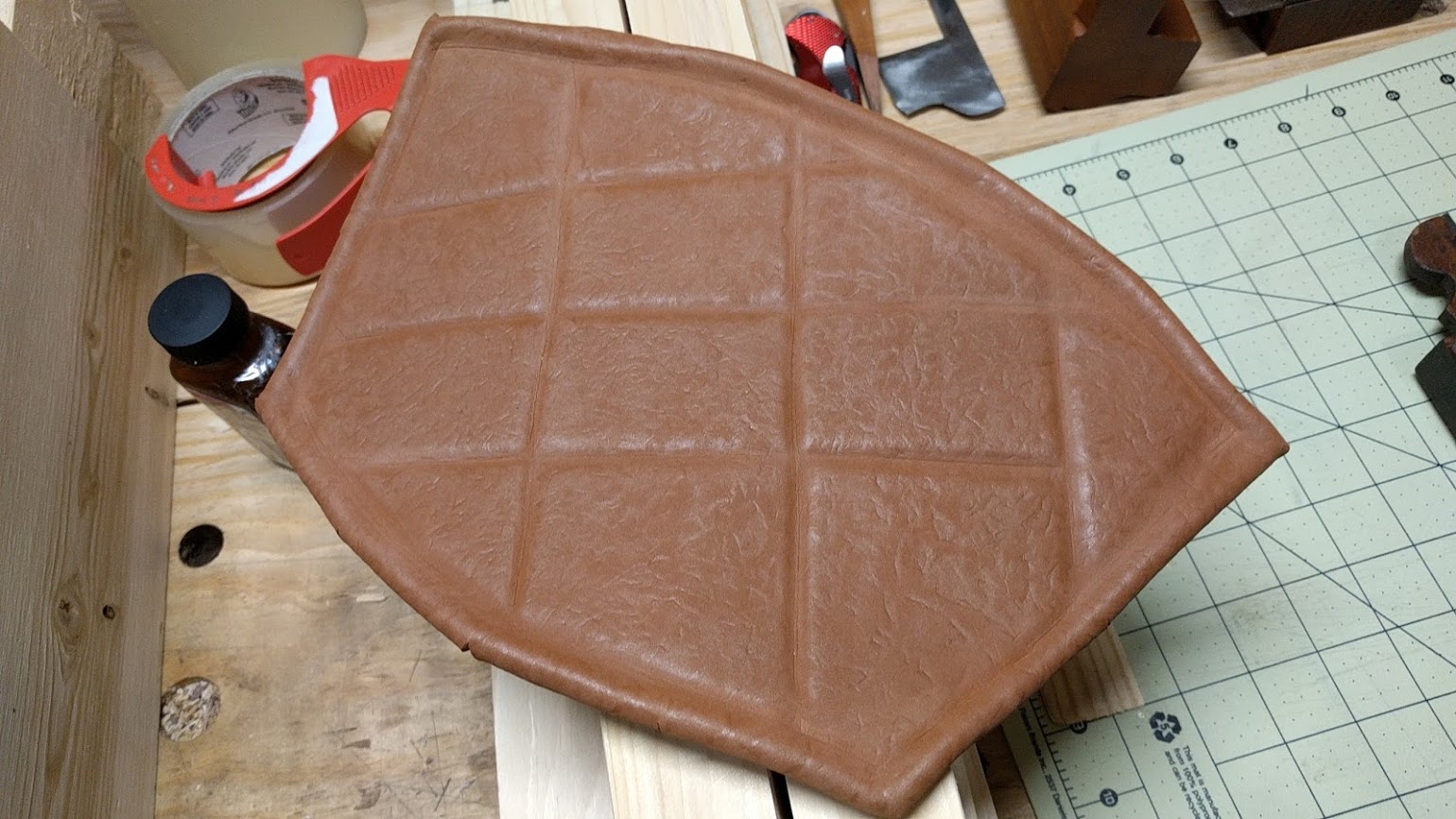

So, I went with the EVA, and so far the results have been good. I did the EVA base layer, then cut imitation steel plates from EVA, then put a top layer on that after alum. foil treating it to give it the leather texture. Neoprene 3/16" solid tubing provides the edging that Snow's armor has. Used a wooden stick I worked smooth to press the areas between the "steel" plates.
So far, so good. it bends nicely to my arm. The leather shouldn't "flow" like suggested, as it's supposed to have a lot of steel plates in it. It'd be stiffer than solely leather. So I think this mimics well. Next up is googly-eye rivets, elastic bands inside, and then cosmetic straps on the outside like Snow's bracers. Then plastidipping and painting. His armor doesn't look too distressed, so there won't be a ton of weathering involved.

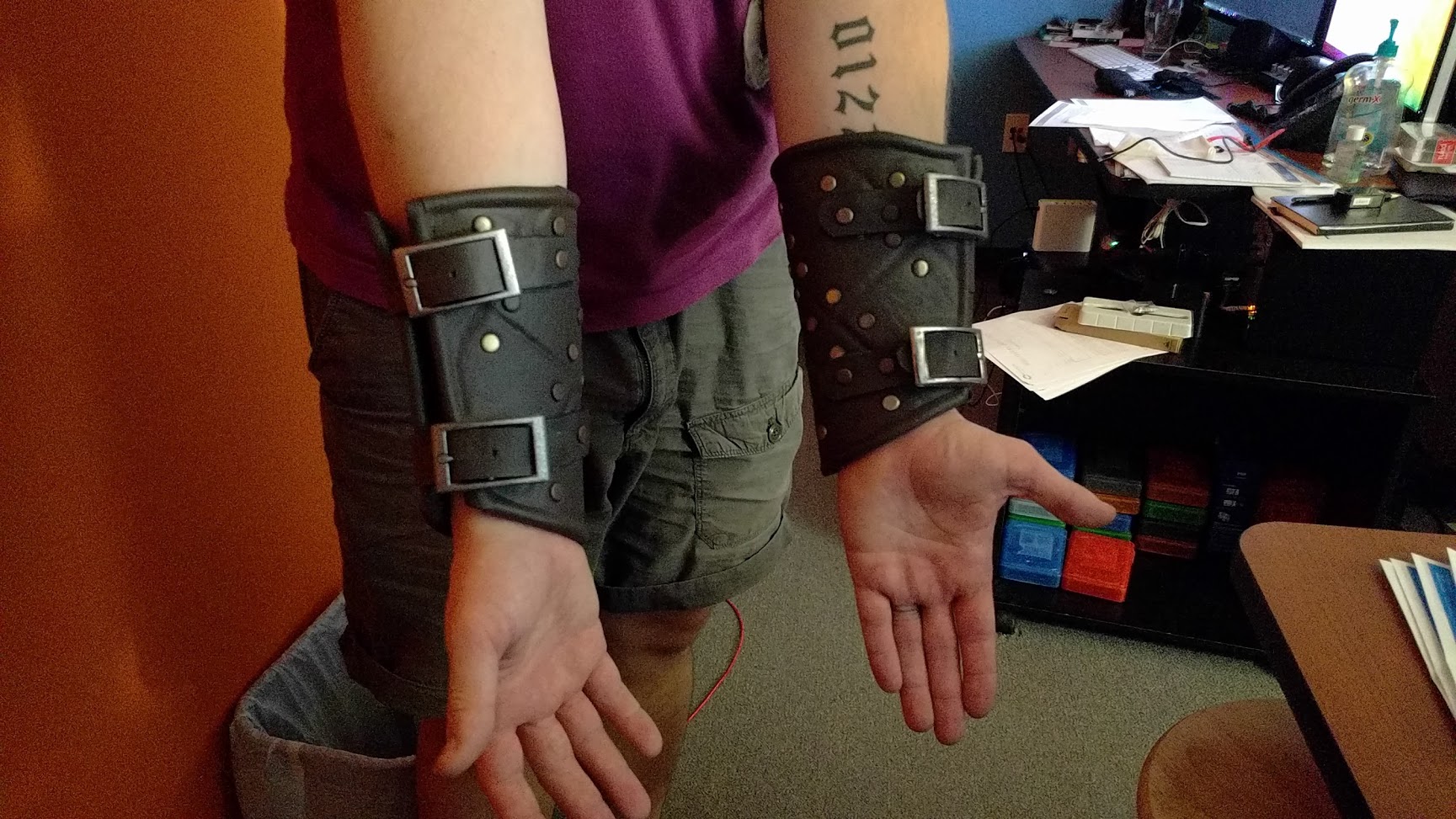

Indeed! I've been busy busy busy but have managed to be nearly complete with this. DragonCon is next weekend, so it's getting close! Bracers are done, armor is nearly done (just the side straps to finish it out). Bonus Longclaw as well.

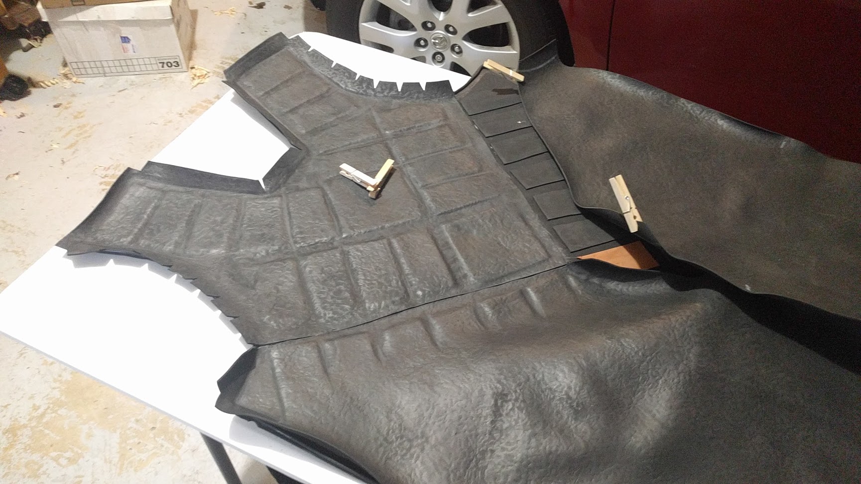

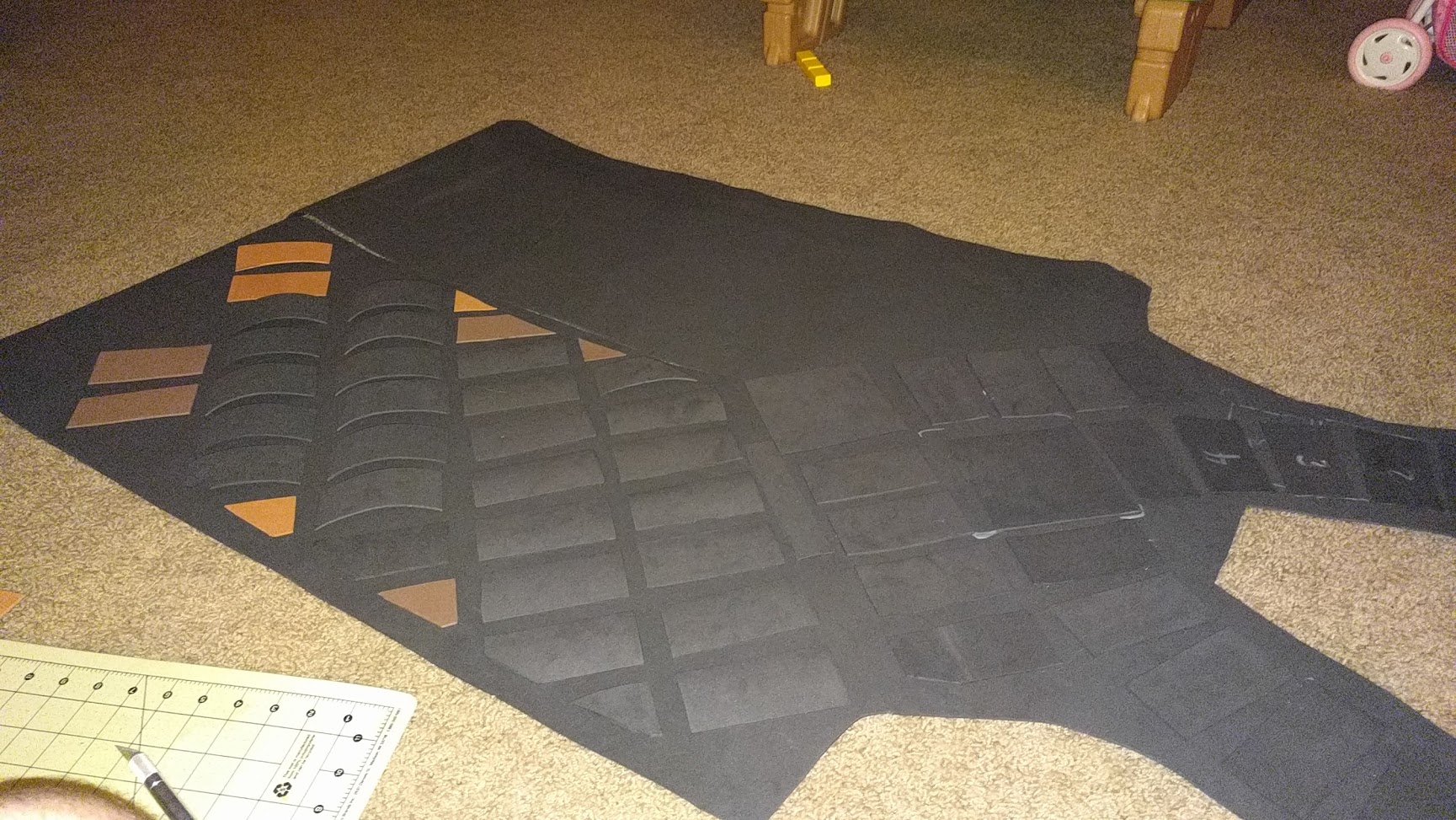

To speak to process, it was basically a rinse-repeat. Cut the base shape to size, then cut a million 2x4 pieces of foam and the 4.5x4.5 squares for the front.
Then create a top layer series, fortunately Jon's armor has a split in it like mine does, so the front is in three pieces. Use the same foil + iron treatment, and then contact cement & press between the "steel" pieces. A 1/4" dowel helped a lot with this.

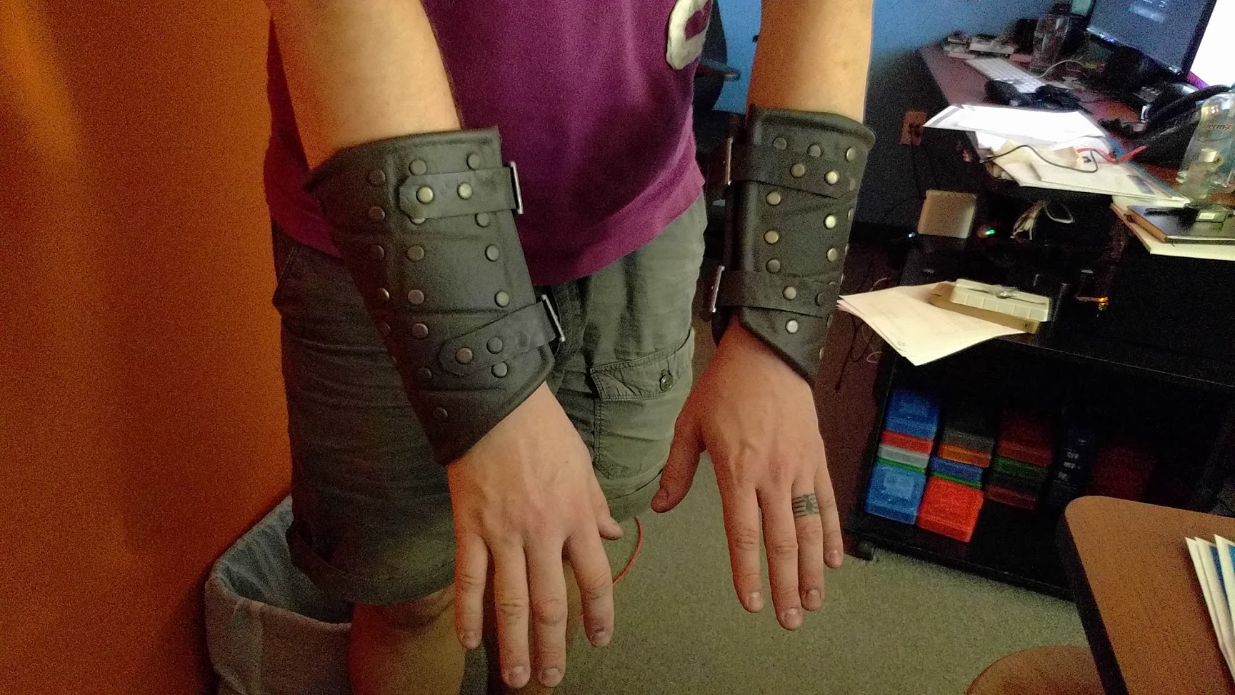

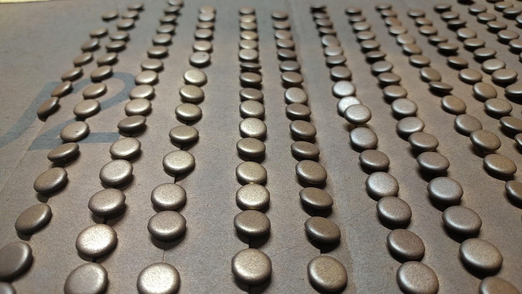

Then spray painted with black plastidip, and then "leather" matte spray paint. Used the same "leather" on paper fasteners (below) and then stabbed them through.
Used "metal" paint, black plastidip, and the leather on the previous-chrome-shiny buckles to weather them a bit.
The straps are also EVA foam. EVA has a good shear strength, as does superglue, so I superglued those. EVA has a poor tear & puncture strength, so I backed the straps with black gorilla tape. So far so good.

Oh, there's about 850-900 paper fasteners in this. So be prepared for a LOT if you want to do that. I'm probably going to tape down the inside so I don't keep getting poked.

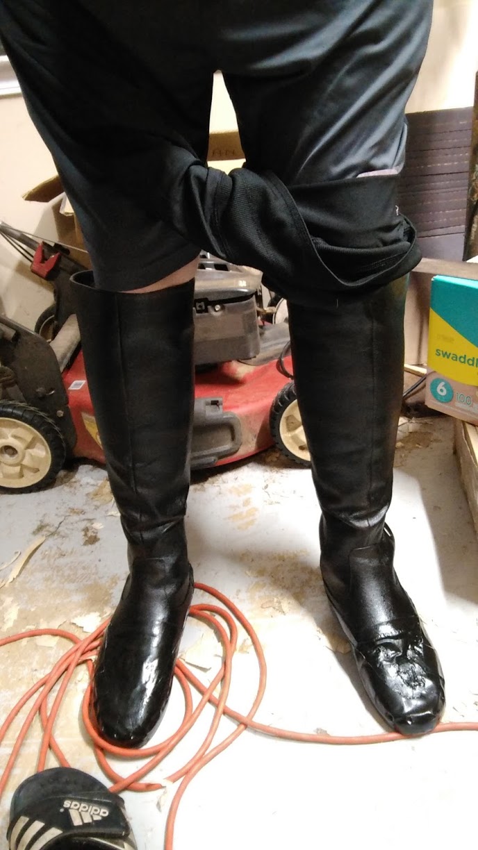

Updated pics. I also have a gambeson made from a dress, not as dark as Jon's but good enough. Boots are a combination of some women's Goodwill boots and an old ratty pair of Vans I owned. Gorilla tape, pleather, and vinyl spray paint. His Battle of the ******* boots are plain black from what I can tell, not the fur ones of the NW.
Boots, belt, sheathe, and gambeson will be the "lamest" parts of this. Hopefully Longclaw and the brigandine itself will be good enough haha.

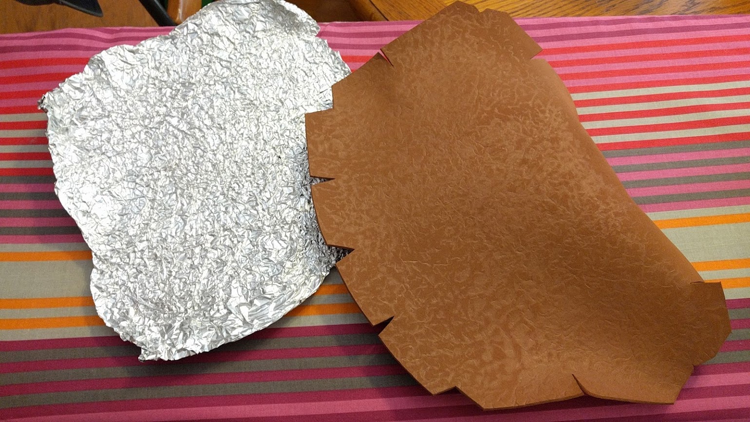

What's the "Foil + iron" approach you're referring to? Is it literally just pressing crinkly tin foil into the surface on the foam with a clothes iron to press "leather" texture into the foam?
More or less - a hot iron is critical. I used the wool setting, would leave in place for 30-60 seconds. Take off iron & foil, check.
