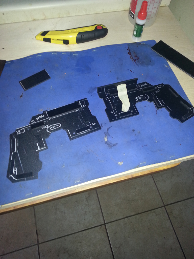

Instead of going with a layer method, I decided to build the frame as a box essentially with one half having the sides attached and the other half the frame acting as a cap that would be bonded to the assembly to create the base of the gun's frame. This eliminated having to cut the frame shape multiple times to build up the thickness, as well as making the magazine well and trigger assembly easier to install.
I first started by cutting out a cardboard template of the frame and tracing it down onto the sintra. The sintra was then cut to shape. After that was done, both halves of the frame were taped together and holes were drilled through both pieces so the rivets would line up symmetrically when they were later installed.

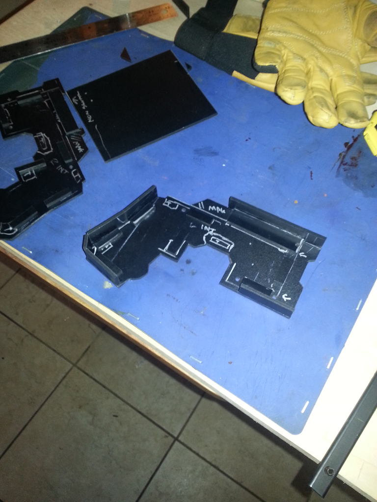

I glued tabs of cut sintra along the interior of both frames. These serve two purposes, one they provide additional support to the vertical pieces that form the spine of the frame, and two act as registers to insure both halves line up when assembled. My first idea had been to take one long piece of sintra and heat and bend it to conform to the shape of the frame, but the number of tight angles on the forward part of the grip proved too tricky. So instead individual pieces were cut to fit the areas, with the gaps to be filled in later.
After a day of cutting and gluing the spine of the frame was completed and I was able to try the first test fit of the finished frame. There was a little play between the frame halves in a few spots but I figured that would give me a little wiggle room to insure an exact fit before the glue bonded fully.
