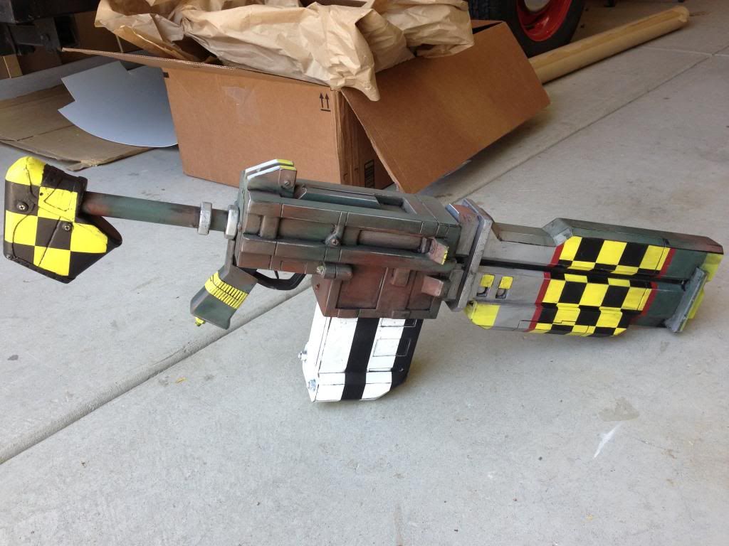

Mostly done, except for Torgue logo on the side.

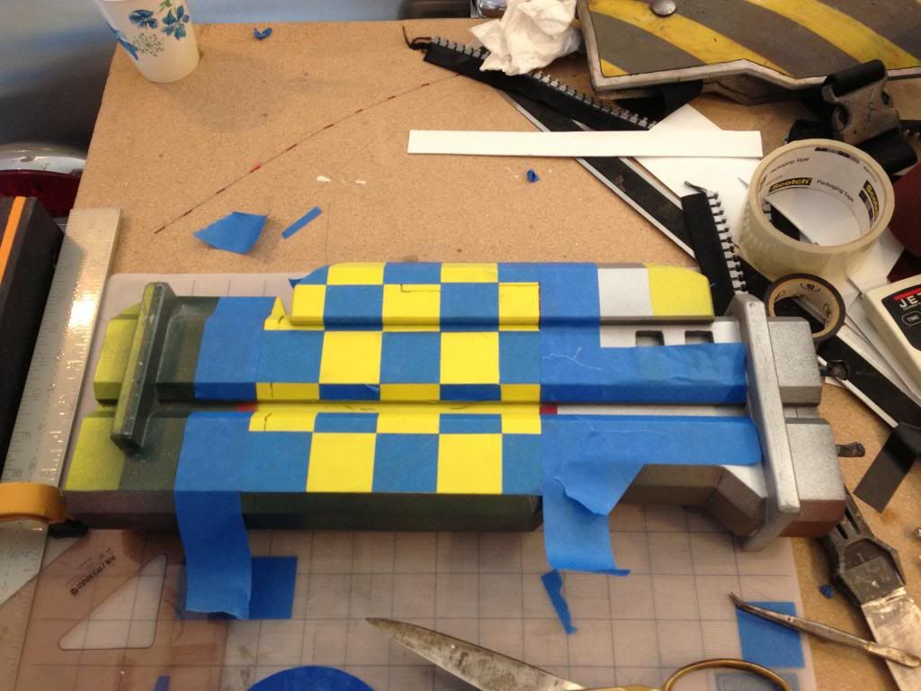

Frantic last minute masking/painting.

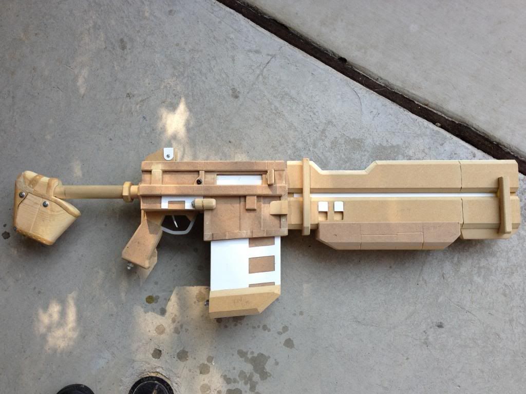

Primer and spot fill.

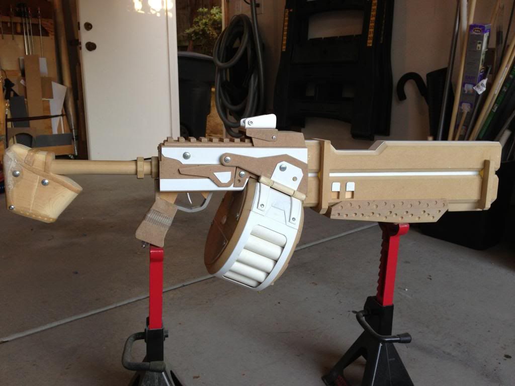

MDF, but only weighs about 8 lbs because it's mostly hollow.

The Bangstick is super impressive! What did you use for the detailing on the stock?
Thanks! I used Worbla for the stock details. I also used it for Axton's boot armor and Tina's mask. First time working with it. Pretty cool stuff.
Fantastic job! I've never played the game... but Tiny Tina doesn't look like someone I would mess with! Is she related to "Talking Tina" :) Question: I work with MDF and I was wondering if there were any special tricks you used to get those "fuzzy" edges smooth? I take wood glue and smear / press it smooth into the "fuzzies" and then sand smooth. Are there other more easier tricks?
Again, GREAT JOB!
Again, GREAT JOB!
Thanks! Truth be told, I really don't do anything fancy. I just use a few coats of rustoleum sandable filler primer over the bare MDF. It goes on rough, but easily sands down to a very smooth finish.
