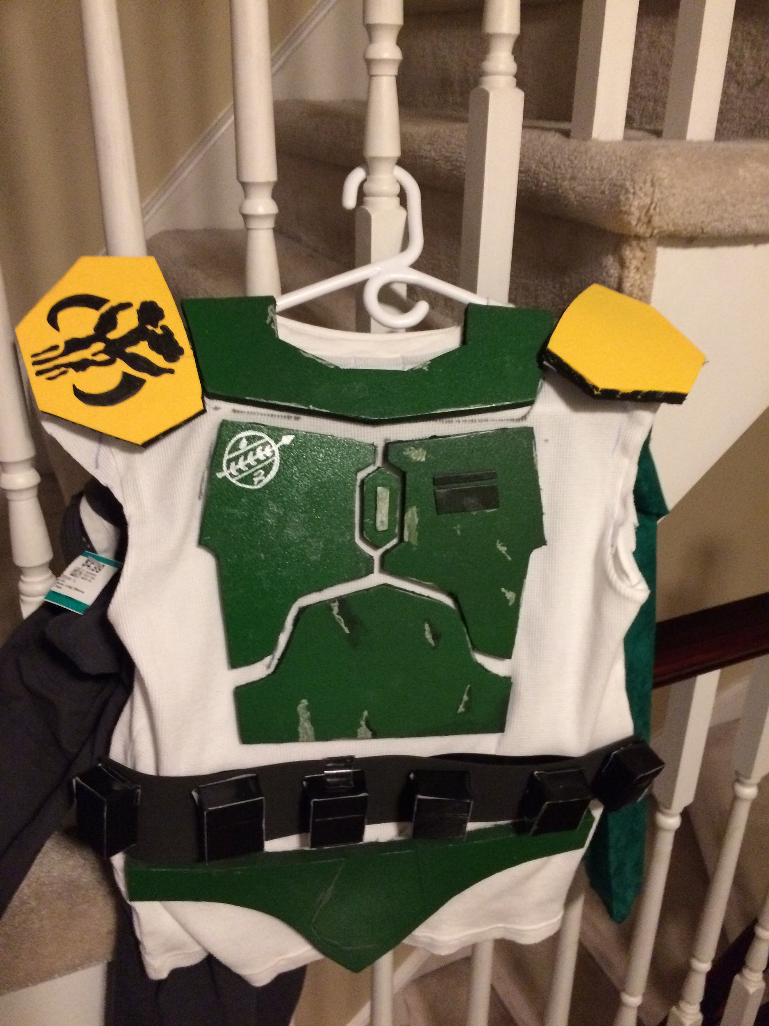

Pic one is the main armor. I found an old shirt at Value Village and cut it into the vest. I got the patterns for the armor from the dented helmet. I was able to cut them out on the Floor Mat EVA foam. Here is where problem 1 began... So I didn't buy Plastidip which was $20 a can, instead I bought Rust-o-leum Flexi Dip as I was trying to cut costs. I found that it took way more coats than it said it would need. Also it peeled really easy too. Next was the paint. I don't know what I was doing wrong, but after 2 days of drying the paint was still tacky. This was alarming because I was under the gun. I ended up buying an acrylic clear coat to spray over top. That did the job. The shoulder bells were hand painted with yellow acrylic craft paint. Finally the battle damage was done with black acrylic and a silver sharpie.
The cod piece and the belt were kind of after thoughts. I did have all the pieces to make it complete, but since he was wearing it to school, I wanted him to be able to sit, so I just glued the front the vest. The belt was a ****tty last minute Duct tape and pink foam job. Could I have done better? Yes! At the time it was late and I was trying to get everything else done.

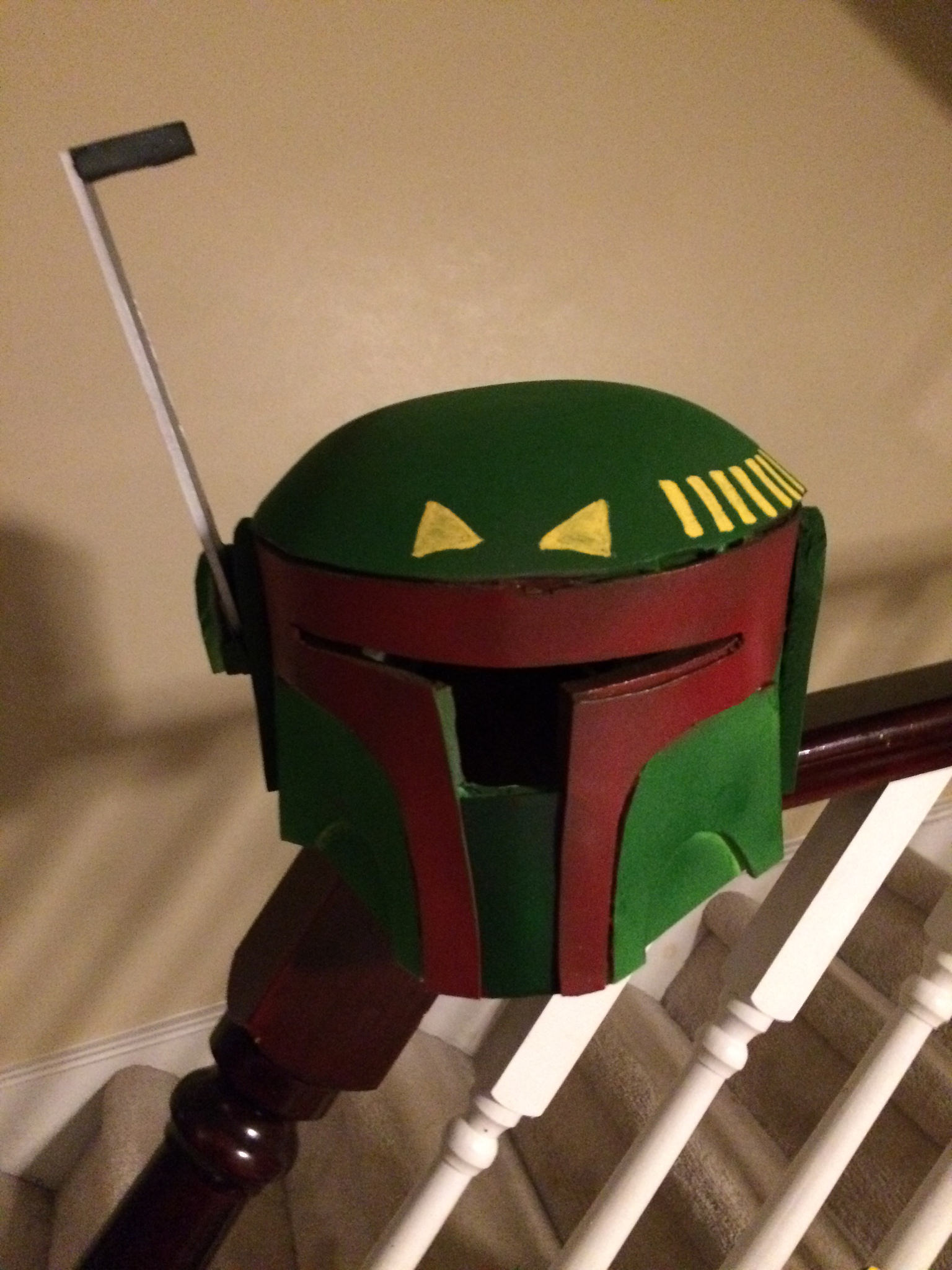

Oh the helmet... this was not as easy as the guy on youTube made it out to be. All in all I was happy with the results. The dome was made by taking a circle piece of foam, heating it up and then shoving it into a colander. As you can see my colander kind of flattens out at the top, next time I would find a better way. Also I clearly did not sand the edges enough, so there is a big gap that given more time I would have filled with spackle. The lack of the visor was a contentious one. My son wanted the visor, and I wanted him to see at night. I won. I was pretty pissed that my edges were white in the cheek area, but I didn't have time to go back and fix it. I had gauntlets to make and a backpack.

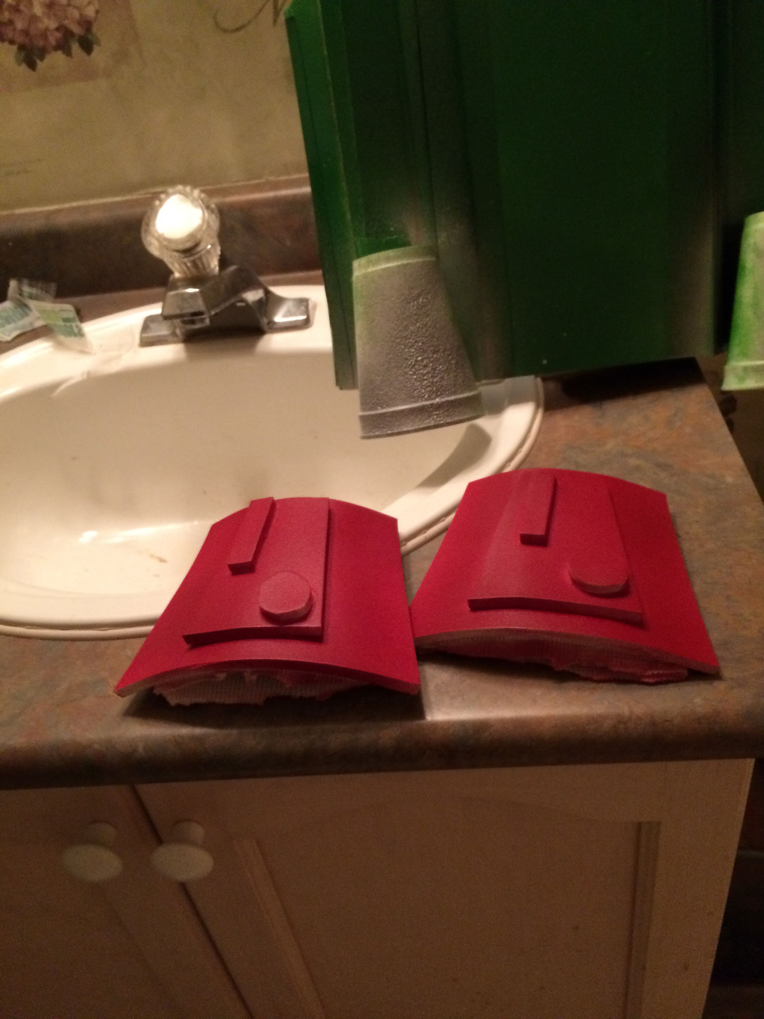

So here is where panic started in. I made some cheap gauntlets that he could easily take on and off if he wanted. I made them half sized so they did not completely go around his arm. Instead I took the sleeves to the shirt and glued it to the inside of the gauntlet. Then (not pictured here) I attached velcro straps to the underside to tighten them up.

Yeh... spraypaint and styrofoam dont mix well. Live and learn though i guess. Was it humid outside when you painted the armor? That could have to do with the tackiness.

I'm going to say that the tackiness was because of the paint reacting with the vinyl in the foam. Anything with vinyl or nylon is a bear to paint. Even if you prime it with a non-reactive coating, eventually the chemicals can still leach through and make things tacky even long after the fact. Best bet is always paint that's water-based or a bulletproof sealer. I don't work with foam much, so I can't say what the best sealer is. I always hear Plastidip or white glue. Perhaps the Rustoleum product is too different of a formula.
Glad it turned out in the end though.
