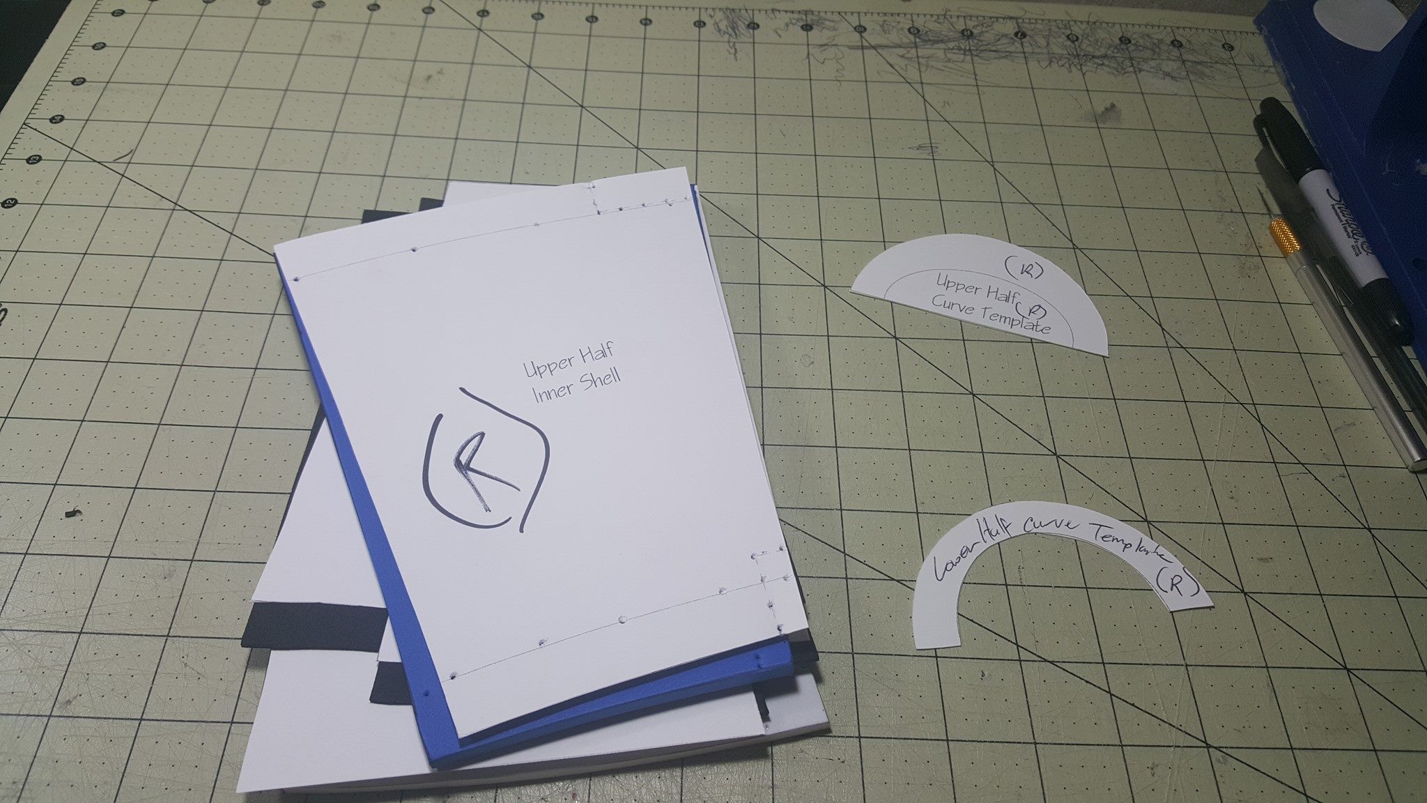

I seen some people where having issues figuring out these templates.
I hope this helps. I am using hotglue and 5mm/4mm EVA foam.

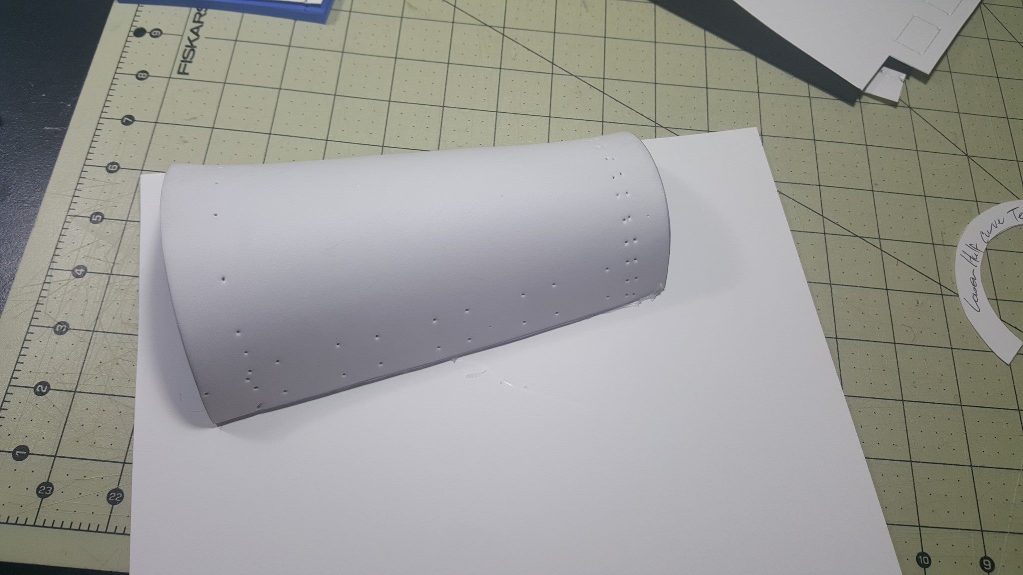

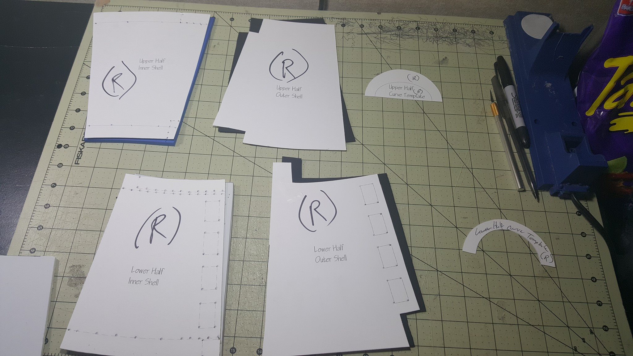

I cut out the shell templates. Mark the dashes into the foam. It will help lay everything out.
13323384_1634482196873998_3111182684775824250_o.jpg13308367_1634482233540661_8329147975070670501_o.jpg13340242_1634482030207348_3337509686306817615_o.jpg13316874_1634482076874010_9222829359138181412_o.jpg
I cut out the curve templates. Then glue to the edges they belong to (labeled on the templates).

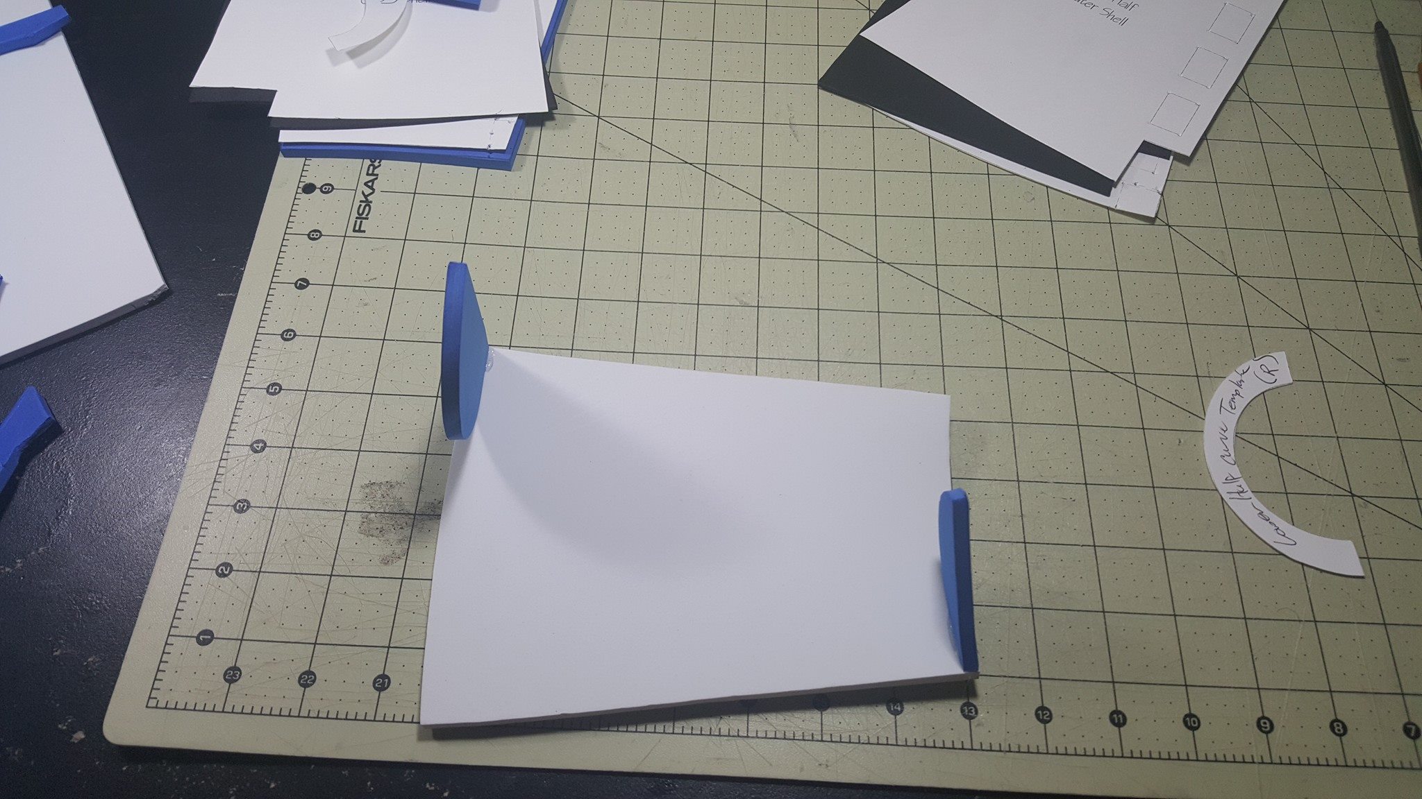

Glue to card stock, so that you can get straight edges. This helps line everything up throughout.
13323526_1635527346769483_1975395751690953897_o.jpg13320570_1635527366769481_6565281040025851763_o.jpg

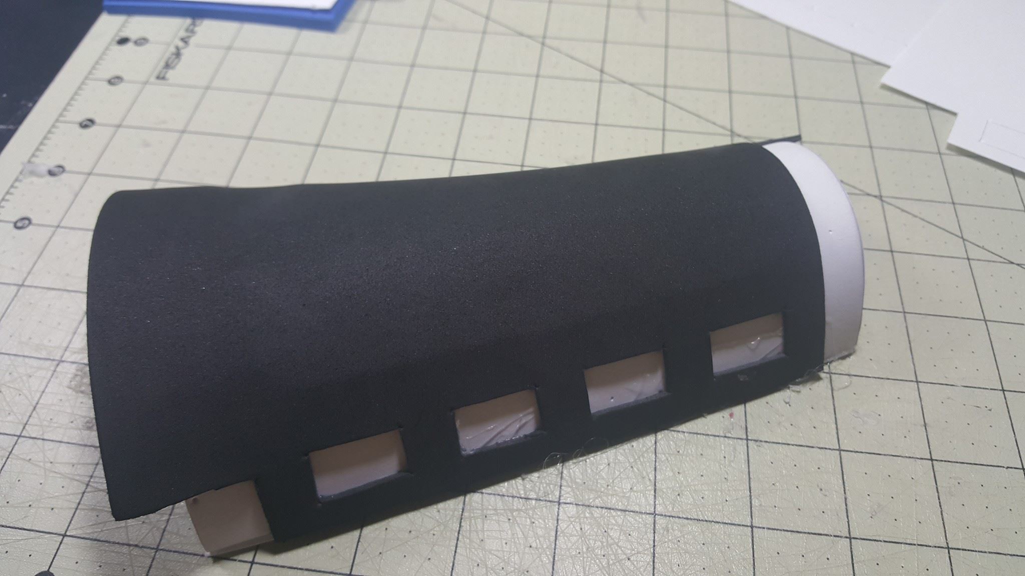

Line up the outer shell (3mm EVA foam) with the dashes you made on the inner shells (5mm EVA foam).
13320568_1635527390102812_3338363191058109434_o.jpg13350384_1635527503436134_3466710832313073610_o.jpg13350303_1635527520102799_7683727048317508455_o.jpg

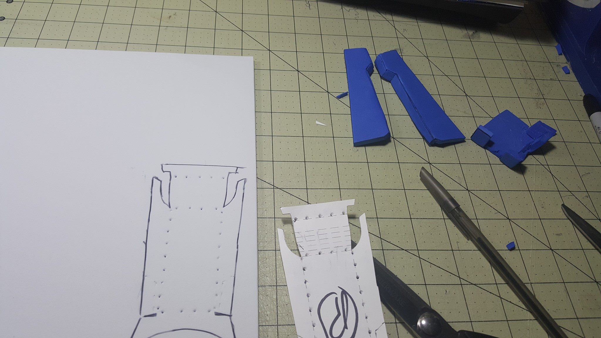

I trimmed the back extra off. I mistaken made my template too long when I cut it out of paper.
I then took all the extra pieces and built them like traditional Pepakura. The parts where pretty well laid right out as to how to piece them together.
13308626_1635527576769460_5907567804429142821_o.jpg13323177_1635527536769464_4140431995751899092_o.jpg13350427_1635527560102795_1094873641310843361_o.jpg

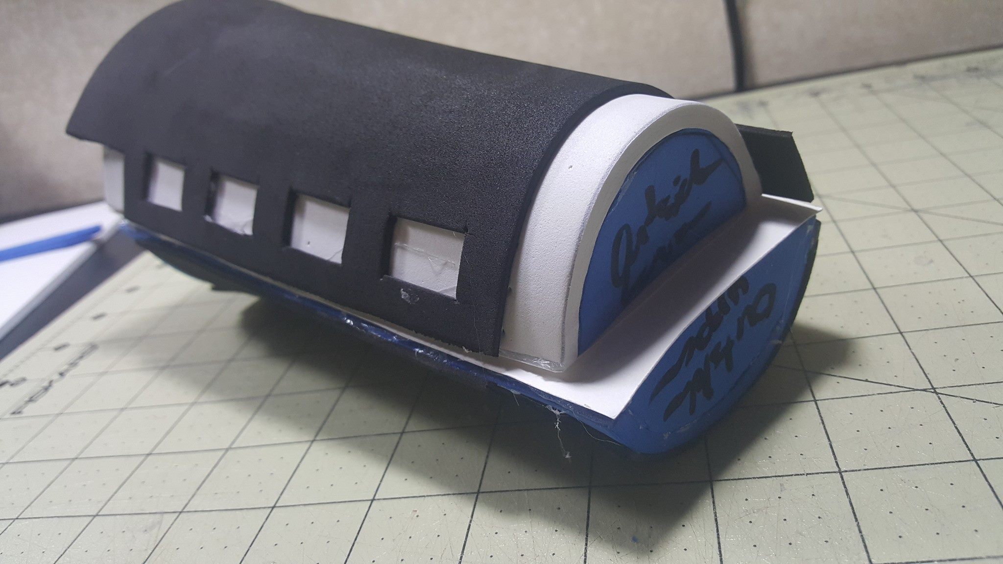

Started glueing them on.
