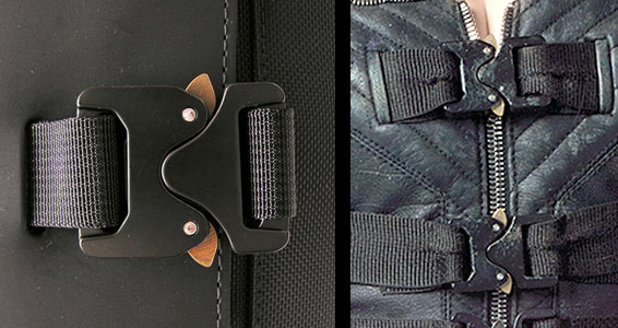

Here is a clear shot of her front from the bust up. Do buckles like those actually exist? I've been trying to locate them without success.
The borders of the panels with the decor look like they're made out of zippers, which is what I was planning to use.

blink 15.jpgblink 18.jpg100_1755.JPGThis is what I did for Hallowe'en, and I wore it to the X-Men movie (with more rudimentary makeup). I couldn't do the contacts cuz they don't come in my prescription. Buckles are from my local Joann's fabric store. Made from two thrift store jackets. Lots of beads, brads, fishing lure spoons, watch bands, etc.
