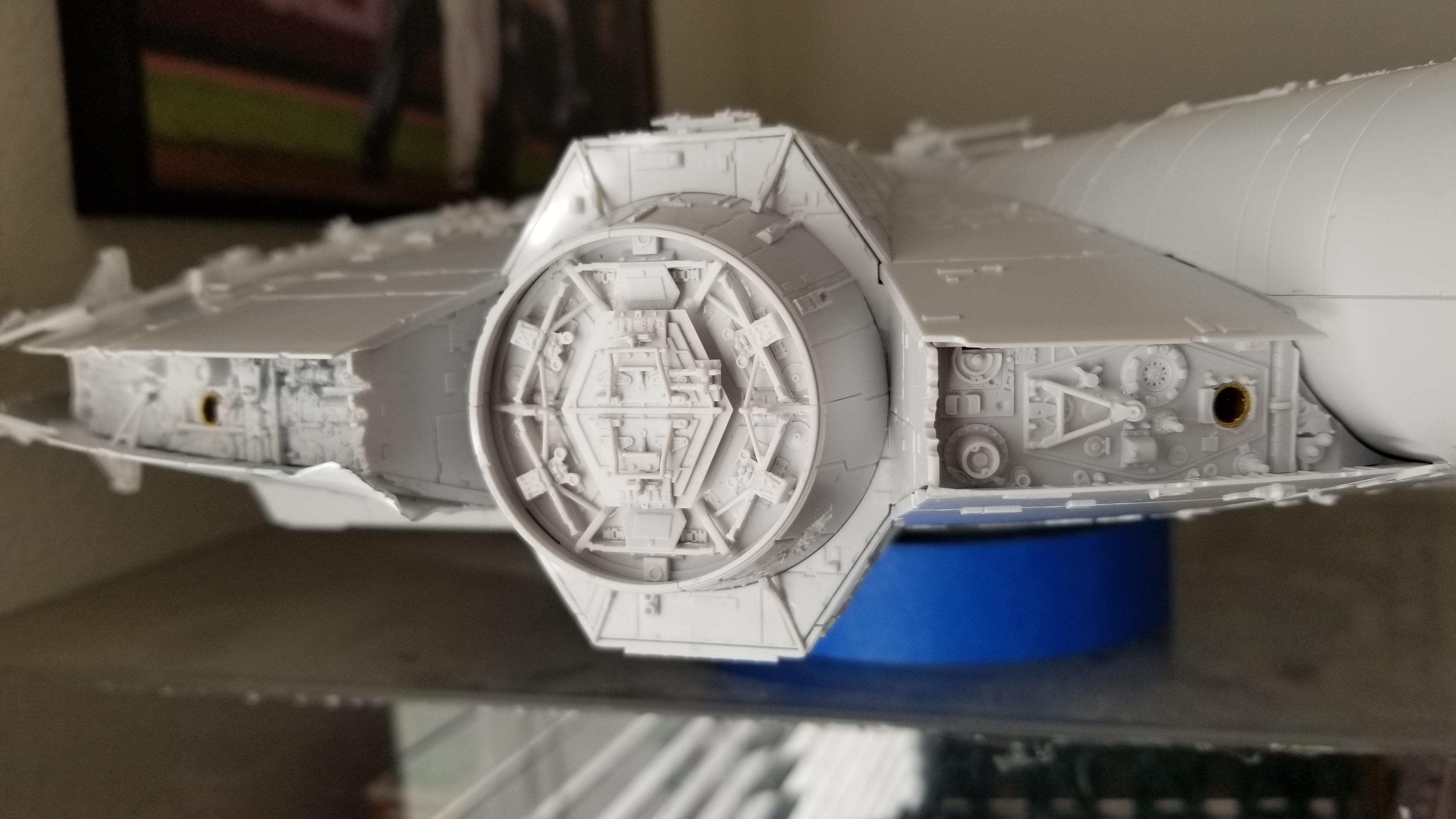

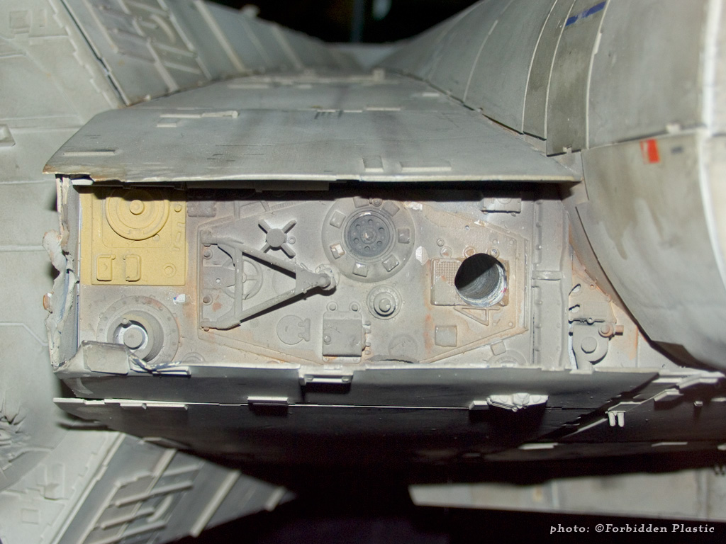

I'm trying to replicate exactly how the 5ft filming model looks, so that includes the bent hull plating and lifting access holes. I actually inserted some brass tubing to give it a more functional appearance. Of course, they will be painted. What's funny is that they are actually function.
How do you recommend bending the hull plating without accidentally snapping it off?

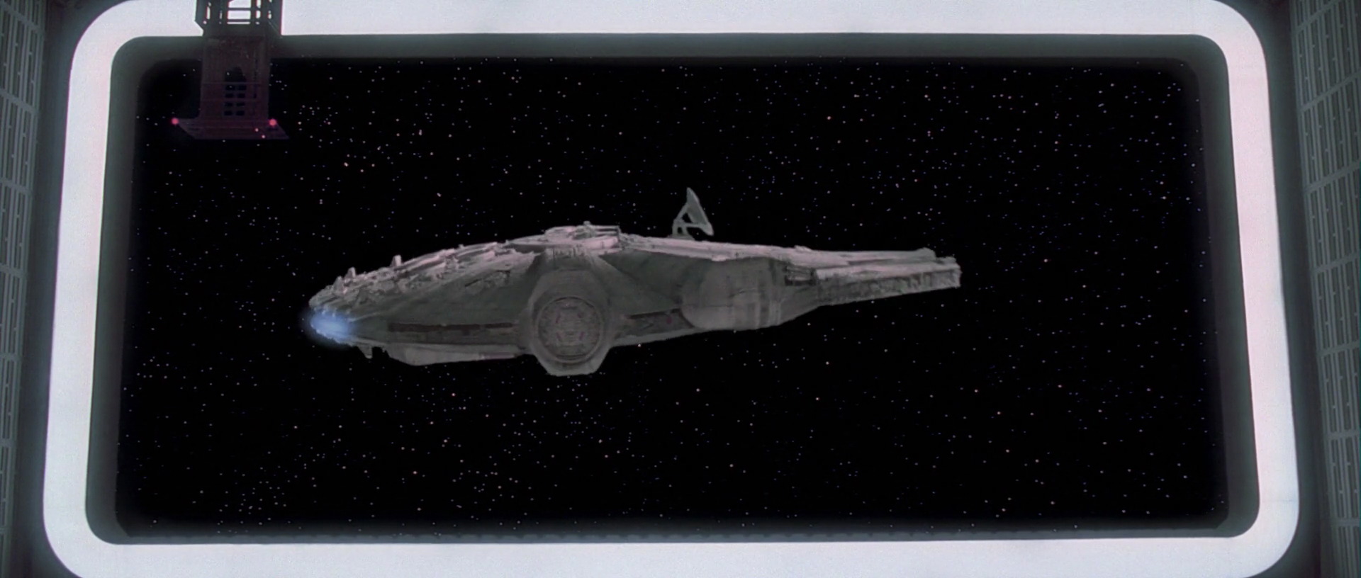

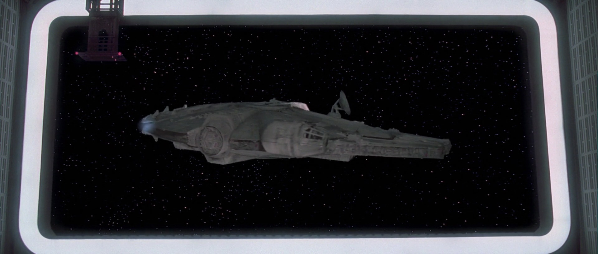

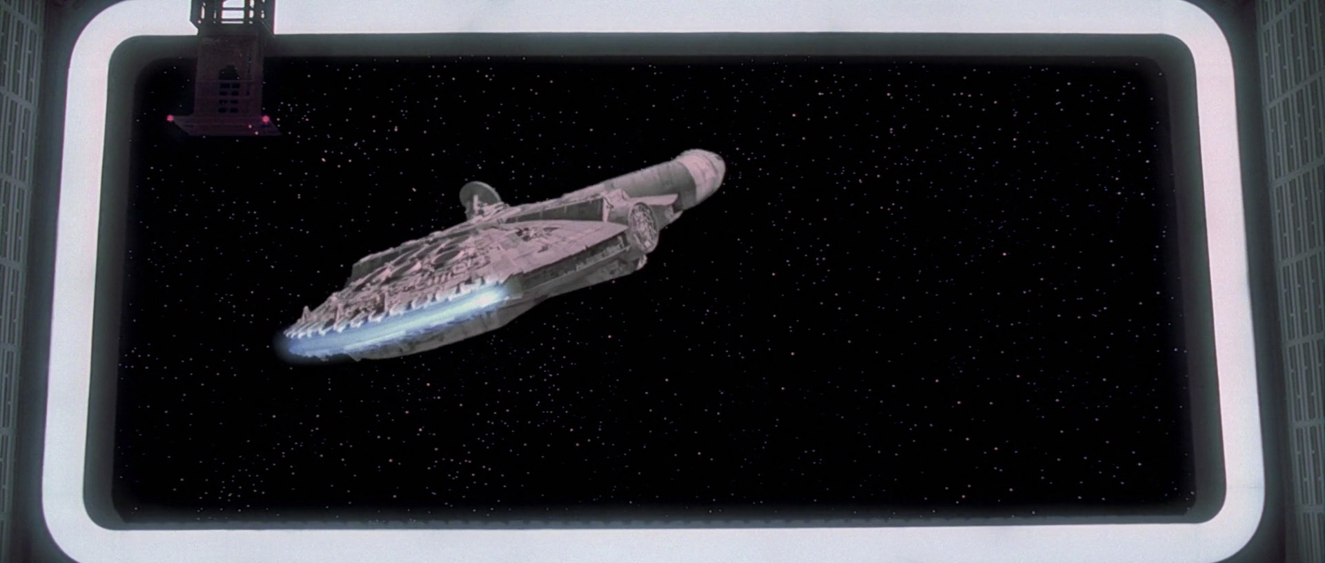

I'm doing this too. High five! From this screen shot, it looks like the hole just aft of the cockpit tube may have some sort of red plug covering it. Or maybe the threaded brass tube is reading reddish on film. The hole on the panel closer to the engine looks blue in one frame, but black in another. Hard to tell.
I used a small pair of needle nose pliers. Heated the pliers with my stove top and bended slowly. Just practice on something to get the duration of heating right. You don't want to melt right through your falcon. I also sanded off the ribbed surface of the pliers smooth so I didn't leave texture marks on the plastic.
Note, that I didn't use the pliers to bend the extremely buckled piece just behind the docking ring. For that I used a separate sheet of styrene, heated it over the stove top and bent to shape. I then grafted the piece onto the existing armor. The falcon armor was too thick in this section to bend that extremely, plus this way it has the look of the multiple layers used on the actual model.

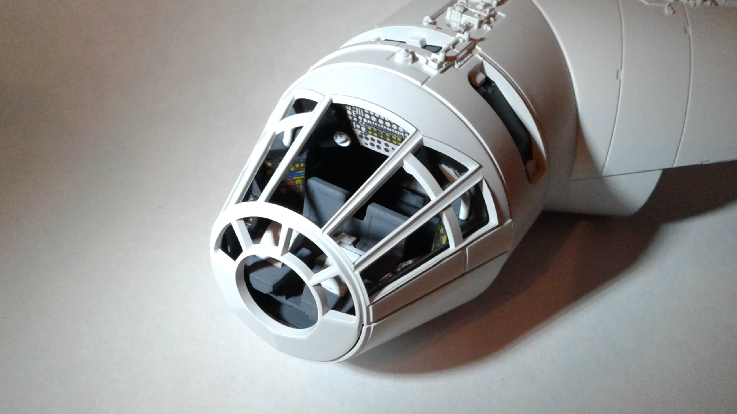

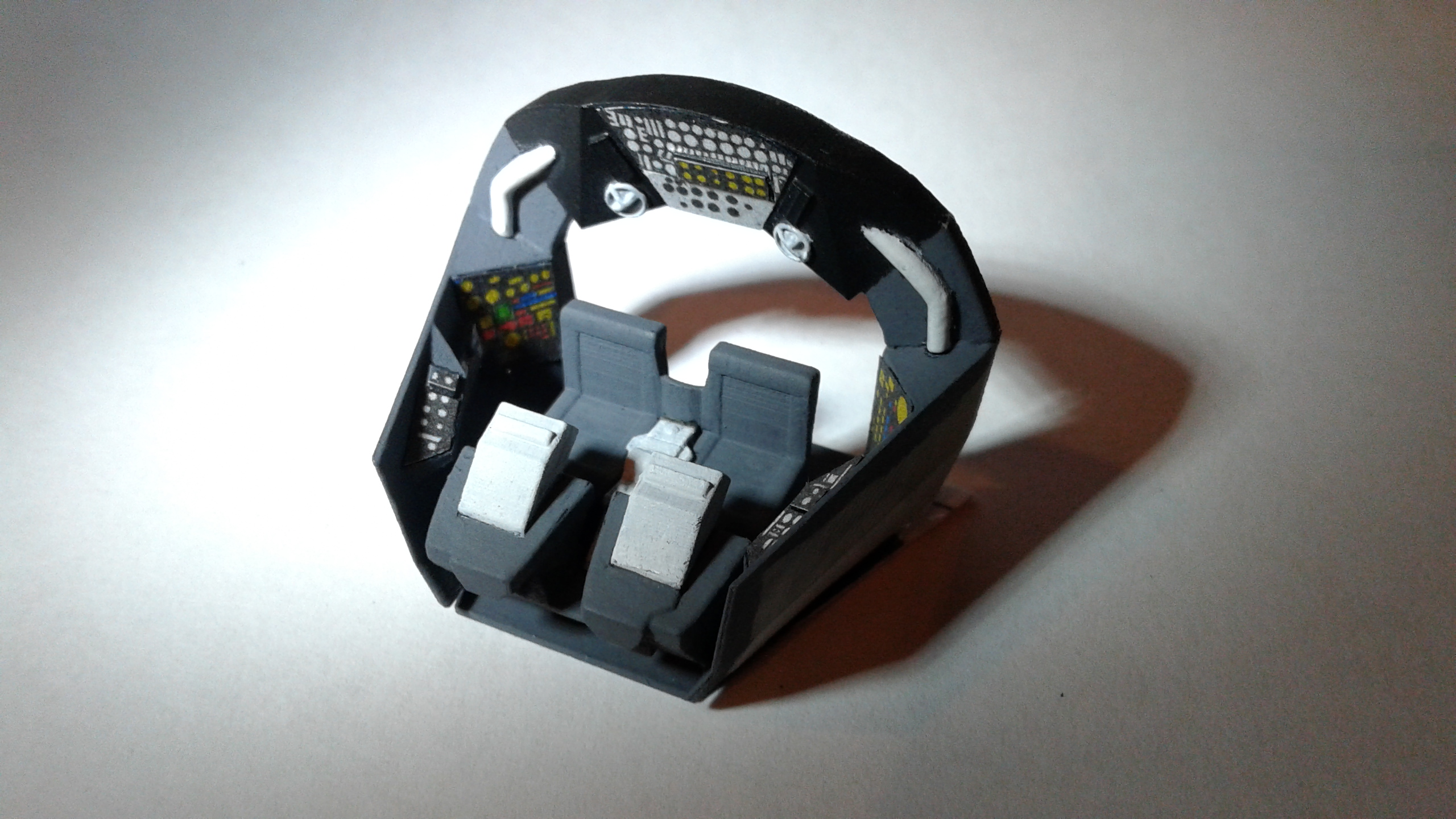

Repainted the cockpit because it was far too dark originally--almost black (the back wall actually is black, but the rest of the cockpit is a dark gray)
I'm currently working on finishing up the last few graphics. A note to those who would like to do this modification: do not fully assemble Bandai's cockpit interior and cockpit tunnel, or at least do not have it all glued together and impossible to take apart--to have this studio model interior and the set interior easily interchangeable, the set interior will need to be cut in half (as in the section with the back seats is separate from the section with the front seats). It is a fairly harmless modification that I will be discussing in the near future for those who are interested.
I'm holding off on the cockpit section of my build for now for precisely this reason. It looks awesome! Definitely interested in a set if/when you make them available, Joe.
