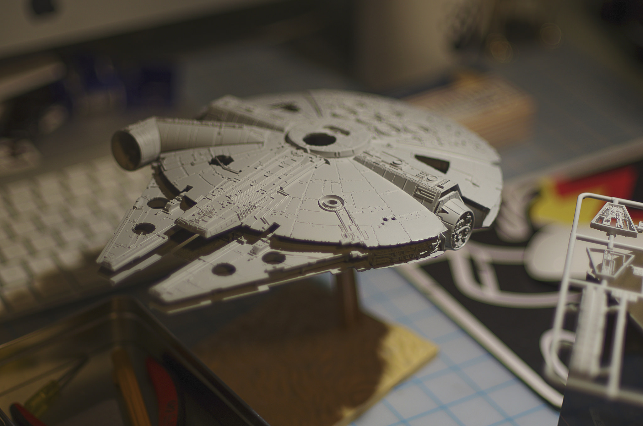

Yeah they're definitely next on the shopping list. I'm all in now. Primed with a coat of tamiya rubber black. Gotta try figure something else out for the base coat cos the insignia white and deck tan are totally sold out and unavailable. Read this morning that Vallejo model air 045 is the equivalent of deck tan and can be mixed with flat white for a spot on base coat. I wonder. No going back now anyways.Wasnt sure whether to build and then prime..decided to do it on the sprue frames..went with it

I had trouble getting Insignia White. I reckon it's all those De Agostini collectors buying it up :) From their websites, I see a few stockists have shipments due in the next couple of weeks.

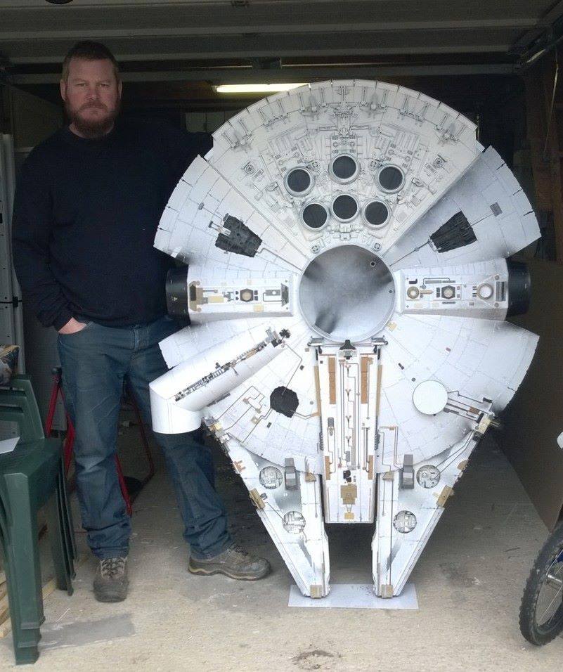

That is glorious!
I have to say, I have never seen or heard of anyone completing a studio scale model of the 5 footer.
Has anyone else?
Would it it be easier to be accurate to details building on that scale? I wonder
easier on on the eyes certainly. Screwy 1/144 making us blind
