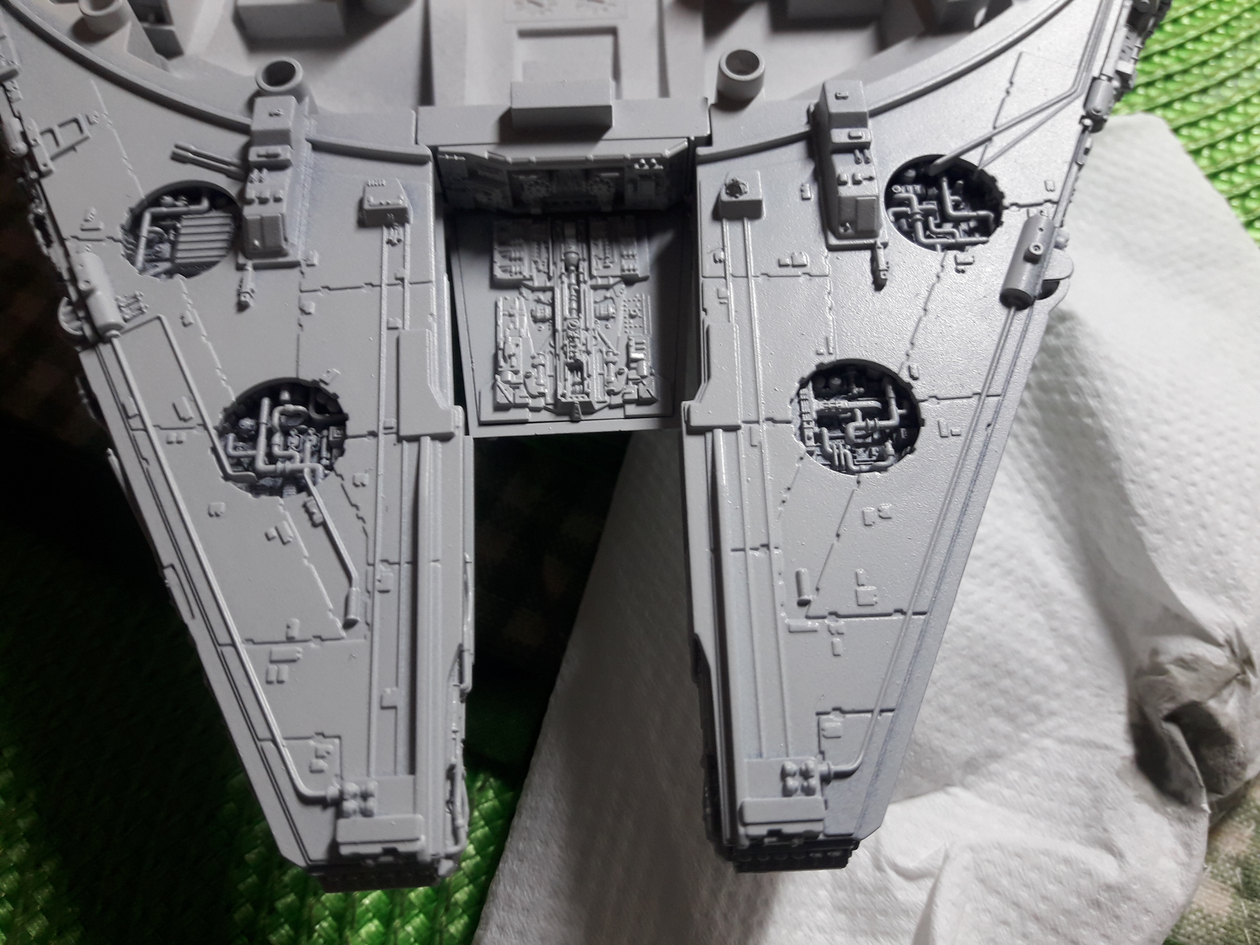

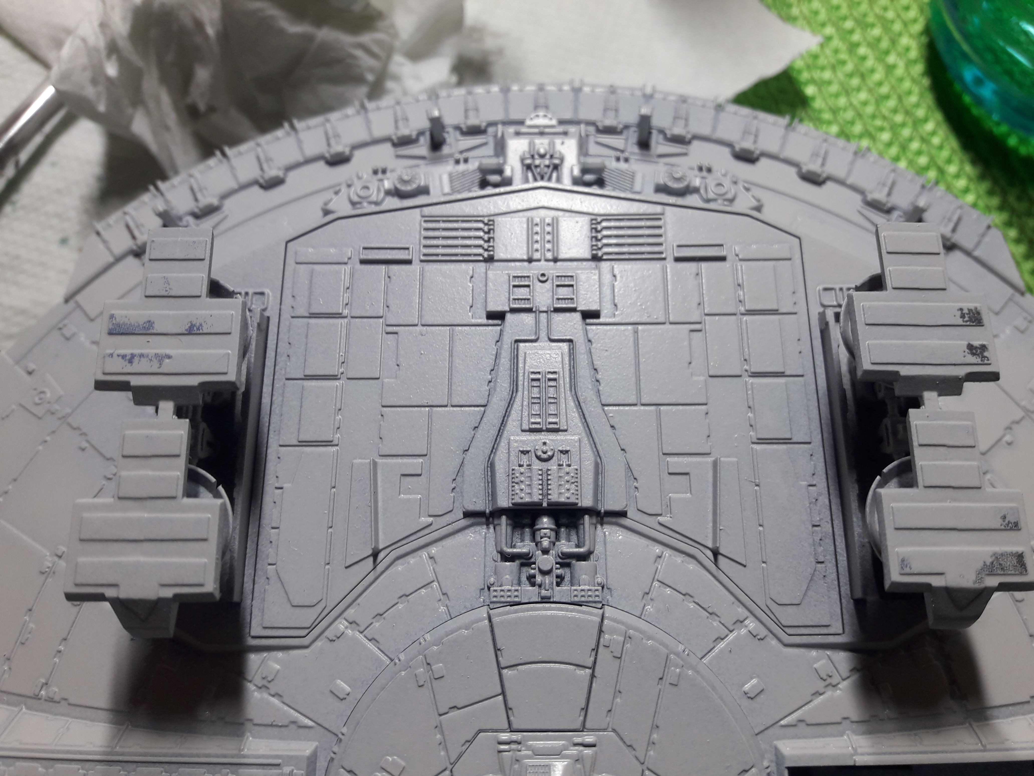

I am buildinhg the 1/144 bandai falcon and i have reached the painting phase and i would like some opinions on the colors. I primed the model with vallejo grey primer but after drying it is too white in order to see my paint coverage so i paitned the model with a light gull grey and did some presading. After that, per the model's instructions i mixed some light gull grey and offwhite (since white had ran out and the tone of offwhite and white are the same to me) 45% - 55%. This is the end result of the model and after starting with the decals on the model. The final color of the model is kind of dark for my liking with the decals on and i am thinking of repainting the model again, as for the decals in case of starting the painting again i will not use them since they are troublesome at best with using lots of decal solution in order to put them on the model. I would like some opinions

Hi kookoogr and welcome.
I just bumped the thread on the bigger falcon:
Look in there for lots of good stuff. I think Tamiya AS-20 is the choice of a lot of people, but your mileage may vary.
If you are looking to match the color of the studio mode, then I think you might have gone too dark/gray. It's sometimes hard to tell in pictures what the actual color is though.
However, modeling does not always have to be slavishly copying things, so if you like the color, than go with it. I went for a greyer mix than normal for my Fine Molds Falcon since I was emulating the old MPC box art where it appears greyer.
If you want to get closer to the studio model, I think you could do a light coat of white mixed with a little tan. If you do heavily thinned mist coats, and take care around the decals, you might actually be able to leave them on as is, And in fact, the mist coat will help dull the decal color a bit making it look more faded and could actually wind up fitting in better instead of being so contrasted. That's one of the reasons I normally skip decals for markings like that
Not knowing what paints you use, I generally have been starting with one of two methods to get a base coat for the "off white" models
On is a base of Tamiya Flat White and bit of Tamiya Deck Tan. How much Deck tan depends. This gives you a good start for the creamy white of the Falcon or A-Wing and B-Wing
Sometimes I also add a very very small amount of hull red and or XF-19 (Sky Gray)
The other is Tamiya Flat White with a bit of XF-19 for a greyer white like on the Snowspeeders. Varying the mix and going heavy on the XF-19 and just a bit of white gives you a great grey for the AT-AT and AT-ST
Another good gauge is the actual color of the actual bare Bandai plastic. IN most cases it is actually a great color match to use as a base coat. I often will mix paints and try to get them close to the original plastic color
