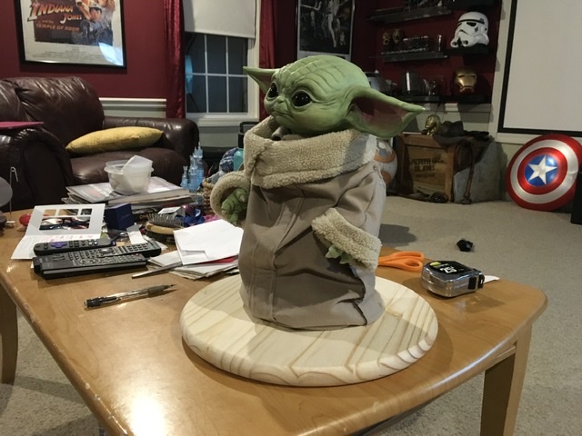

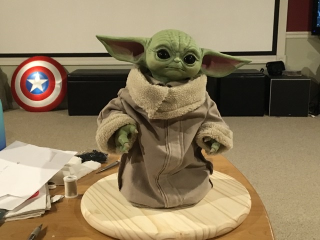

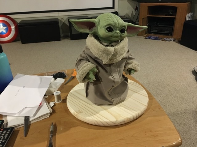

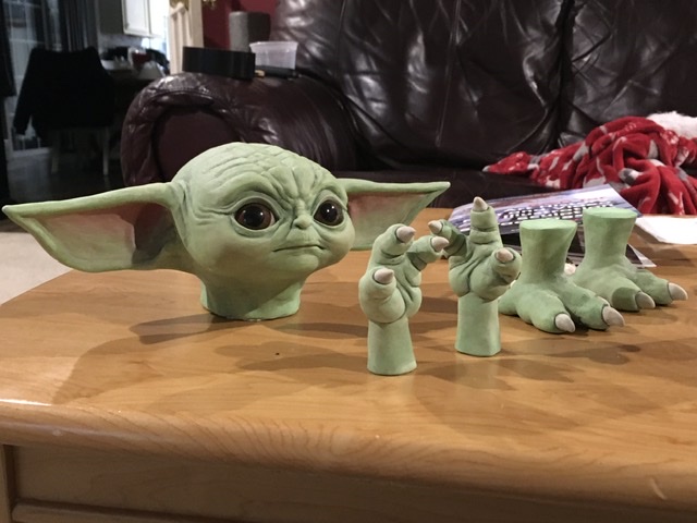

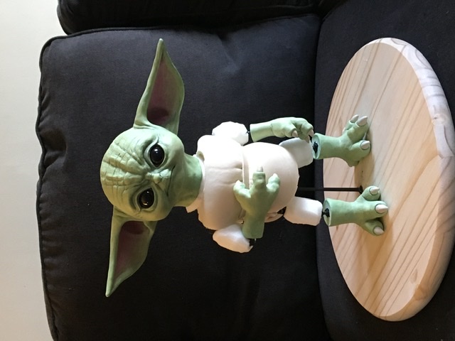

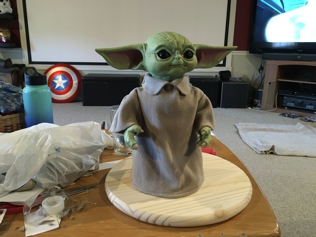

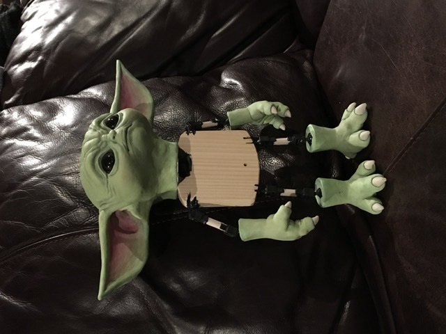

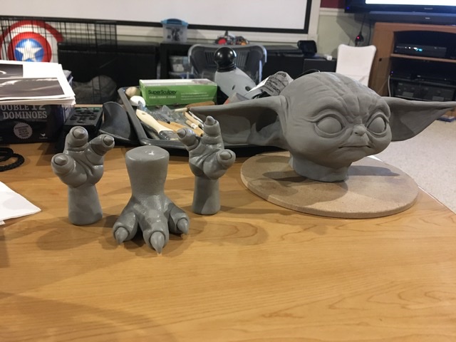

Here is my full size Baby Yoda. I sculpted him with Super Sculpy and made some resin casts. Painted him up and installed some animal eyes that I got at Joanne Fabrics. Made a fully potable body using Knex ball joints and a sink spout ball joint. Padded him up and custom made his robes from fabric I got at Joannes and an old coat I found at the Salvation Army. Really happy with the result.

Are the eyes you found at Joann's full spheres or just the front? I want to make an animatronic Baby Yoda at some point but I need his eyes to be mostly in a sphere form, not just a front bit with the back completely cut out
it is just the front. They are not spheres.

For the eyes on mine I ended up buying 20mm animal eyes from Joannes Fabric. I did have to use a small amount of apoxy putty at the edges of the eye to get rid of the small gap. These ended up looking much more the part than the painted eyes. I still include the resin eyes with my kit incase you want to try painting them. As far as the color goes I started with Krylon Pistachio as the base Coat. Then I just use those cheap craft paints from Walmart. I do a lot of mixing though to get the color I want. The paint is called Craft Smart and the green I use is Lush Foliage, but it’s mixed with a lot of white to get the right shade i like. It’s pretty light but gets darker when I start to do washes to bring out the details.
