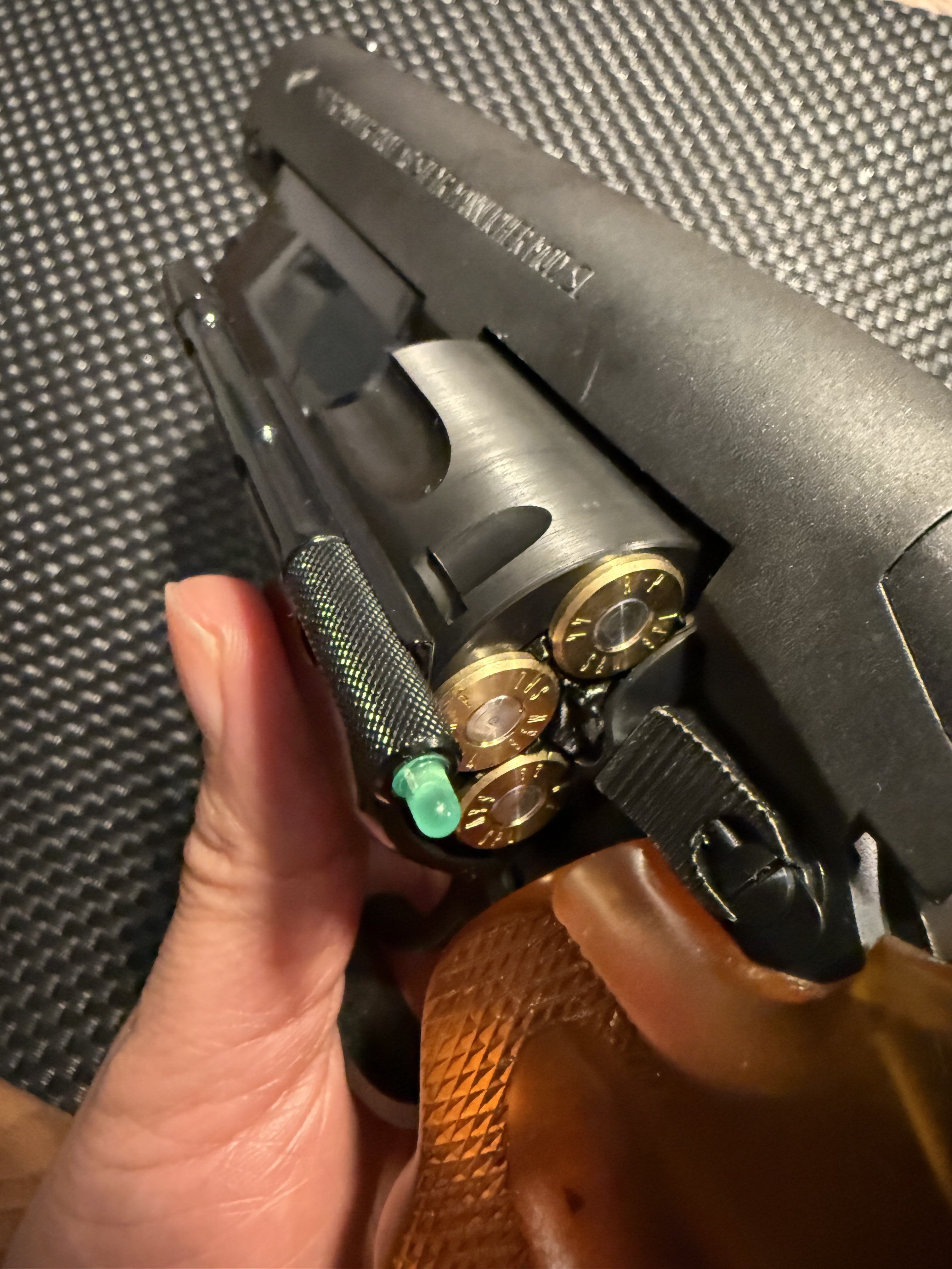

Hi. I bought a barrel and a cylinder from Teddz. I just got the Paragon FX Elite today and installed the cylinder. It fits and functions perfectly. I haven't done the barrel yet since it requires a bit more work, but looking at it next to the blaster the diameter is the exact same and I have no doubts it will fit. Unfortunately I think Teddz has run out of the parts now.
