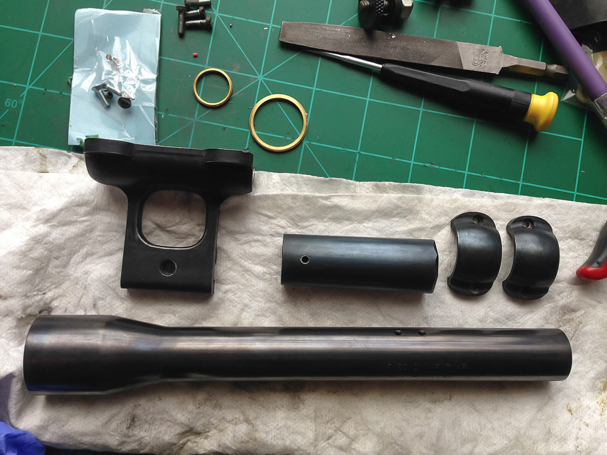

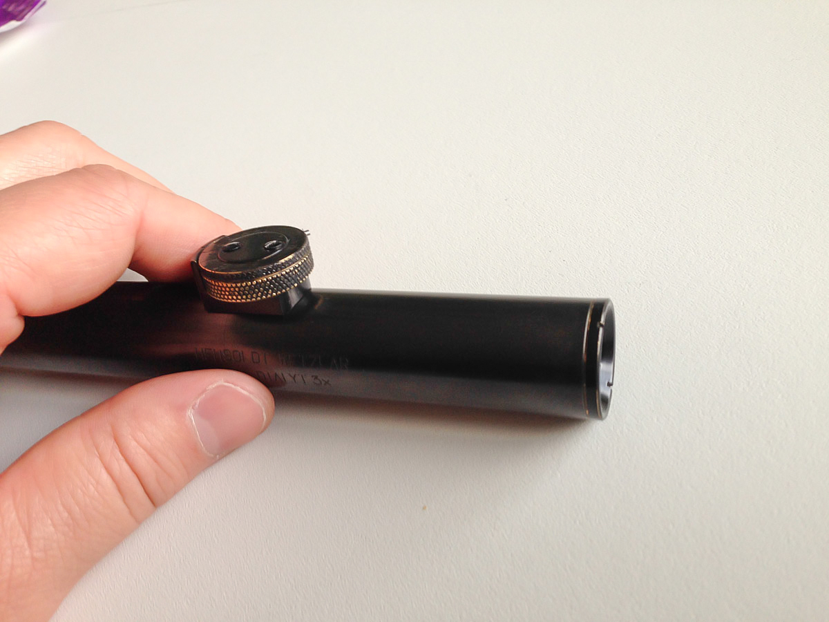

The first thing I did was take the aluminum bull barrel, and the scope mount, scope, and rings and get them blued. I used Birchwood casey Super blue on the steel scope, and Birchwood casey Aluminum black on the AL bits. Getting aluminum to resemble blued steel is doable but takes a TON of work. I mean, you gotta apply AL Black, buff, polish, re-apply, and repeat over and over and over and over. The results are worth it though.

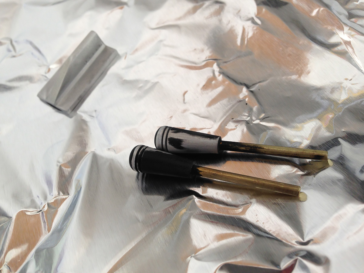

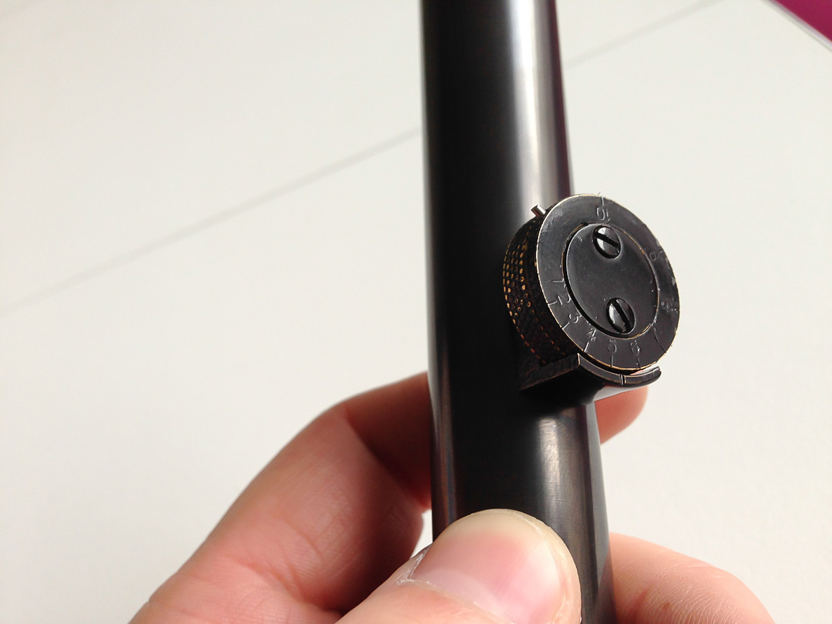

Then I painted all the brass scope fittings with Satin Enamel, just like the real Hendoldt scopes. I did a thin pass, and baked all the painted parts for a cure. I didn’t go thick since I would be weathering, and if you bake straight wet paint you get a natural thinning on edges, which really helps the weathering.

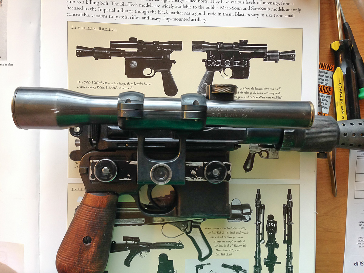

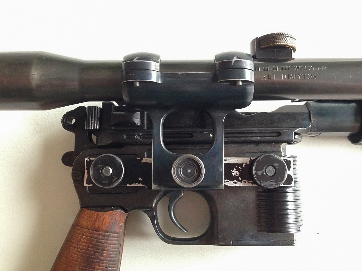

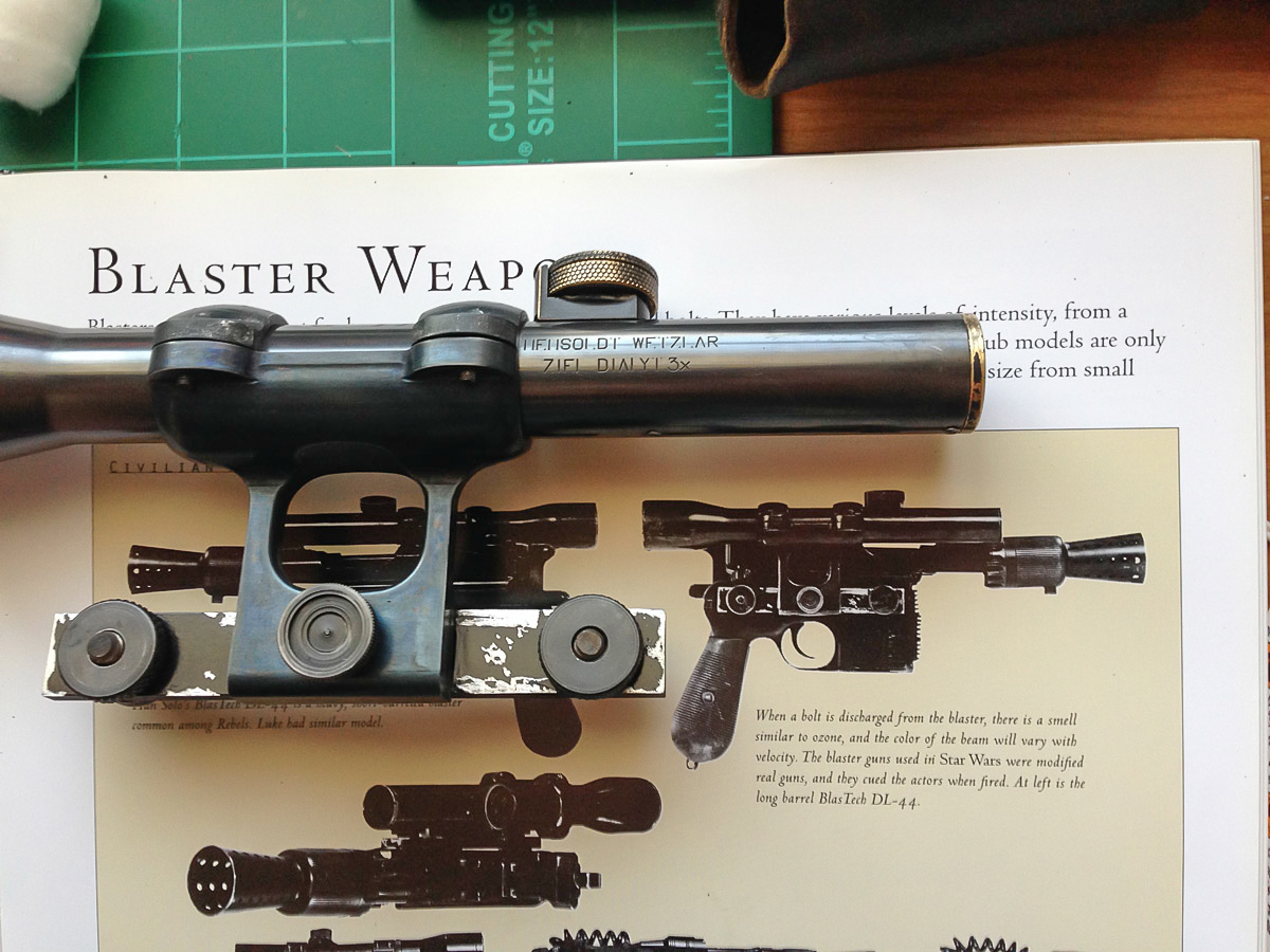

I weathered up the scope, then started on painting and weathering the mount cross bar to be as prop accurate as I can with the Chronicles and reference pics.

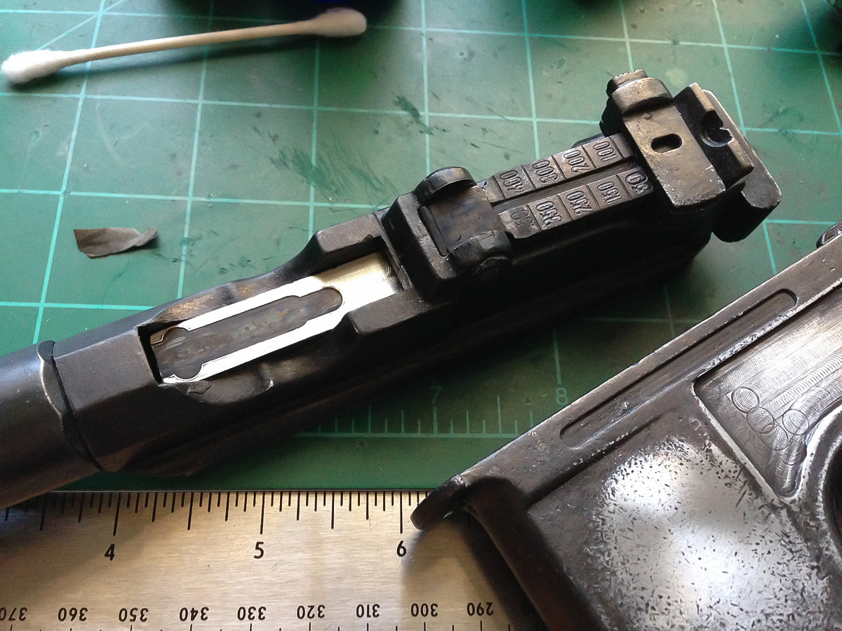

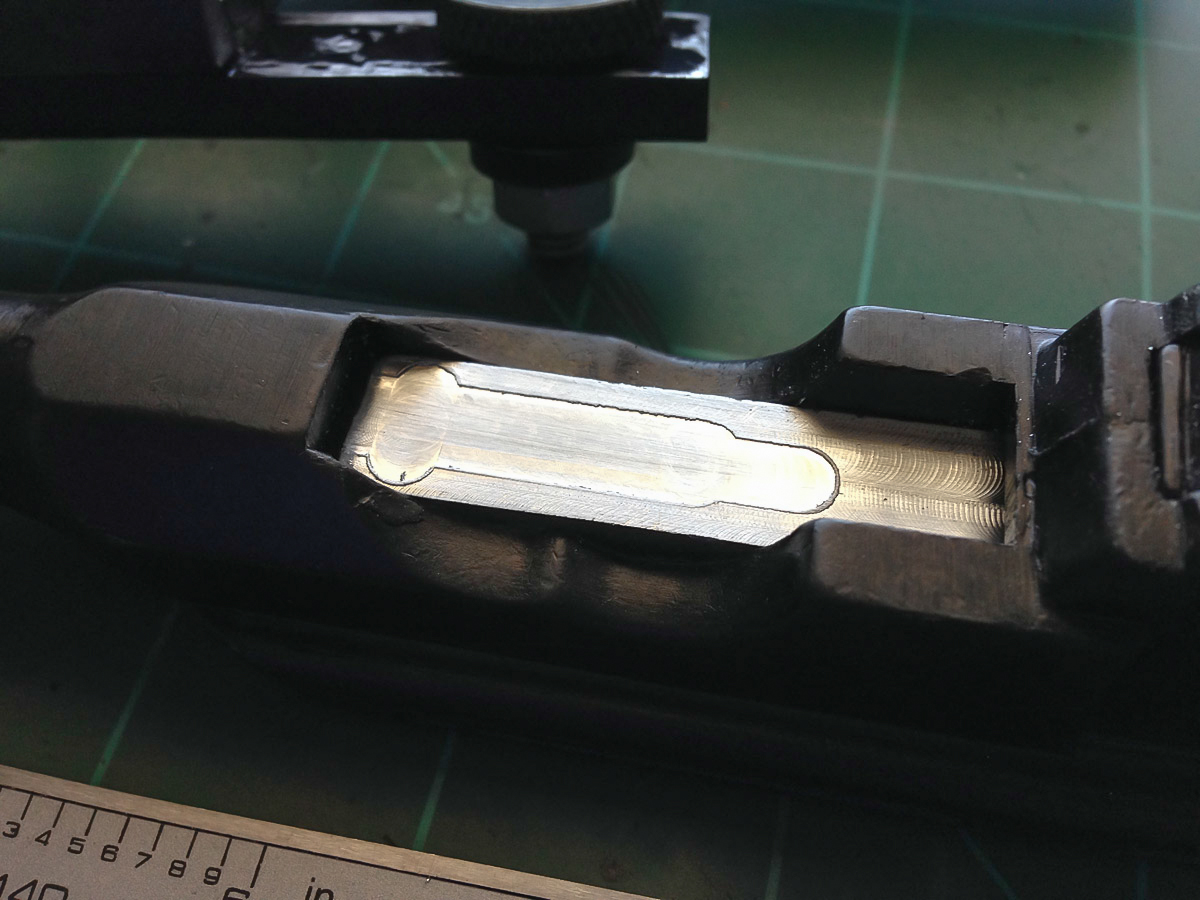

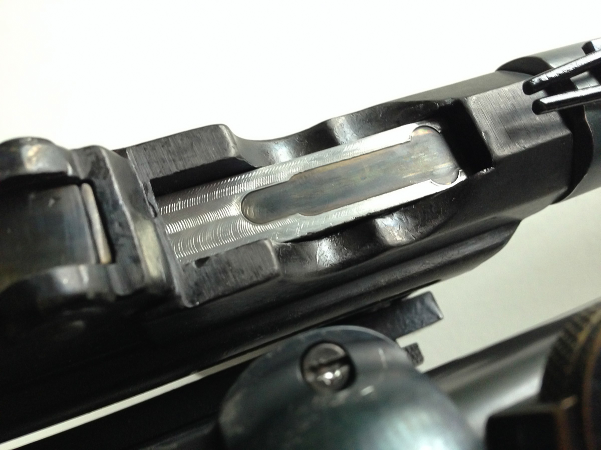

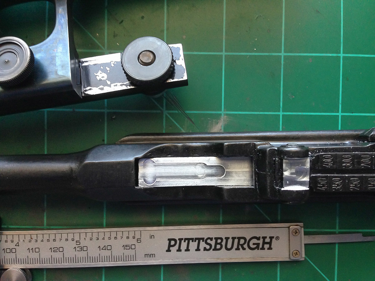

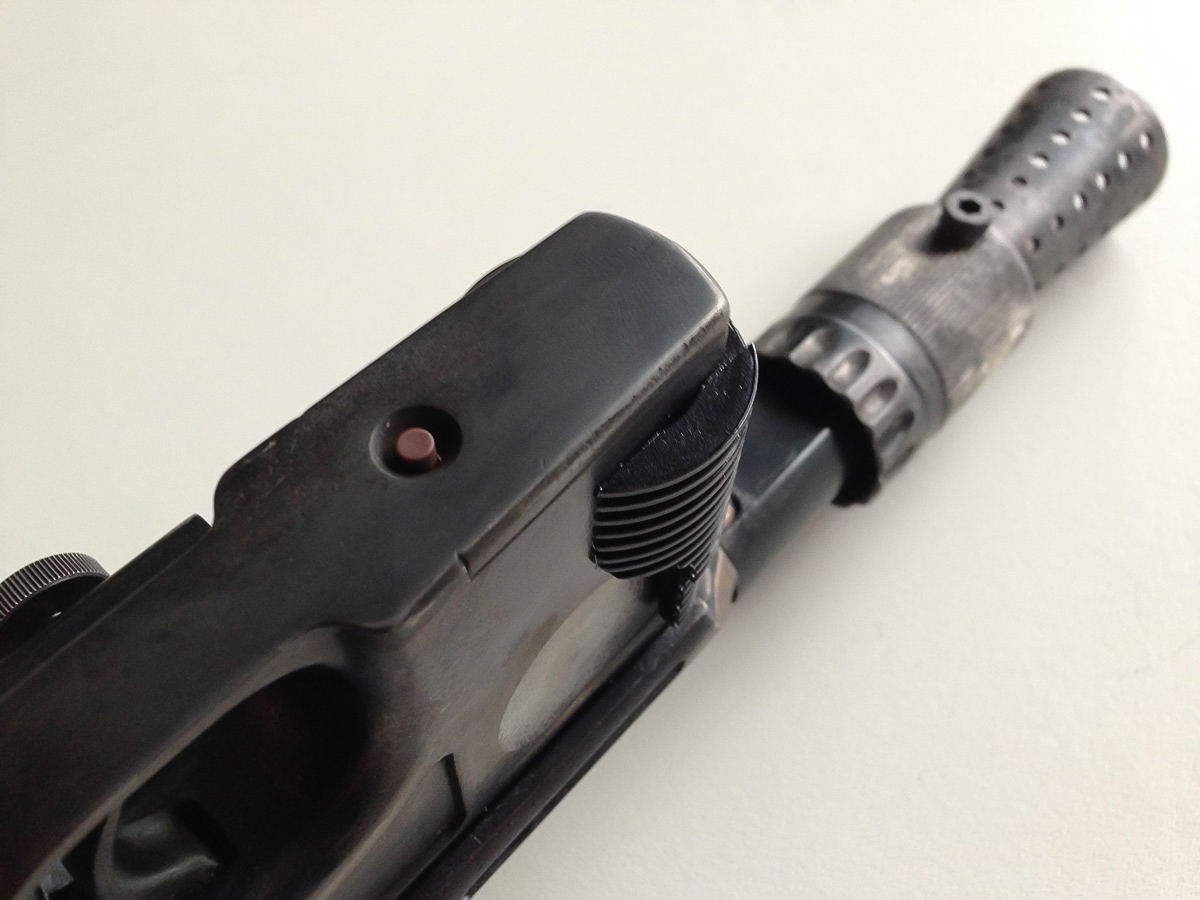

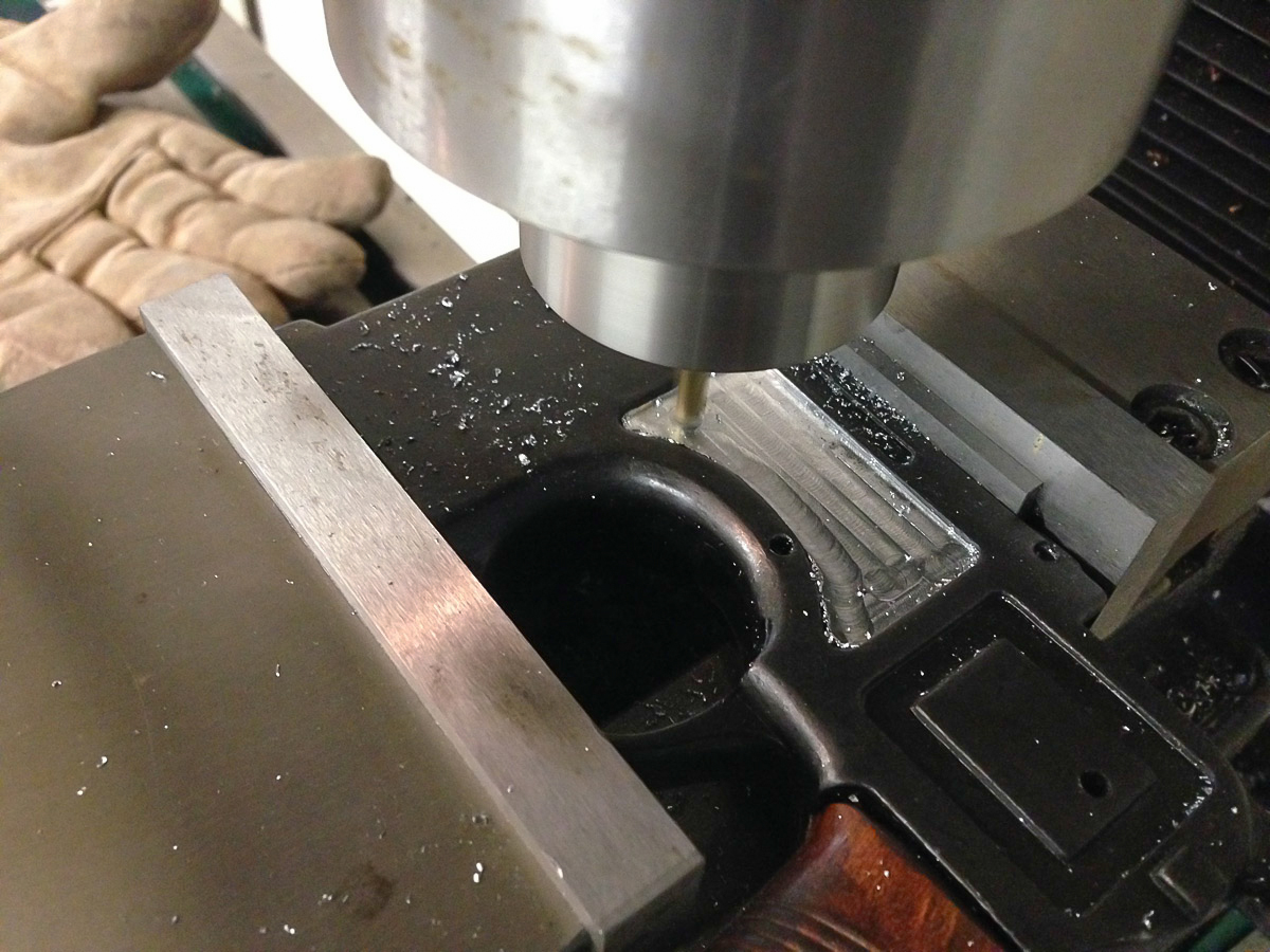

Next I decide to start the metal work. I decided to mill the plain jane Denix Bolt down flat (It’s all crazy mottled cast metal) and mill in an extractor. I used my real Mauser as reference for the dimensions of the extractor.

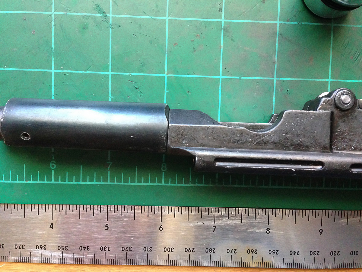

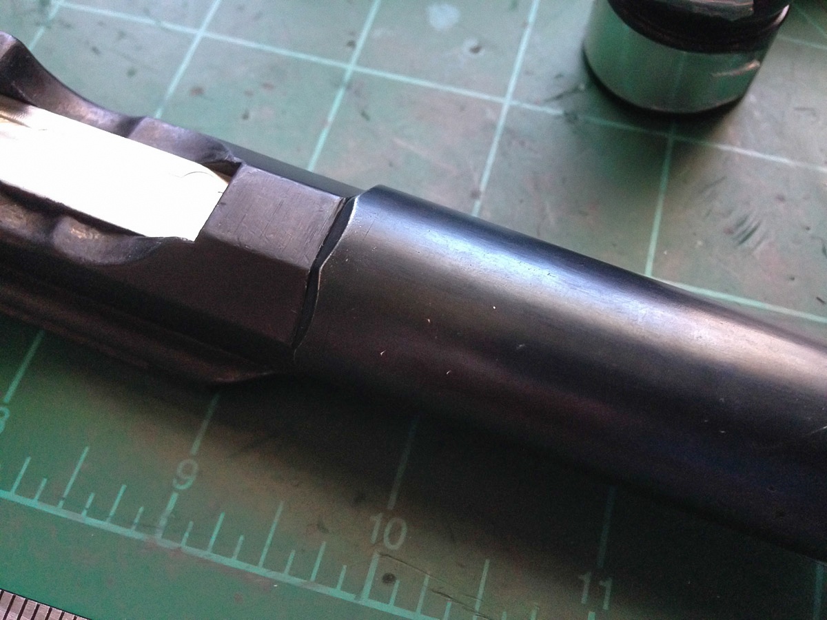

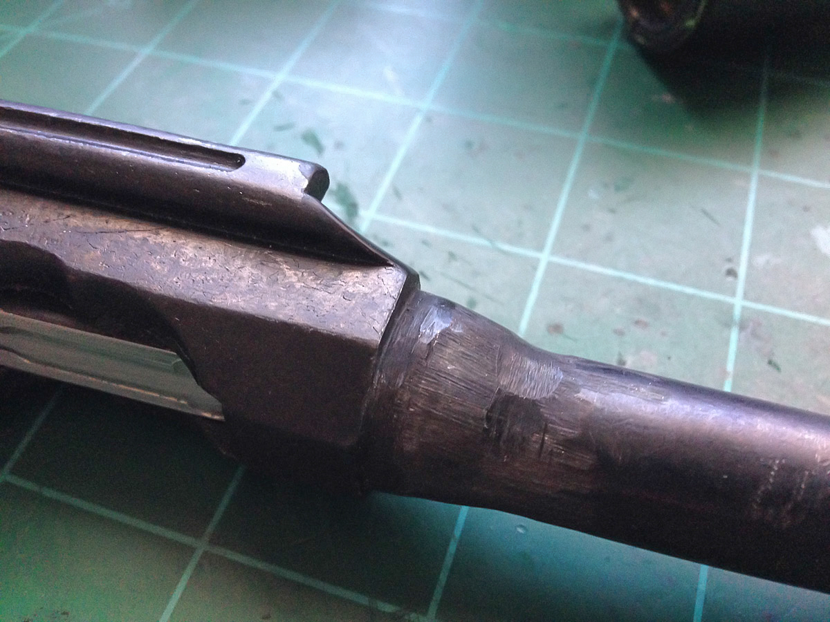

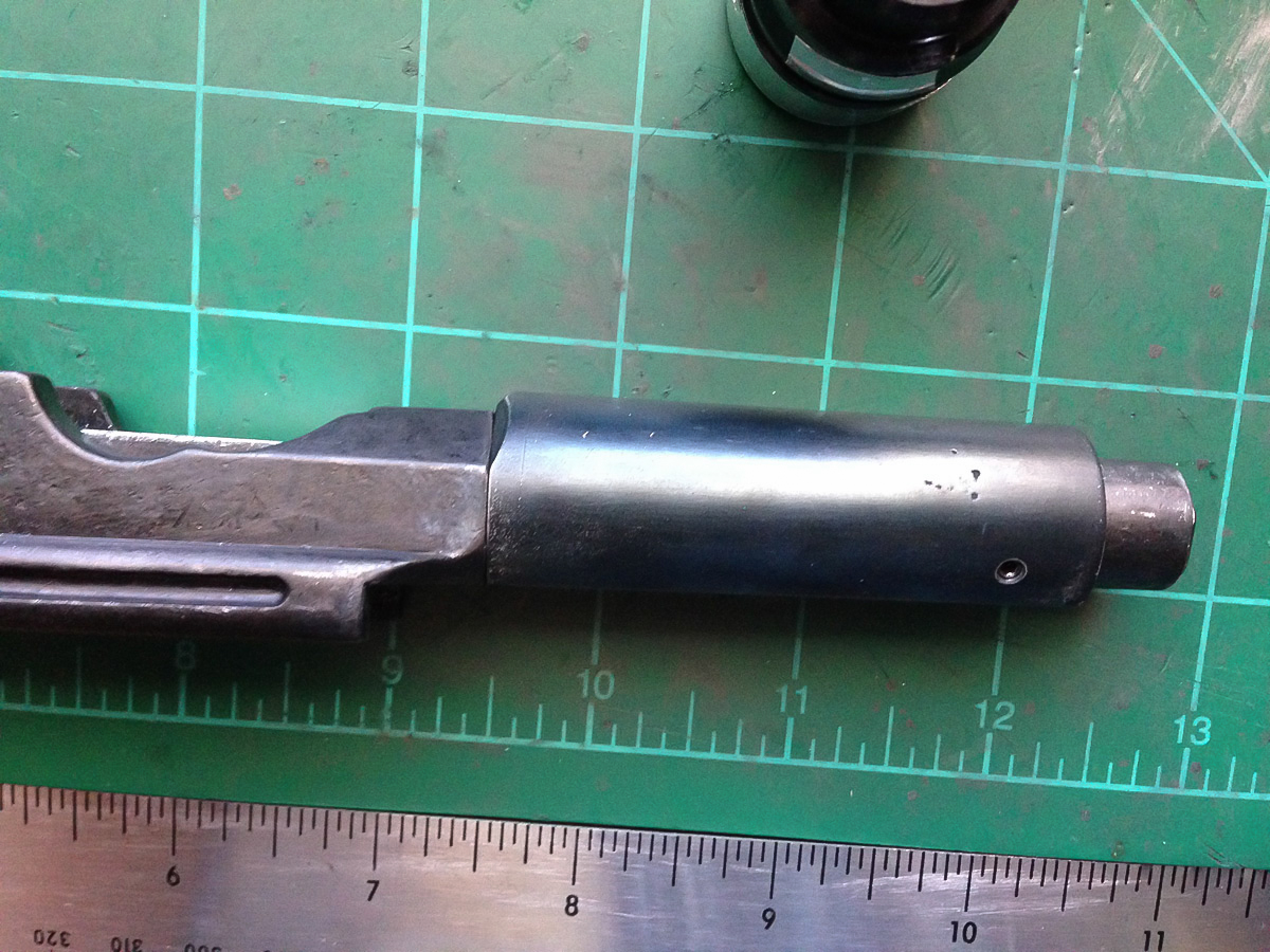

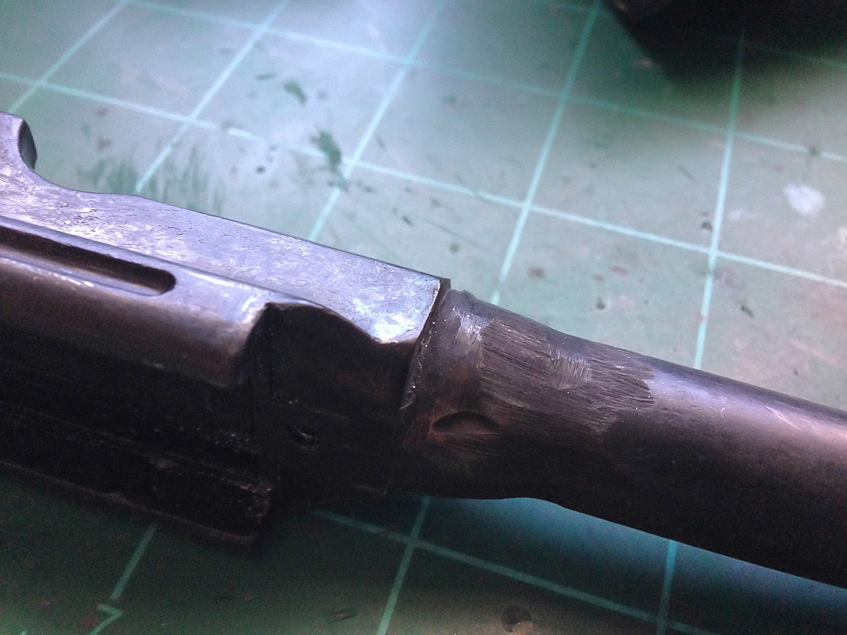

This part had me cussing. Fitting the sleeve bull barrel isn’t as easy as just sliding it on, when you want prop accuracy. It needs to sit a certain way, and dang it I will make it so. It took a lot of filing and finagling to get it right.

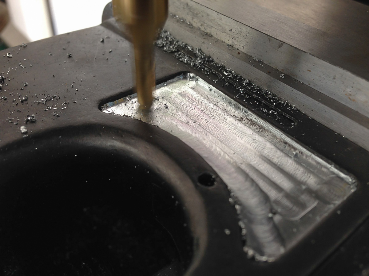

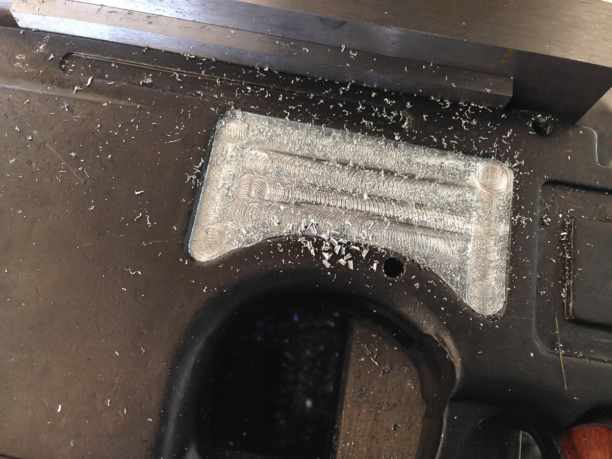

Then it was time to remove the denix and Spain logos from the side. So I milled it like the real Mausers are

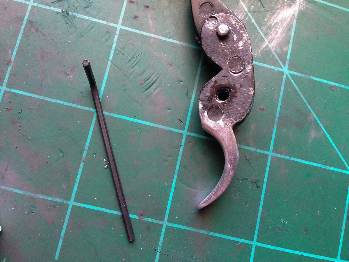

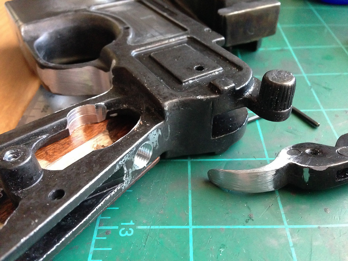

Also I hand filed and reshaped the nasty, fat, blocky, denix trigger.

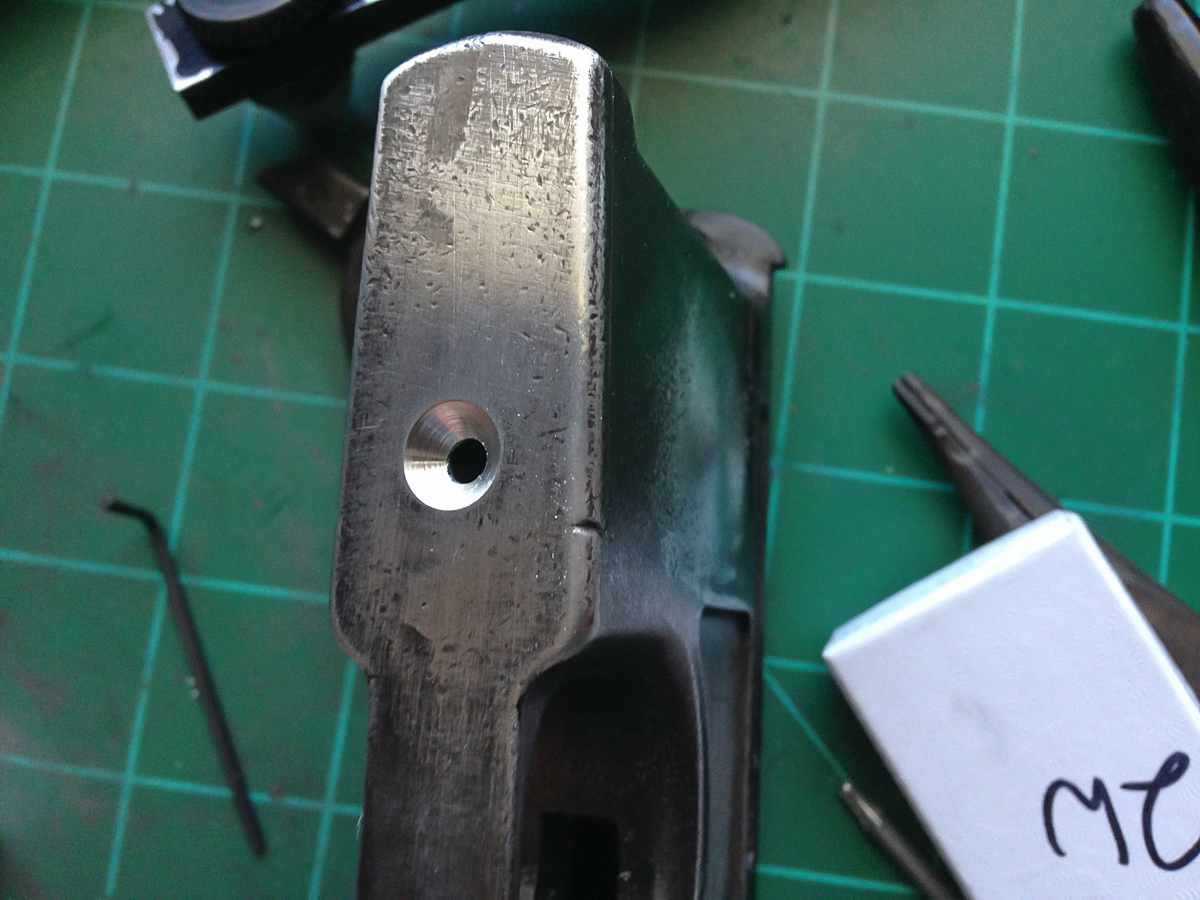

Then I added my auxiliary button hole to resemble the mag plate release on a real Mauser. It can’t be in the correct spot due to structural issues inside the denix, but close enough.
I also widened the gap between the grip frame and trigger guard. Now it’s not narrow and uncomfortable anymore, and more accurate.

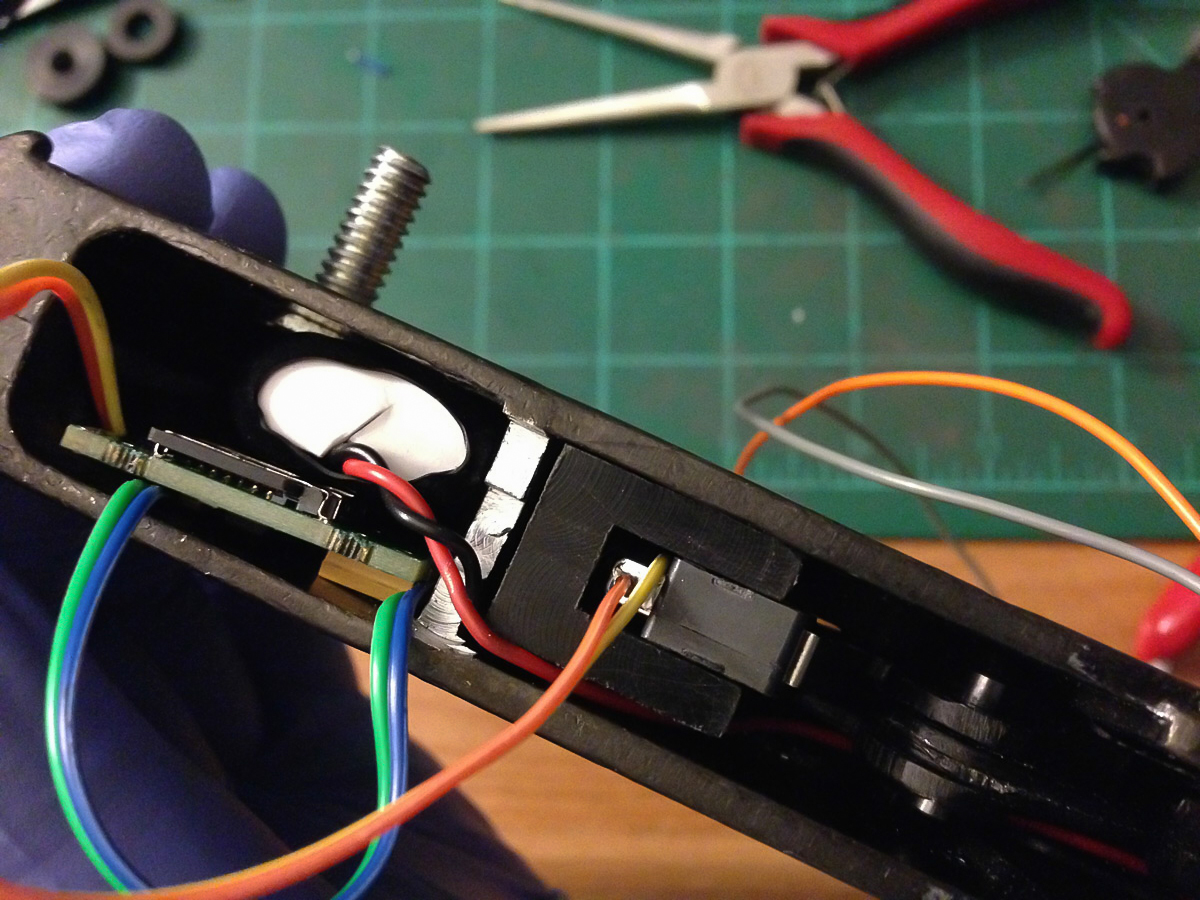

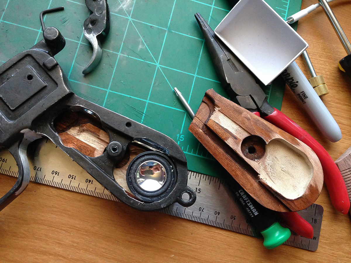

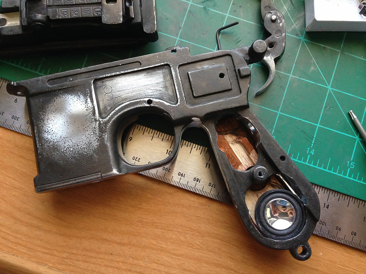

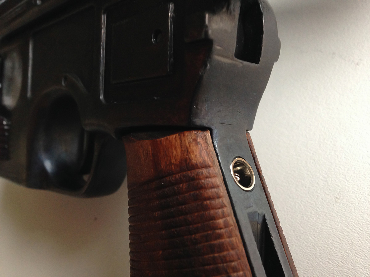

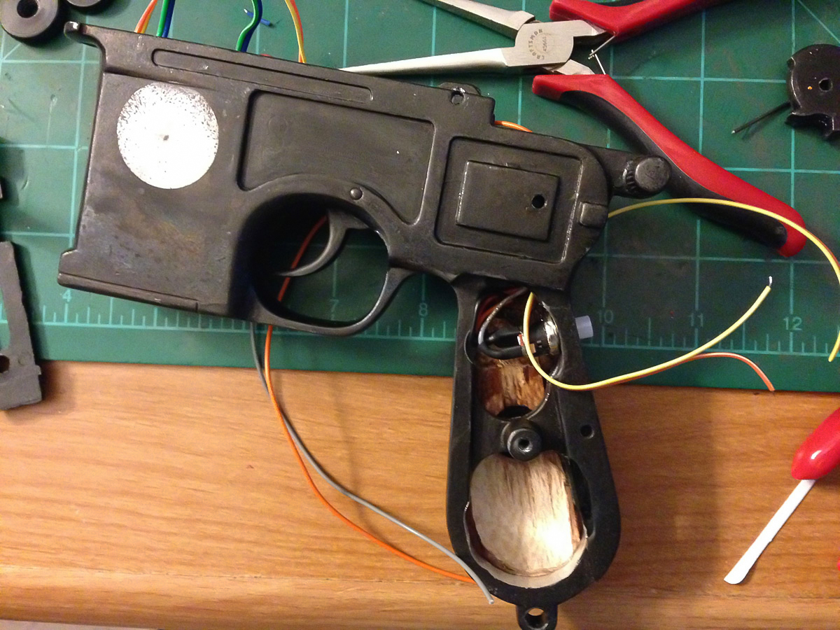

Since Aaron got a denix with wood grips, next came milling out the recesses for the 2W bass speaker and resonance in the grips. I had to make a little room on the frame too.
Add a recharge port hole, and tap it.
Here I used AL black to blue the extractor I milled. Real Mauser bolts are left bright (they age and dull over time), so I left the rest bright.

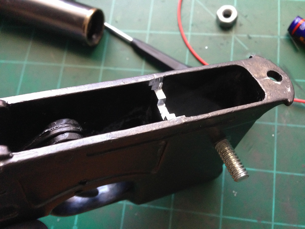

Now I had to mill some wire clearances
Mystery disc and trigger done
Wiring begins

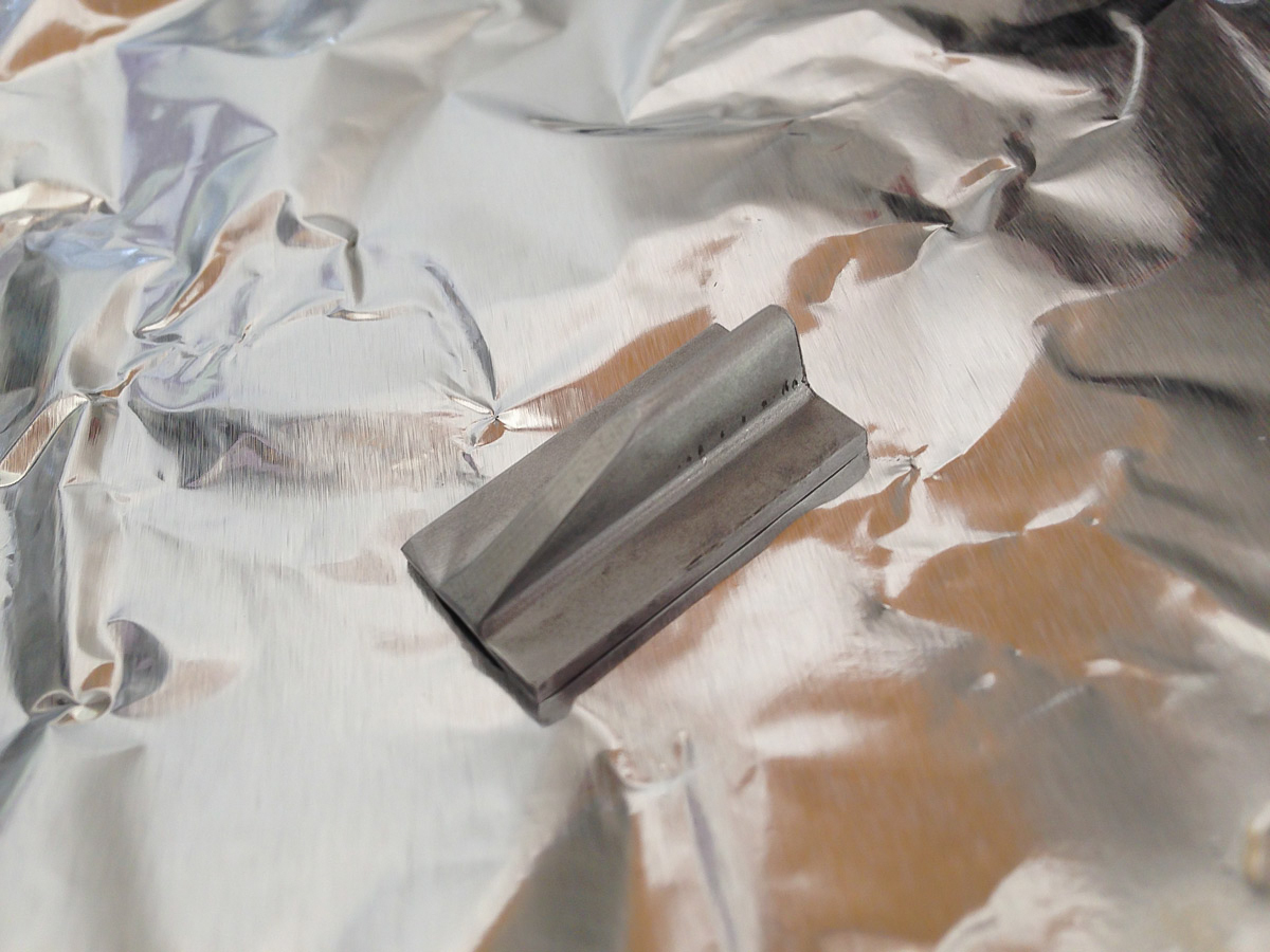

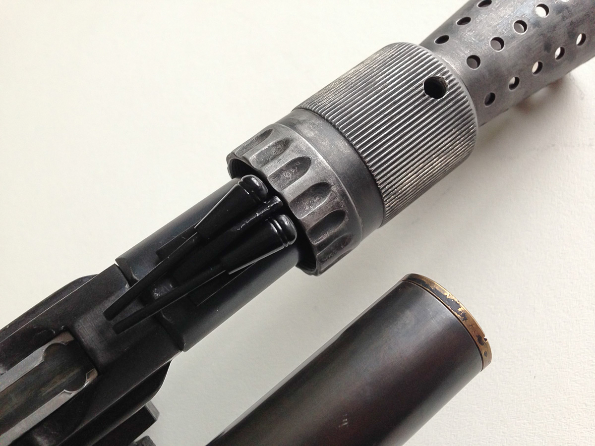

Now for the sight greeblie, I didn’t have any more DEC accurate pushrods, but I did have some older ones I got on therpf. I THINK they were bobadebt pieces. Mated to a DEC piece of aluminum T track that I shaped, and they came out great.

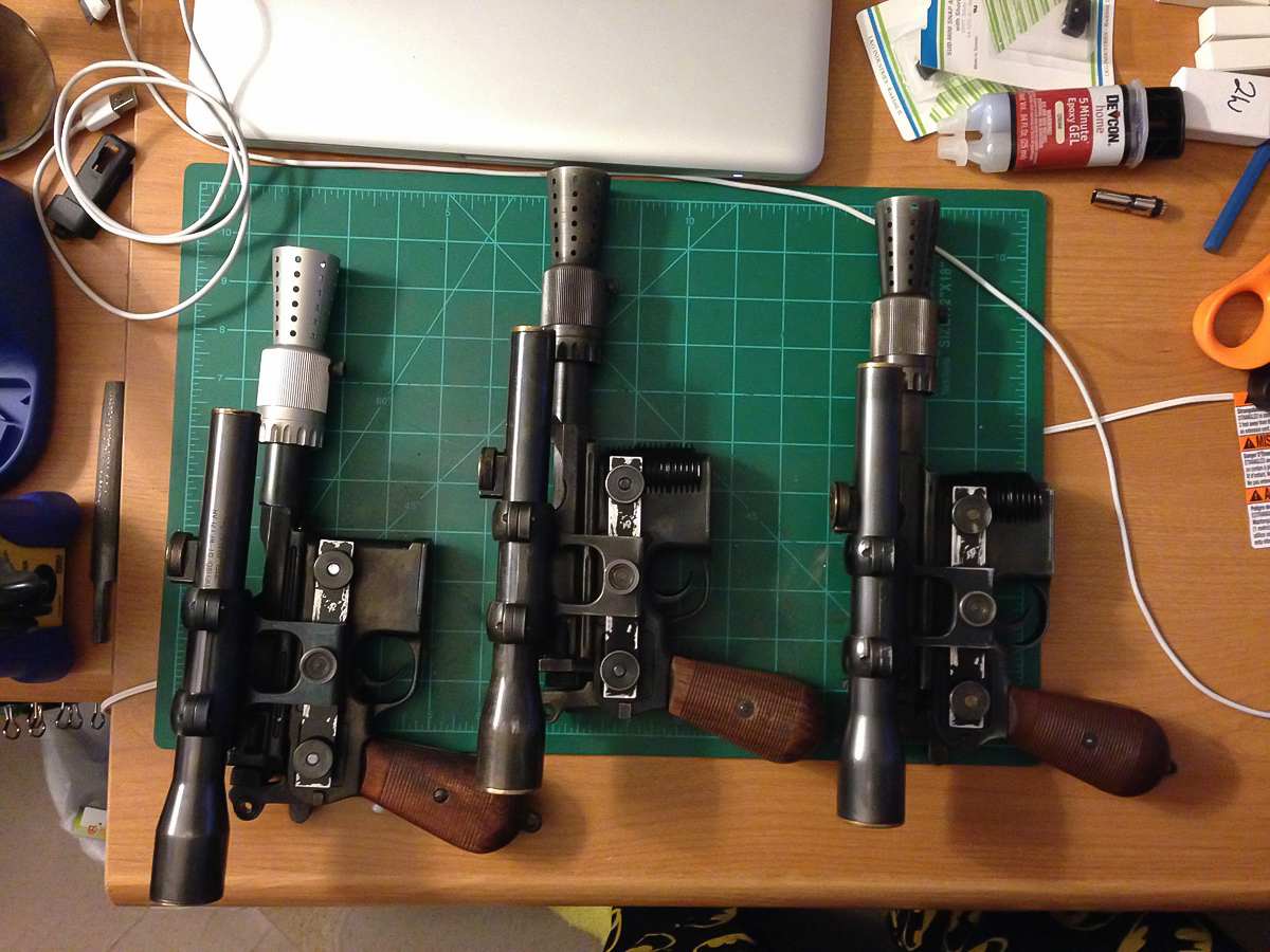

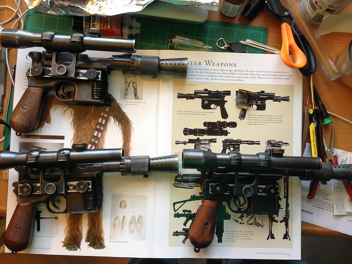

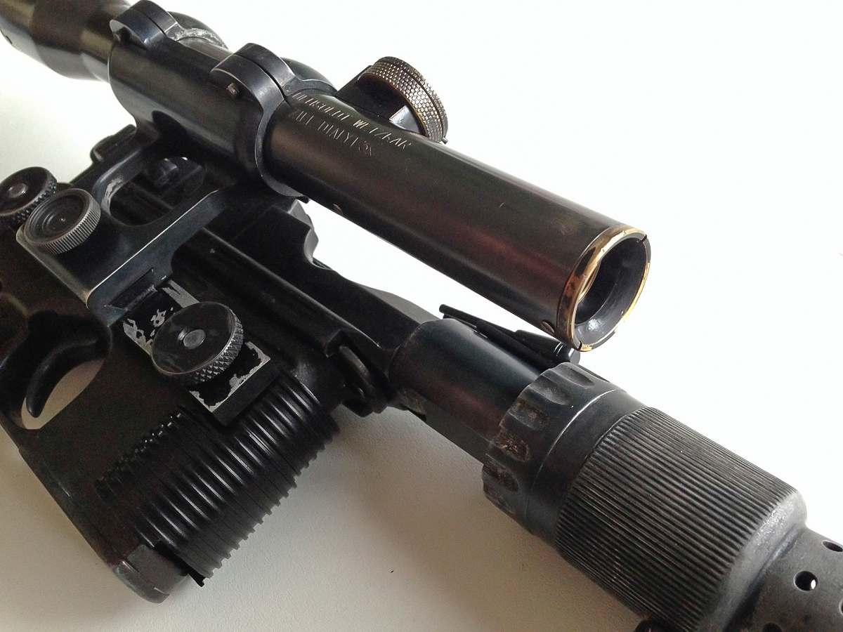

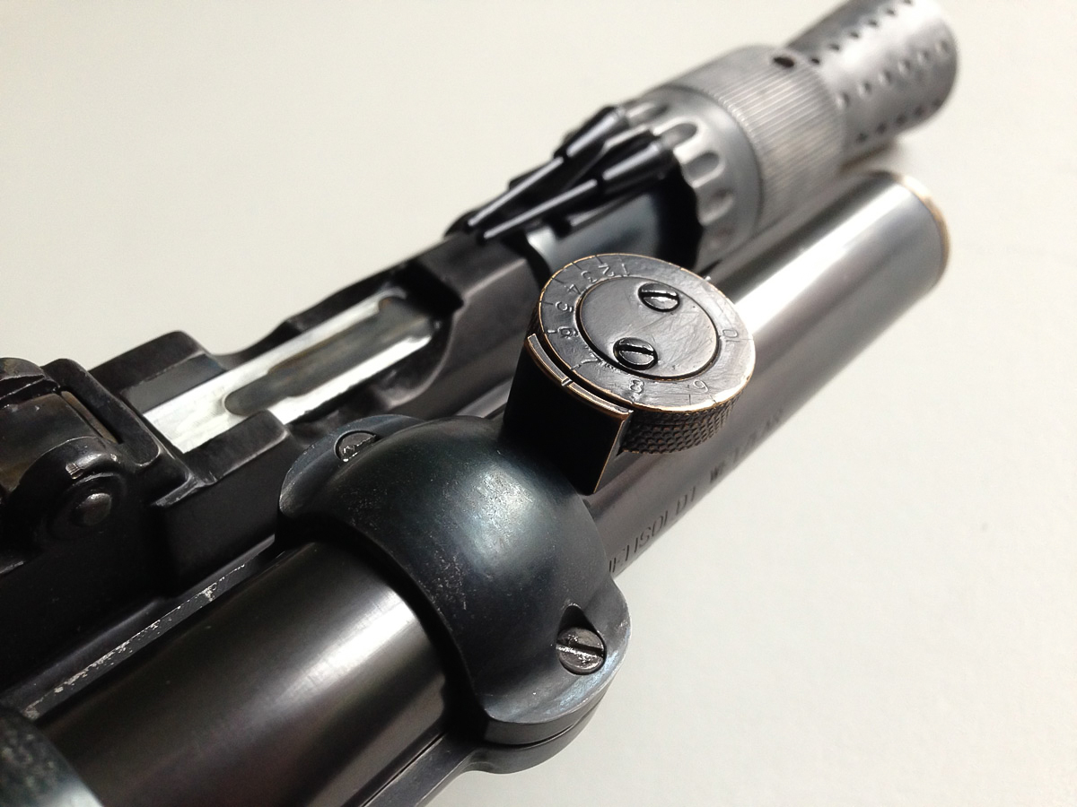

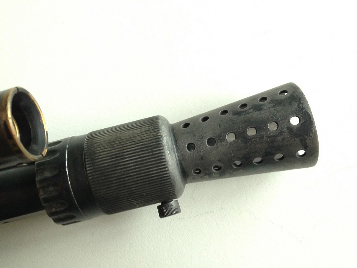

Forgot to get progress pics of the flash hider weathering, as it was SUPER labor intensive. I got it looking like a real found MG81 FH, and LOVE the way it turned out. Here’s a pic of me accurizing the mount knobs on all three blasters. I wanted to finally get the weathering on the knobs right.

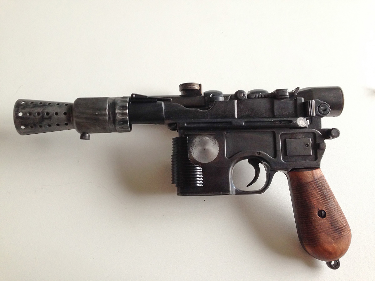

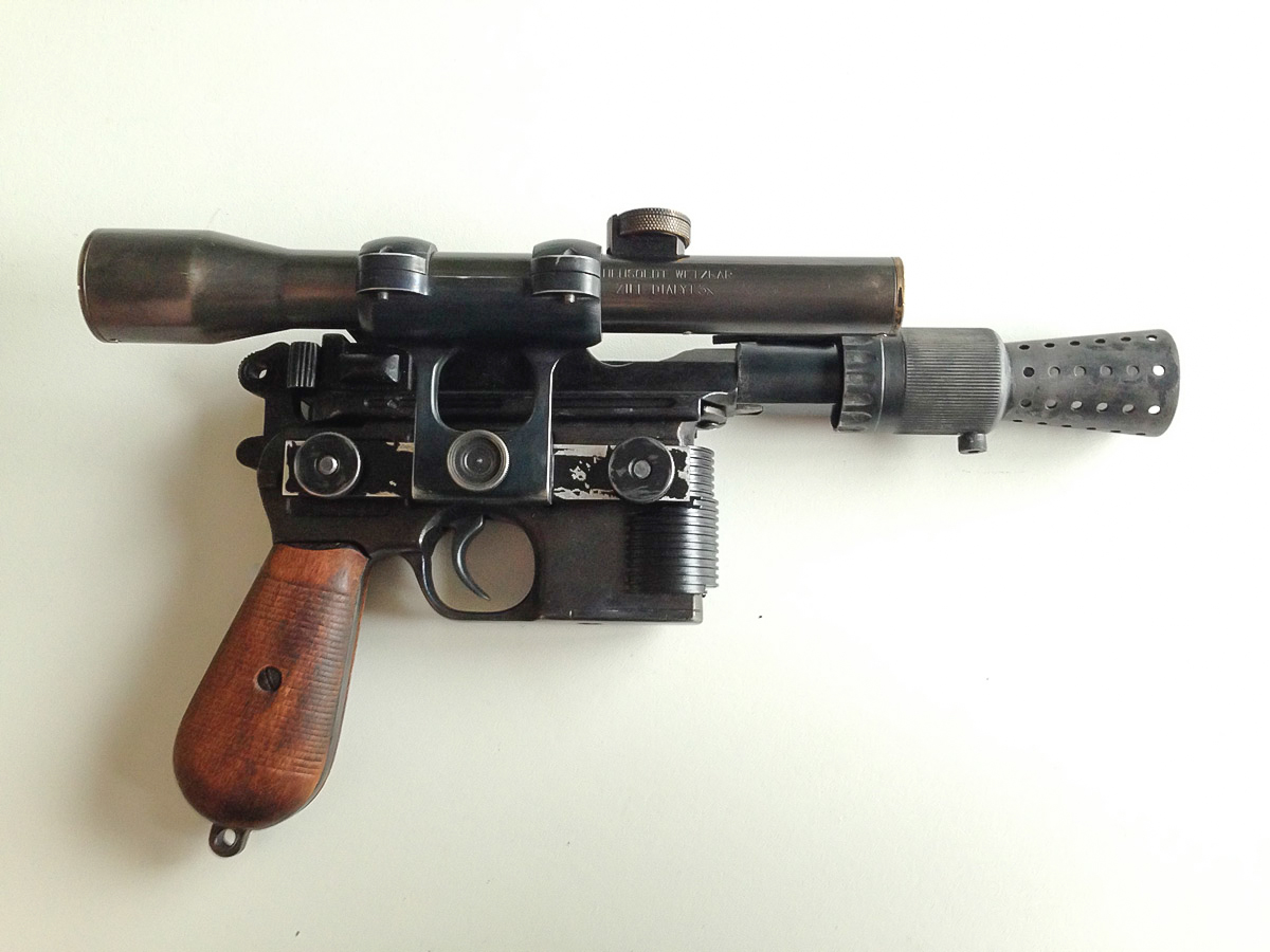

And now the finished piece

What was the reference text I see in some of the pics BTW?

Very nice. I wish I had a mill - after seeing Kpax's mods I had tried to engrave/cut an extractor detail with a dremel but it is hard to do by hand.
I am curious to how you flattened the front of the sight. There is a big hole through that part that I would be afraid of exposing - did you fill it, or press it together before you cut it?

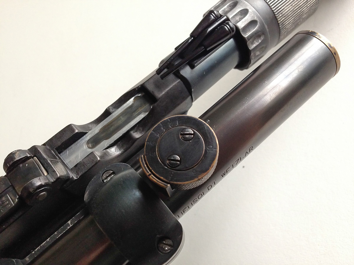

BTW. You think the real Hensoldt-Wetzlar scopes have enamel paint? Should I repaint my brass details? ... :wacko

I just milled it down making sure not to go too deep. That big ol' pin holding the sight ramp in takes up a lot of space unfortunately, so you can't get it super perfect/accurate. I left just enough metal to hold it down.
The real scopes' paint... no clue. It LOOKS like satin or semi gloss black. Surely it's leaded too. I have three of them here, and the paint on the brass parts all looks the same and JUST LIKE modern semi gloss enamel. I just went with what I had the first time and it came out perfect. Go figure. :p
