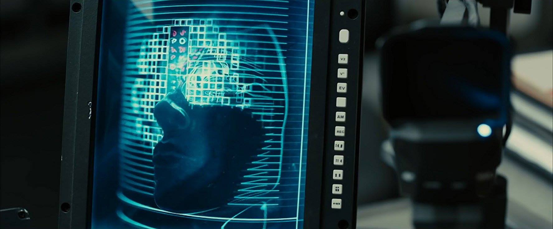

Gosling's character scans Bautista's eye once he gets back to his car and it pulls up the associated records - this is kind of the aesthetic I'm thinking for the display readouts.
Might add some DNA Helix elements... anyone got any other cool ideas for this part?

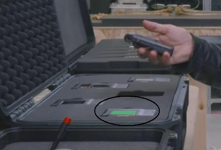

In the Tested video, the prop master said that they CG the eye on to the screen and in the prop case they show a green screen stand in.
They also have two rubber stunt versions, one open and the other closed.
Seems to be 2 Hero pop-up with LEDs.
If the screen is going to be just an image of an eye, maybe the simplest way to go about is it to just have a back-lighted, thin panel
and a transparency.
Green screen for CGI.

The pop up action should be relatively simple to do as well as the lighting of the LEDs and backlit screen.
Do you think that the circuit board in the pop-up portion is an actual board.
Maybe it is the microcontroller itself which controls the LED flicker?
and a transparency.
This would absolutely be one easy way of doing it. I'm enjoying the working TFT screen idea at the moment mostly because I can animate some neat effects on the thing after the scanner button is released. Beats CGI, in my mind. :)
It absolutely could be the microcontroller in question. However, I don't recognize it as a standard arduino board - those usually have pretty clear rows of solder pad connection points for the various components, and those aren't present here. It could be something custom that holds a microcontroller chip, but I have a hard time imagining why they'd go to that cost and expense when off-the-shelf options exist. Given that all the wires trail down into the device, I've been operating on the assumption that the displayed PCB is non-functional and the actual workings are controlled by something more typical inside the lower portion.
