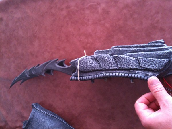

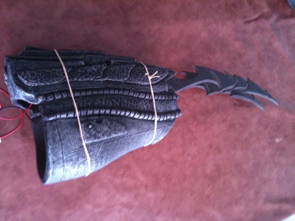

I am trying to make an animatronic system in Steve Arnold's gauntlets.
There are resin and heavy enough to serve as a support.

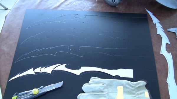

I had to change blades of origin because they were too big to go into the glove, then I made them in Sintra/Forex.

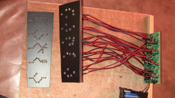

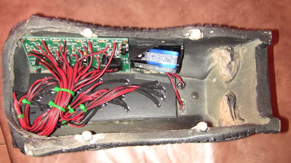

For the countdown, I used a Velleman (Chevron Arrow) kit and I made a support for the diodes in Sintra.

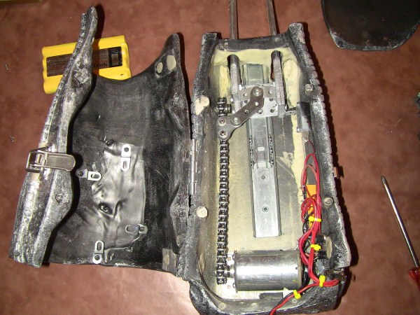

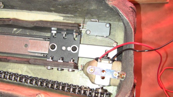

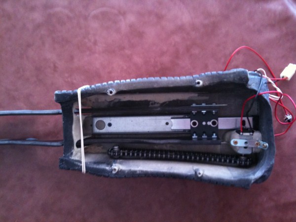

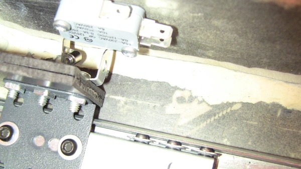

To move the blades I use parts of remote control motorcycle (gears, chains) and a toy engine and relays.
Thanks all Hunters for precious advices I had found on the lair
Thank you for looking...
I really liked how you did the gauntlet using the chain. Thank you for showing the inside of it too. That was really clever.
Looks good. You probably could have used a smaller gauge wire for hooking up the LEDs to the circuit board, because they don't carry a lot of current. That would have saved you some room in there in case things get kind of tight.
I like the idea of using the gears and chains from a remote control motorcycle. You did some good engineering there.

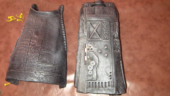

Hi Bro,
I had finished my gauntlets, I had to change the motor for a more powerfull one (from a drill).
And a little video with Mannowar's P2 Hand:

Hi Bro,
Thank you for looking... :D

VaderDave :I had put two pairs of switch, one pair on the gauntlet and the second one can be palce inside the latex hand.
