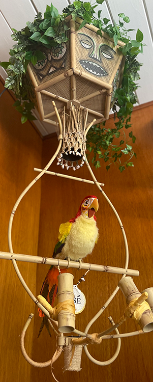

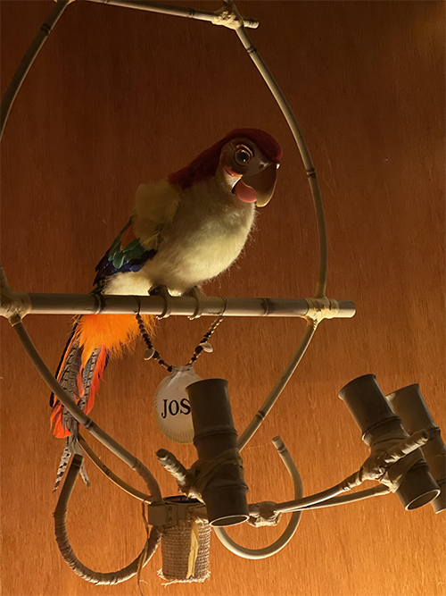

I suffer from a sort of mental illness where I believe that if I’m willing to suck at something long enough and fail enough times I can be OK at just about anything.
When the pandemic broke out that illness told me, “when you’re done bleaching your groceries and quarantining your mail, you should teach yourself animatronics.” Having no experience whatsoever in mechanical engineering or programming robotics, this was a terrible idea.
But it was also wonderful. It forced me to try new things, get better at subjects I had struggled with my entire life and accept failure and setbacks as the necessary steps to succeed.
Fittingly, as the Pandemic is officially being declared over, after three years of failure and sucking at something, I have finally finished my Tiki Bird.
¡Olé! ¡Olé! It's showtime!
But I still wonder whatever happened to Rosita …

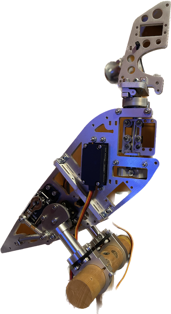

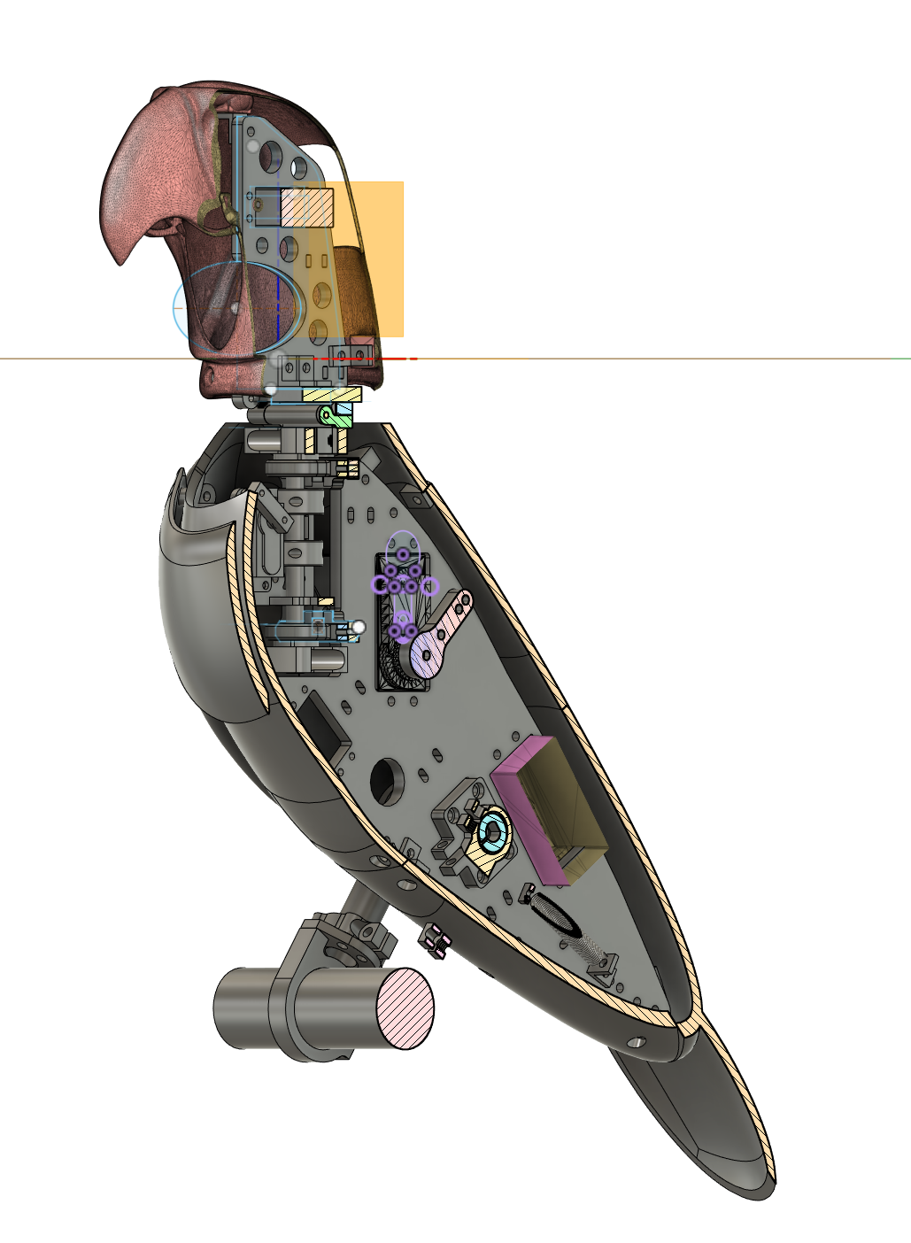

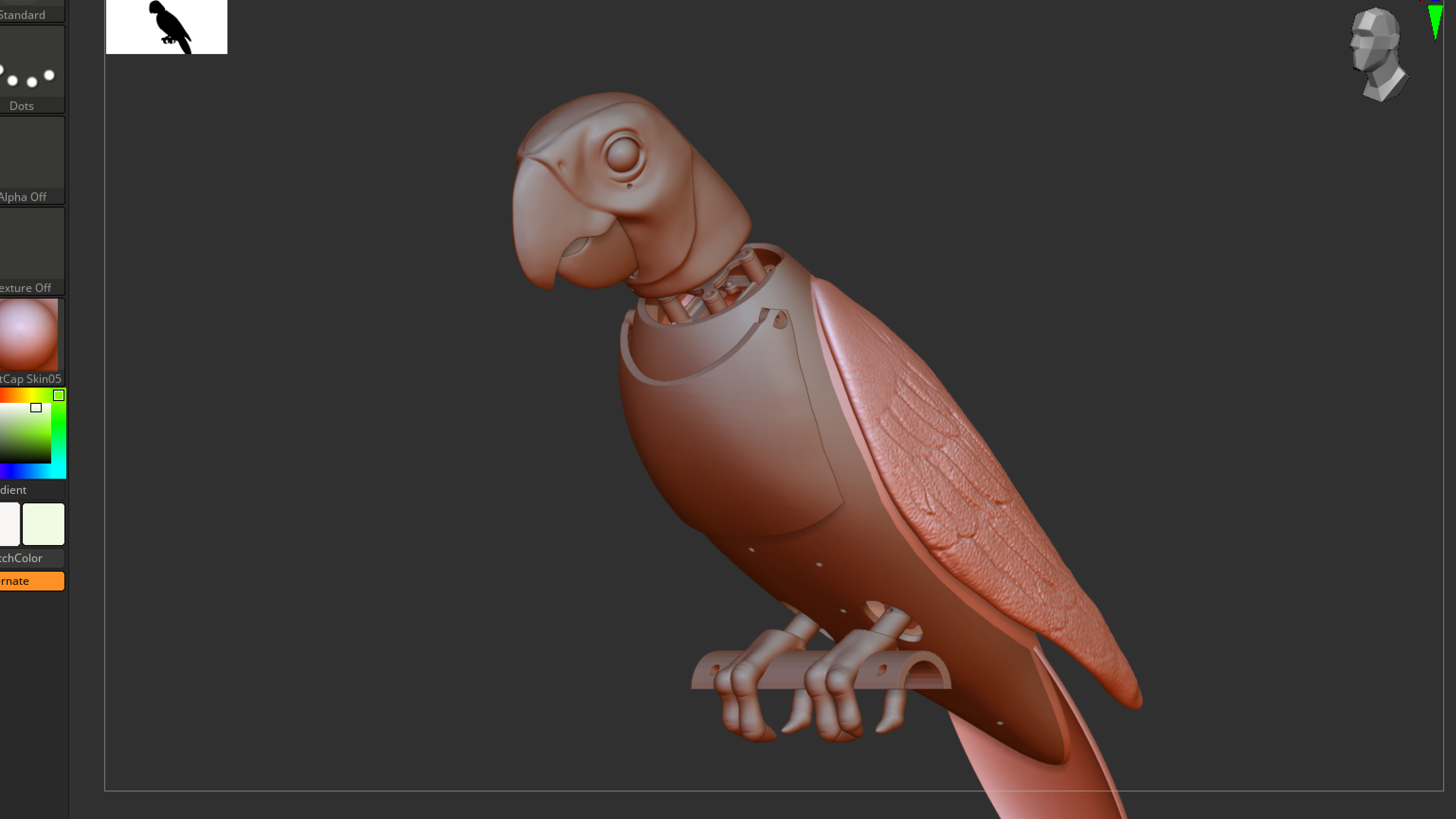

For my birds, an aluminum armature was laser cut, and a 3D printed, PETG shell was attached using 4/40 angle brackets:
Your idea for a shell sounds workable.
You could also sculpt a shell and vacuform a skin, attaching it your box with standoffs or RC linkages.
The feathers can be hot glued directly to the PETG.
