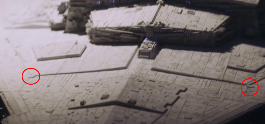

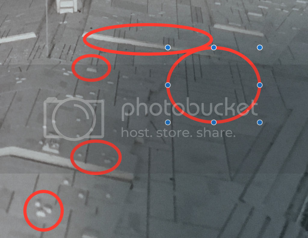

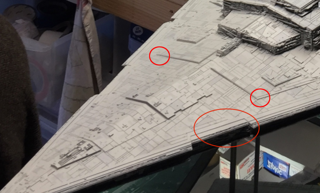

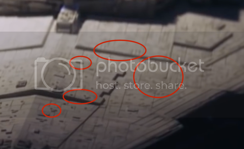

Sorry for posting this here but here are pics comparing the Anigrand and the SD from the Bandai promotional video:
Anigrand
Bandai
Notice the missing rectangles on the Anigrand?
Unless you are going to tell me you removed them from you build? ;)
I didn't have to remove the rectangles in question because they were not present on the Anigrand model. They were added to Bandai's build-up of the Anigrand model, along with a lot of other small details, by whoever built it. The so-called Bandai ISD is nothing more than the Anigrand kit with extra details.
BANDAI
ANIGRAND
Most likely then the Bandai custom build is built from the same 3D file
What evidence do we have that it's a custom build? The simplest, most logical explanation is that Bandai acquired and built the Anigrand model, and are now using it for promotional purposes. Certainly the so-called Bandai kit has the exact same fit issues around the rear base of the "neck" as the Anigrand model. This isn't a rendering issue, but rather a production issue unique to Anigrand's moulds.
