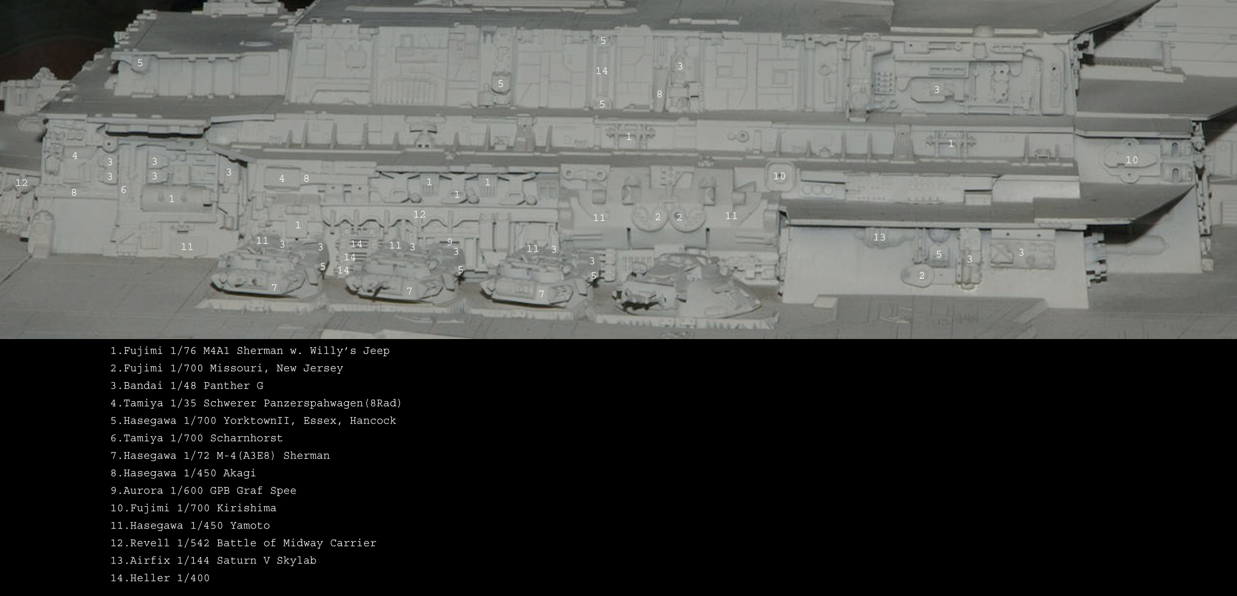

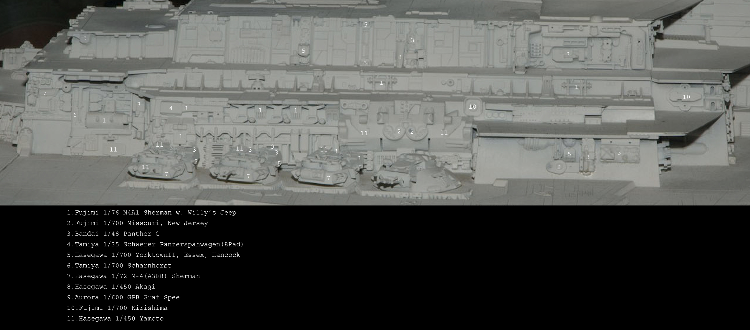

Am now working on the Upper Structures which I have found many parts.
Part Id's updated with just a couple left from the Back walls.
Have idetified 85% of this model with over 100 kits used.
