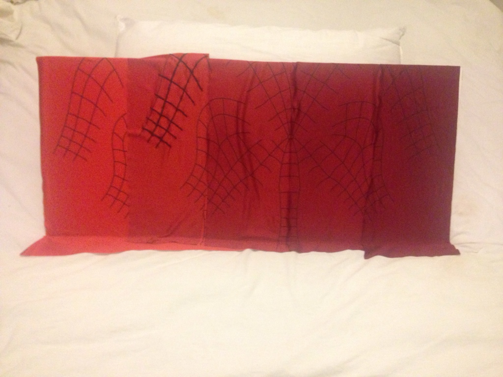

I've been experimenting with dyes for a better shade on my red... The shading of the red is bugging my sssooooooo much as it varies in tone in different light! Do we like a particular one?
Personally, I like the second to last shade! :) In my opinion, the last shade (the darkest red) is a just a tiny bit too dark, but not too dark to be the brick pattern that goes over the initial red!:D
Agreed^^ second to last looks pretty good! But dang I wanna see that blue and red screened fabric in person! It looks sick.
