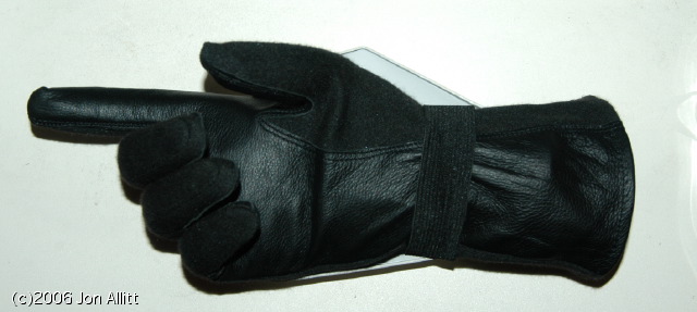

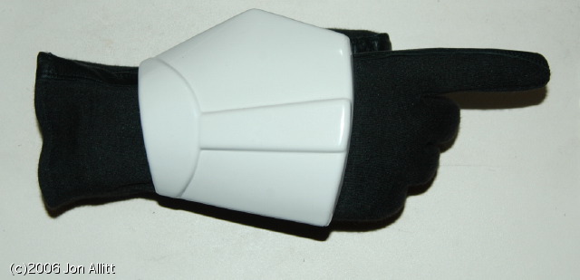

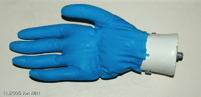

I'm putting together a mannequin for some trooper armour and need some poseable hands. I've moulded my hands for a couple of previous mannequins in alginate and hydrocal but that's messy and would require a 2 part silicone mould to be able to cast in a flexible material. So I decided to try an experiment using a latex glove as a mould.
I bent some aluminium armature wire into the shape of a hand and attached it to the mannequins fiberglass wrist. Stuck it in a latex glove, suspended it in water to stop the latex from "ballooning" out and filled it with silicone rubber.
not very pretty since I didn't mix enough silicone and had to pour some more - but inside a nomex flight glove who's going to know.
I had to cut a bit of silicone off one side to create a concave palm area and it's not strong enough to hold a blaster single handed but should be fine with the left hand holding the front of the blaster as well.
