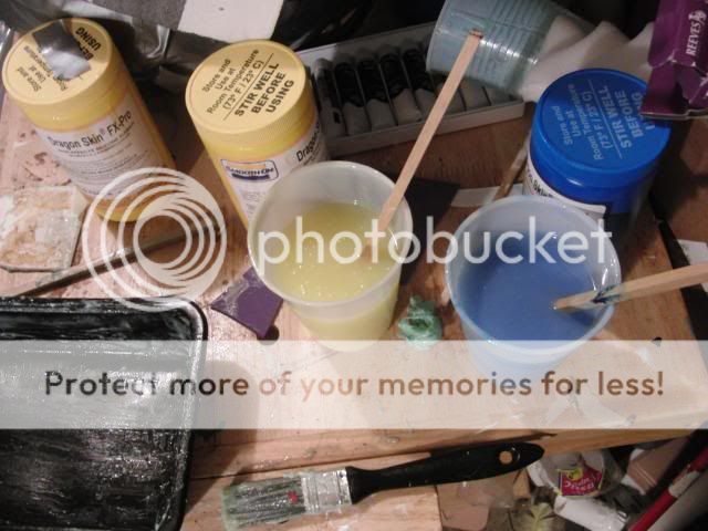

Here is the Dragon Skin silicon getting mixed with some oil based paints to add color to them. I started with Dragon Skin 10 medium for the first layer, and used Dragon Skin pro for the rest. Pro sets much master than I thought . Each set of Dagon Skin were 2 pounds, and I used all three.

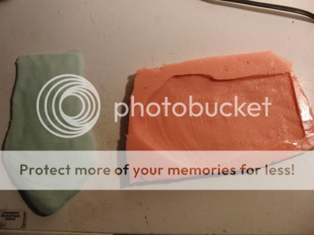

To see if I could cast Dragon Skin in a Rebound mold I casted this test ear. I was happy with the results.

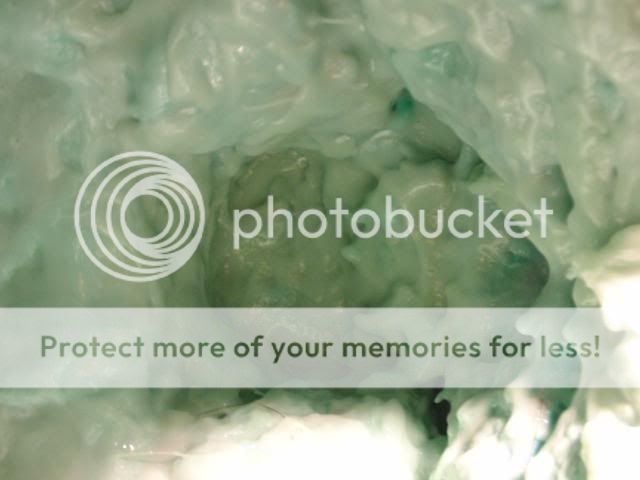

I have used all the Dragon Skin and I am not sure if the back half of the cast is thick enough to not rip.
Here is the front.
Here is the back.
Would it be a good idea to slosh some FlexFoam-iT X in the back half to suport the cast? Or would that ruine it?
I am short on time so if there is no advice saying not to I will go ahead and give it a shot tomorrow.
Re: Original Concept Gannon: The Legend of Zelda. Puppet Costume.
Success! My smooth on dragonskin-skin worked! It did not fuse with the rebound.
There are some air-holes, but they add character.
The chin area was thin and ripped. I have since patched it and attached the ears with the last remains of dragonskin from a kit.
