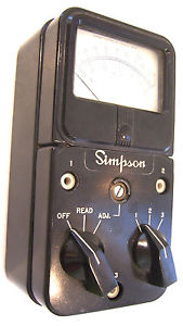

I want to cast a part in resin that has indented letters which will be filled with paint - exactly like the kind of thing you see on old meters like the one below...
In fact what I want to do is cast a new front panel for that same meter, but with different lettering.
