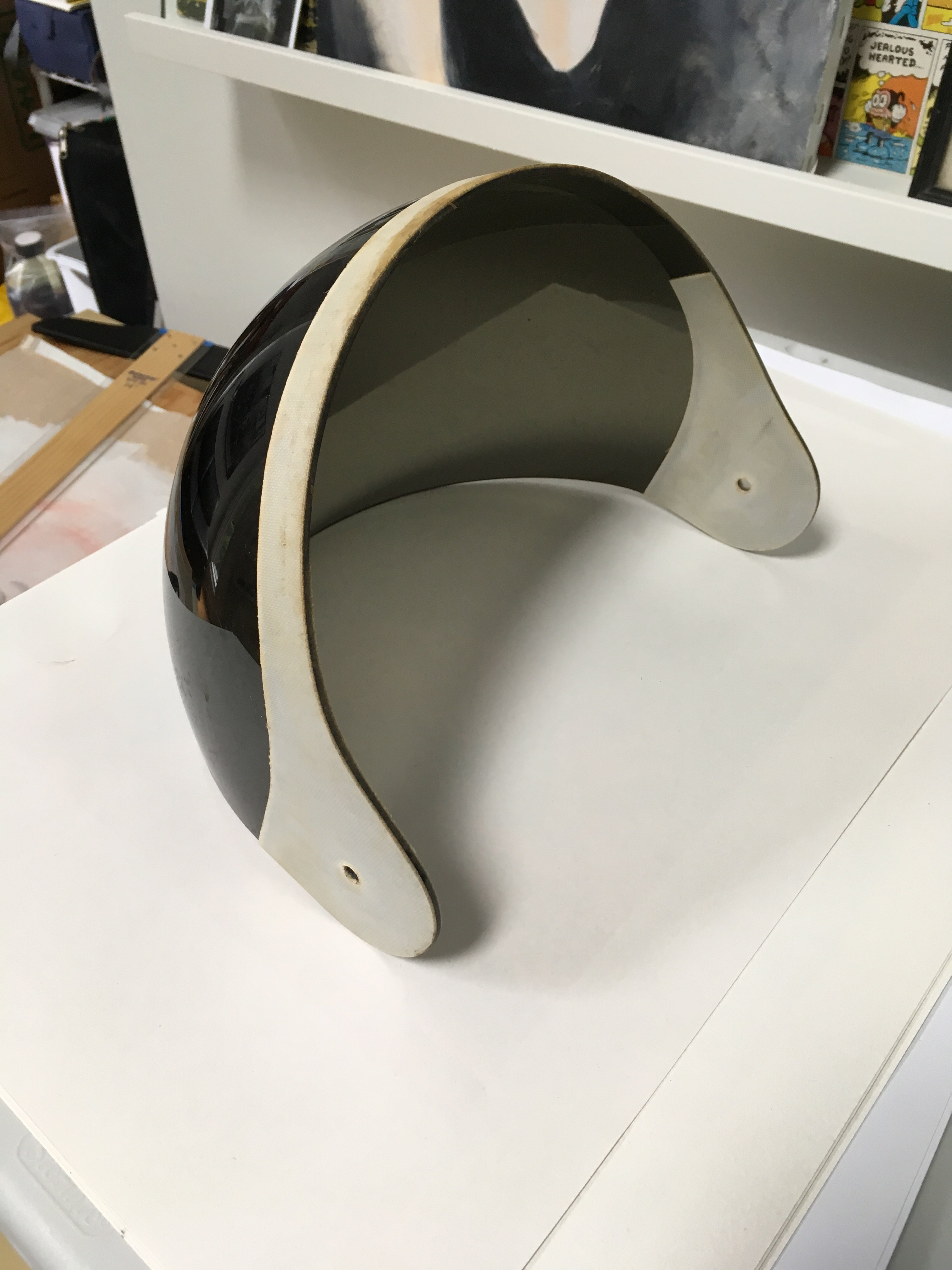

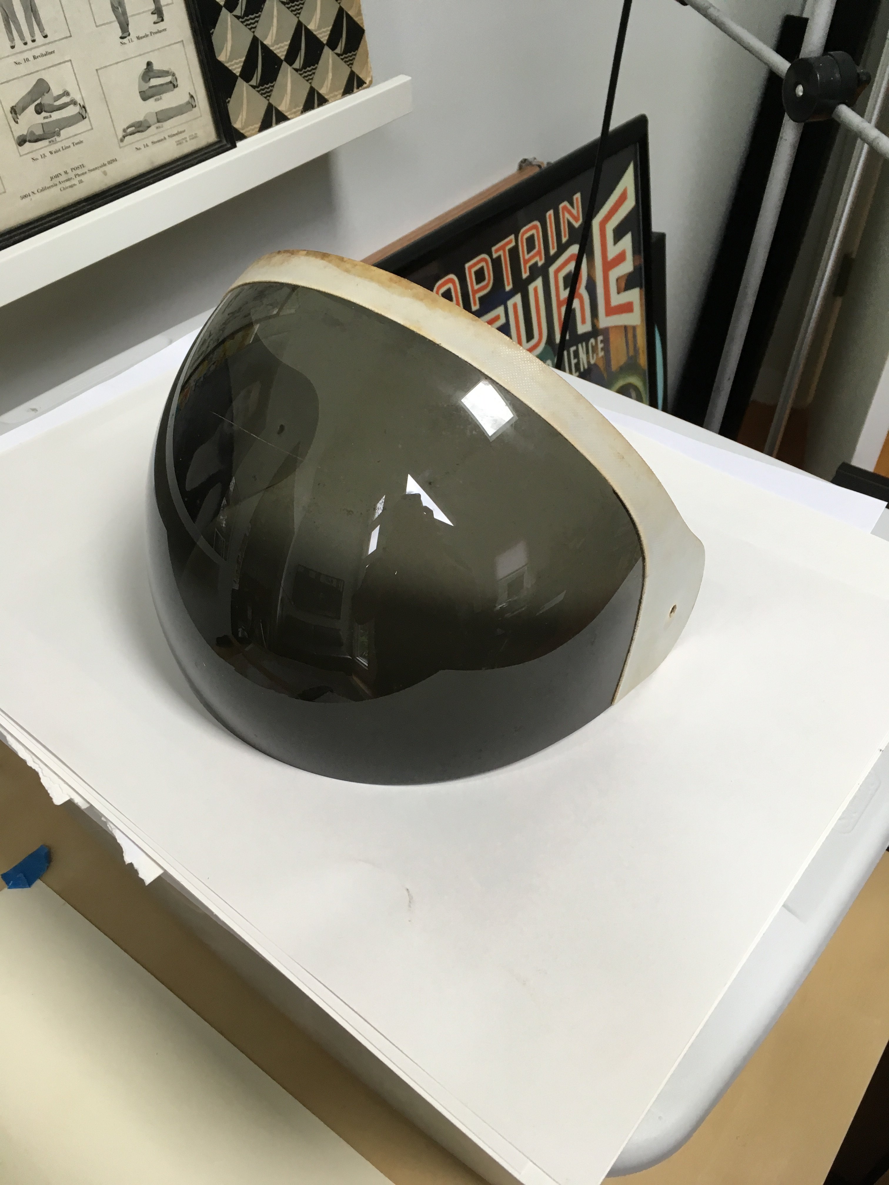

Hi...attached are two pix of a US Navy Mark IV helmet visor which I'd like to duplicate without risking damage...some thoughts I had was
trying to cast a vacu forming buck by putting the visor in a plastic bag kind of enclosure and then casting plaster into its curve and starting with that...I"m sure someone knows how this might be done and would love any ideas...I just don't want to risk screwing up this real Mark IV visor...

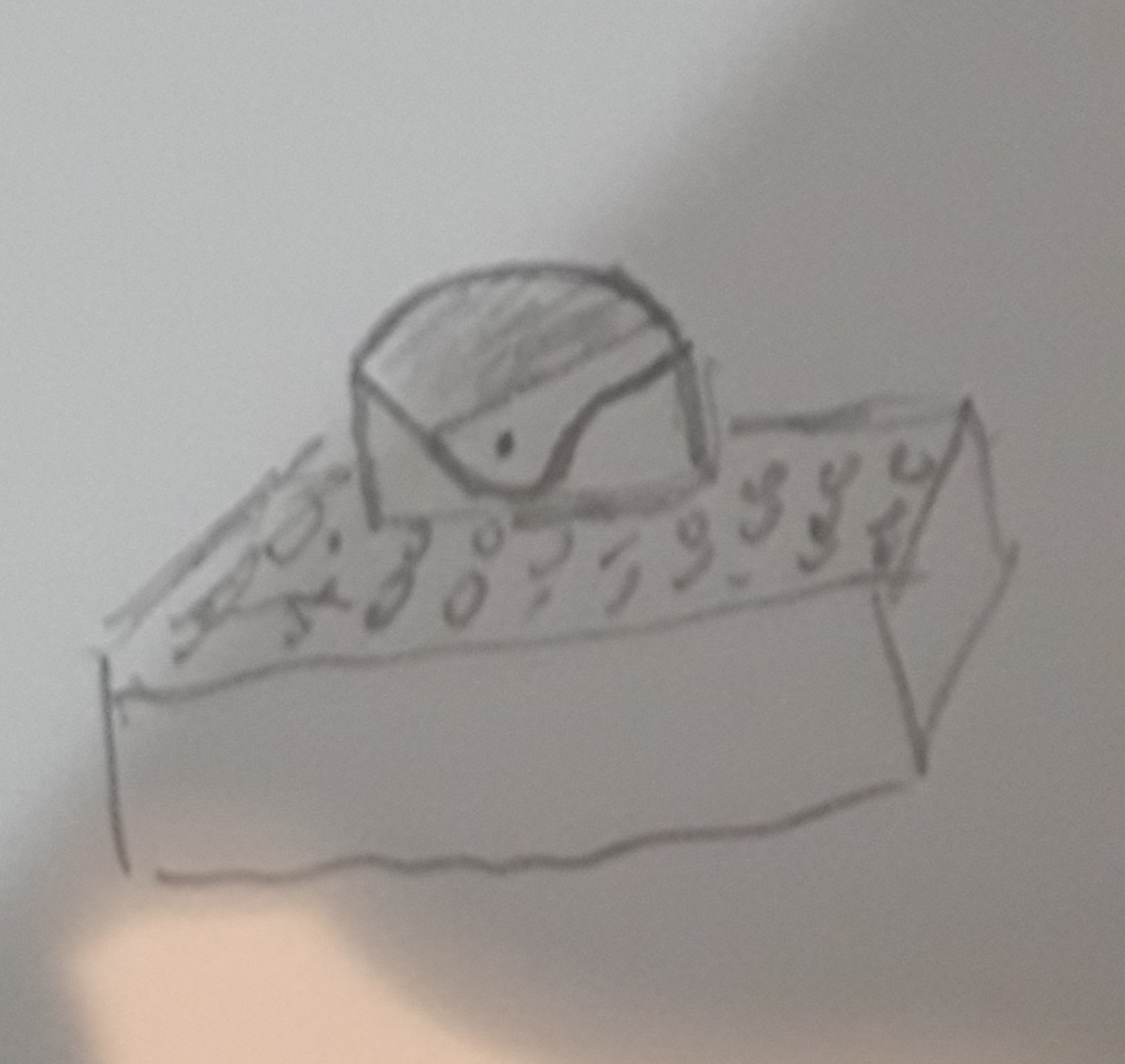

Hi JPH...thanks for that...I don't have any vacuforming stuff, so am looking for things I can do on
my workbench...(I assume your drawing was of the suggested seating on a vacuform buck and suction surface?)

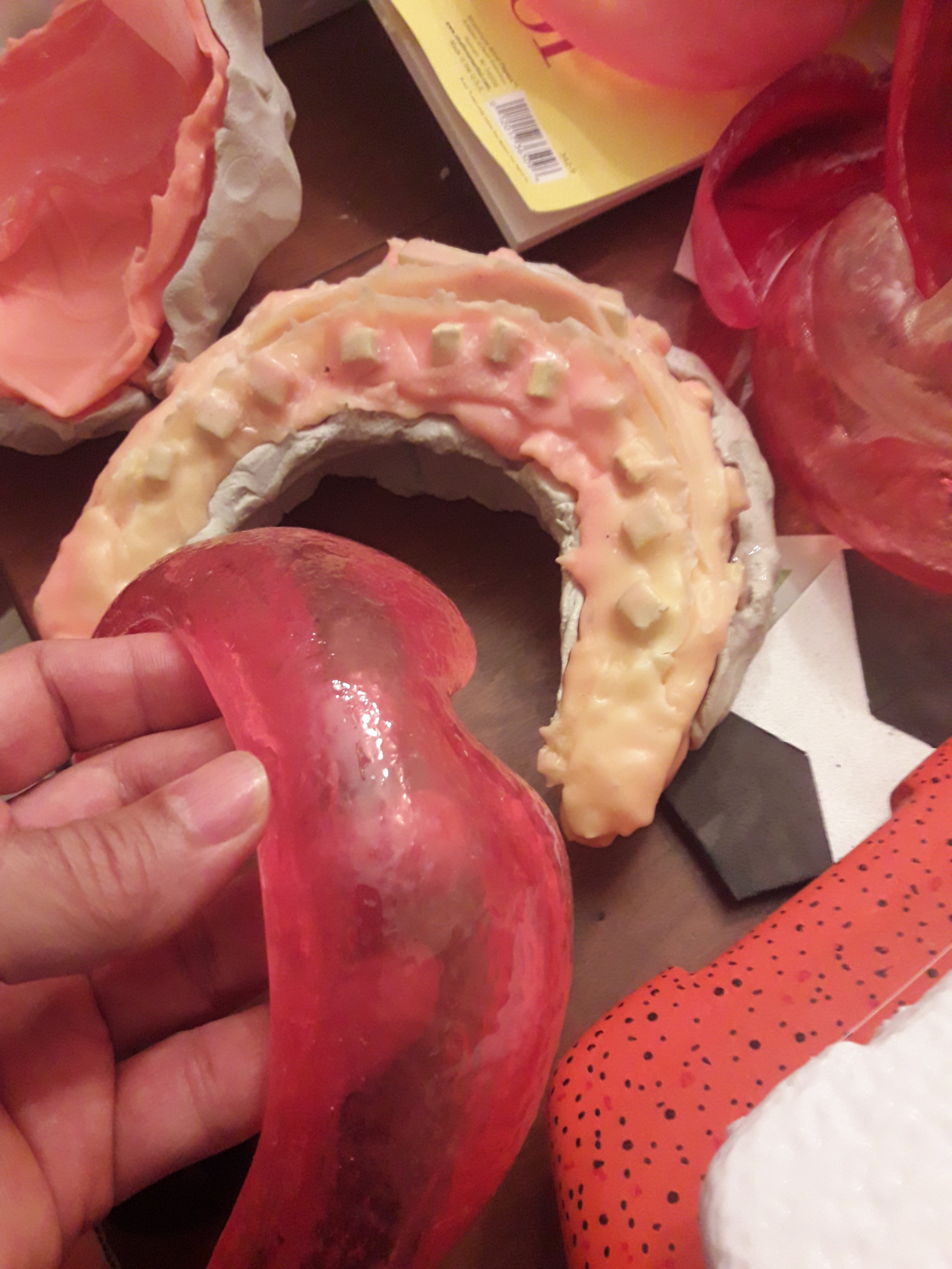

When you make a mold using Rebound, you apply layers of rebound and embed registration points on the outer surface. I use cut up pieces of foam. So, after applying several layers of Rebound, apply a layer or two more with foam. After you coat with rebound and foam registrations points, you then can use plaster of Paris or Free form air to make a hard mold that fits on and holds the Rebound in place.
The hard outer mold is usually in two pieces that come off easily from the Rebound.
The drawing was a vacuformer box on bottom, with the prop you showed on top. You can make a vauformer in a day with some 2x4s and the brown peg boards. When I get home, I will take some pics for you.
So, the goggles are made from the orange rebound mold. The yellow lumps are pieces of foam embedded in the Rebound and the grey stuff that is on both sides of the rebound mold (interlocking with the foam) is FreeForm Air.
SmoothOn has great video tutorials for this.

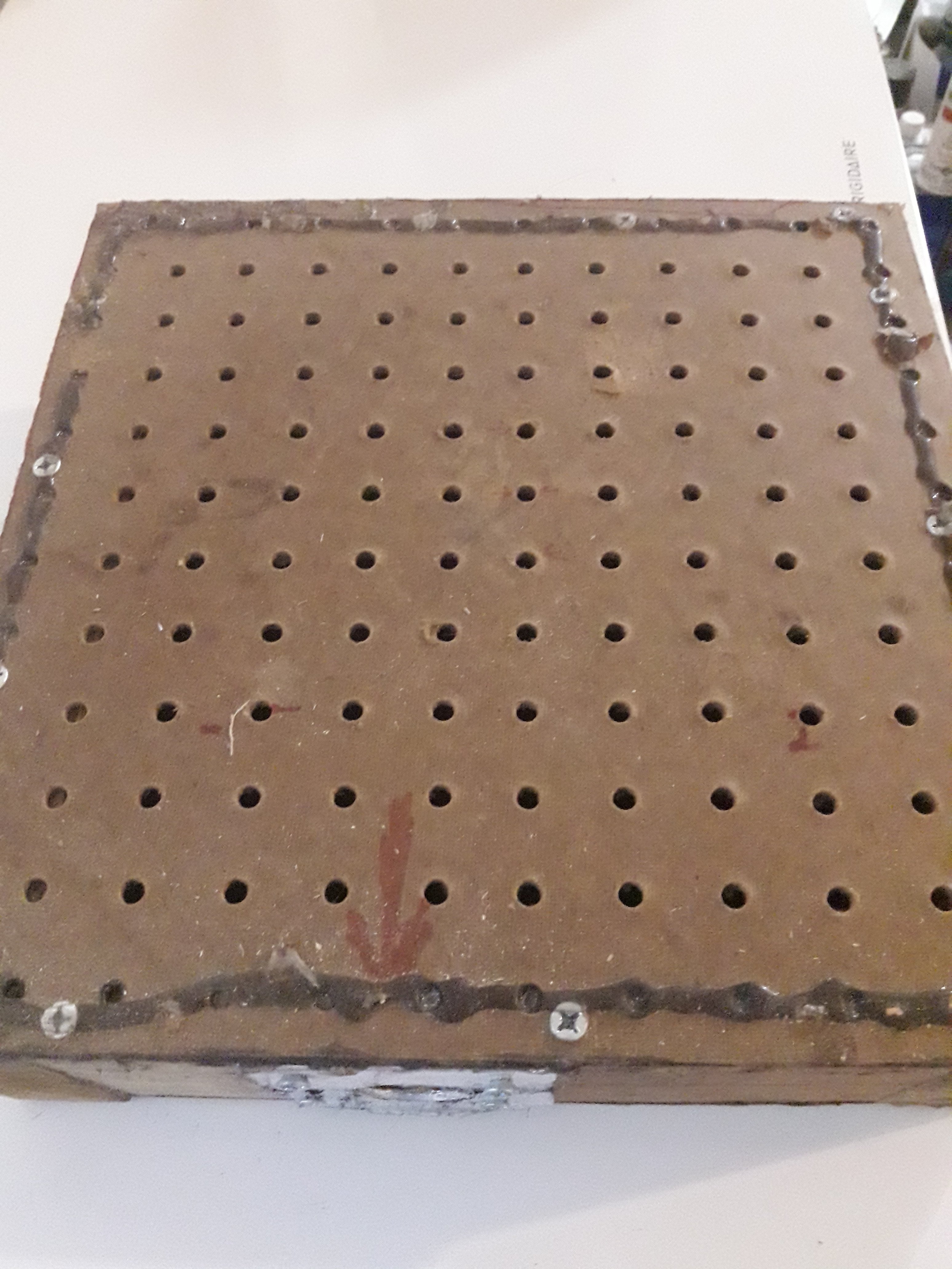

The vacuformer is just a box woth a top made from peg board, and a hole on the side for a shopvac. Then you need a frame to hold the PetG that fits snug on the pegboard.

What is your intended use of the copy? If it is for a mercury helmet visor, then this is too large. This is the sun visor of a MK IV helmet, which is about a 1/2" larger radius than the clear visor. If you mold the outside of this visor, and pour you tool into the mold, you will add another 1/8" or so to the radius when you vacuum form it. This will make a visor that is 11/4" wider than a mercury visor.
