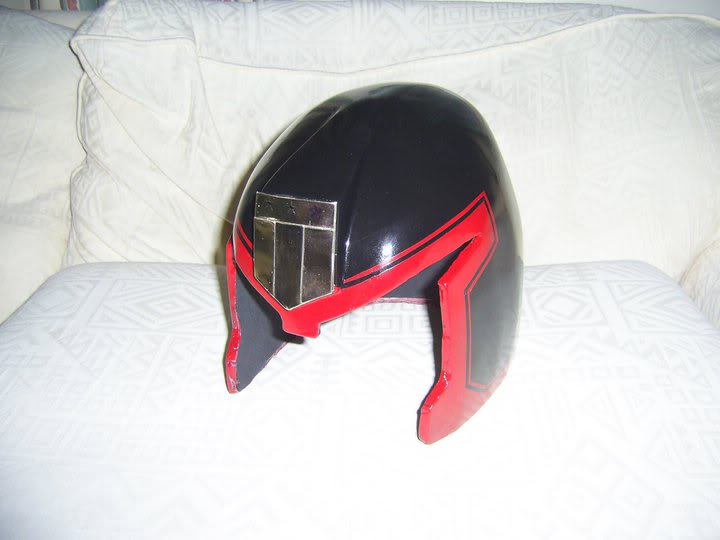

I would stick to fibreglass, I tend not to use fibreglass mat on pep items as I find standard glass mat to thick and resin thirsty, I use fibreglass tissue which I get from car repair stores, 1 layer is good but 2 or 3 is very strong and it will work into fine detail. I tend to fibreglass tissue the outside with 1 layer and inside with 1 layer. Because the tissue is so fine you can work the outer layer the get quite a good smooth finish, then I mix a 50/50 mixture of resin and car body filler and apply a skin all over and then sand to a smooth finish... filleing and floors as I go.
With this I have been able to do the items below using pepakura.
Cylon helmet, spray with airbrush chrome paint.
Judge Dredd helmet which I made 2 off for last Halloween nightout :D
