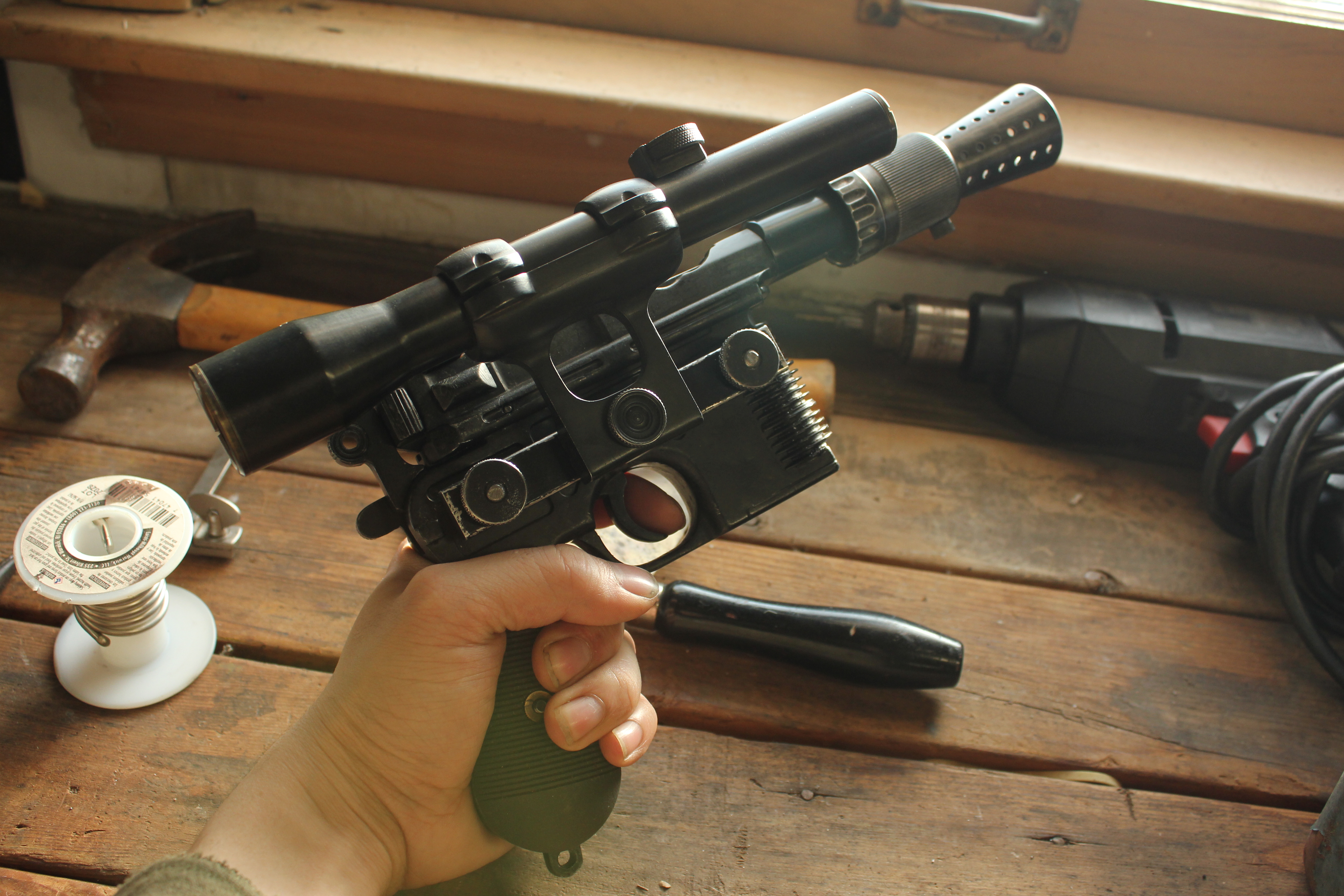

Well, patience and tenacity are two key things that I found important when I was monkeying around with my DEC Alum/Pewter kit. Sanding and polishing over and over again is one thing but secondly to that, I found, when working with AB is heat. Once I've sanded the metal to a smooth finish, and brought it down with some fine steel wool, I ran the aluminium piece over a flame (provided by a candle) to slightly warm it before applying the AB with a cotton ball. Once I've covered it and the metal is reacting, dunked it in a tub of cool water, before drying and lightly buffing it with the steel wool and re-applying the AB and repeating the process again.
Other members have done this literally hundreds of times and have managed to get a deep black finish on their pieces but I don't have the patience for that. Here's a picture of my DL-44 with the finish I managed to achieve.
attachment.php
