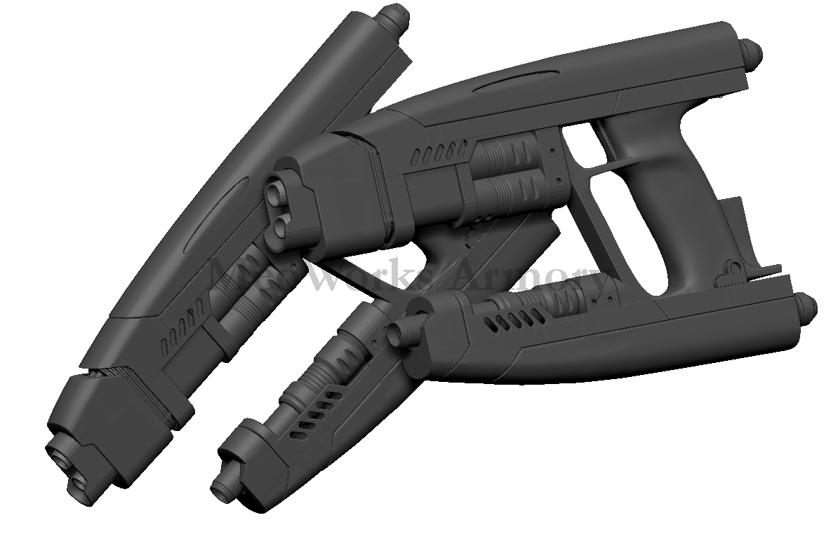

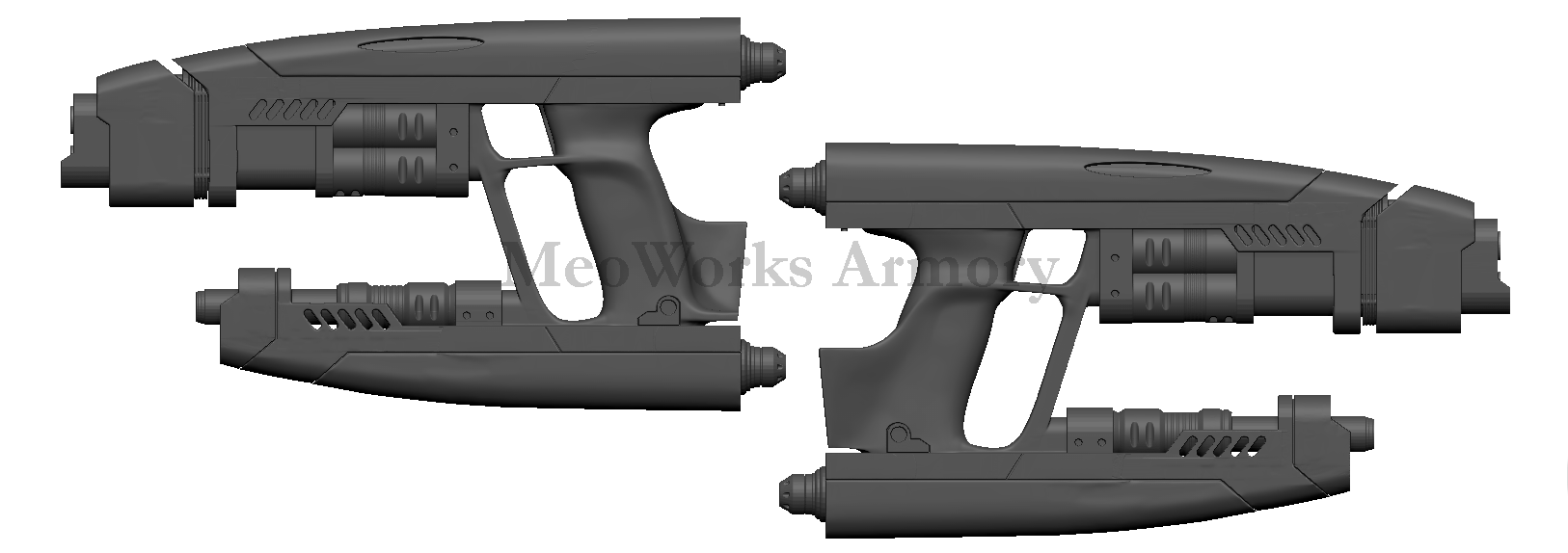

Star Lord Blasters from Guardians Of The Galaxy! I think I've included every possible detail from different production and prop photos. Features the often missed flared out palm guard, barrel heatsinks, lower barrel "step" details, tiny back switch (the one that no one knows the function to), and many more!
Digitally sculpted, printed, finished (added screws/bolts etc), and now into final resin casting! Will have full unveil soon!
You've managed to nail the emitter with its narrow walls (~1 to 1.5mm).
Most other renders have a very thick walled barrel which thanks to the blu-ray screengrabs it is now possible to see is slightly inaccurate.
