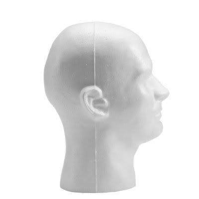

So after going to numerous places to get a mannequin helmet with no luck, I found this one on amazon... $10
This should do the trick. Anyone have recommendations this? Bondo or fiberglass? Never worked with fiberglass before but would give it a shot. I love bondo because I can sand it and it's very lightweight. Don't have a clue where to start with fiberglass. Gonna do a search on the rpf for fiberglass tutorials.

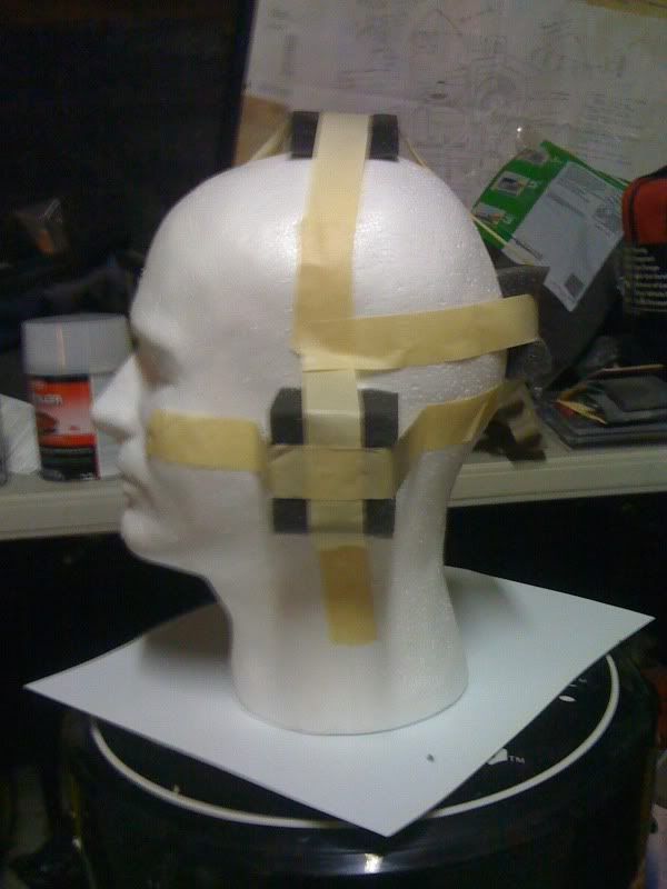

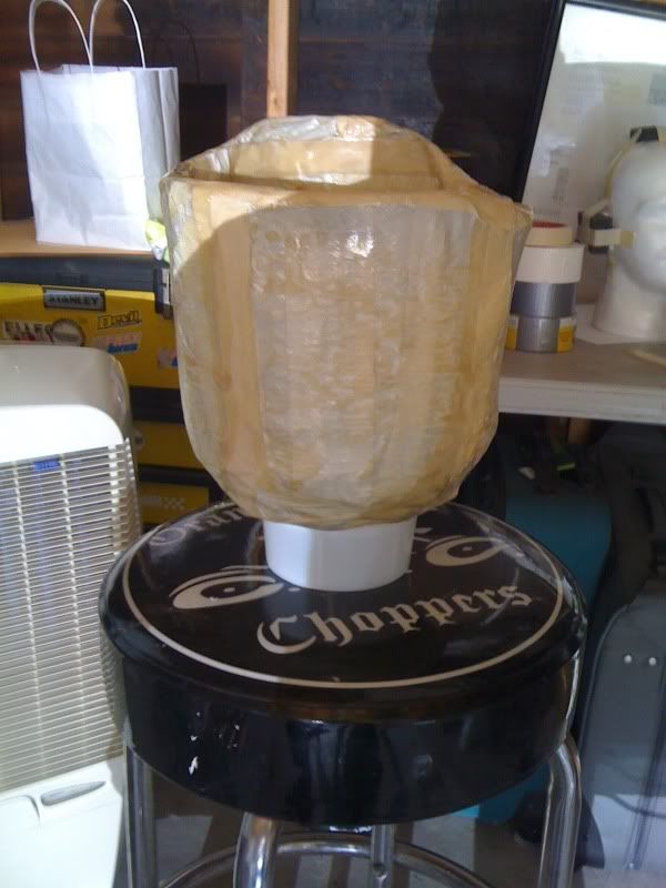

Ok, back to work. I started with taking some basic measurements of my head and making adjustments to my mannequin head so I could have an accurate base.

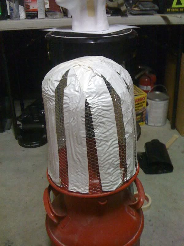

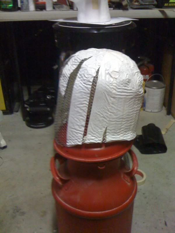

After that, I used some chicken wire to make of rough shape of the helmet. Once completed, I used some white duct tape and laid it over the entire exterior of the helmet (prepping in for fiberglass cloth).

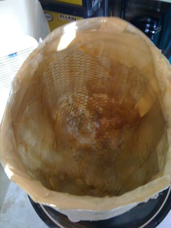

After the fiberglass cloth was measured, cut and placed on the exterior and interior of the helmet; I applied fiberglass resin on the inside first, followed by resin on the exterior.
As rough as it looks, it is FAR better than my bondo helmet. A great lesson learned and hopefully a good lesson for any future scratch builders.
Now this helmet is a "rough draft" since I have never worked with fiberglass before. As I learn the technique and through trial and error, I hope to have my "final draft" helmet started in the next couple days.
As always, tips and criticism is ALWAYS appreciated!
