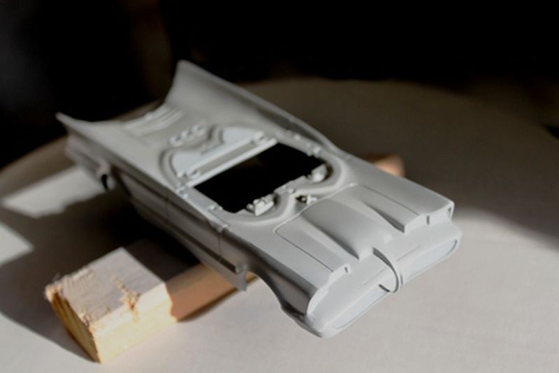

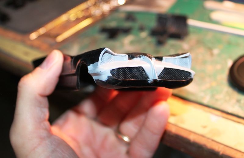

The first thing I did was attach the grill to the front of the body.
I must be more discerning now in my middle years because I don't recall this piece being so ill-fitting when I was a boy.
I must've spent a good hour puttying and filling gaps with AVES and Tamiya polyester putty before sanding and brushing on a coat of Mr Surfacer the next morning:

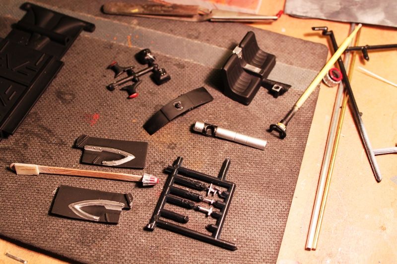

Several parts on the chrome parts tree had to be soaked overnight in Super Clean to remove the plating.

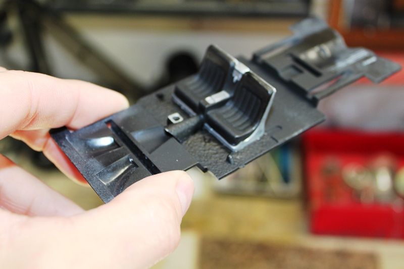

The seats for one are meant to be black leather along with the attached center console.
Same for the steering wheel although I will need to paint the center of it silver.
The dashboard, rollbar beacon, and turbine nozzle are silver (but not bright chrome) with red and black accents components.
The plastic is black under the chrome so I will go back in with aluminum and red enamels after spraying them flat black after a shot of Taniya grey lacquer primer.
Here's the car body after priming:
You may (or may not) notice I cut off the blade from the front of the grill. Most of the photos on the internet show the car without the blade and that's how I remember it so... it just looks better to me without it.

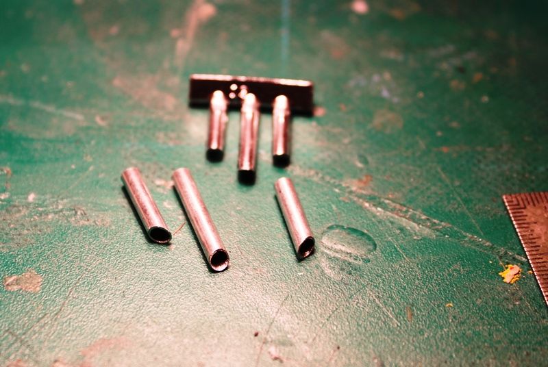

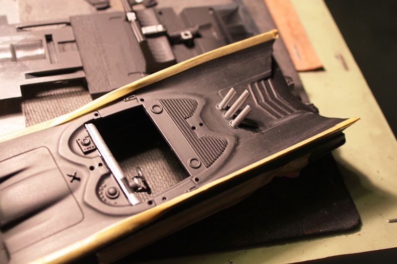

Sorry. Couldn't do that with the rocket lauch tubes.
The kit part tubes are a one piece solid chromed plastic affair which just doesn't look right so I cut three sections of hollow aluminum tubing which I'll need to glue into the three holes behind the cockpit individually once the body is painted:

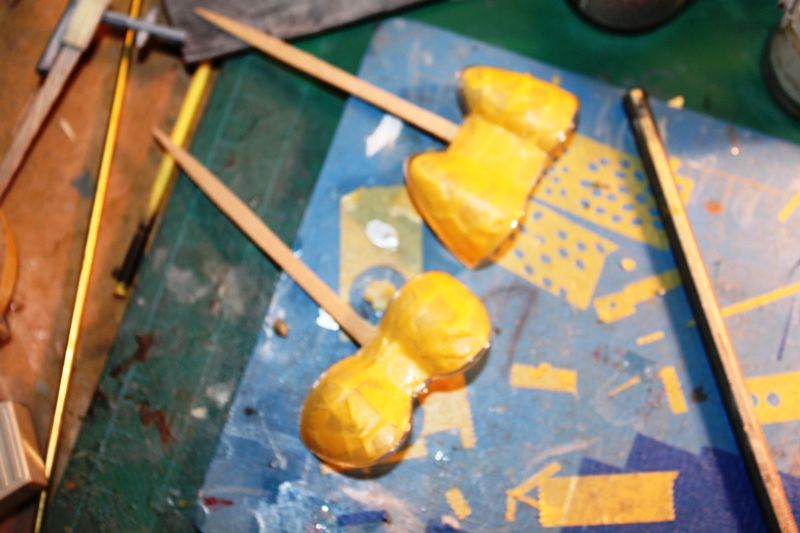

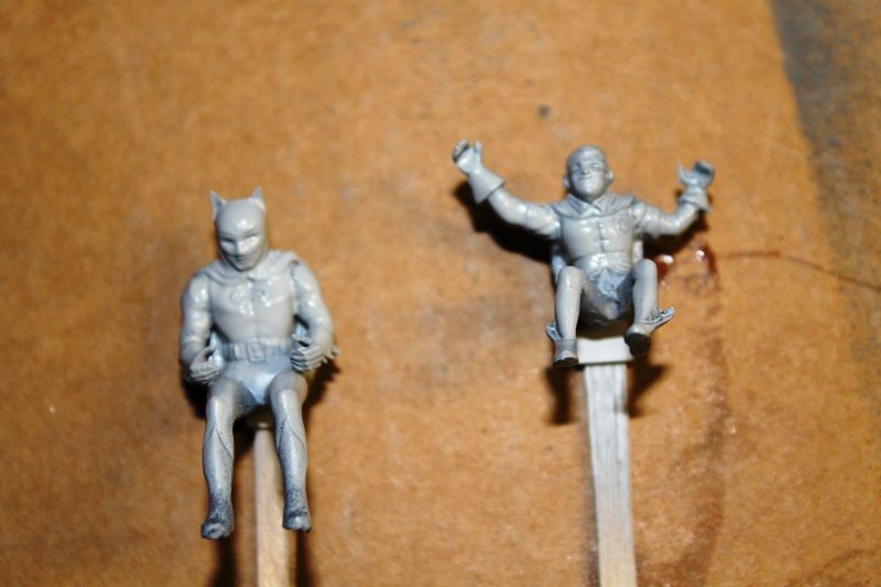

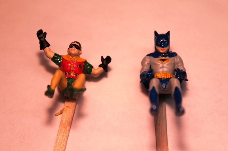

The Batman and Robin figures had to be assembled; Batman needed his arms glued on and Robin came with an upper and lower torso that needed to be glued together and puttied. Both figures had to be files and sanded along their sides to remove parting lines from the molding.
Here they are after priming:

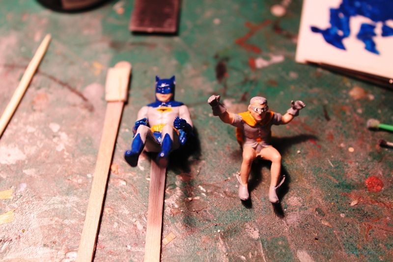

Batman was the first figure I finished painting; Robin is still a WIP as he has more colors to his costume:

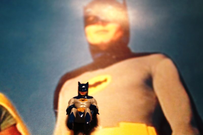

I printed a picture of Burt Ward and Adam West in their costumes off Gooogle images and am using that as a guide:

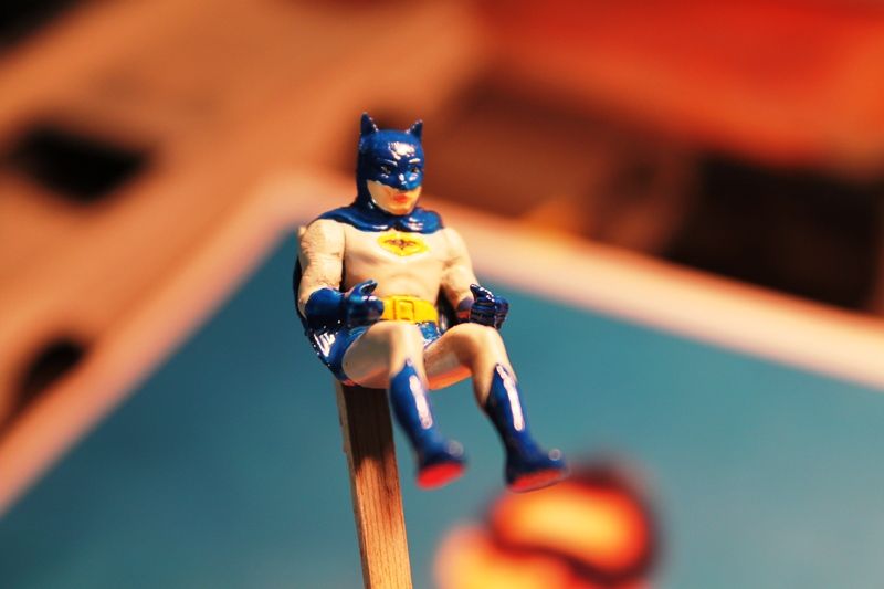

Closeup of the Batman figure:
The figure is small but I was able to "dot the eyes" and give his cowl the characteristic grey "eyebrows" as seen on West's Batman.
To do the eyes I painted the whites first, trimmed a toothpick to a fine point, and dipped it in black paint before using a light touch to "dot" the pupils. Then I painted the cowling, cape, gloves, and boots with a mix of dark blue and purple enamels being careful when painting around the eye openings and eyebrows.

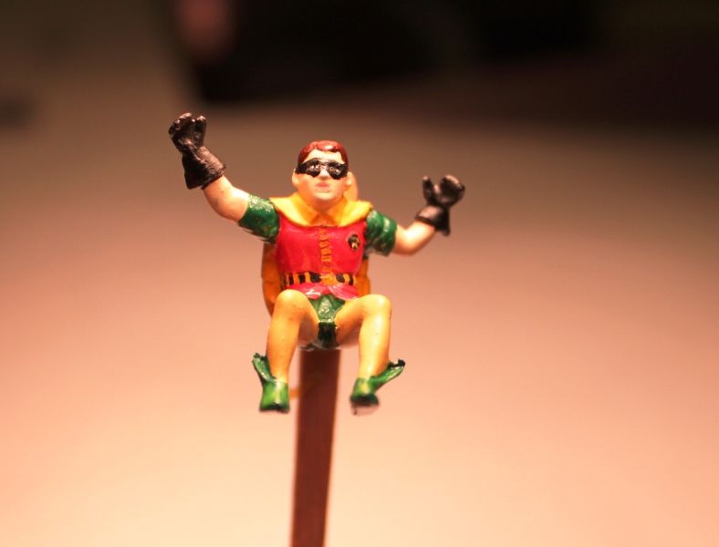

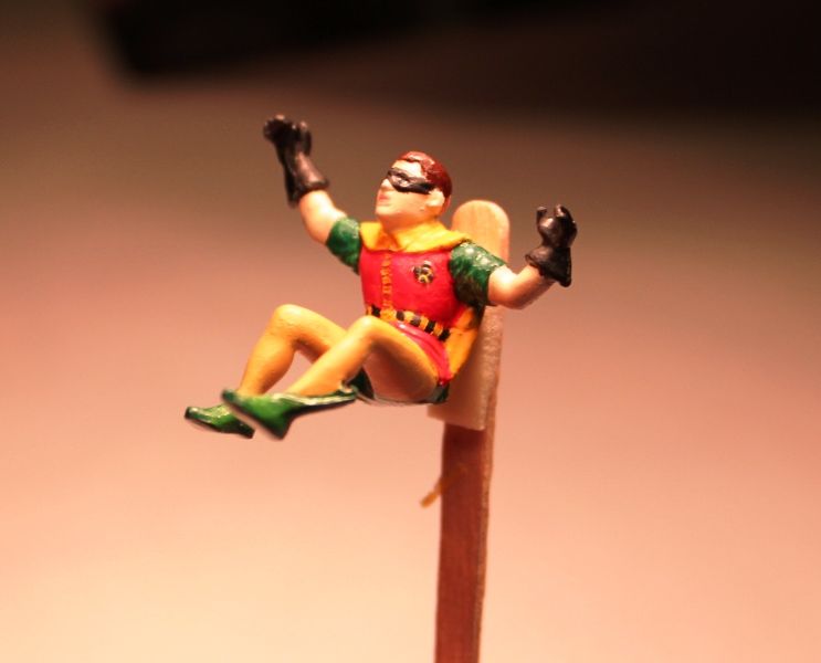

Finished painting Robin:
The Dynamic Duo:

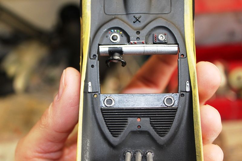

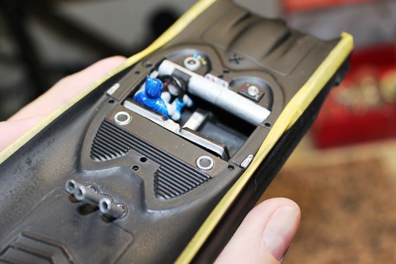

The rocket launcher tubes were glued in with CA.
I also glued inthe dashboard with steering wheel and the parachute packs:

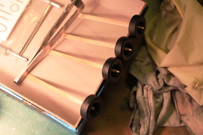

Tires were sanded where the seam halves joined then brushpainted with Testors flat black:
The dashboard and sterring wheel were glued in:
The seats were glued in:

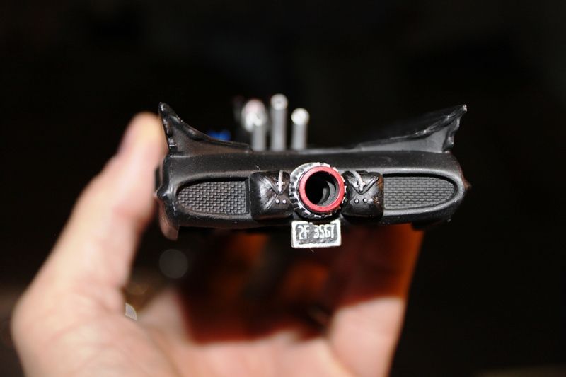

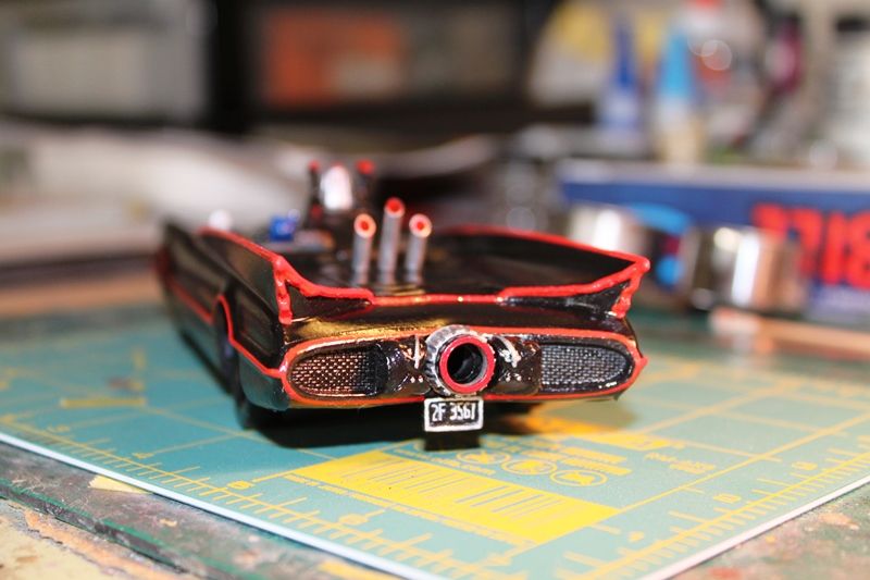

The backend with Bat chutes, Bat turbo, and Bat license plate painted:

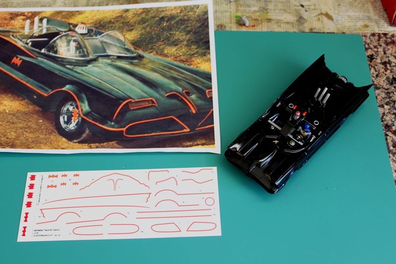

The decals have been a nightmare. They break up very easily even after coating with liquid decal film and do not adhere well even to a gloss finish. Also, on the tail fins they only give you decals for one side of the fin and photos clearly show the red striping covers the edge on both sides of the surface.
I am ending up painting most of the stripes hand with a fine brush using masking tape for the long strraight sections when possible. Luckily I have a very steady hand for the curvy bits.

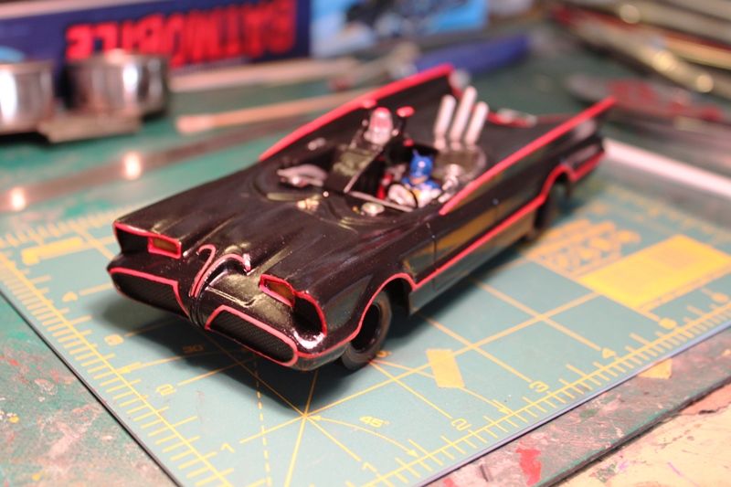

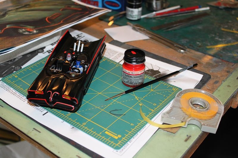

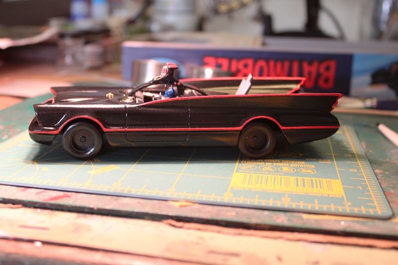

Today was pinstriping day with Testors Italian Red and a 5/0 brush. For the long straight stripes on the top of the fins and the midline on the sides I used Tamiya tape. All the curves and scallops were painted freehand:
Stripes finished :

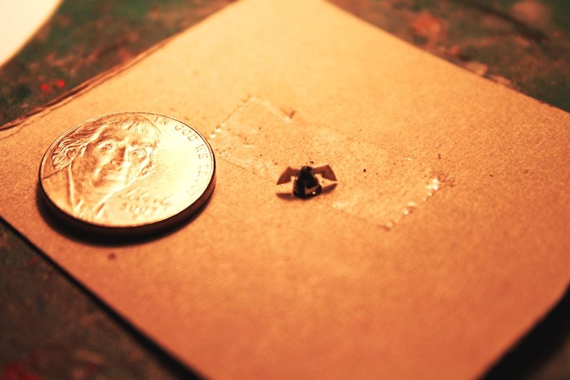

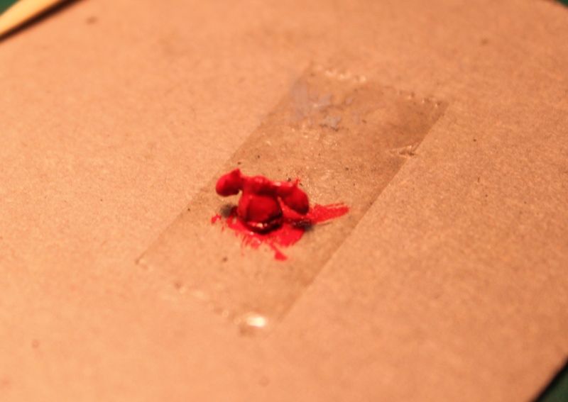

Made a teeny, tiny Batphone yesterday...
The real Batphone:

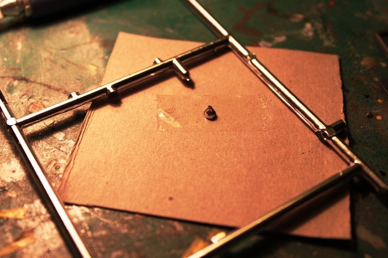

I found cutting the end off a piece of the leftover chrome sprue made a pretty good base for the phone:

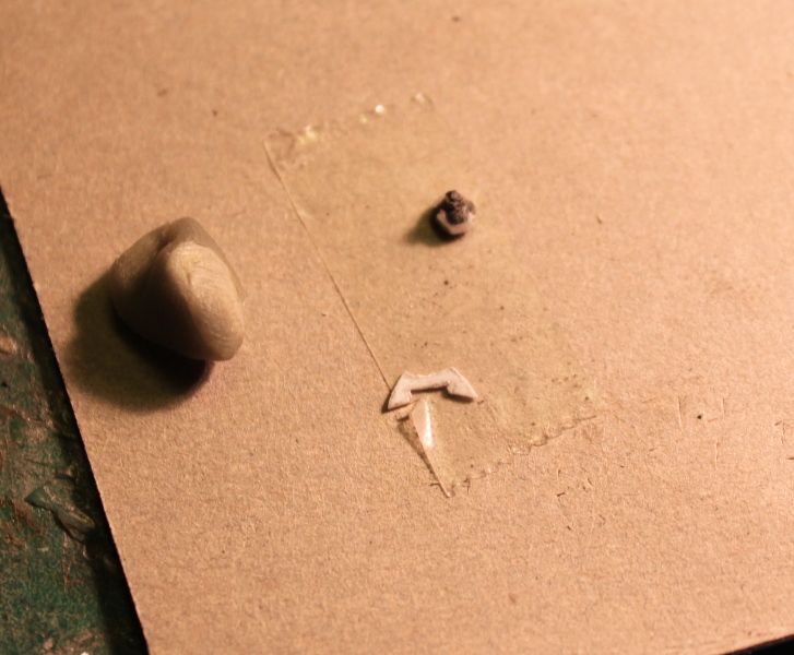

I cut the handset from a piece of thin styrene sheet using scissors and an exacto knife:
Then I cut the handset in half and glued it to the top of the base:
Once the glue had set I took a toothpick and made the ear and mouthpieces out of dropletes of CA. Then I filed and sanded to shape. I painted it Italian Red:

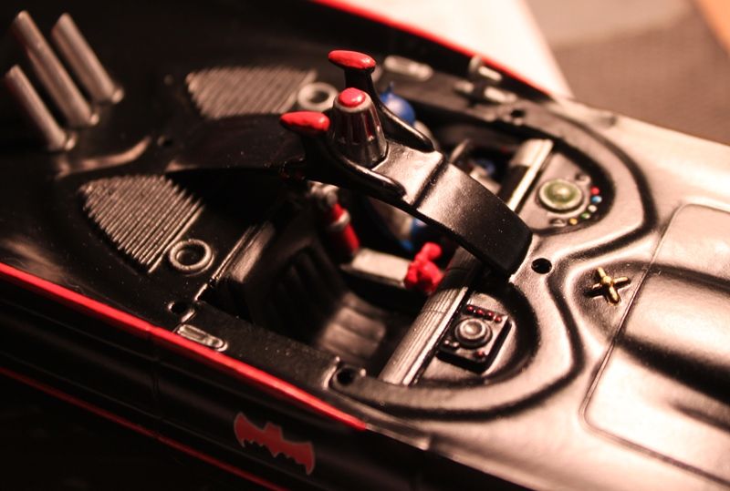

The Batphone installed in the cockpit, glued to the center console with CA:
The Batmobile was given a coat of Testors Semi-Gloss over a coat of Dullcote giving it a nice sheen. The Dynamic Duo, the seats, the Batchute packs on the rear, and the tires, are all left flat matte.
