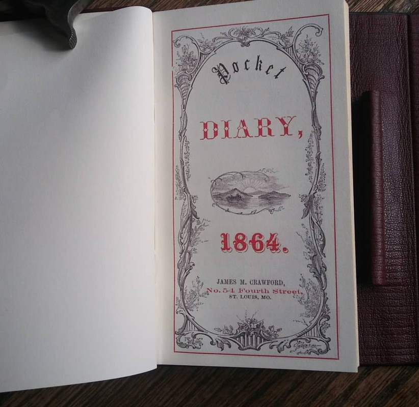

I chose to make the diary in "new condition" instead of distressed. I figured over time it will naturally distress. So in reality, this is what the booth diary looked like when it was new back in the 1800's..
The pages are filled out with all period correct print that would be in a diary of that time period.

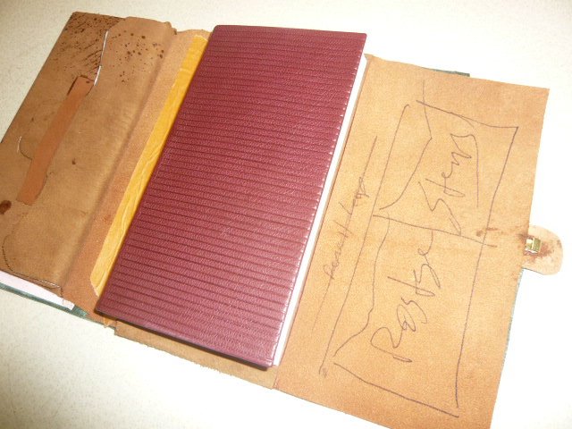

below you will see pictures of the multiple test books made for size and for function purposes.
sample diary #1
sample diary #2
sample diary #3 with postage pockets and leather finishings
red leather being hand tooled with embossed lines
The original booth diary, the red hardcover booklet inside the wallet was removable so you could buy a replacement for the next year without having to replace the entire wallet. That is how we designed mine as well.
here is the finished product
