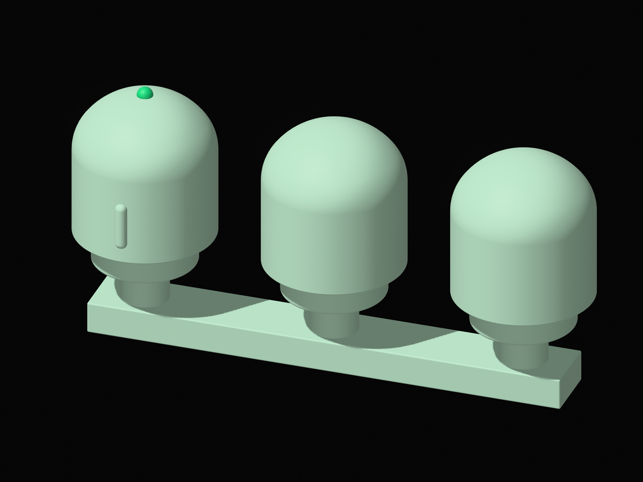

*A shorter cylindrical tower to sit behind the bridge, since the kit version is too tall. One version matches the filming D-7 model, with the extra greeblie and the round pinhead detail on top. The other is plain and smooth, like on the AMT tooling model.
* The round pinheads which were on the rear bridge platform and either side on the main body.

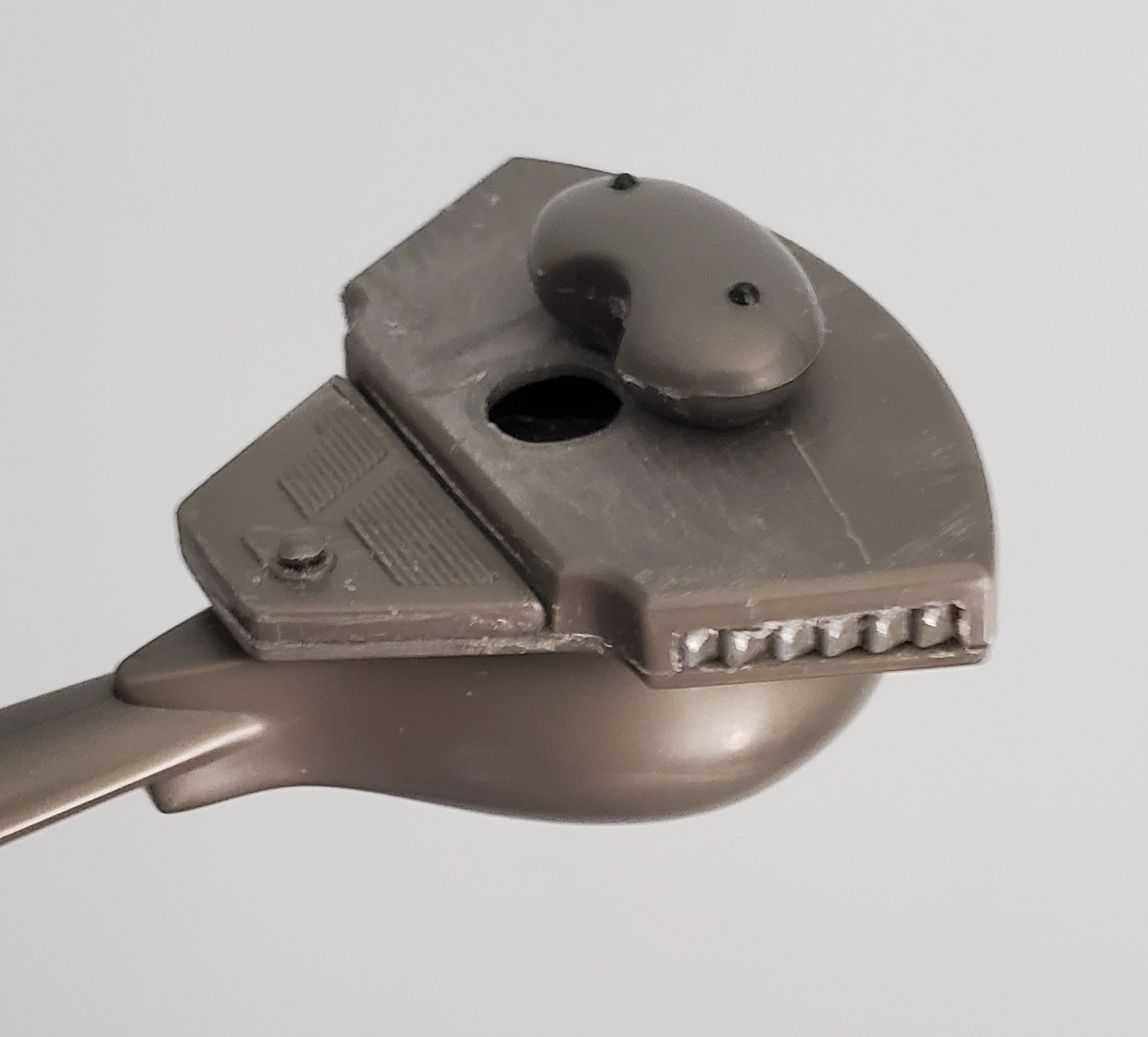

*A replacement for the sensor hole tunnel piece on the “head”, with the antenna details added in.

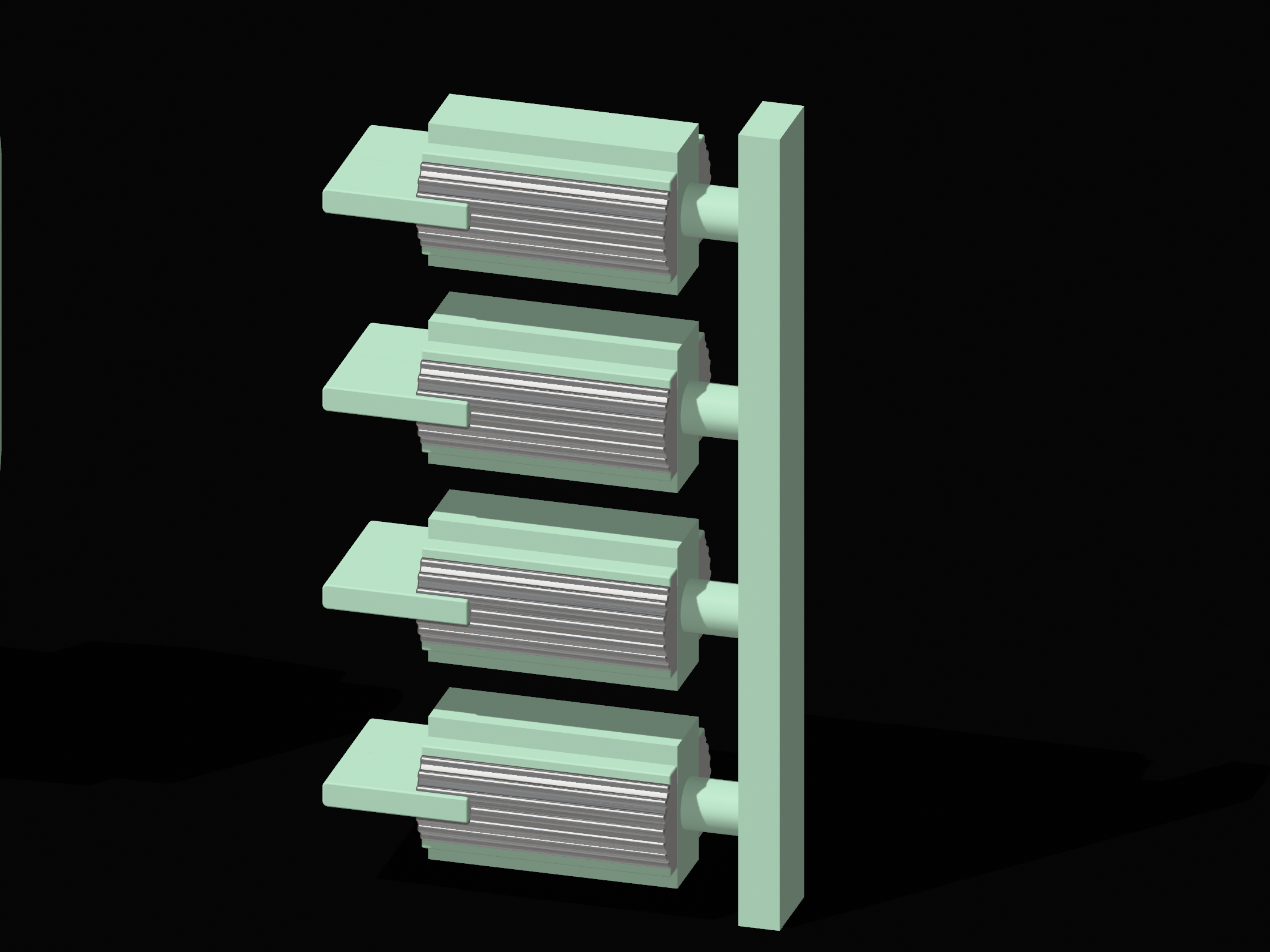

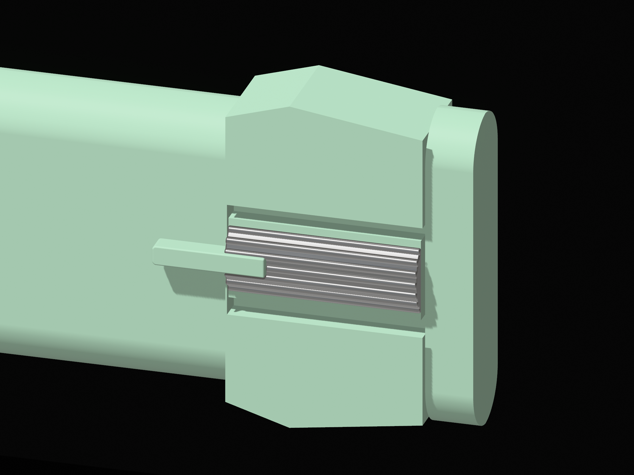

*The alternate nacelle half-round grille detail seen on the AMT tooling model and the original AMT model kit, designed as one piece to be trapped in-between the nacelle halves. I made a digital mock-up of the nacelle based on caliper measurements of the kit parts to ensure a proper fit.

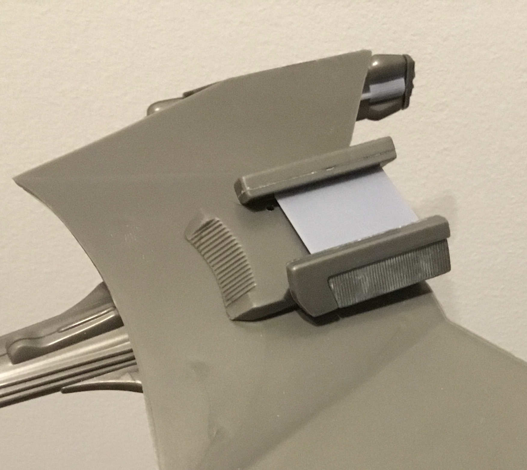

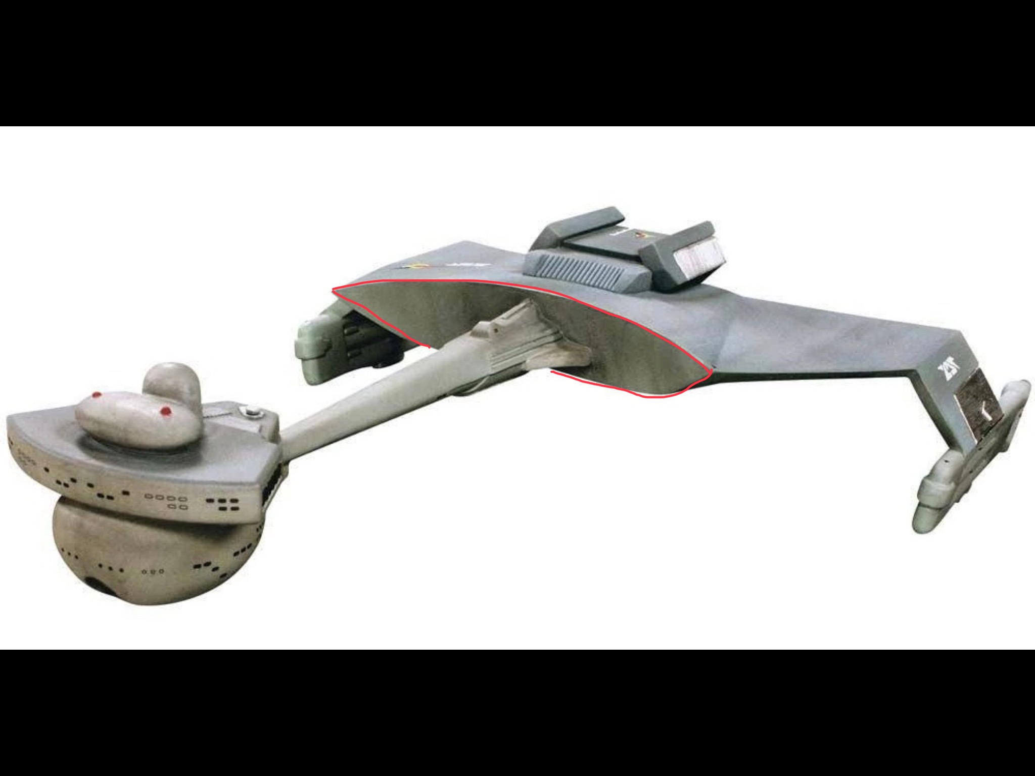

In doing research for accuracy mods on the D-7, I was reminded that the little ramp platform behind the Bridge is too long on the Polar Lights kit. Sure, I could just file and sand it down, but getting the rear bevel angle and the length correct and consistent on several builds would be a bit tricky.
So, I’m now modeling the ramp, as well. I used the rear tower I’d already built, and created a mock-up of the Bridge bubble (based on measurements of the kit part) to get everything lined up and scaled properly to match the reference images.
That way, I can just remove the stock tower and ramp, sand the upper Bridge platform flat, and install the new parts with minimal fuss.
Realistically, I should just model the entire upper Bridge platform and all of its details, but that would be a lot of work. Better to just modify the thickness of the kit platform and then plant on more accurate parts.

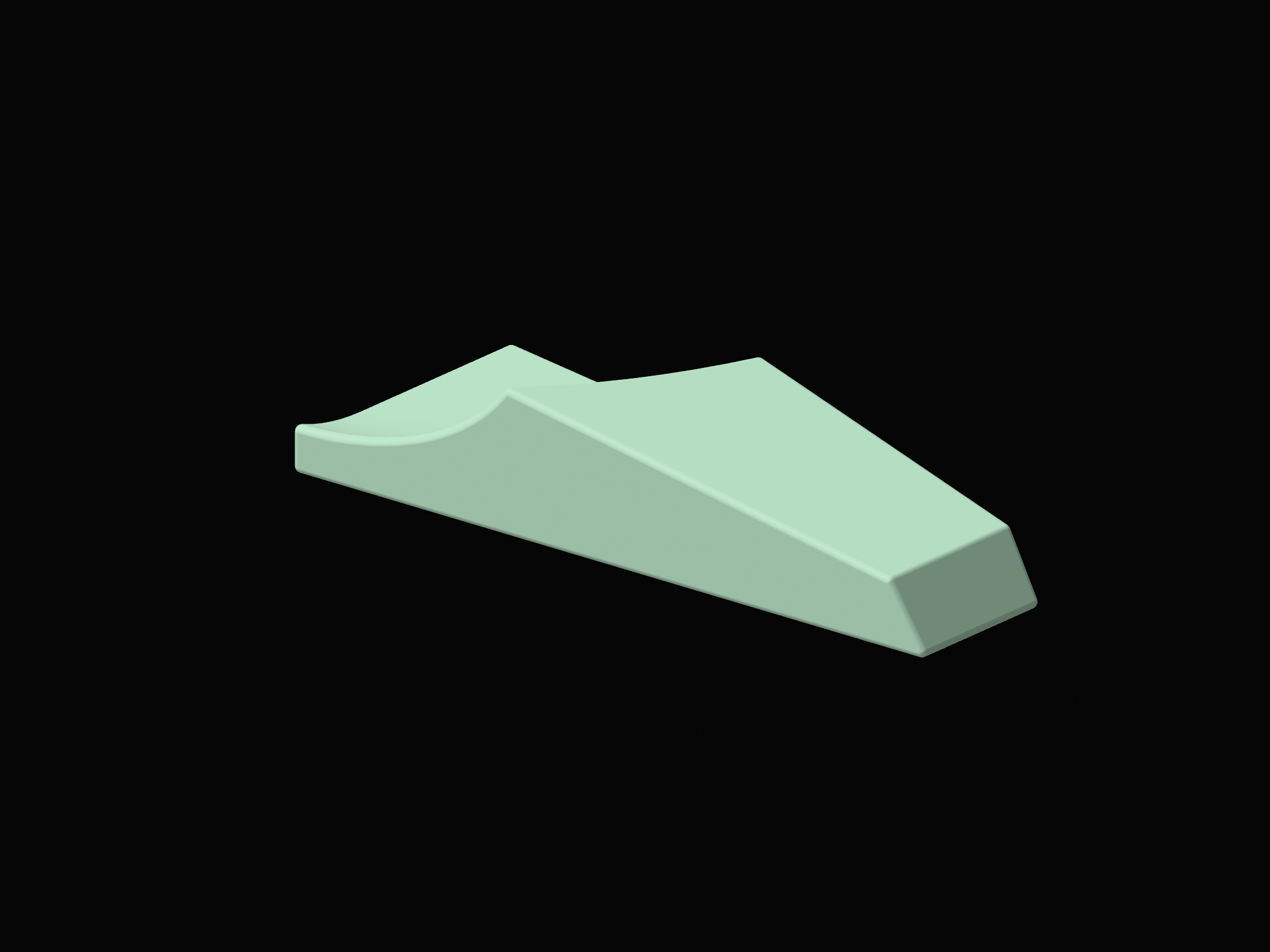

I decided to also create a new hangar roof piece (minus the front pegs and interior detailing), since the kit part is about 3.5mm too long, facing forward.
Sure, I could just shave it down, but, once again, getting the beveled edge/length right and consistent for several models would be tricky. This will ensure consistency.

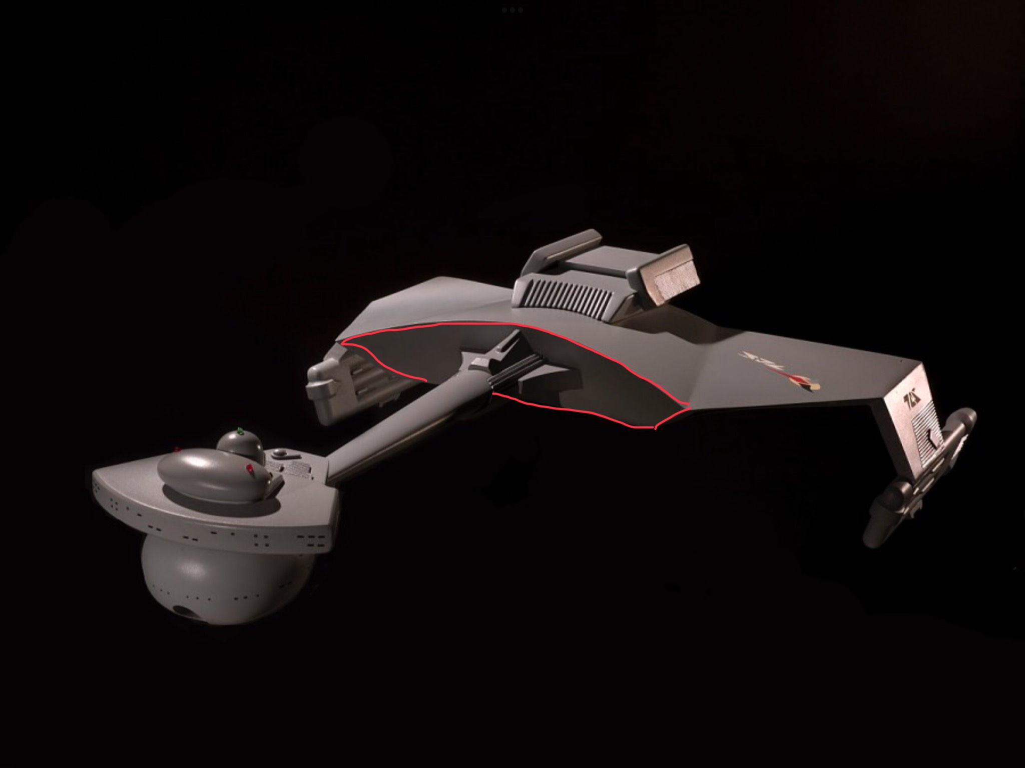

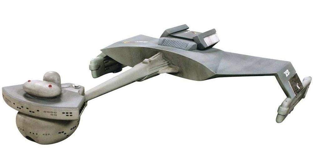

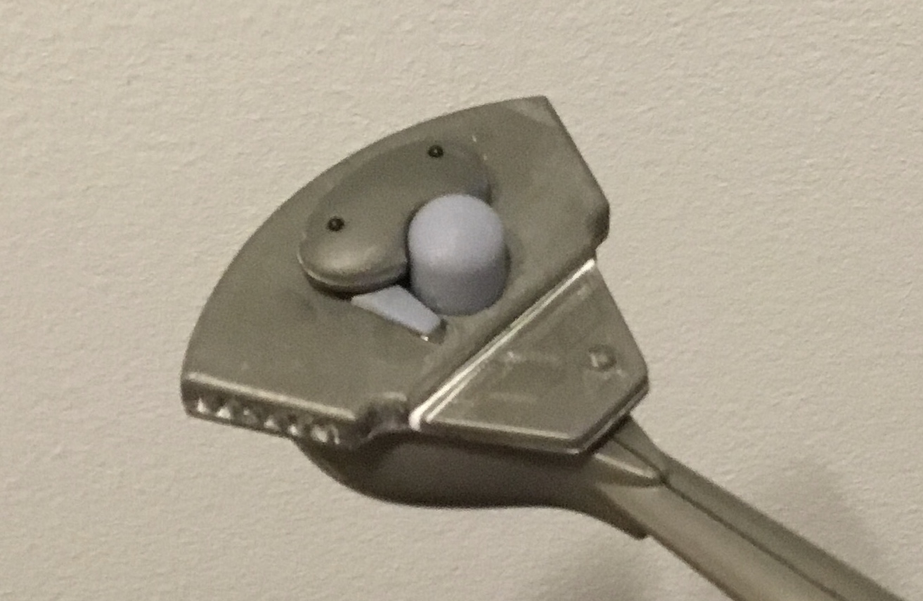

I cut apart and modified the Bridge platform, using reference photos of the studio model. The curved front half was lowered by about 1mm, and the rear deck by about 1.5mm.
I also sawed off the rear tower and the ramp. My replacement tower is designed to slot into the hole left behind, and the remaining footprint of the stock ramp will help will aligning tge replacement.
Everything is glued together, except for the Bridge bubble. Looks rough, but once properly putted and sanded, the assembly should look more proportionally accurate.

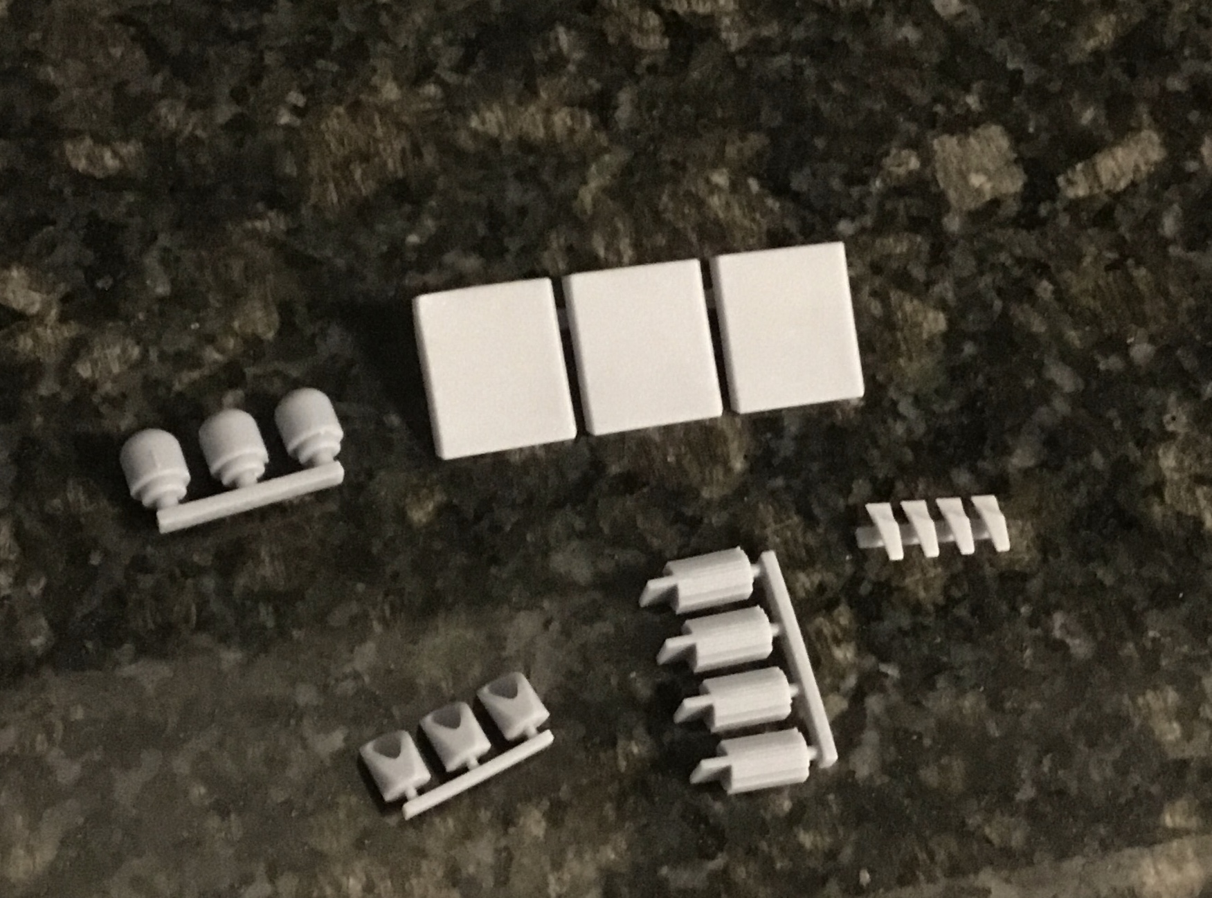

Buttoned up the last tweaks on the D-7 replacement parts (sensor tube, hangar roof, Bridge rear tower/ramp, engine grilles, pinheads), and ordered them to be printed in resin. Should be arriving in a week or so.

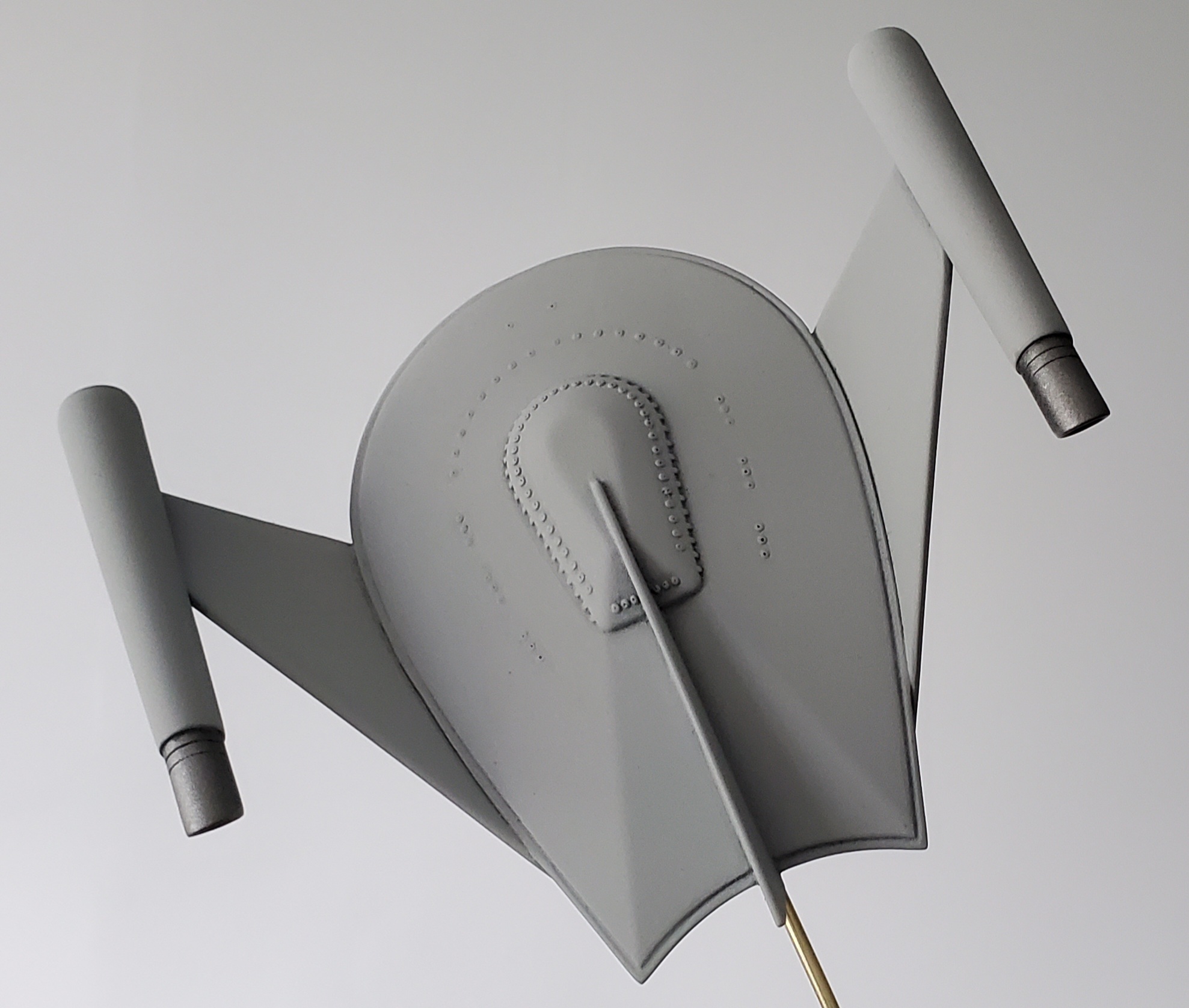

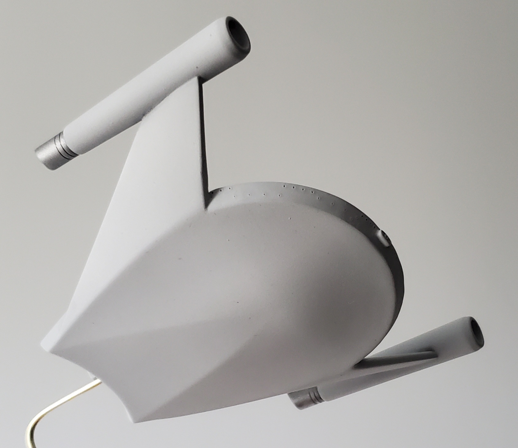

I masked off the Bird of Prey's engine endcaps, and painted the body a mix of Tamiya White tinted with Light Gray.
Looks right to my eye. An off-white that looks grayer in certain lighting.
And the preshading makes the lines and details subtly pop.
