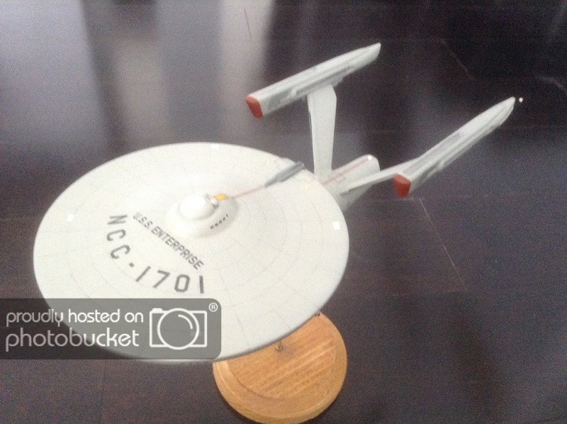

After many years of patience, I finally have a model of the refitted Enterprise, from the aborted STAR TREK PHASE II (originally just "STAR TREK II") TV series! This is the recently-released, 1/1000 scale kit from UGH Models. The kit is excellent, but requires some fairly extensive modifications to more closely match both Matt Jefferies' original design, and the visual effects model built by Brick Price and Don Loos. David Shaw's incredible research and scratchbuilt model (http://www.hobbytalk.com/bbs1/99-sc...g/376313-phase-ii-enterprise-study-model.html) were invaluable resources for this project, and I shamelessly copied--er...used his work as my primary reference, with a few minor tweaks (and the occasional mistake) to suit my own tastes.
Alterations to the UGH model include:
* Removing and shortening the B/C deck superstructure, and adding the connecting piece between the two turbolifts on the Bridge.
* Extensively modifying the impulse engine "spine" on the upper rear saucer.
* Removing and replacing the lower sensor dome on the underside of the saucer, and filling the two outermost engrave rings on the lower saucer.
* Removing and replacing the sensor/deflector dish detailing.
* Adding detail to the phaser assembly at the base of the dorsal.
* Filling in all of the molded-in windows on the secondary hull.
* Rescribing the panel lines on the hangar deck doors.
* Adding navigation lights to the saucer and secondary hull.
* Shortening/reshaping the nacelle pylons, and replacing the molded-in vents with scribed sheet styrene.
* Removing incorrect detailing on the nacelles, and adding new detail (vents, ribbing, fins, upper channels).
* Scribing gridlines into the upper saucer, secondary hull, and nacelles.
The decals were custom-printed from a scaled-down version of Shaw's excellent decal art, with a few tweaks.

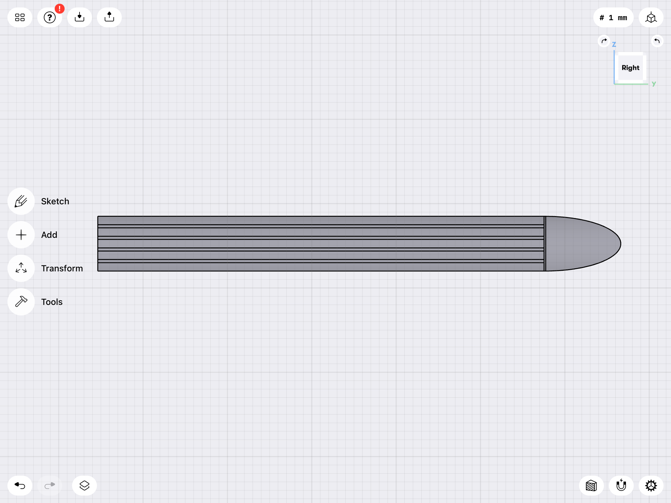

After awhile, I realized I could go even further. Given my recent experience in learning 3D modeling, I realized that I could model and 3D print replacement parts which would be very accurate, and not suffer from the inevitable wonkiness of being handmade.
So, I loaded Matt Jefferies’ original blueprints into Shapr3D (while also referring to the reference photos of the unfinished studio model), and began tracing, extruding, and shaping parts. At first, it was just the dual-turbolift Bridge, the lower saucer planetary sensor, and the marker lights. Then, the nacelle/pylon support/shield pieces. Then the linear accelerator. Then the secondary hull docking ports and their pentagonal hatches. Then the nacelle chin guards. Then the nacelle front endcaps themselves, which can be printed, shaped to fit the contours of the kit’s nacelles, molded, and cast in tinted resin. Then the B/C deck.
What began as an engineering refit evolved into a redesign of the whole model.
Here’s the current progress. I’m very excited. Parts like the bridge and B/C deck have been designed to key into each other, and various parts have sprues connecting them, for both cost and ease of printing. The photos seen below of the model itself (which still includes the tape on the nacelles/pylons, as well as the original, scratchbuilt parts, since the replacement parts have yet to be finalized and printed) show what a difference just the pylon length tweaks make. In its first life, the model looked a bit…off. Enough to be quietly nagging at me for the past few years.

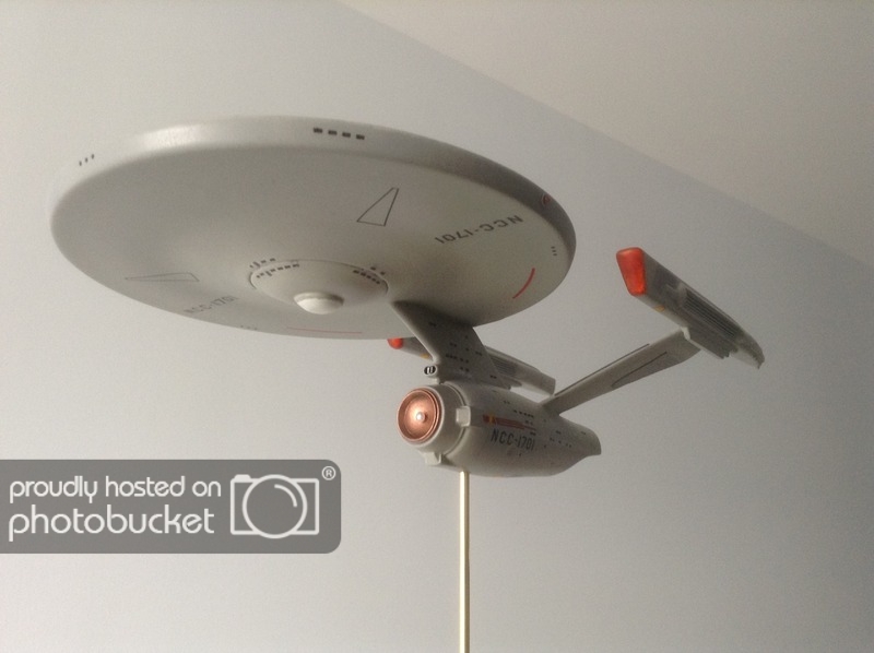

On a tangentially-related note, I’m also modeling a few parts for my Richard Taylor/TMP preproduction version of that ship. Since the Tetryon Parts replacement is no longer available, here’s the impulse crystal:
And what I really need to do is model some upgrade parts for the 1/1000 Reliant, such as proper details for the underside.

So, I began modeling drop-in pieces which will be much more precise.

Meanwhile, I’m also working on replacement parts for the 1/1000 TOS kit. I’ve never been happy with the shape of the inner nacelle dome inserts, nor their inaccurate fan-blades. I also created an insert FOR the insert, replicating the 1/350 kit’s simulated Christmas tree lights, just for that extra layer of detail. Fact of the matter is that the 1/350 kit does not have tapered fan-blades, so this may be helpful for that eventual build, too.
