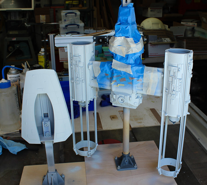

So the first step is primer. I prefer lacquer based primers as the base coat. Here I'm using Ditzler DZL-32 lacquer automotive primer. It's great stuff. Very thin so it doesn't fill in fine detail and sticks like crazy to both plastic and metal. Unfortunately, Automotive lacquer based primers are very difficult to get, at least here in the United States and California in particular. Tamiya's lacquer primer is a pretty good substitute, although expensive in those little bottles.
A number of the kit parts have been kept separate so that they may be easier painted different colors or shades.
