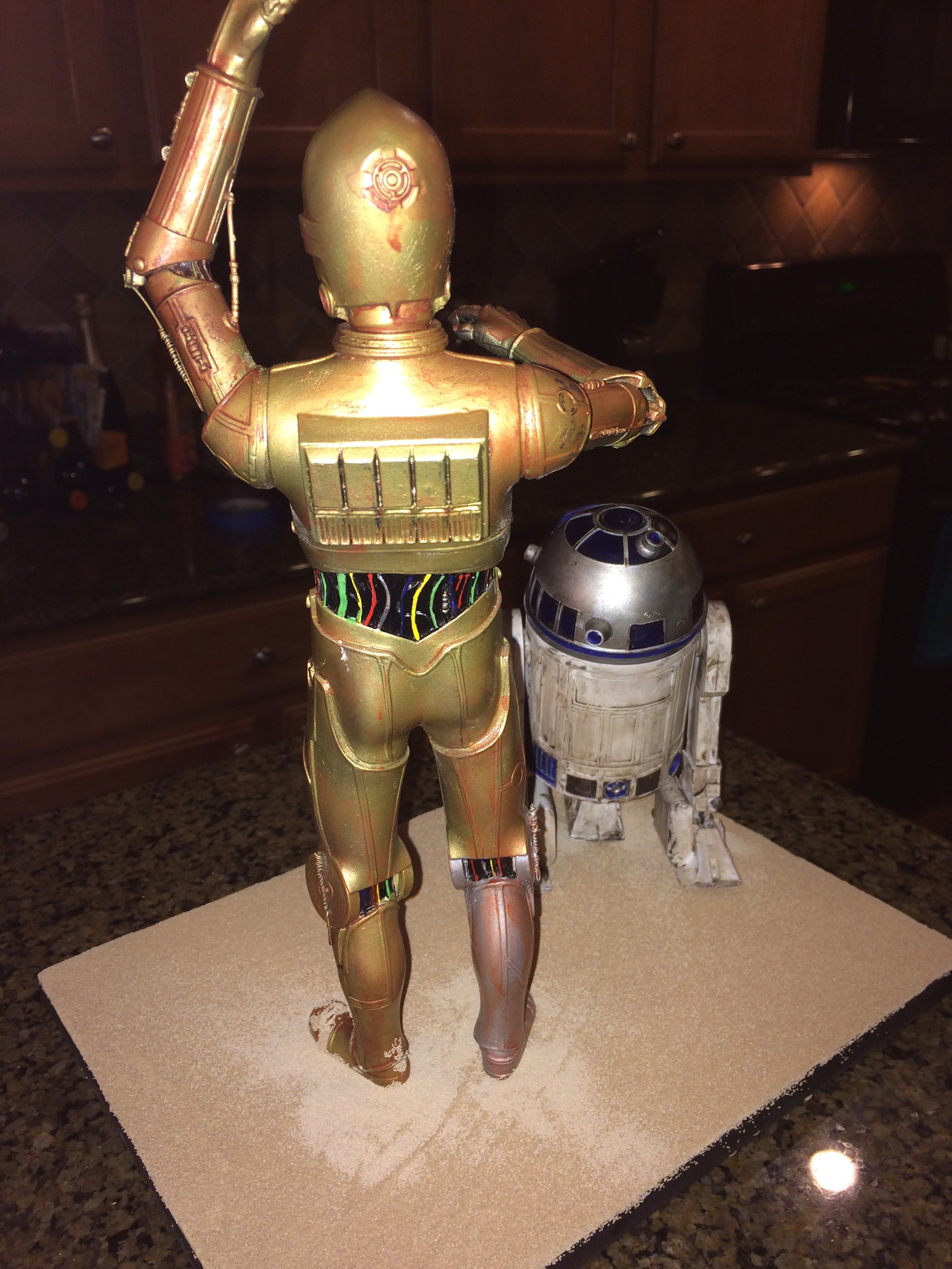

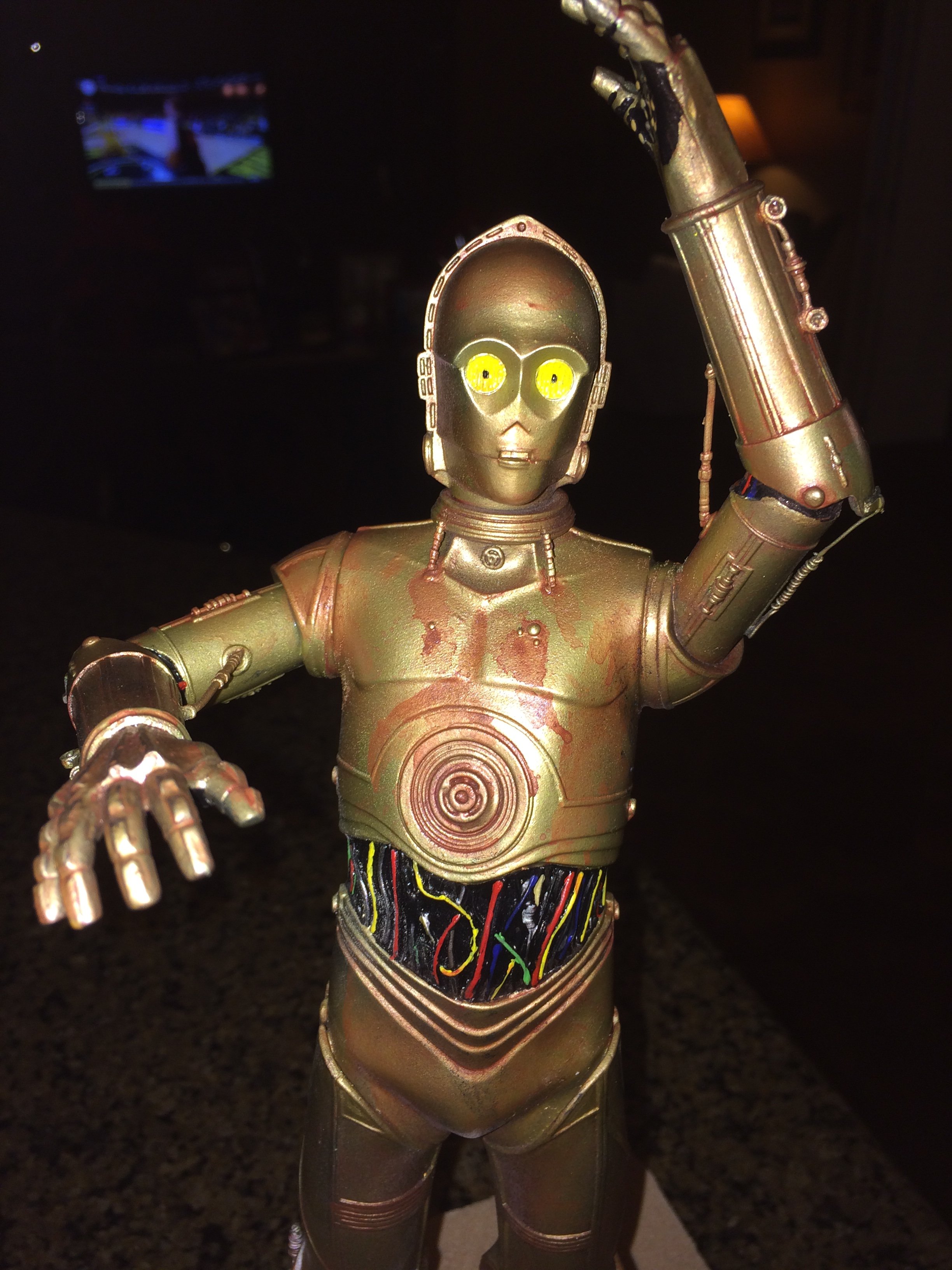

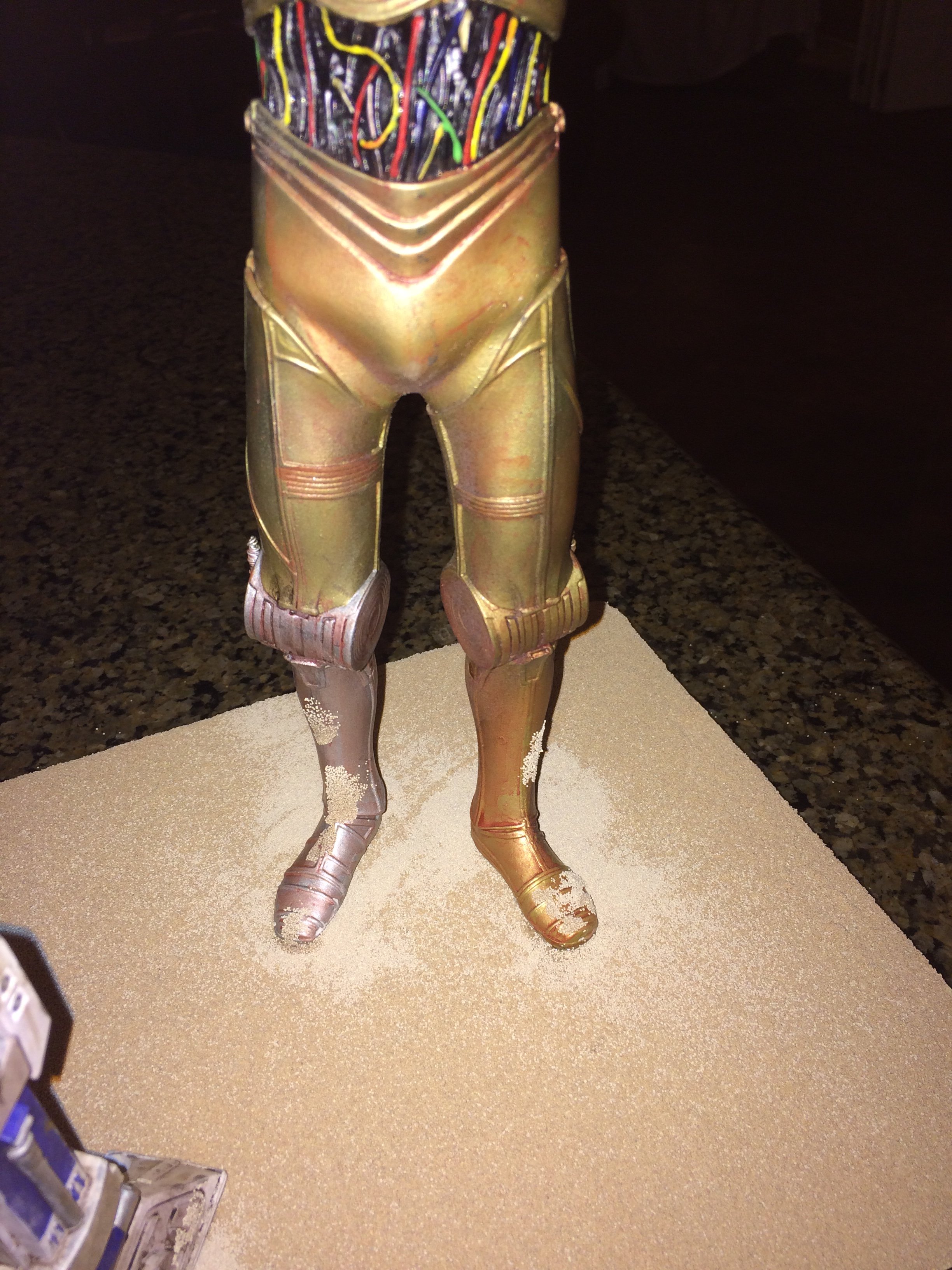

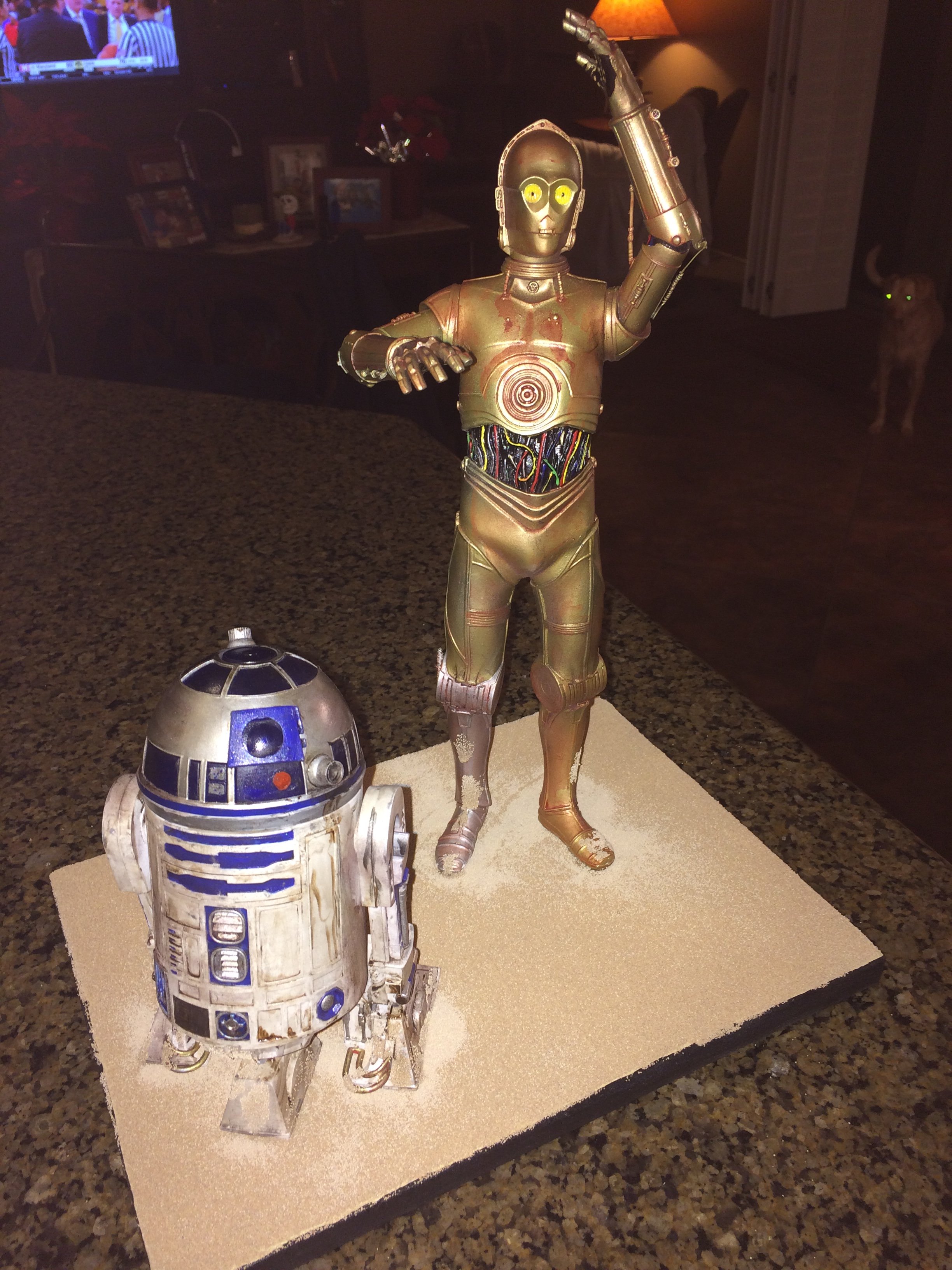

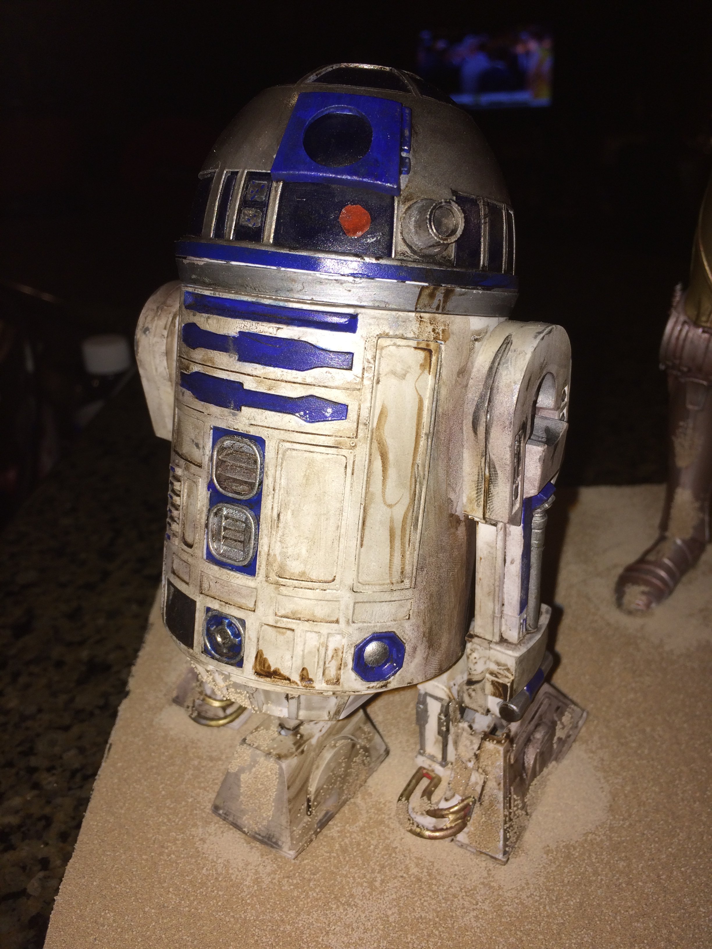

IMG_2777.JPGIMG_2776.JPGIMG_2778.JPGIMG_2779.JPGWell the boys are almost done with the desert scene. Just a little clean up and done. Any feedback is welcome.

Well done! I like the 3po better, the R2s weathering is very uniform in that the dirt looks too random, i.e. not created by various "events" or over time but simply "splashed on". You IMO could improve on that by i.e. using a thinner to create runny lines and deepen the cracks by have the paints pool up. But in the end it all comes down to personal preferences.

Almost done indeed; careful with the weathering: I don't know what type of paint you're using (or what kind of pics/research)but you should try to tone down the brown you've been using on both figures. If you look at 3PO and R2, you'll see that you have a combo of black, burnt umber, brown, beige all mixed together in certain area. Try to dilute those (use a make up sponge/ QTips) and do some layering while applying the different tints. Start with the darker color and finish with the lighter ones. Good luck:)
I'm just the moderator for my son on this one. He and his freind built this. The R2 is from a kit from 1977 I had sealed when I was a kid. The 3PO is a vinyl kit from ebay. The base is a wood base. The sand is some kind of railroad ballast. I agree that the wash needs some thining dowm but overall I think it looks great. I did post it in the wrong place. It should be in gen mod. I don't know what happened. I don't know how to move the thread there.
